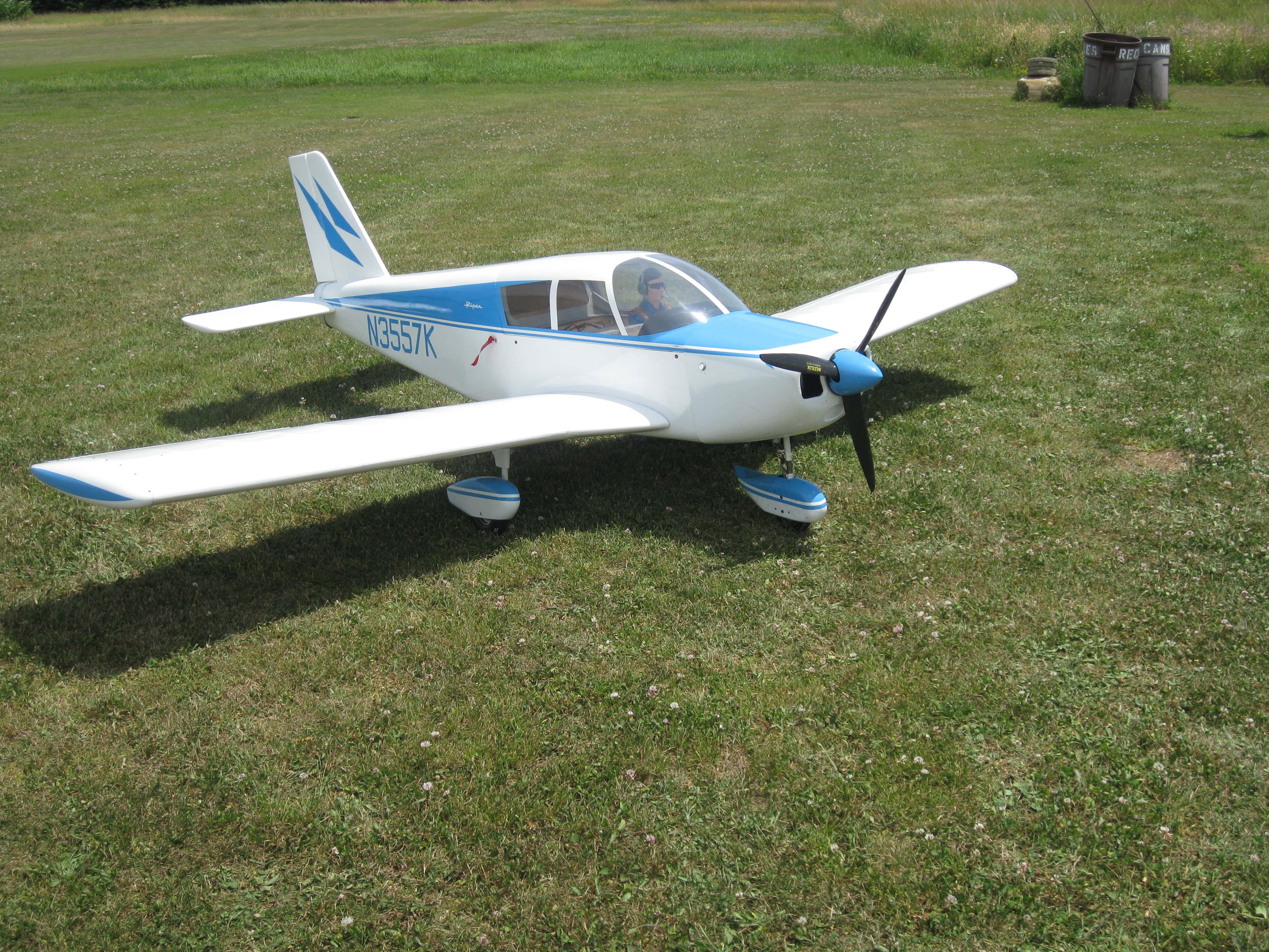

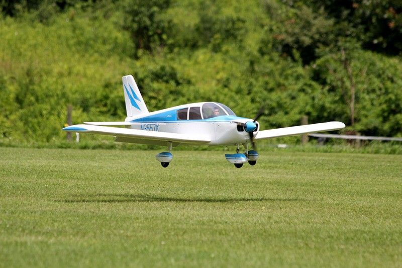

Yes, the Cherokee is 1/4 scale ARF from RC Guys. I removed the factory covering and used photos from the net. The plane that I modeled it after is owned by Forrest Barber from Alliance Ohio, he owns the Barker Airport there. I added the wheel pants and Robart struts to the build. The plane won the Best scale Piper Cub award at Wings over Piper in 2015.
