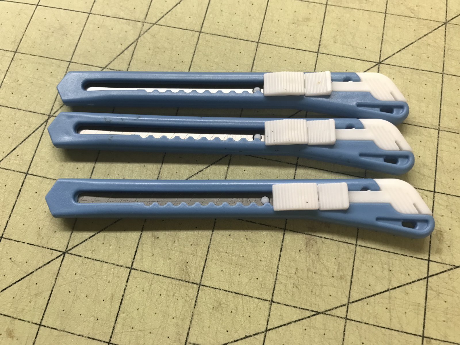

    IMG_0541.JPG Another one I have found recently is these little cheap snap blade razors from the dollar tree. Get three of them for a buck and I like them much better than a normal single edge blade for covering. They are very flexible and to me they seem to be holding the edge longer than a single edge or even a #11 blade does.

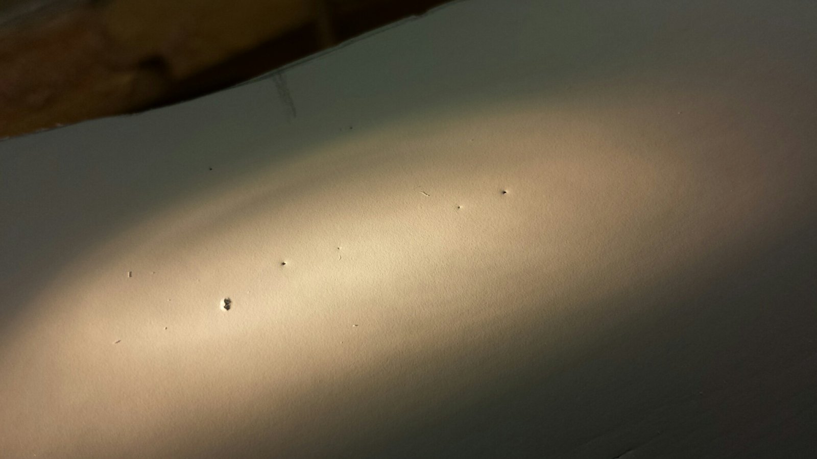

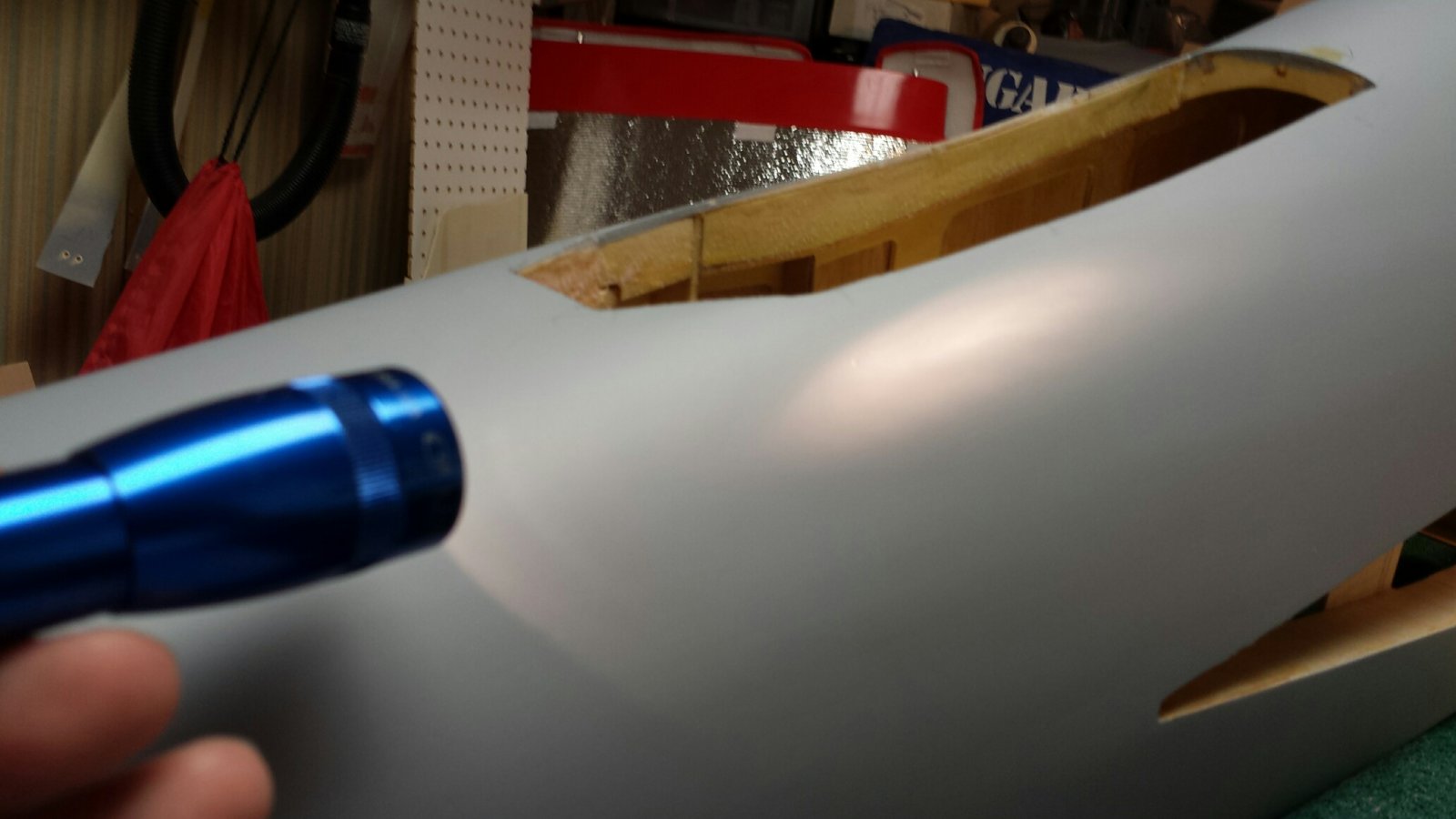

    When your working on a fiberglass part or on a fiberglassed balsa wing or fuse, your always chasing those pesky pinholes. After you first time you prime, but before you sand, take a powerful beam flashlight and shine it at a shallow angle across the surface. It will make even small pinholes show up like a sore thumb so you can find them and fill them.
