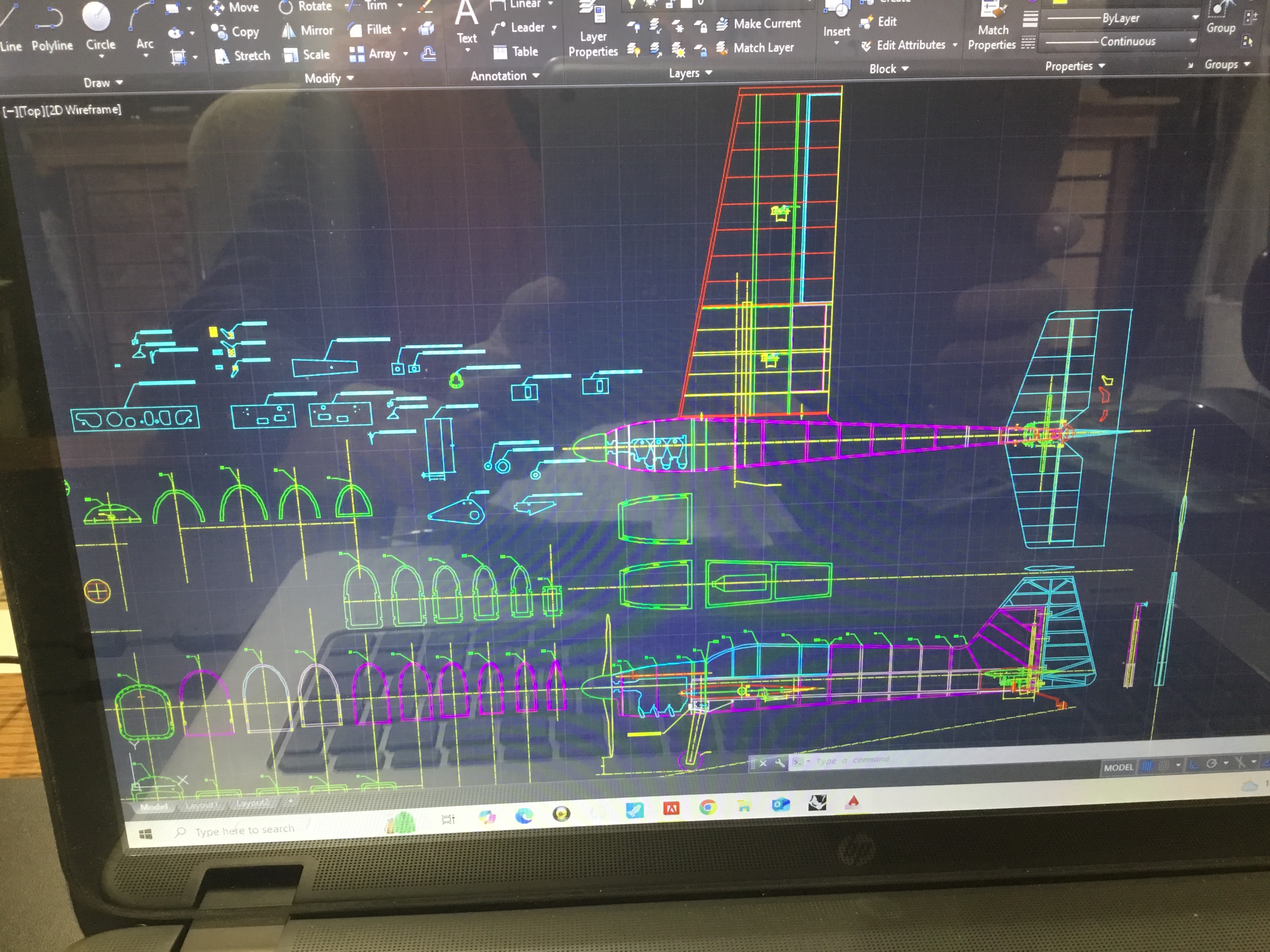

Hopefully this will be a build thread for large sport plane. Bought the engine and then started looking for a plane for the engine. Could not find a plane, kit or anything that would fit the needs for a Kolm 150. So I have decided to draw up a plane to fit the engine. The only thing I could find to fit the engine was P51 mustang. Not something I want to start out with. Would like to run the engine for a season and get use to it and setting it up and tuning the engine.
This is the drawing of the plane in AutoCad for the engine.

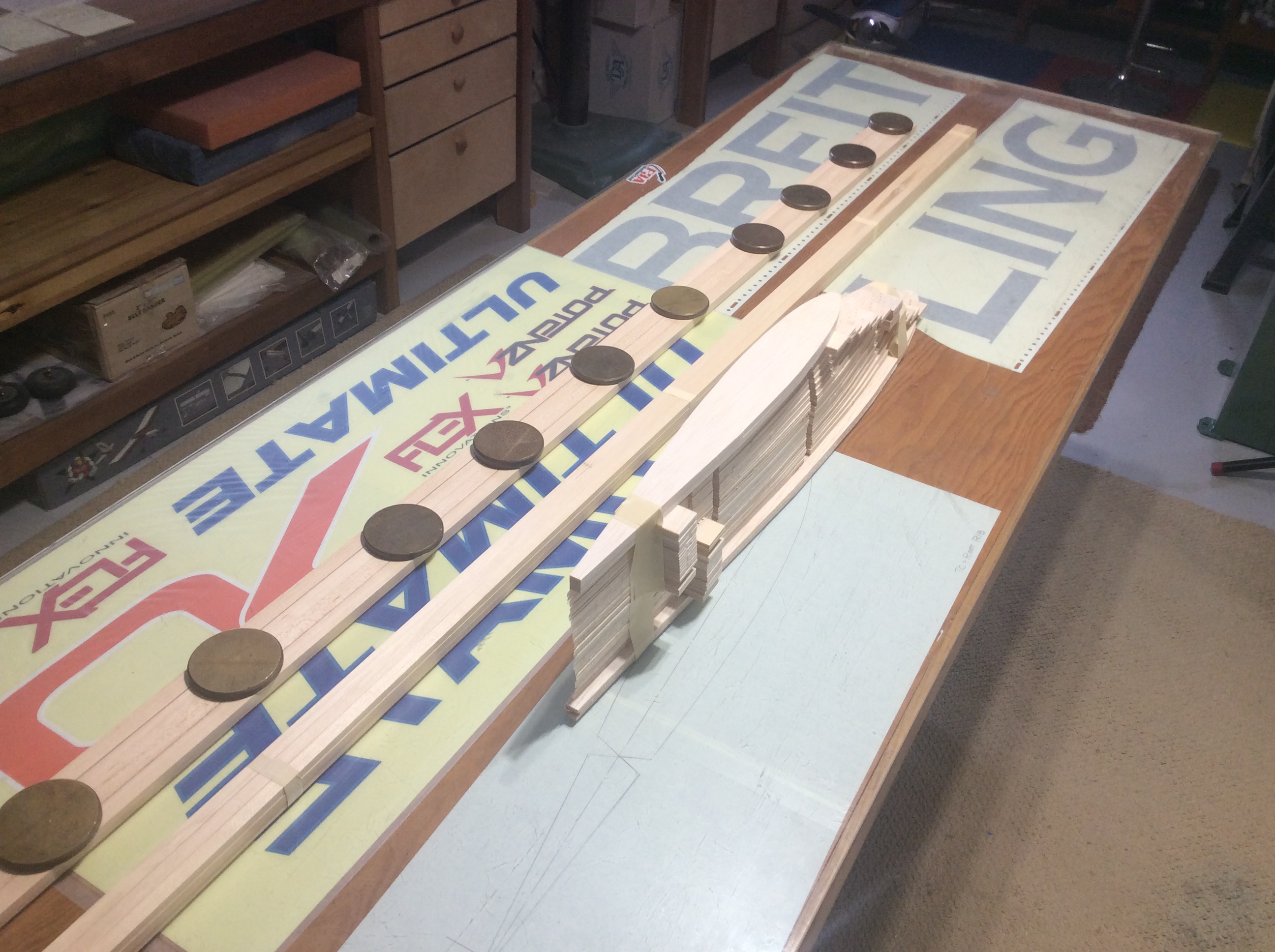

Worked on the main spars for most of the day. For some reason when drawing up the spars I decided to taper the spar from the of the tube to the tip rib. Good idea at the time but not fun to do it was a lot of work tapering the spar from 1/2 inch down to 1/8 at the tip it is done but will not do it again.
