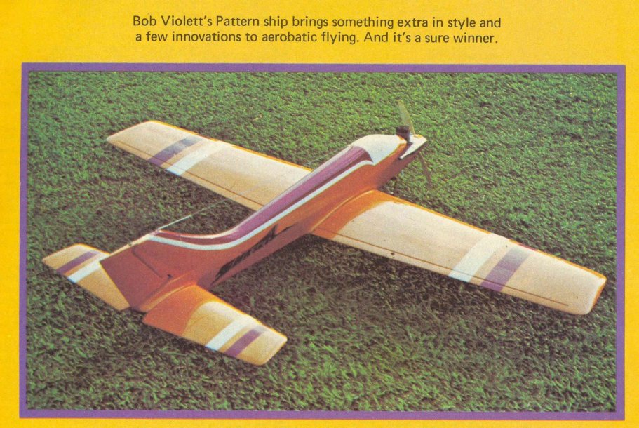

  4. Jetpainter
    Jetpainter 640cc Uber Pimp
    A Bob Violett Shrike pattern plane from back in the early 70 had a flying stab. It used “The Violett Flying Fork” for control.
    Snoopy1 likes this.
  5. Snoopy1
    Snoopy1 640cc Uber Pimp
    4,513
    6,473
    Canada
    It would be interesting to hear from somebody hoe flew this plane, and what if thought of it. Did not know the bob violette made pattern ships.
