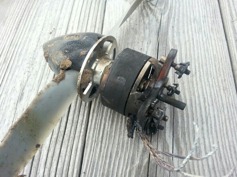

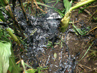

The motor was the only thing left. Either esc or lipo burned up in flight.
SnowDog
Oh my Dog! That's bad, dental records bad. Didn't see the smoke in time huh?
The plane was flying level and then nosed down with complete loss of control...no smoke until it hit the ground. Either the ESC or the battery failed. Single battery powering motor and RX through the ESC.
Wow! Sorry Mike :(
That looks like ESC to me... What did you have in there?
Brand new ZTW Gecko 80amp. Battery was a Gens Ace 6s3000
This plane flew great last weekend. Not sure what happened...unfortunately with the lack of evidence it will be impossible to discern the root cause of the accident.
