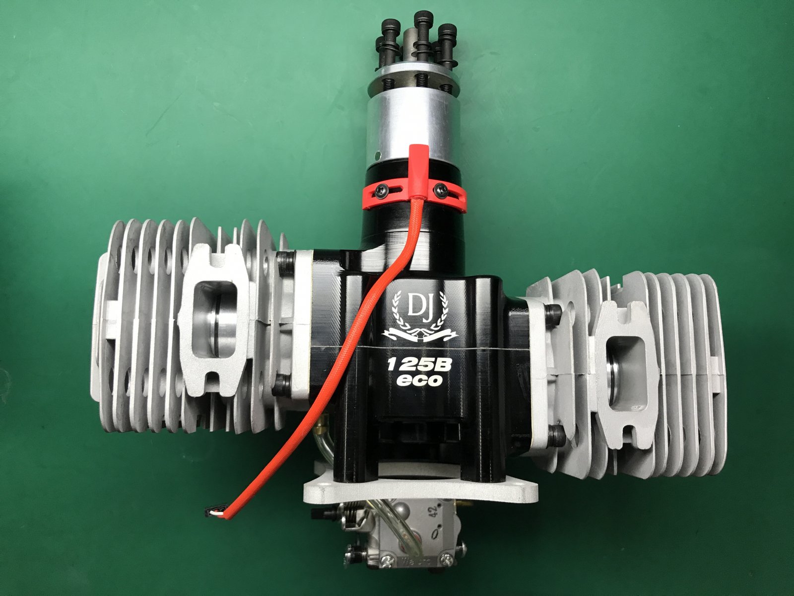

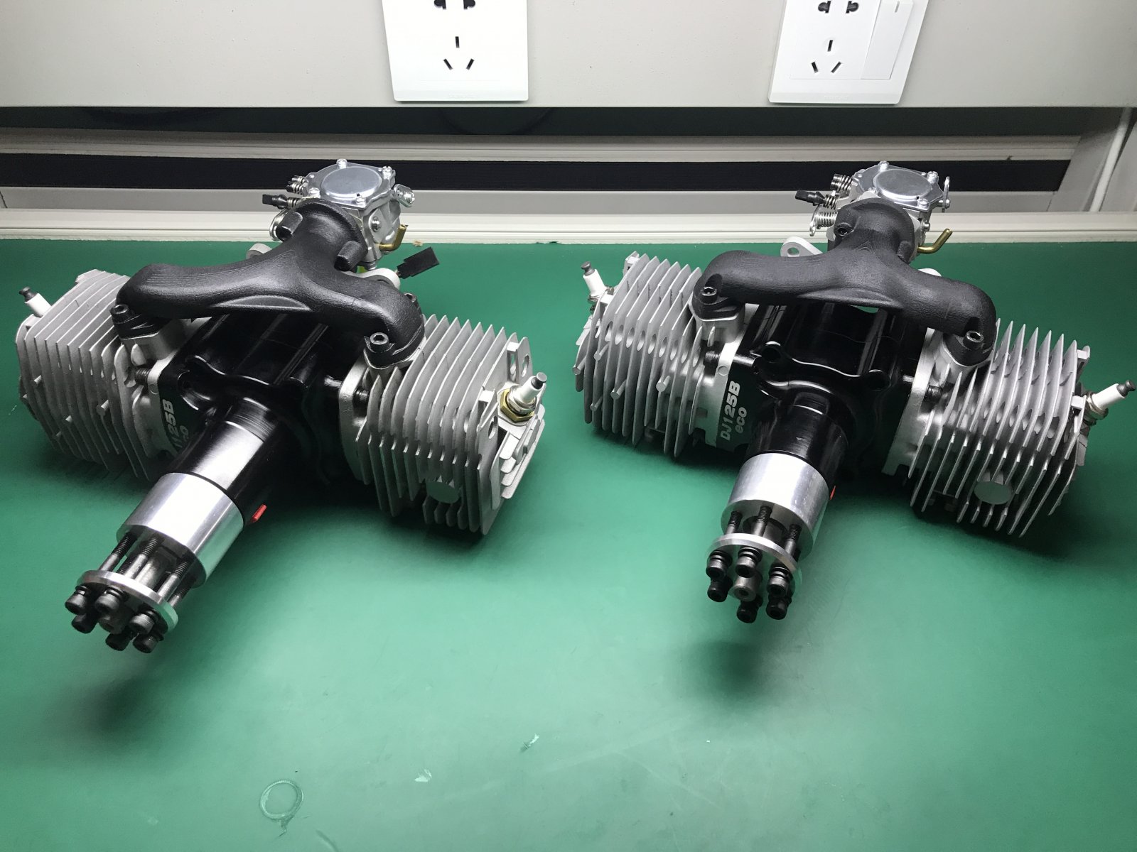

    Saw this rendering......125cc.......Old School Piston port induction o_O (no reeds)...... Compact heads/angled plugs to fit smaller cowls......Fairly light weight :happy:...... Slightly more powerful than a speeding mini bike:on_the_go:......Says it will 3D a 35 center :cautious: but better suited to scale :ugh:.....Dirt cheap price :money_talks:......Will make you wish you had held on to the lighter more powerful DA85 :big_yes:.....
    It is a "pretty" though!
    And everything flies so much better when it's pretty :In_love:.
