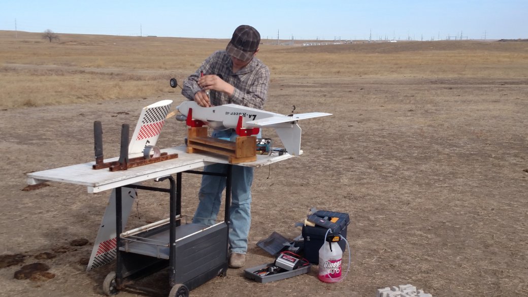

We spent most of the time working on planes though. We had a maiden on an OMP profile that we kept having problems. You could take the plane up at about a 45 to get to a safe height, level out and it would run out of fuel and die. We ran it on the ground, held it up at an angle and no issue.
Tuning did not affect the problem. Took it back up and out of fuel again. The guy has the tank mounted below the wing and I was concerned that was affecting it. You would think this would not be a problem. Although we don't often do those long 45 degree up-lines inverted. This was with a DLE 20. If any of you have any suggestions let me know and I will tell him.
