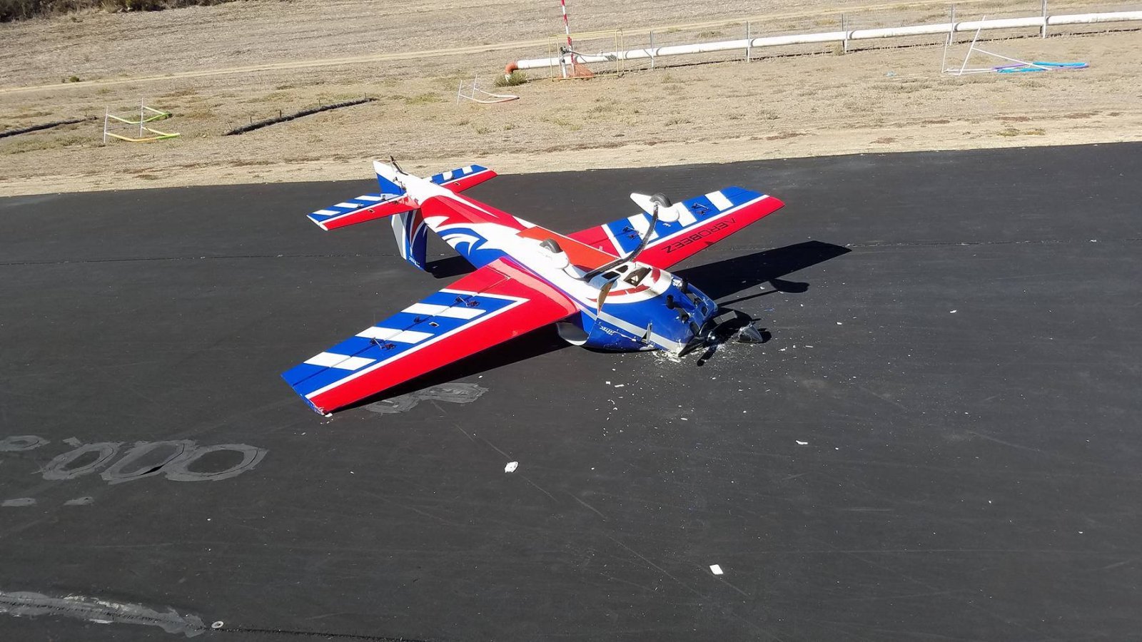

First up on Friday, the 40% decided to call it quits when I pulled out of a hover. She got 30 feet up and the engine died- best educated guess is because of how rich the engine is that it loaded up when I was torque rolling and when I went wide open she quit, I was going to begin setting the needles after this flight but obviously didn't get there. Joe Mitchell is going to take a look at the engine and confirm what we suspect, hopefully the damage to the engine is minimal. The damage to the airplane isn't bad, a new cowl, some repair to the wing tip, and a new motor box and she'll be back in action. That was an expensive learning mistake but you all know how this hobby goes sometimes :rolleyes:

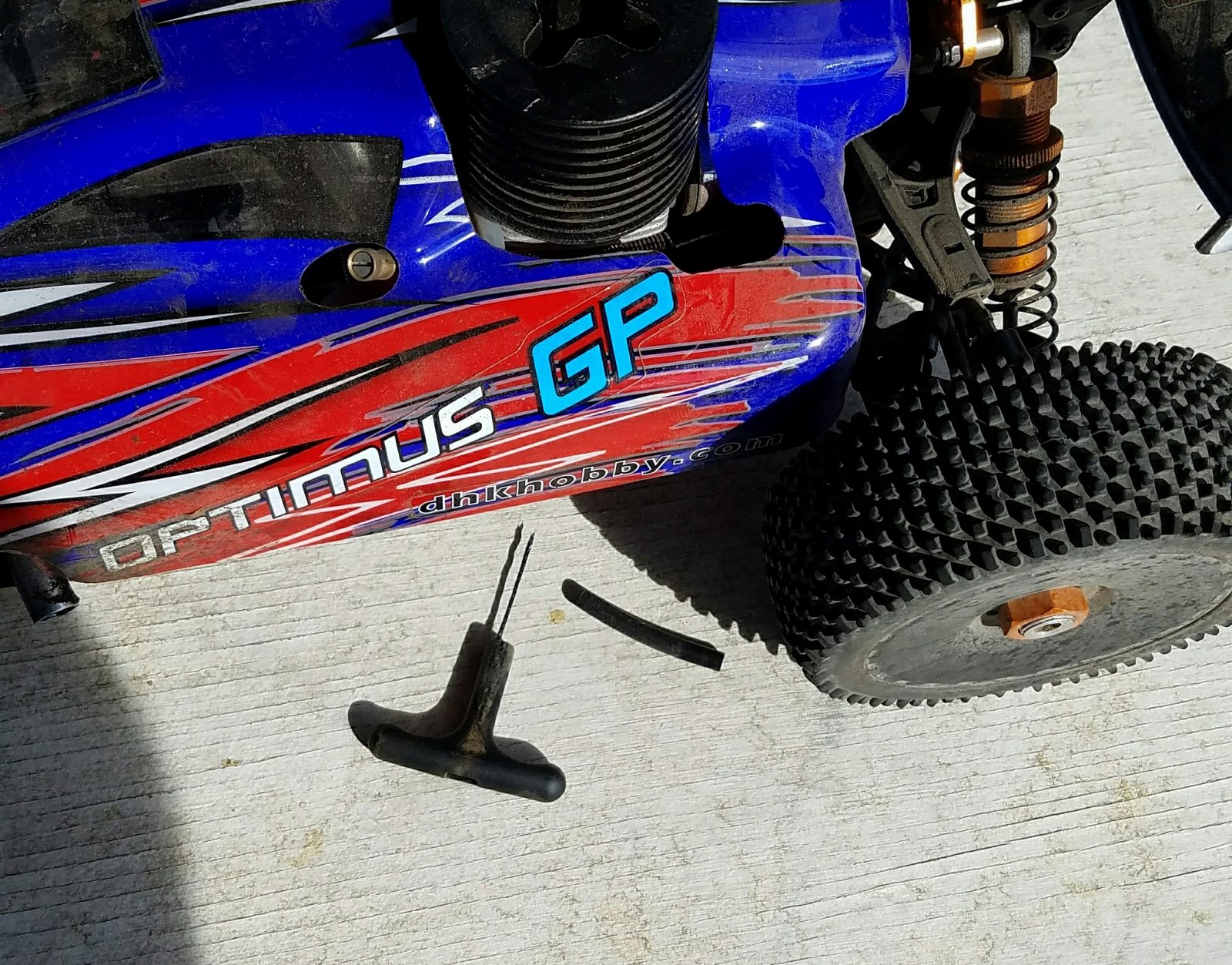

Saturday seemed to go off without a hitch, I flew my 107" Yak harder than I have ever flown an airplane before. Went to unwind with the new buggy and broke the pull start before she even got running..

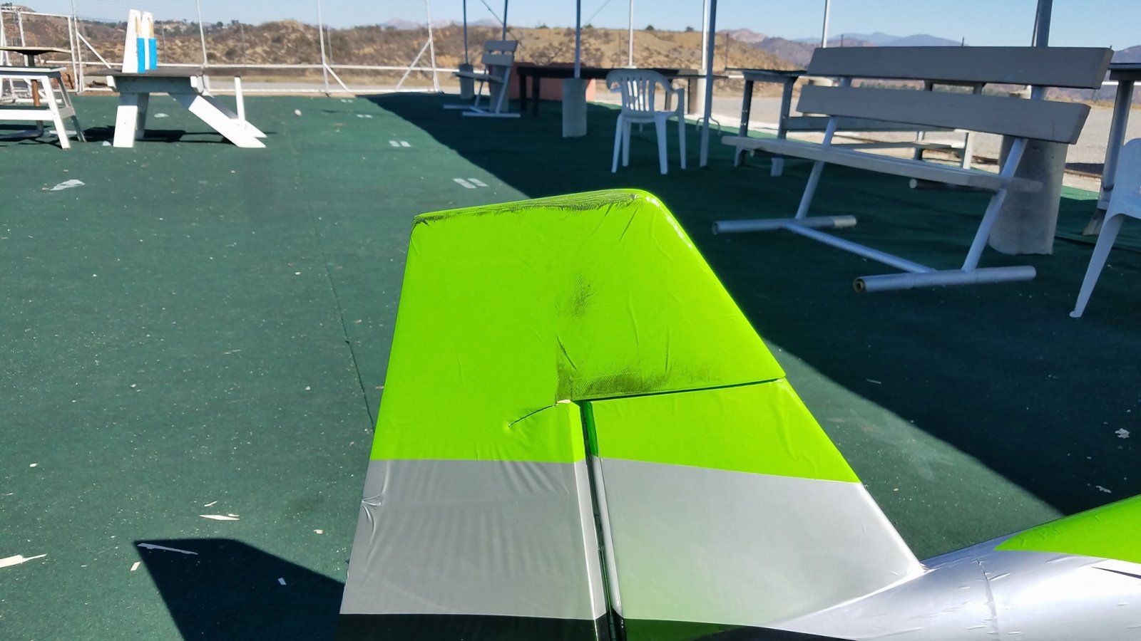

Lastly, today, probably the most epic thing I've ever done was drag the side of my rudder in a rolling harrier. Of course I broke the counterbalance loose on my brand new rudder and had to repair it... The repair turned out horrible, I won't even show it :ugh!: Guess I need to buy another rudder :rolleyes:

Dang, sorry for your "not so good" luck this weekend. Heck of a way to spend a weekend huh?

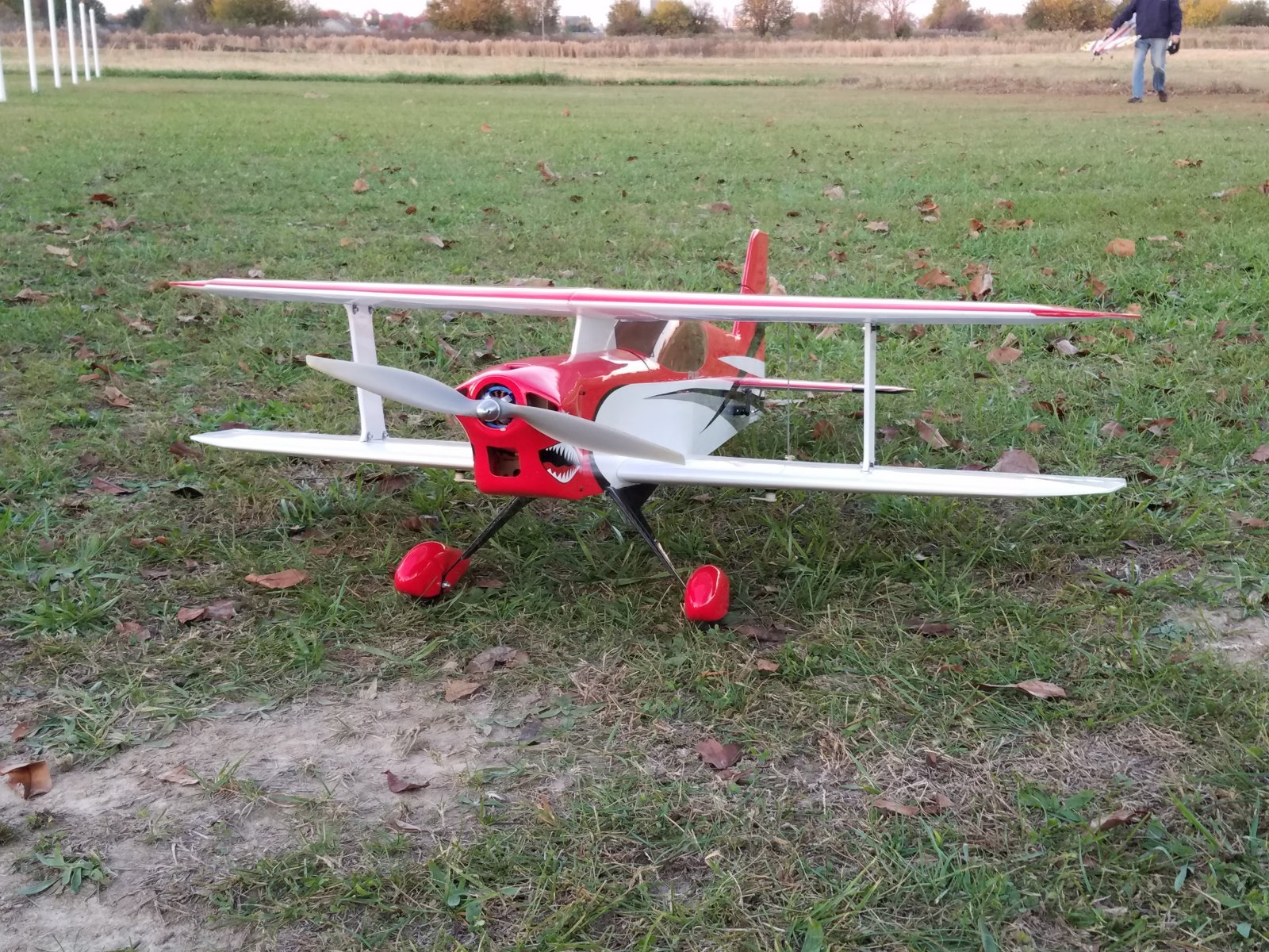

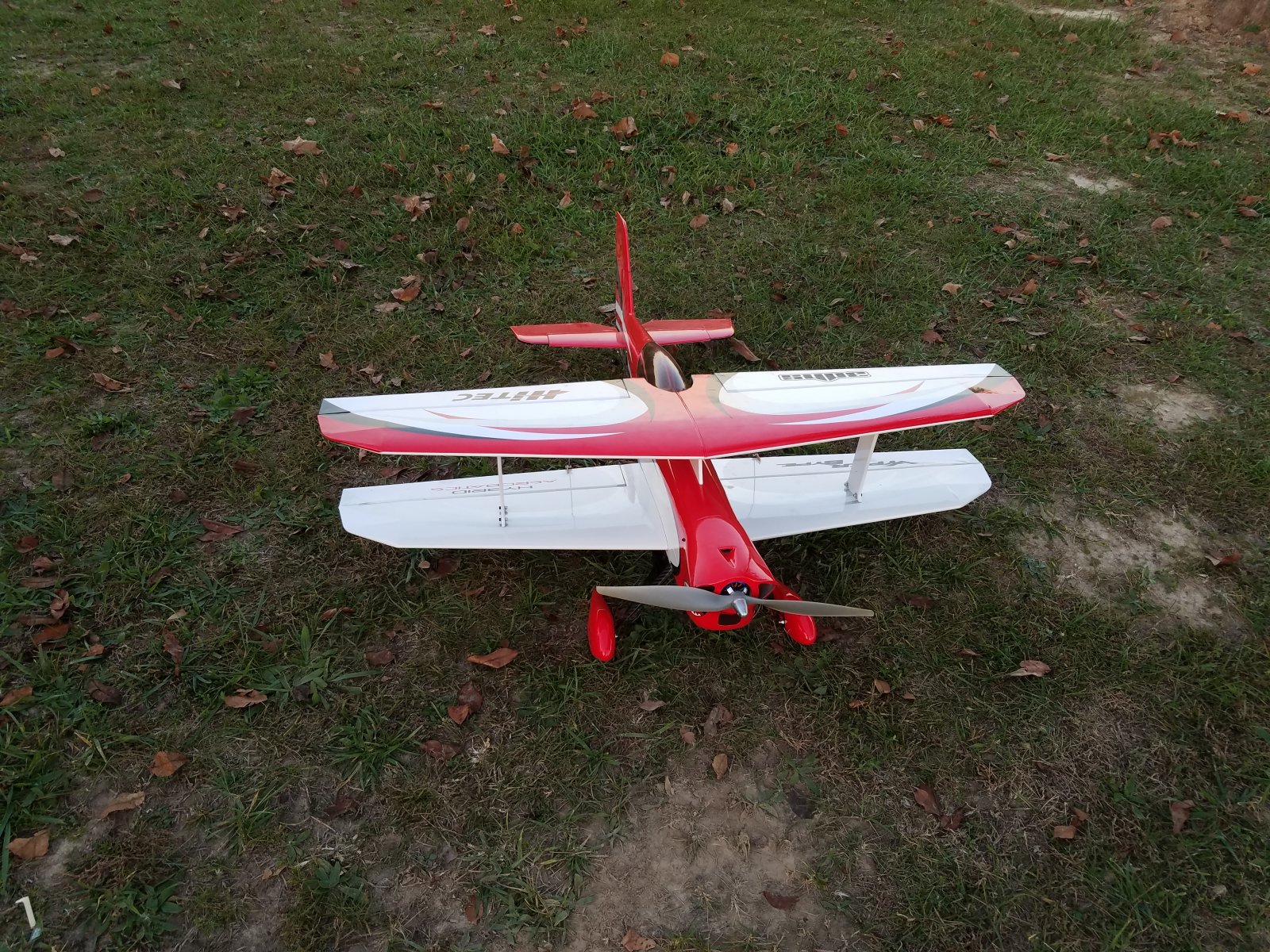

Took this new to me plane out today. Picked it up Saturday at a fun fly and put it in the air this afternoon :) The first flight was about as hair raising as they can get. I didn't bother to check the cg because I was using the same size batteries as the previous owner and had it where he had his batteries. BIG mistake. First time ever flying a biplane, new to me plane, very tail heavy made for an exciting first flight. I managed to get her back on the ground and shoved the battery another inch forward and took to the air again. Much better experience the next 3 flights :) Was greasing landings by the end of the afternoon. I believe there is a thrust issue with the plane though. When I let up on the throttle it climbs, a lot. When I go full throttle it dives to the ground. I can roll inverted at about half throttle and it will climb out on its own.

Sorry to see that the only thing I can say you have to time to fix it during the winter months.
