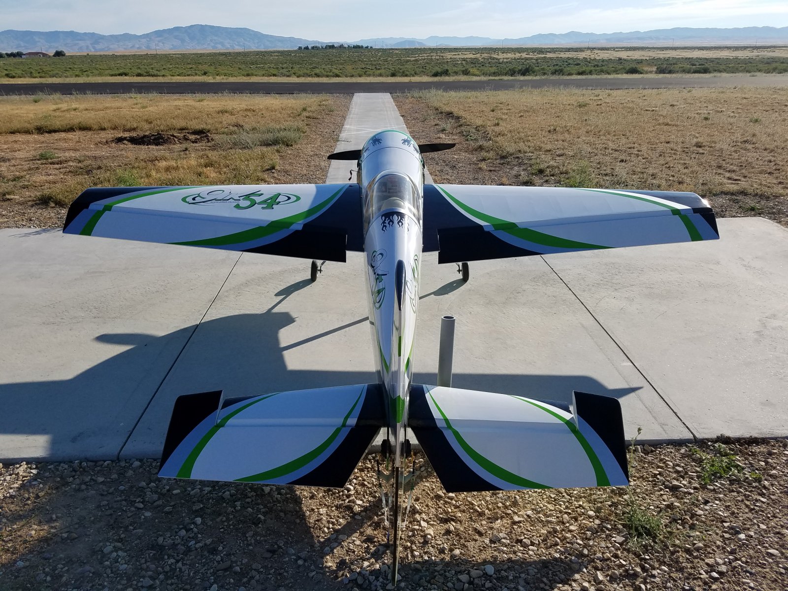

I went flying today. It was hot, but No Rain and No Wind! I took my scratch build "Miss Moana". The first flight was pretty good, even though it was running very rich. It must have been just on the borderline last week, when the humidity was ridiculously low and in today's nasty humidity it went rich. I checked the CG by doing a 45 degree inverted climb and when I got off the elevator it didn't drop off at all. I might have climbed a bit more. I guess I'm going to have to invest in some carbon fiber stab tubes to get some weight off the tail. The shortest piece I can buy in the size I need is 72" ouch, my wallet.

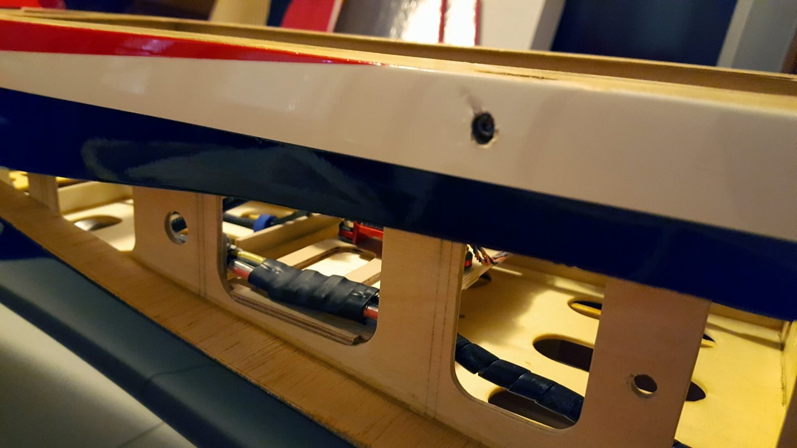

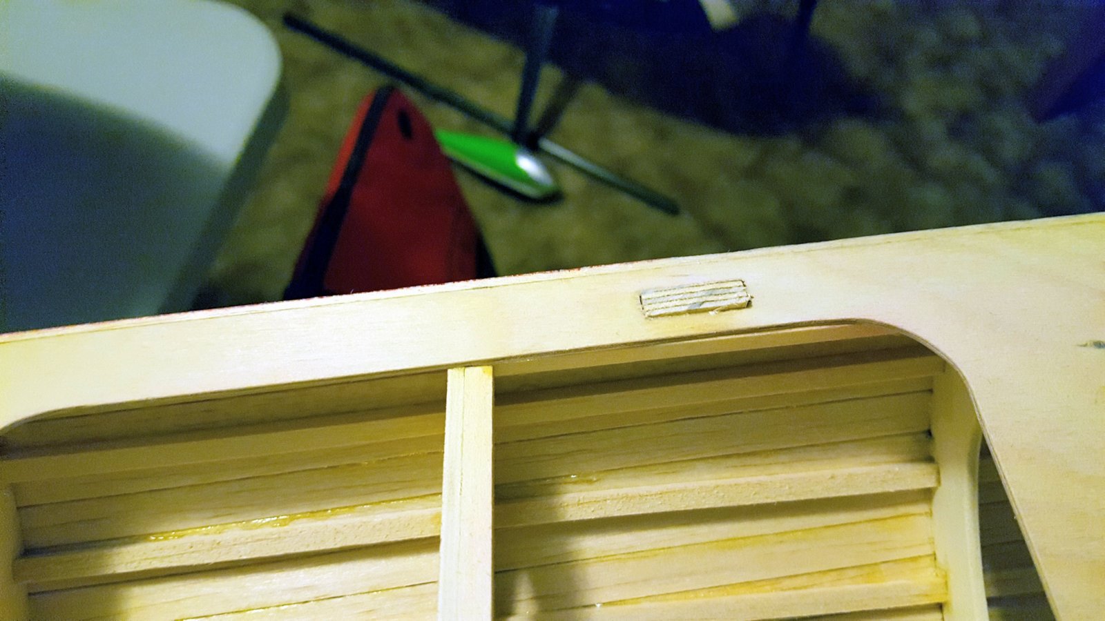

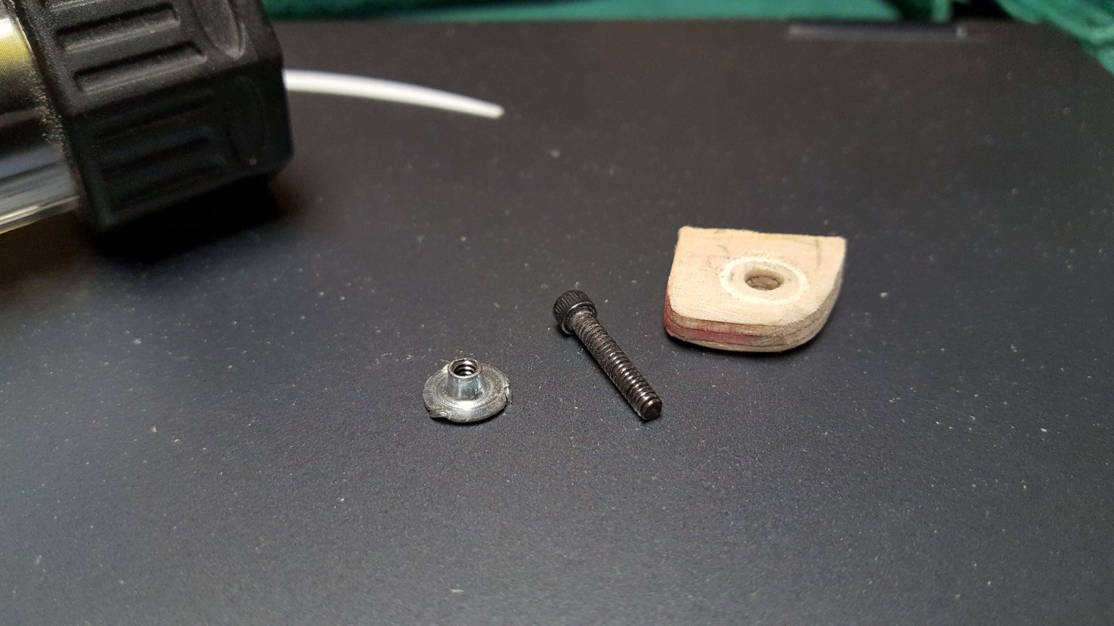

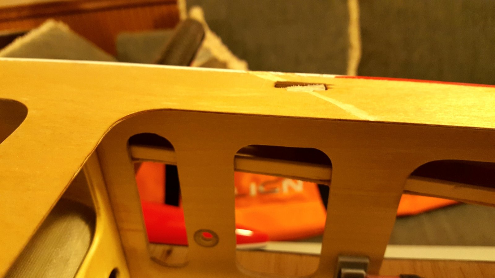

After landing I went to pull the hatch to let the pipe cool and check the fuel. On the third of four screws it turned several turns before I heard a "POP" and the screw went back into the hole. We worked on it for over an hour and couldn't get it out. I ended up borrowing a hack saw blade from a guy and I was able to get the hatch just high enough to cut off the tab and get the hatch off.
When I got it home, I finally did get the screw out, but even with being able to get to the back side now that the hatch was off, it fought me the whole way. The threads on both the screw and the nut don't look bad, but they're definitely screwed up.
Well I guess that's what I get for being an idiot and not epoxying them in.
