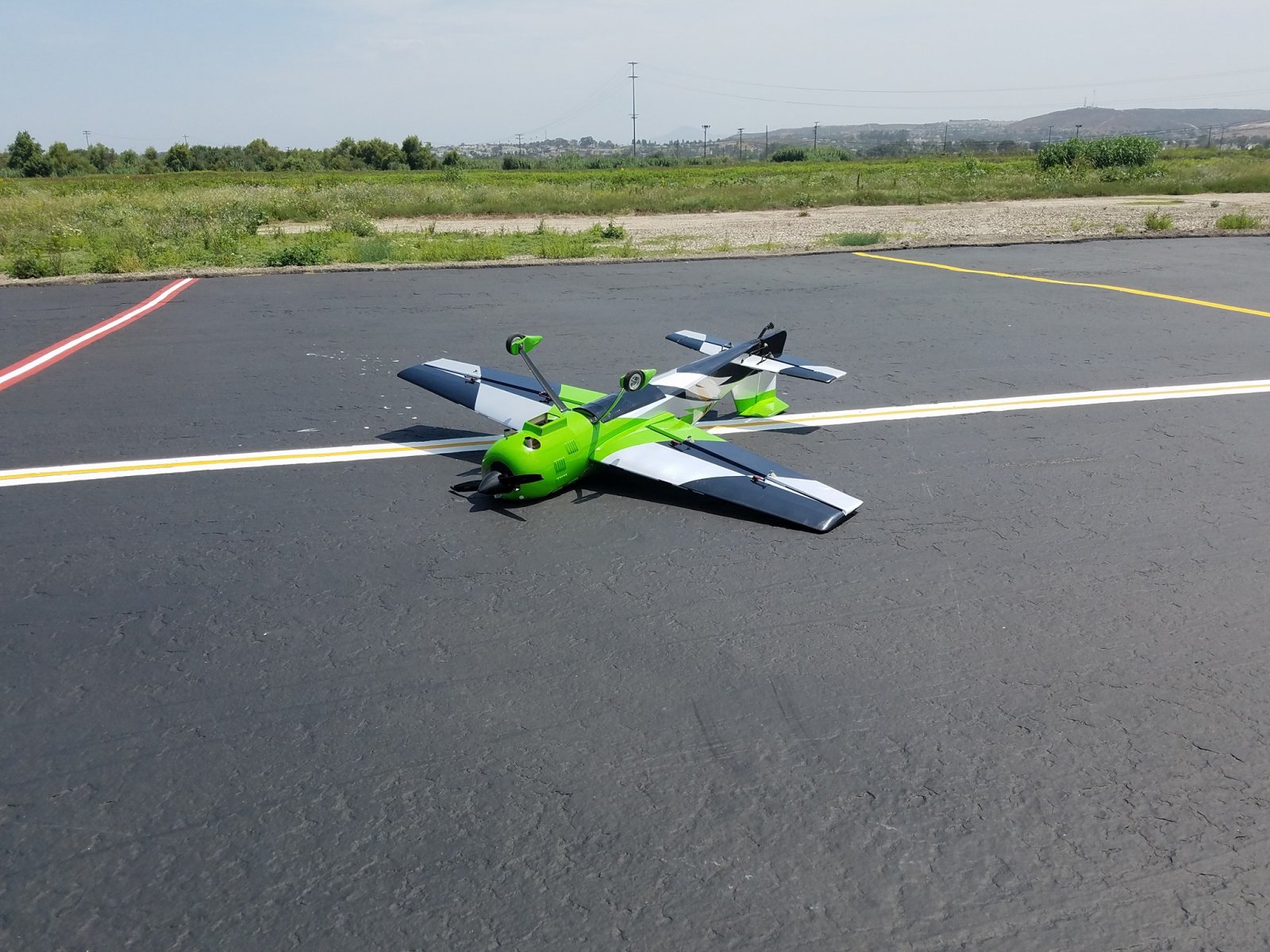

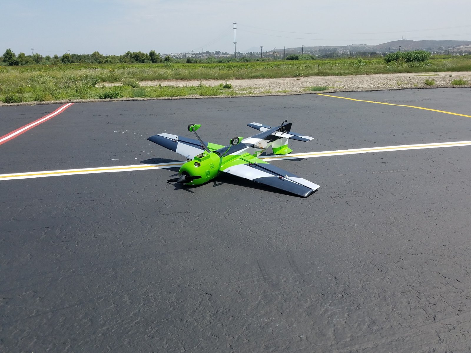

    Well I threatened to send the DA120 from my Yak into DA last weekend, guess it decided it wanted to be sent in all its own :rolleyes:o_O
    19942625_10214472279547700_772098721650150859_o.jpg 19944396_10214472280347720_3485013747047660523_o.jpg
    Looks like the gasket on one of the cylinders was leaking slightly, I don't know for how long but it's possible that's causing some power loss. Didn't break anything as far as I can tell, HOPING it's just a new hub and front bearing at the most to fix it.
    The fun starts at 3:25:
    You can hear the engine throttle back at the bottom of the waterfall. Oh well, few hundred bucks in parts and it'll be good as new-ish again.
    Total damages:
    1x cowl
    1x canopy/hatch
    1x rudder
    1x Falcon 27x11
    Decided I'm going to try the Falcon 28x9.5 prop on this airplane too. It spools faster than the 27x11 and gives more low end bite, which is what I prefer. Already ordered the propeller :)

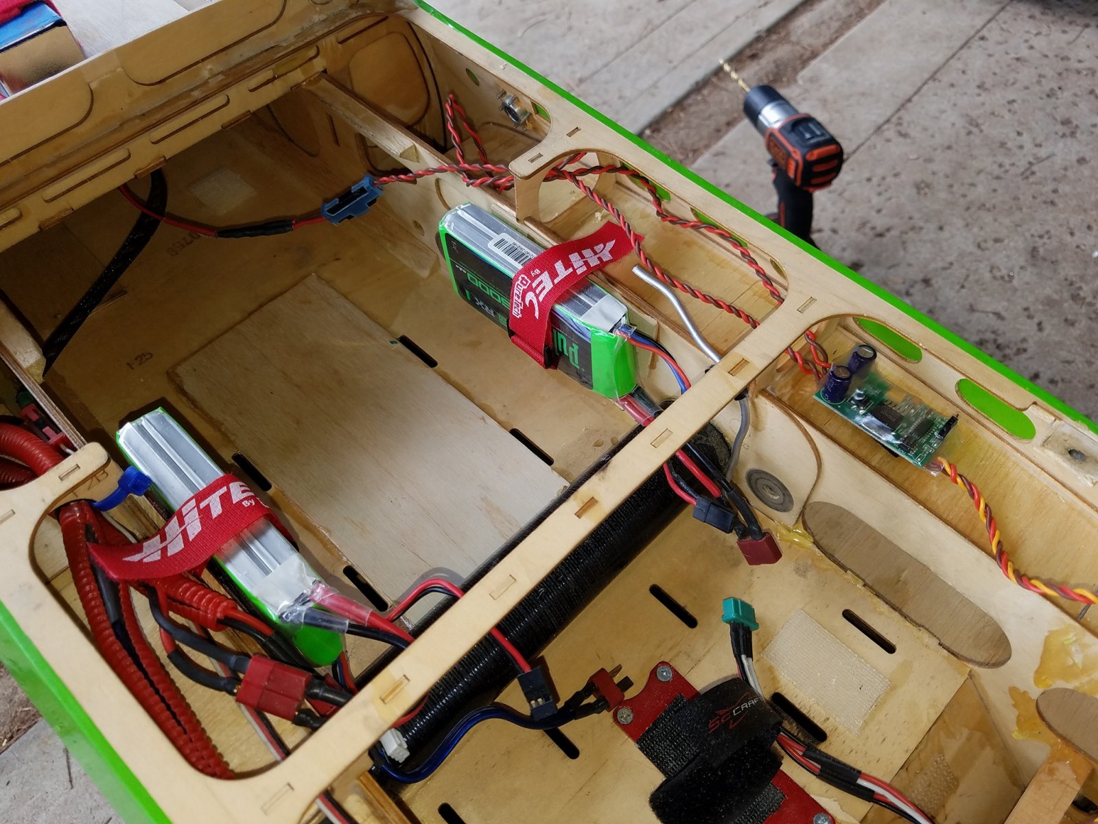

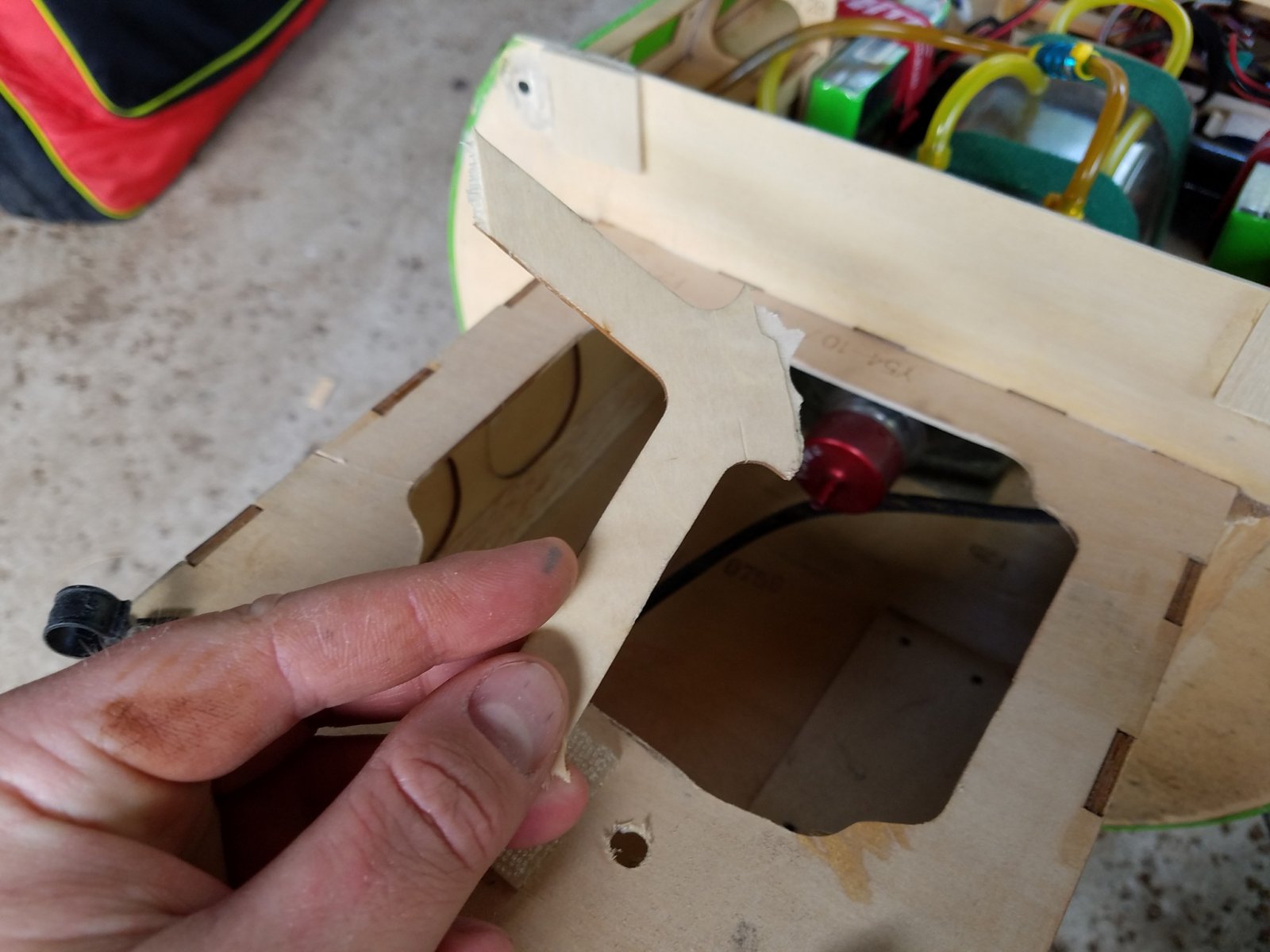

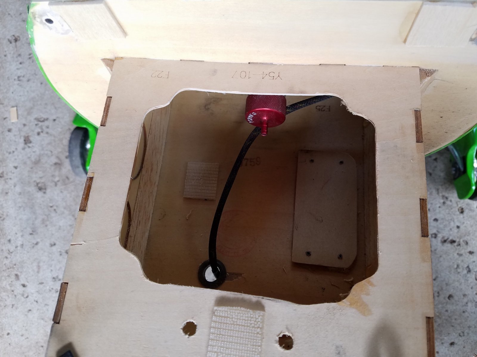

    Since I didn't have an airplane to fly today I got to work on the Yak. Anybody that knows these Pilot airplanes knows that the top of the motor box usually has an "X" pattern, after years of abuse it finally gave out so I decided to cut it out and dremel it smooth. You can also see that I just cut off the top of the smashed F1 former, the area I cut serves as absolutely no structural support for anything so there isn't any point in keeping it. When the airplane is assembled you won't notice anything. The holes that secure the cowling and the canopy hatch pins are all elongated so I am going to fill them in and glue in new supports.
    All dremeled smooth again.

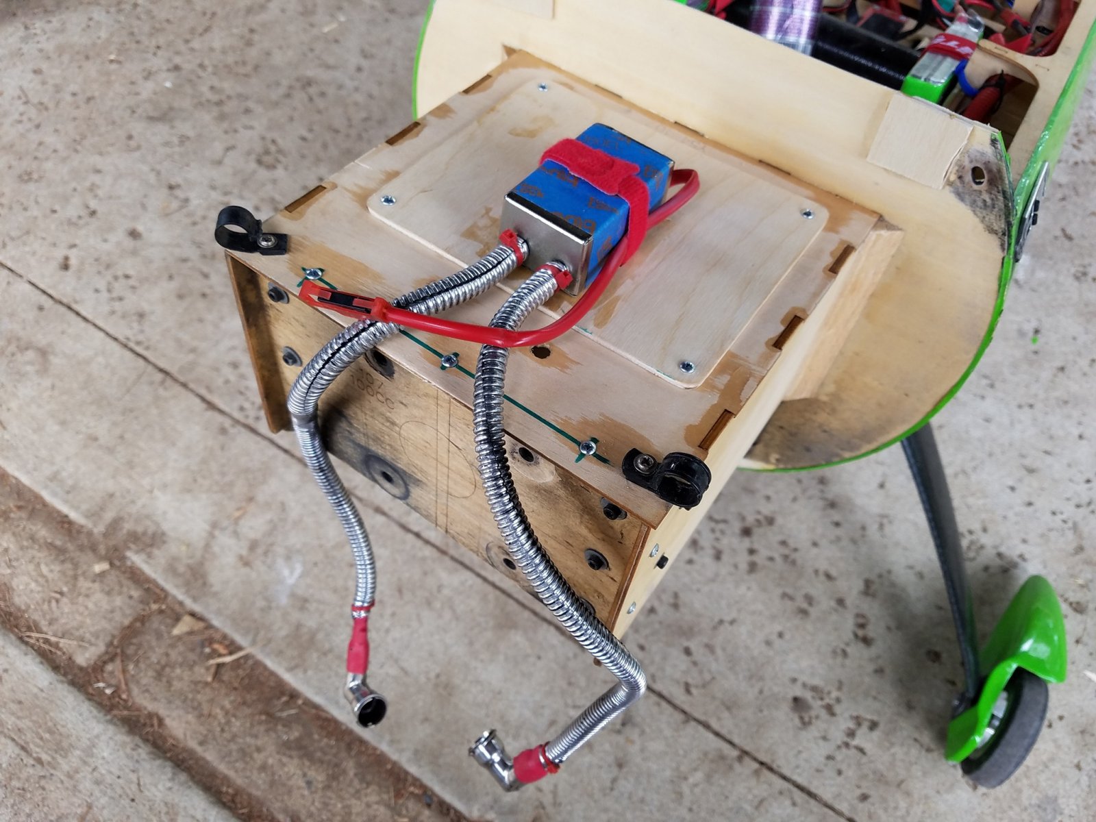

    I also made a new hatch for this area, and mounted the ignition to it.
    The ignition was originally mounted just in front of the hatch.

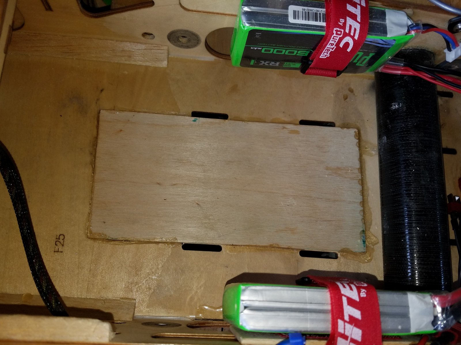

    In the crash the plywood floor securing the tank pulled up at the cutout slots, so I glued in a new piece of 1/8" ply to strengthen the area up.
    I also removed the Fromeco Badger switch and Sahara regulator for the ignition and instead replaced them with a Tech Aero IBEC I had on hand. The red battery tray pictured above was also removed right after I took the picture. So overall I added some weight, but removed more weight. Aside from the SWB dual rudder tray, there's not much else I can remove to lighten this airplane up.
