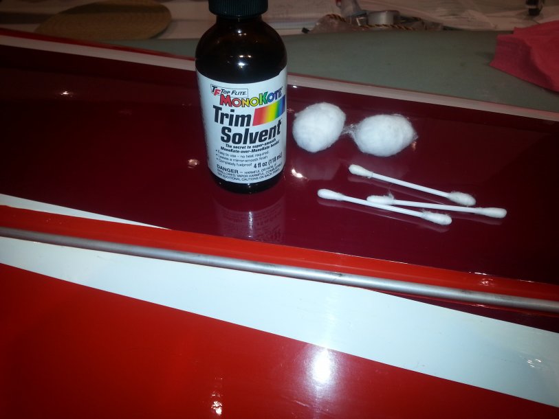

The clear I seal edges with is Nason 496-00 with a touch of Nason 483-78 activator. DuPont 7600 clear is good too. just much more costly. Really any good automotive clear will work ,and it is a bit more flexible when dried than clear fingernail polish. I use it on some covering edges and also on the edges of some graphics.
The trim solvent is formulated for monokote, it does not work well with ultracote.
I was told from a well known builder to use polyurethane to seal the edges on Ultracote. I did on my Sukhoi and it seems to blend in very well and dried. Havent flown the plane yet but it looks like it will work very well.

Marvellous stuff for monokote. But were talking Ultra.
What happens when used with ultracote?
