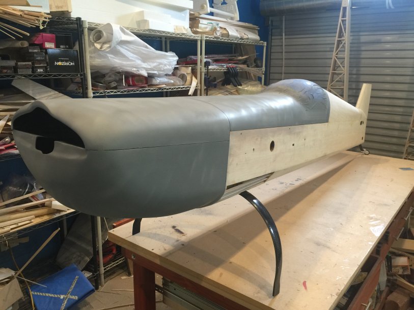

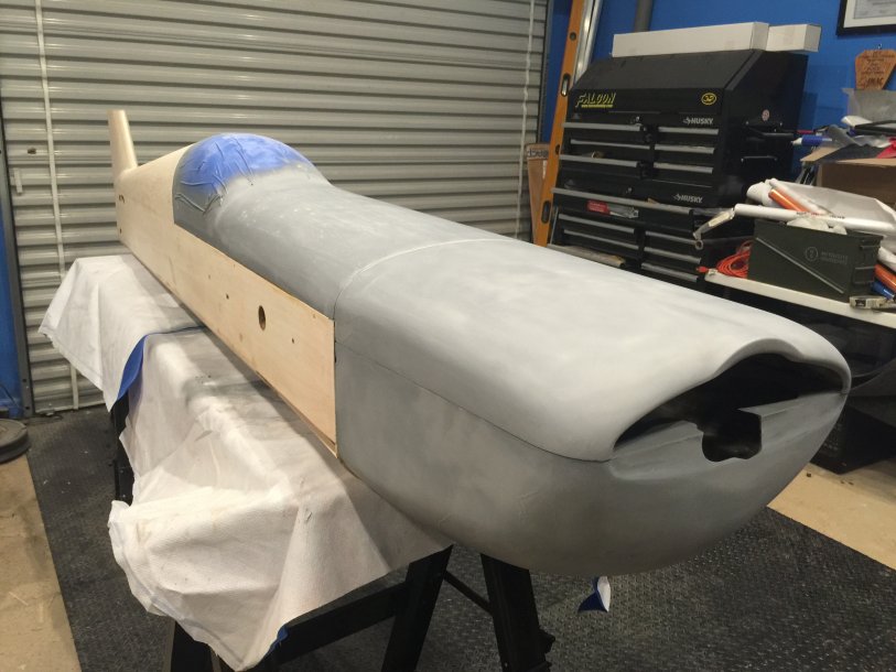

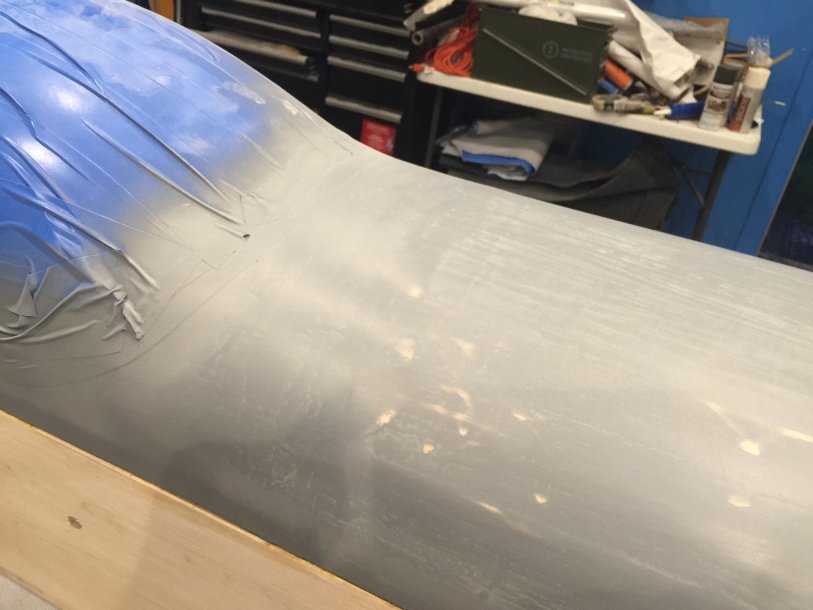

Well, this is after the 1st coat of the epoxy primer, and before sanding it. I installed it on the fuselage so I could see how it is coming together.

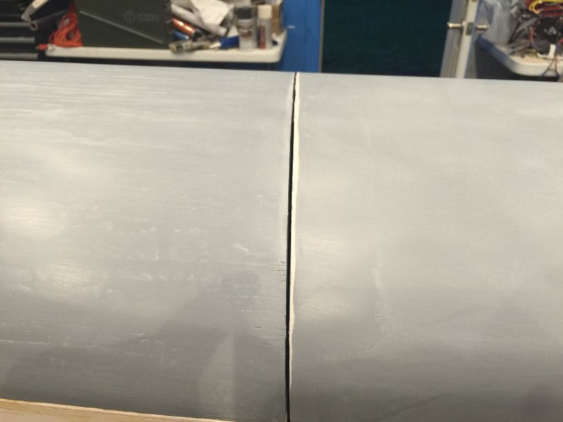

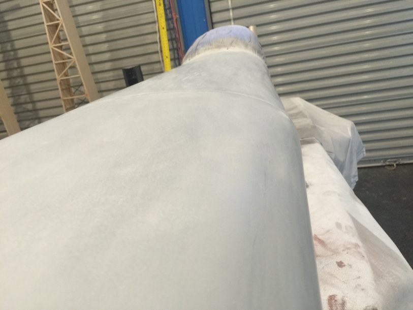

then I did a bit of sanding, and you all can now see the gap, which if I pass my hand over it with eyes closed, I cannot ascertain a step off.
I was also impressed at how well this sanded, and it was dry in 1 hour, to where I could sand it.
I was also inspecting the junction between the canopy and the hatch, and it is not apparent, so the prep work paid off.

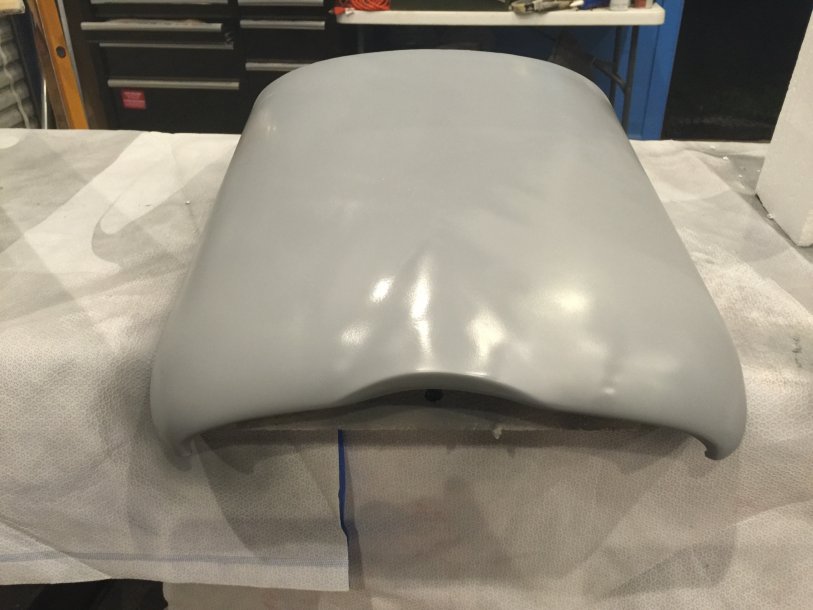

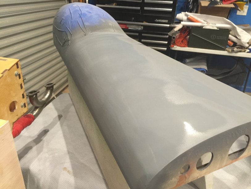

I sanded it down to 600, and then applied a second coat of epoxy primer. I will wait til tomorrow morning, and then apply glaring putty to anywhere that needs it, and then I will sand again, using wet 600, and til i get a very smooth surface, then I will apply a 3rd coat.
these are the pictures after applying the 2nd coat of epoxy primer...
little bit more done this morning.
this is a painstaking process, as it is mostly prep work, and the more time you put in it to your satisfaction, then the better the end result, yet, I am still not happy!

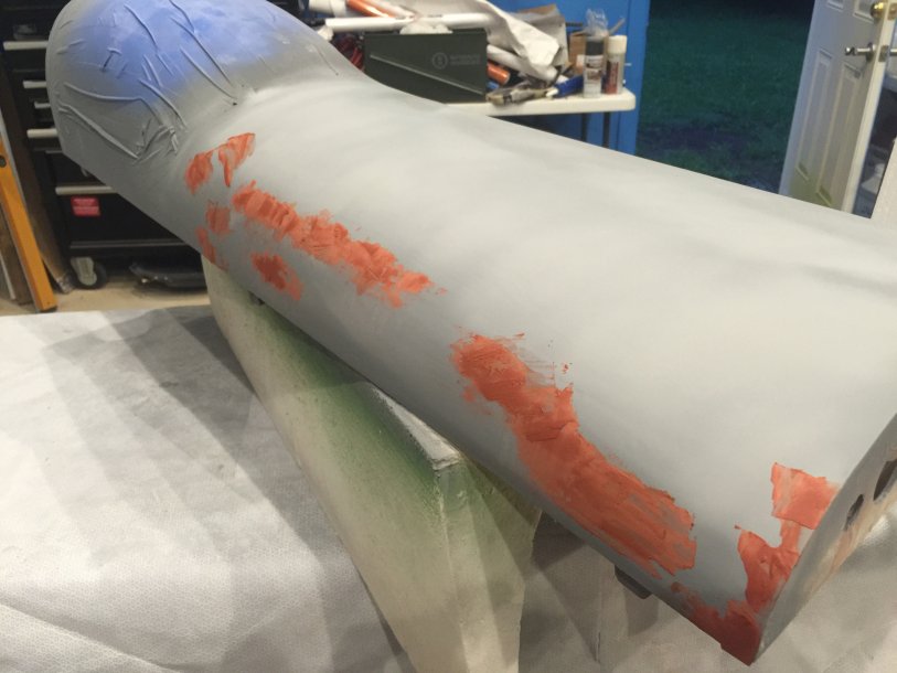

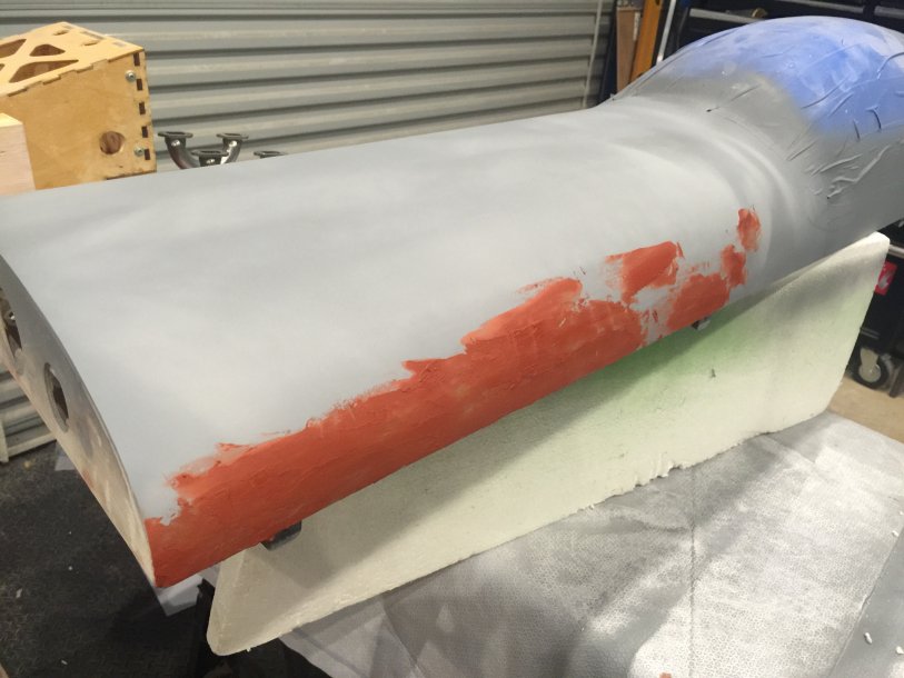

I applied GLAZING putty to multiple areas....
I have since, sanded this down, but still needs more work. There are just very very small areas that need filling.

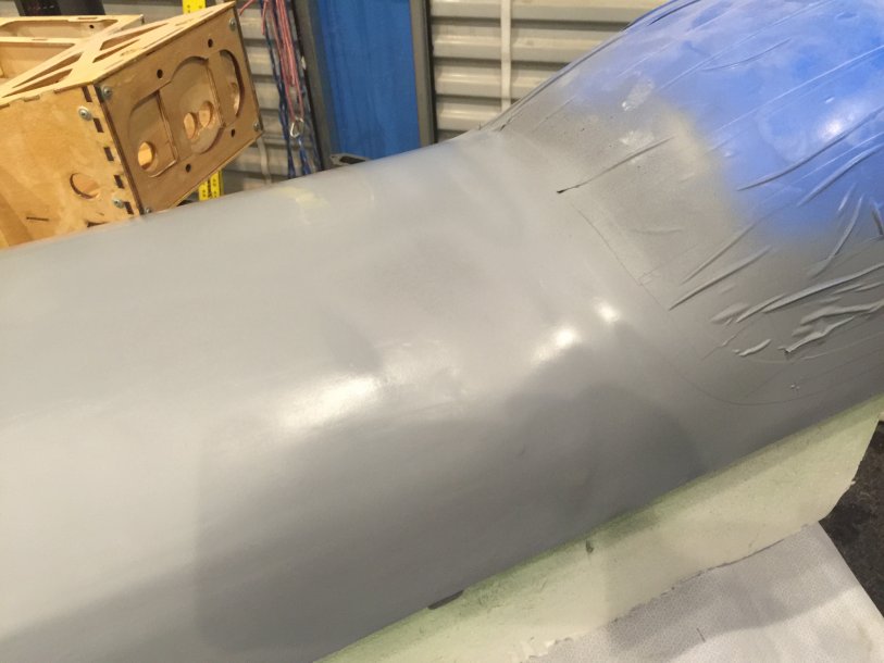

here is a view of the junction of the cowl with the canopy. I am happy with this. Came out good. Now, just working on surface minor defects, real small. I think most may say, hey, that is nothing!

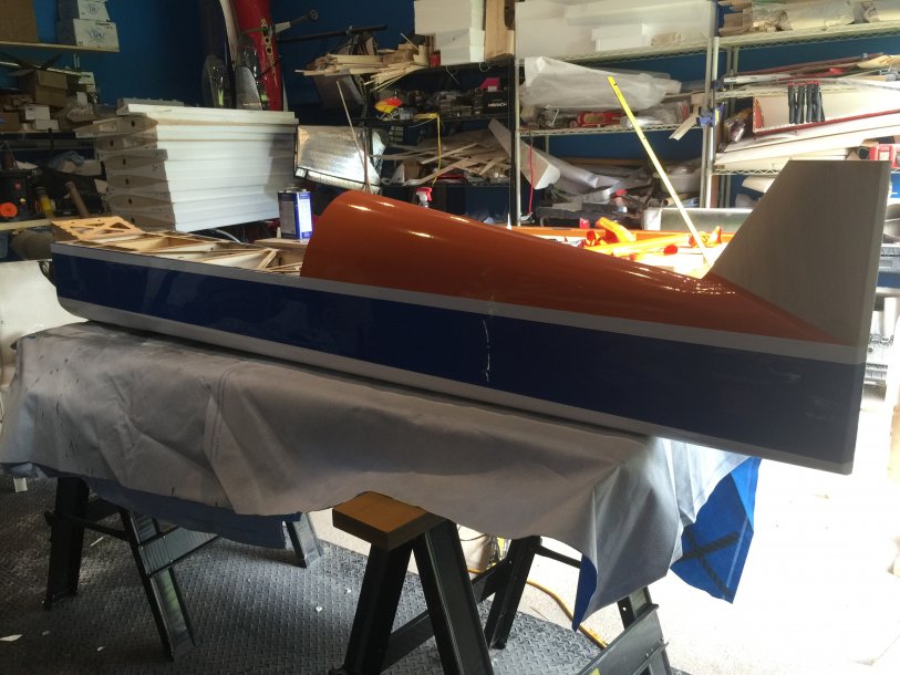

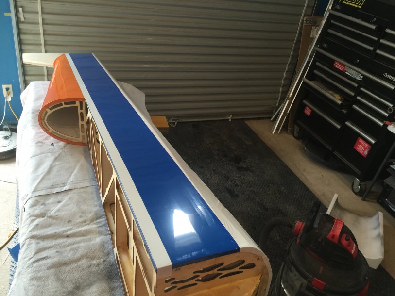

well, began to lay the white on the bottom, and the iron pooped out on me. Luckily, HobbyTown was open, and I was able to obtain a new iron. (which was free, someone at work gave me a 200 dollar gift card for hobby town).
I started in the bottom, white down 1st, then the blue, then the orange. Additionally, I applied the 1" wide white stripe, on the left side, tomorrow, I will do the right side, then finish the fuselage off.
I have to go to "ENGLISH PAINT", local car paint store, and have them match the orange and the blue. Once I get that paint, then I can do the cowl and canopy.
all the covering is single piece full length from nose to tail.
