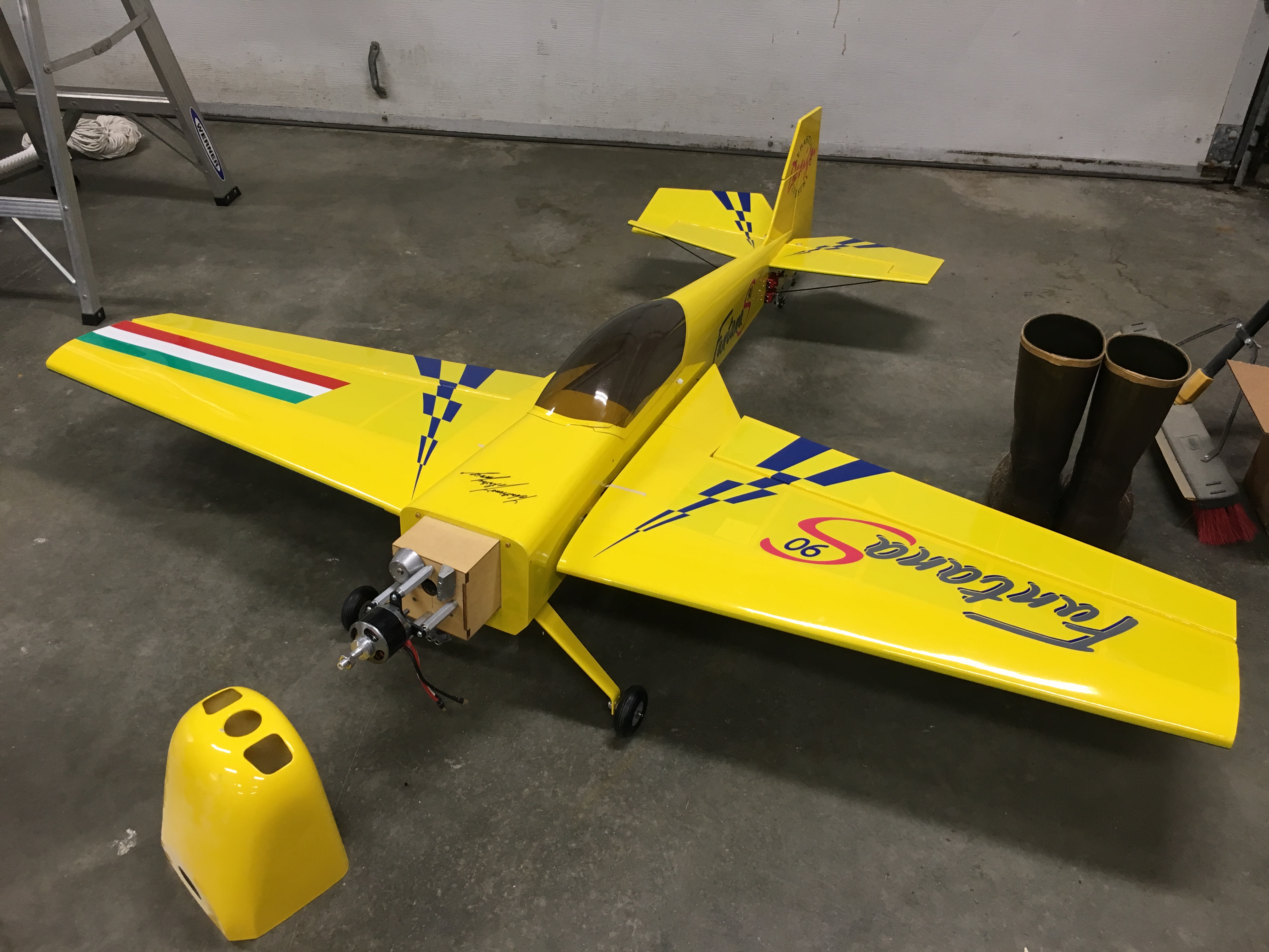

Been putting together a Funtana 90S for a buddy in between working on the DHC-2. Coming out super tail heavy. So I added .4lbs to the nose.... eeeekkk!!!
Not only that but the covering was old,peeling off, Hangar rash like a cat got it, cracked canopy... missing parts!!! Lions tigers a bears oh my!!!
Getting close!

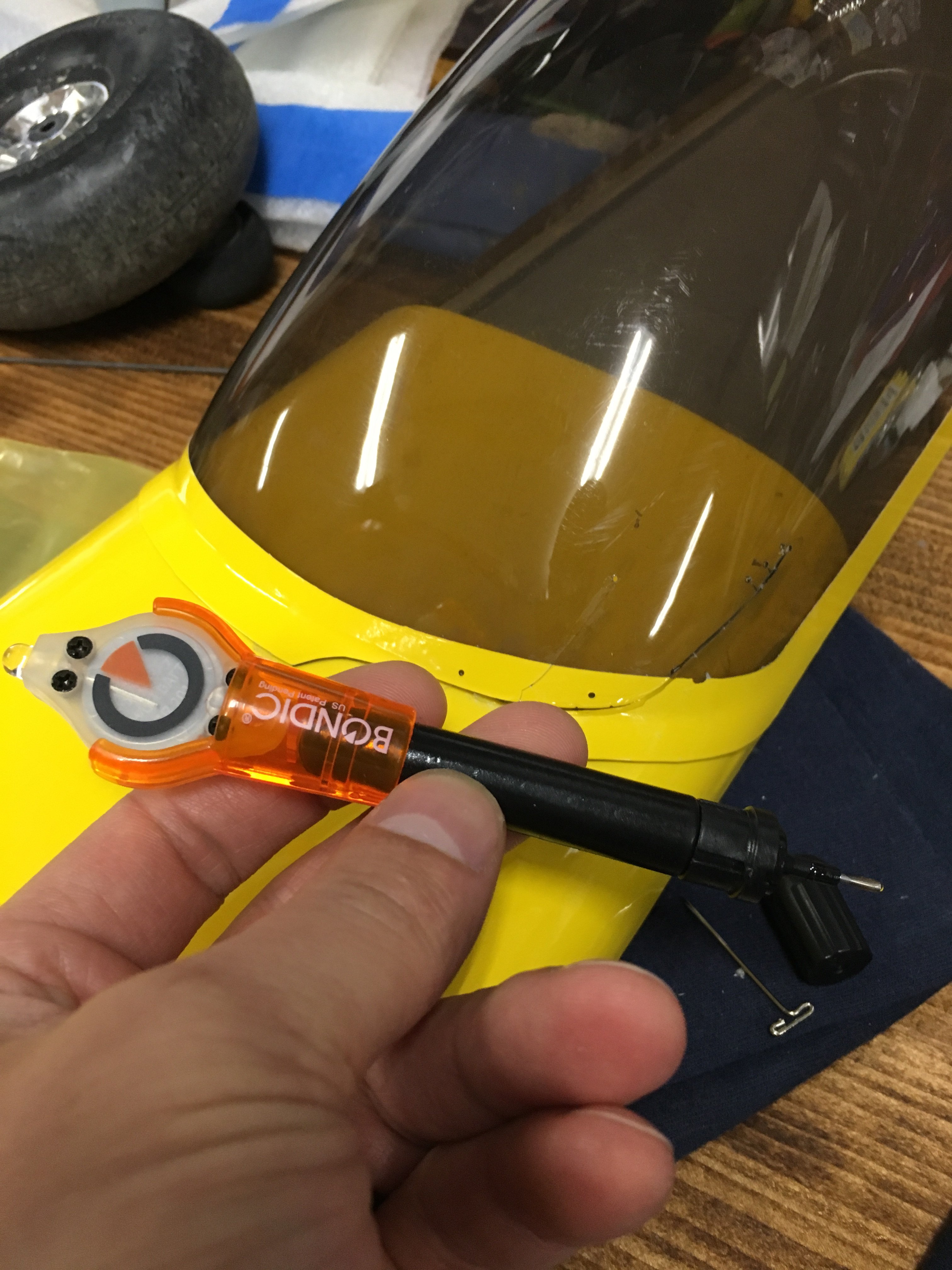

Also for the canopy cracks I used formula 560.... but then I thought hmmmm what about UV glue to fill in the gaps... So I tried it. Seems tuff and is holding!!

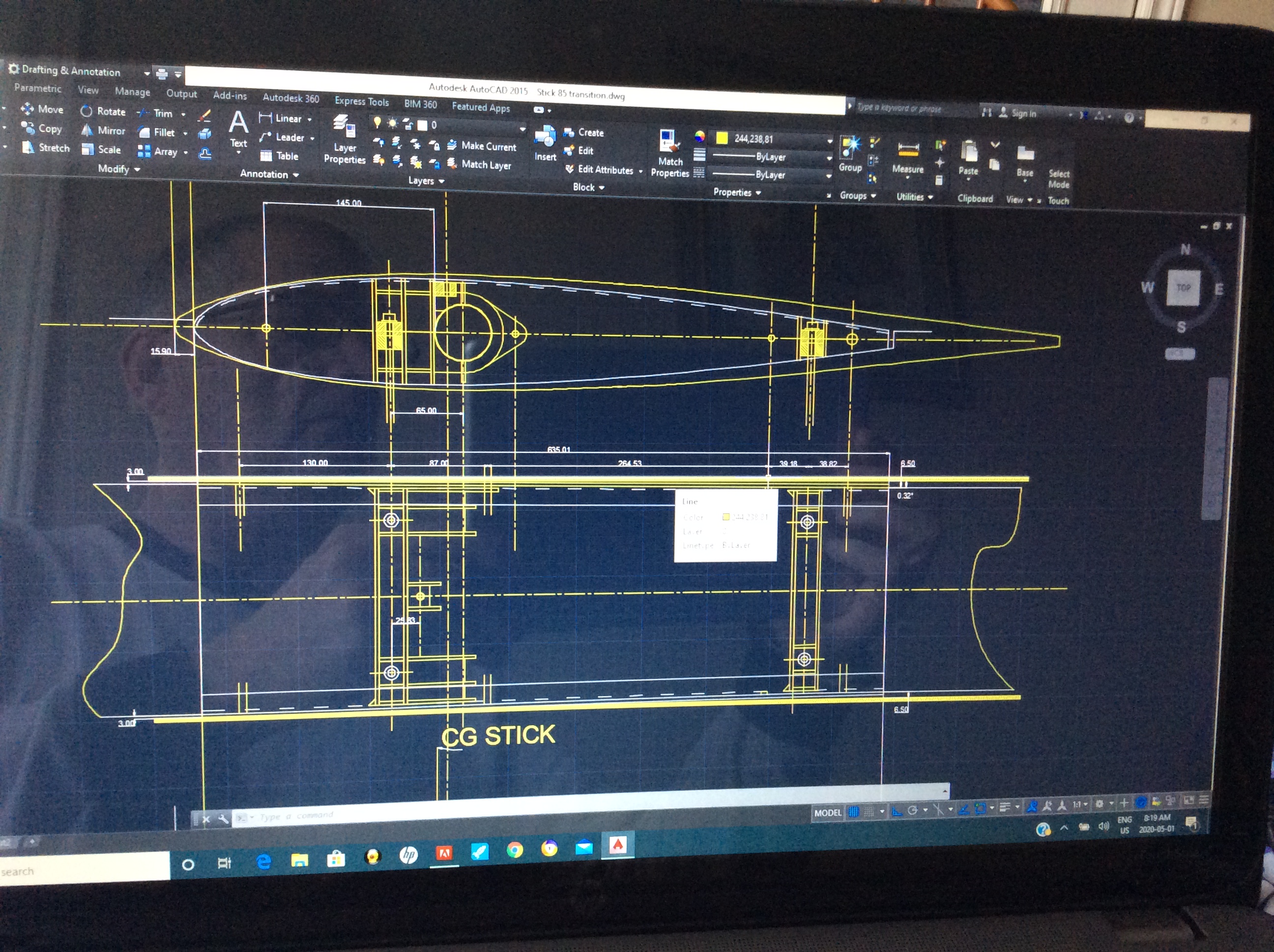

The wings have been repaired just need final sanding and cleaned up then the two wings will be ready for covering. Had to buy 6 six rolls of covering just to cover the two wings they are huge at 3100 square inches.
All AutoCAD work is done to blend the new and old wing together and designed a new centre section to pick up the four hold down bolts. Changing a plane from 1 1/2 tube to a 2 inch tube really causes some difficulties and also moved CG back 20 mm on the new setup hopefully to change the tail heavy situation. Time will tell if I can move all the batteries back of the firewall a bit.

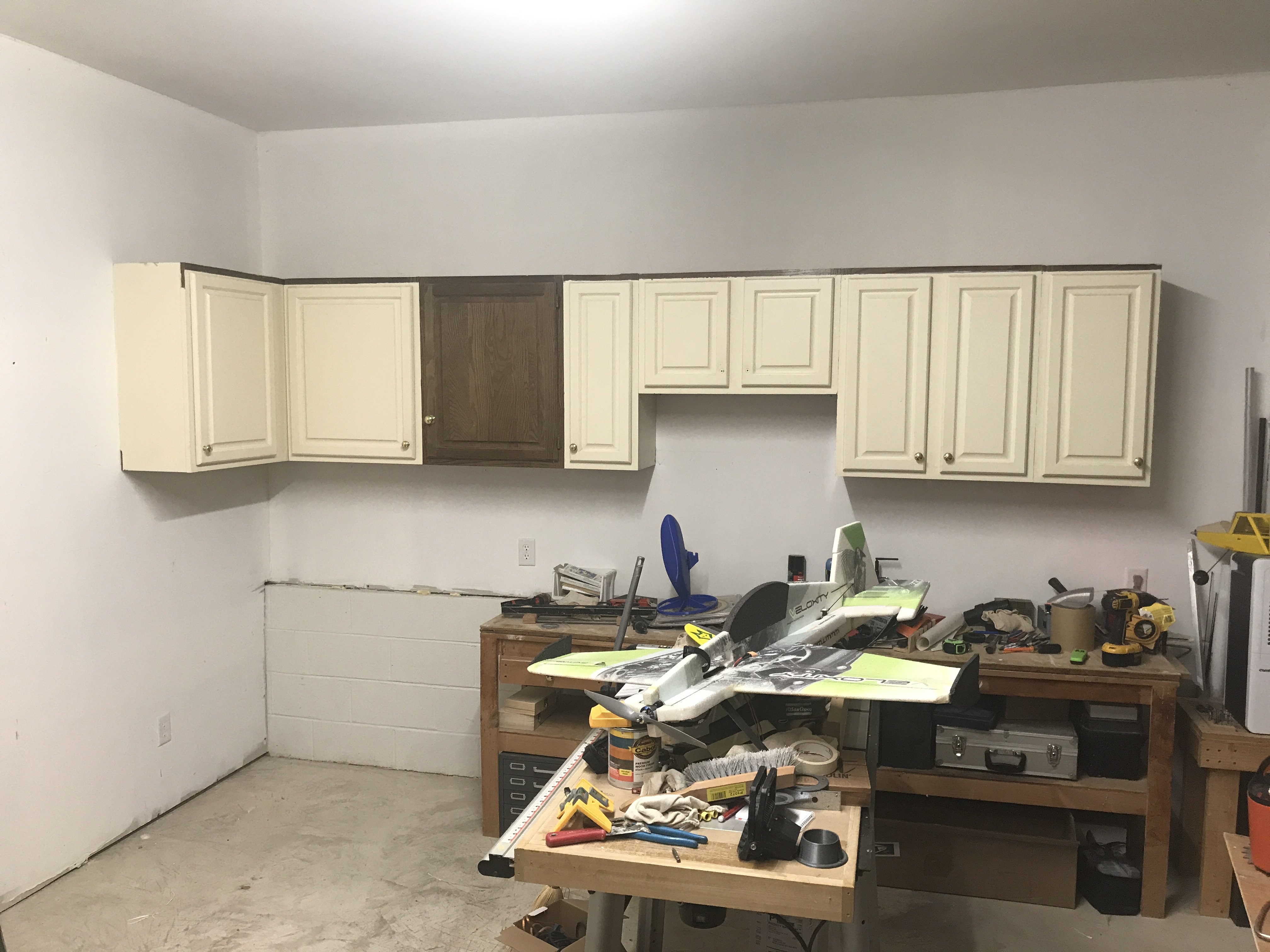

Got the rest of the upper cabinets up in my shop today. Now time to load them up and get ready to move the lowers in and set it up as a miter saw station. View attachment 114525
Looking good. Nice to see that velox front and center. :) I've been putting in some serious foamy time lately. Some new neighbor kids are my audience. They'll put their heads on the fence and watch me fly around. Pretty fun to see them awe inspired.
Honestly I have barely ever flown the plane. It was giving to me by a flying buddy when he moved from VA to Alaska but it needs new wing servos. He had cartwheeled it and stripped the gears in on aileron servo. I pulled them and put just some regular 9 grams in it as I had some on hand but they aren't strong enough to really throw the plane around.
