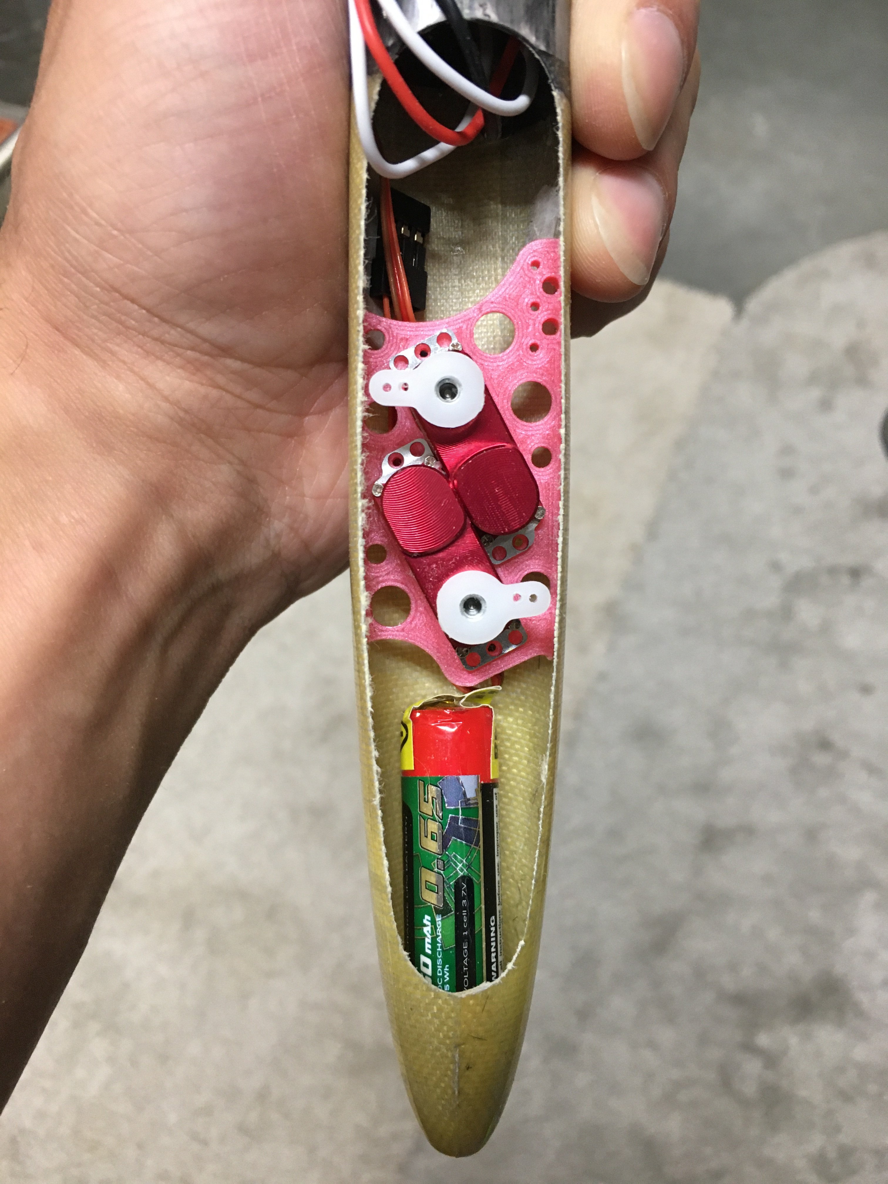

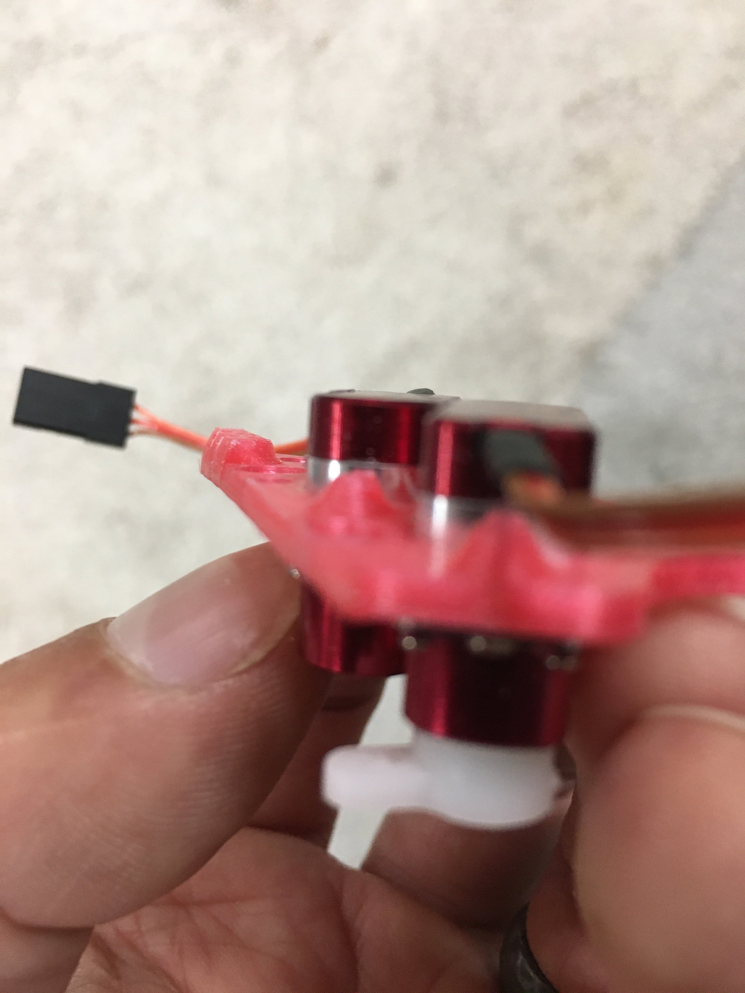

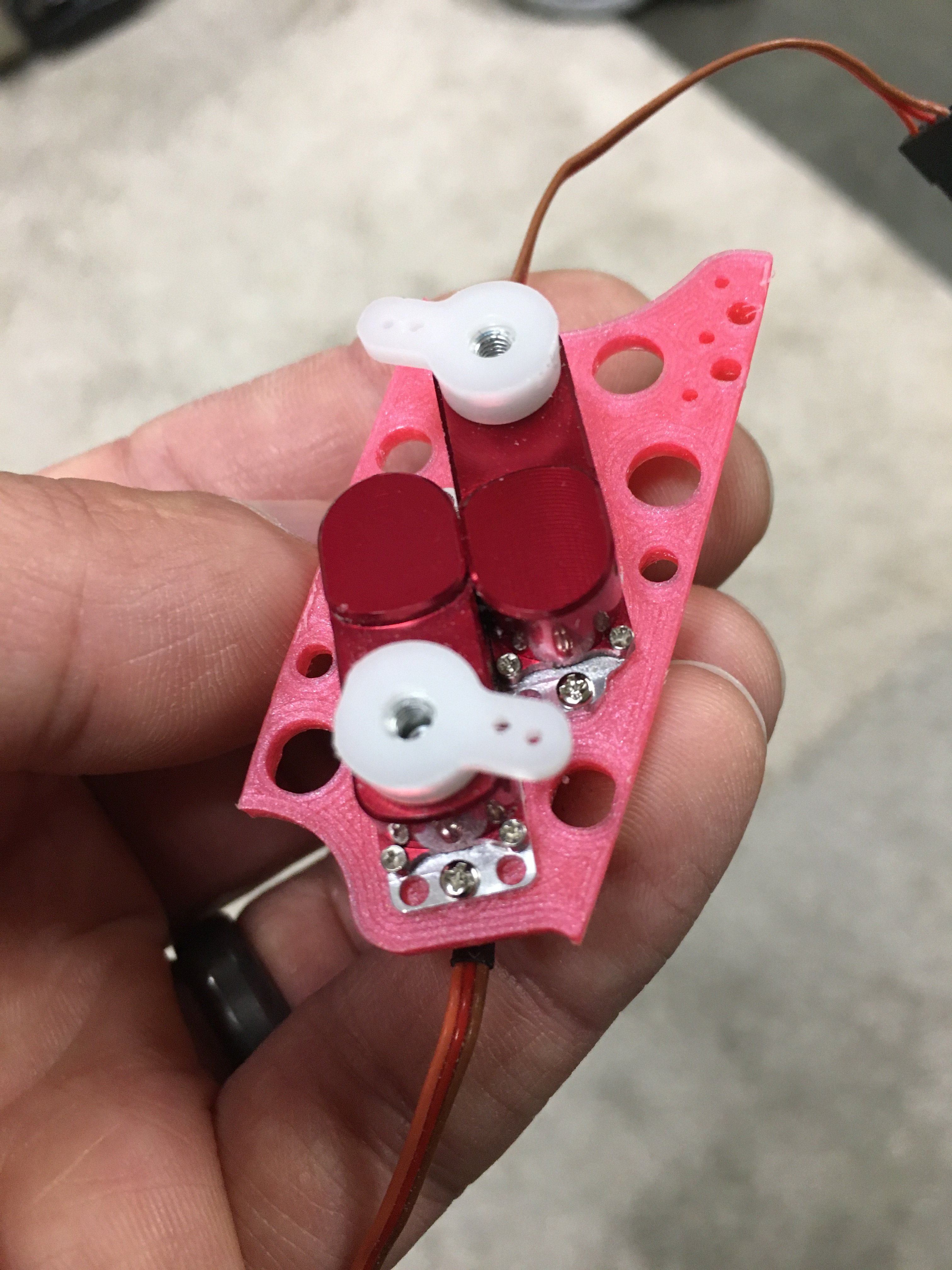

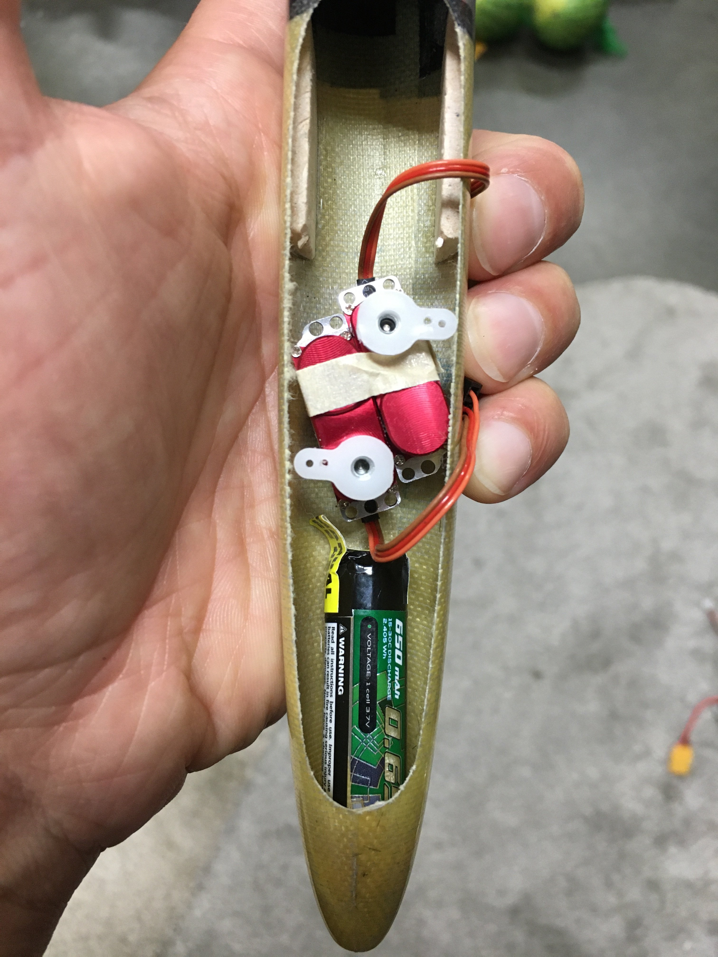

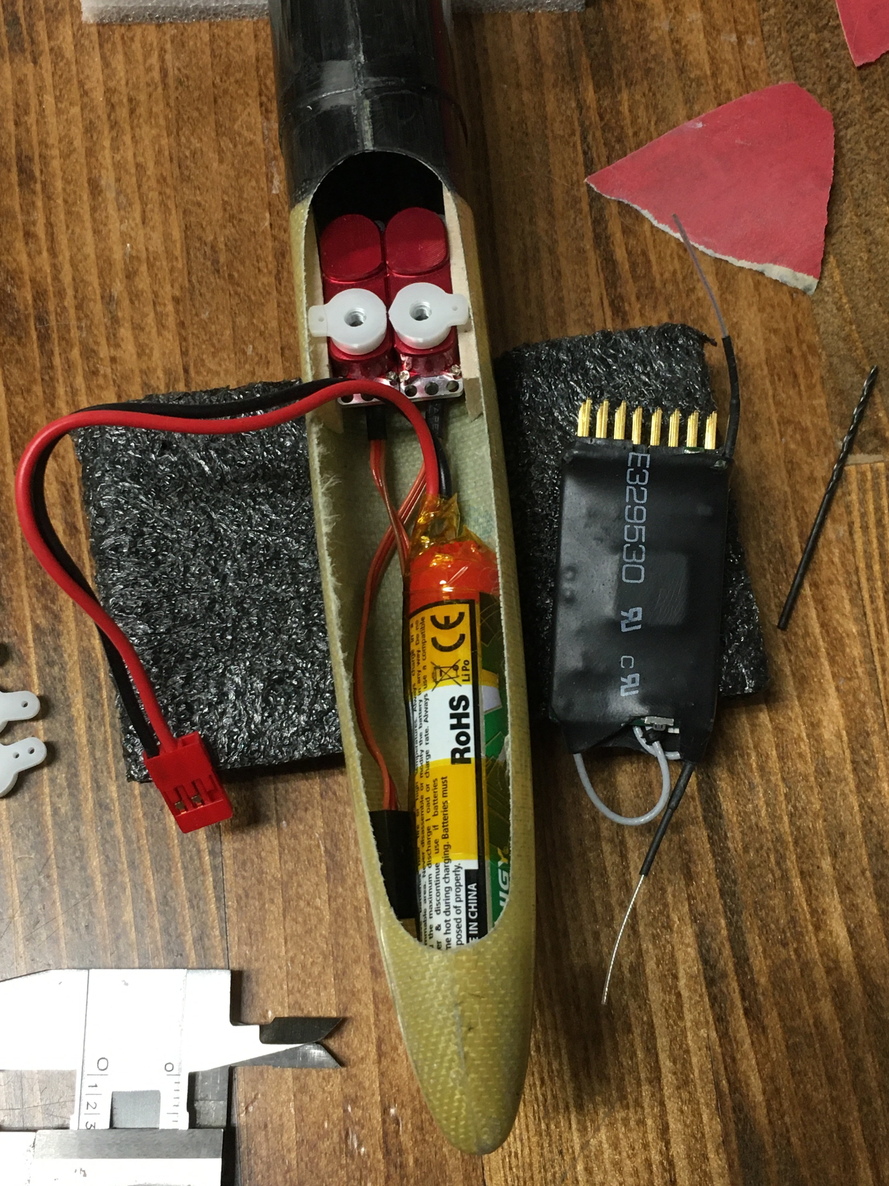

I think I’d rather use tungsten putty than that 1k LiPo so I can get the throws. Measured 8mm total throws at 140% travel from the servo arm verses 6mm at 100%. With the arm being a tad shorter than the control rod I don’t think I’d even get optimal throws. More reading I’ve found that more people prefer all you can get on the elevator for pushing over at the top and up for snap flaps. Man these simple dlgs are more complicated than I thought!!
Here are my two options and I think I’m going with the canted servos now. I’ll just need to be a bit more careful with my battery usage and swap them out. I’m finding with my mini dart a 20min flying session may only eat 30-40mAh tops.
View attachment 118187View attachment 118188
Tungsten is the way to go. Heavier than lead and takes up less space.

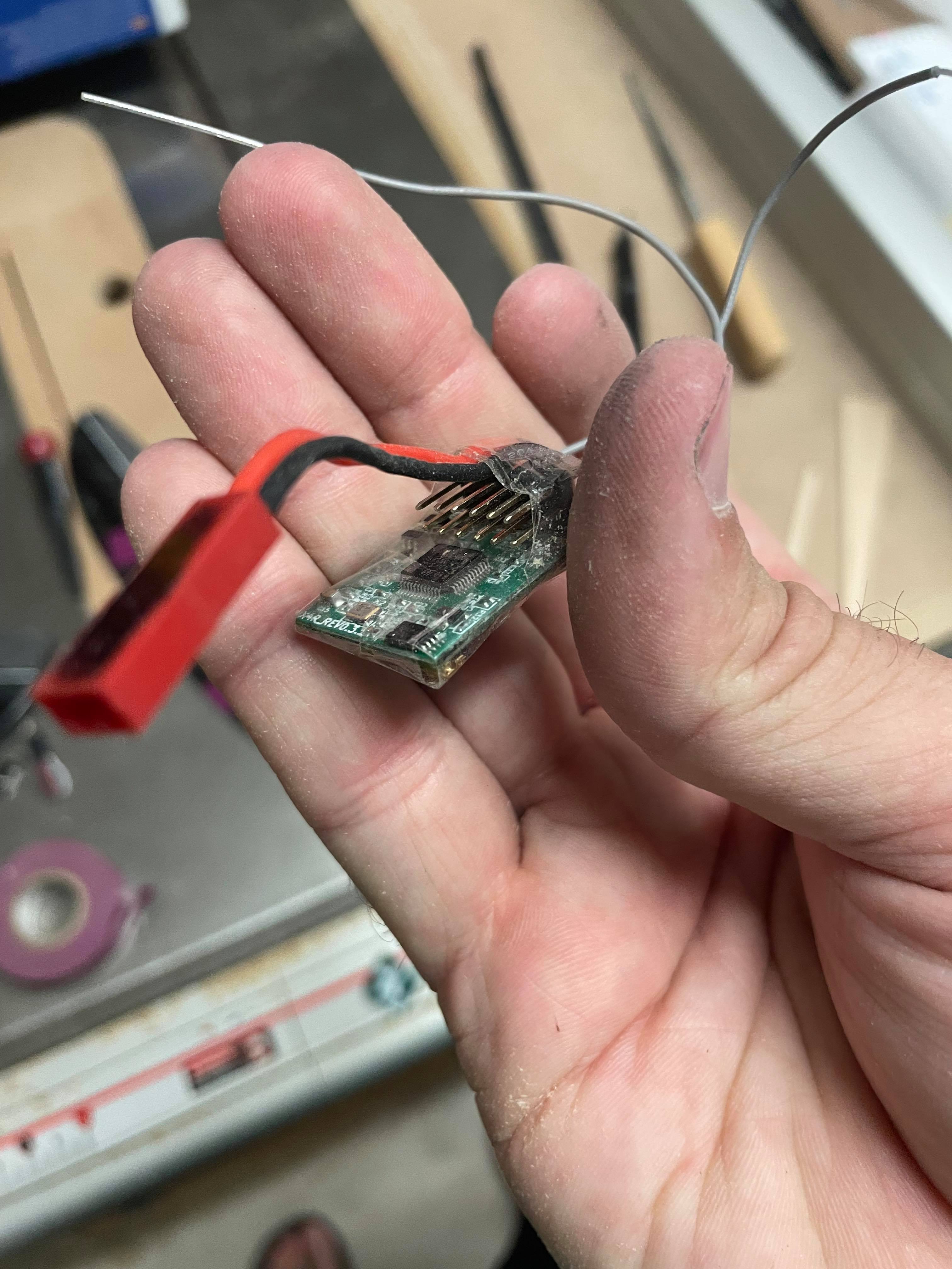

I like the angled setup. Would you like the model I drew up for my tray? Should be easy to modify to work with what looks like MKS 65's. My next piece of advice for you is loose the big RX. You can do everything with four channels including the battery hook up and save a ton of space. Pictured is the RX I run in mine. Its four channels I soldered the battery lead to the RX and literally to save even more space I de-soldered all the pins and turned them around to face over top of the RX.

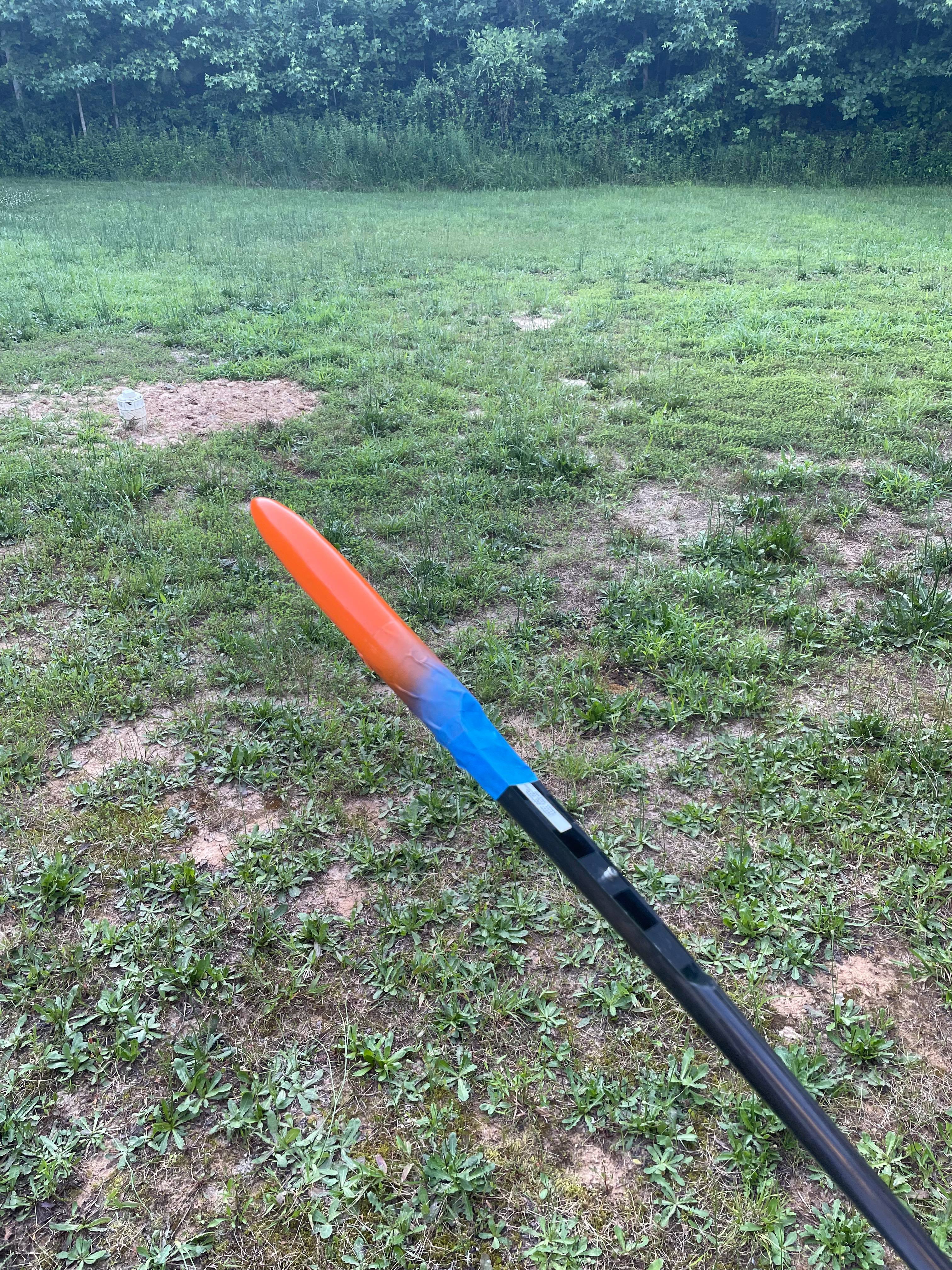

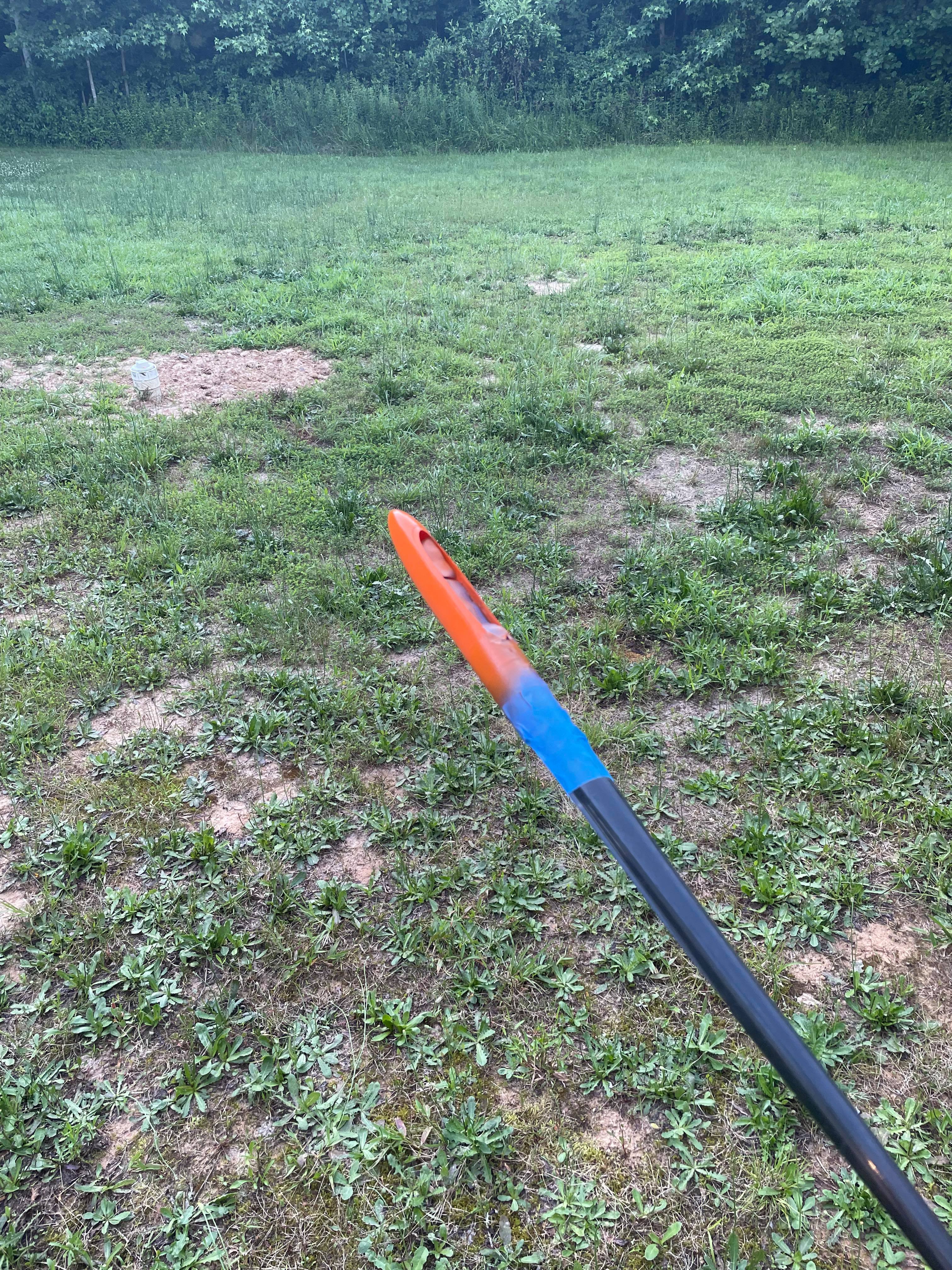

Decided I didn't like the look of the bare kevlar nose so I got the spray paint out. Orange shows well for me in the air. Ignore the tall grass its been to wet in my back yard for the mower the past couple of weeks.

Nice work on the RX, I thought about it as well. The constraint is the width of my receiver. unfortunately Futaba is lacking in small 4ch full range telemetry receivers that can operate on lower voltage. I really want to have the voltage telemetry on my 1S battery and I have a bunch of R7008SB receivers so I decided to use what I had. I will end up soldering the leads most likely as well. I did end up ordering some tungsten putty last night.
As far as the tray goes, the MKS75K (not 65) are a bit wider than the KSTs at 9mm, so the offset is slightly different. I've never manipulated another file before so it may be easier to sketch it up myself given the F2 has a smaller pod. I also learned that the F2 has a shorter nose and tail than the original Flitz.

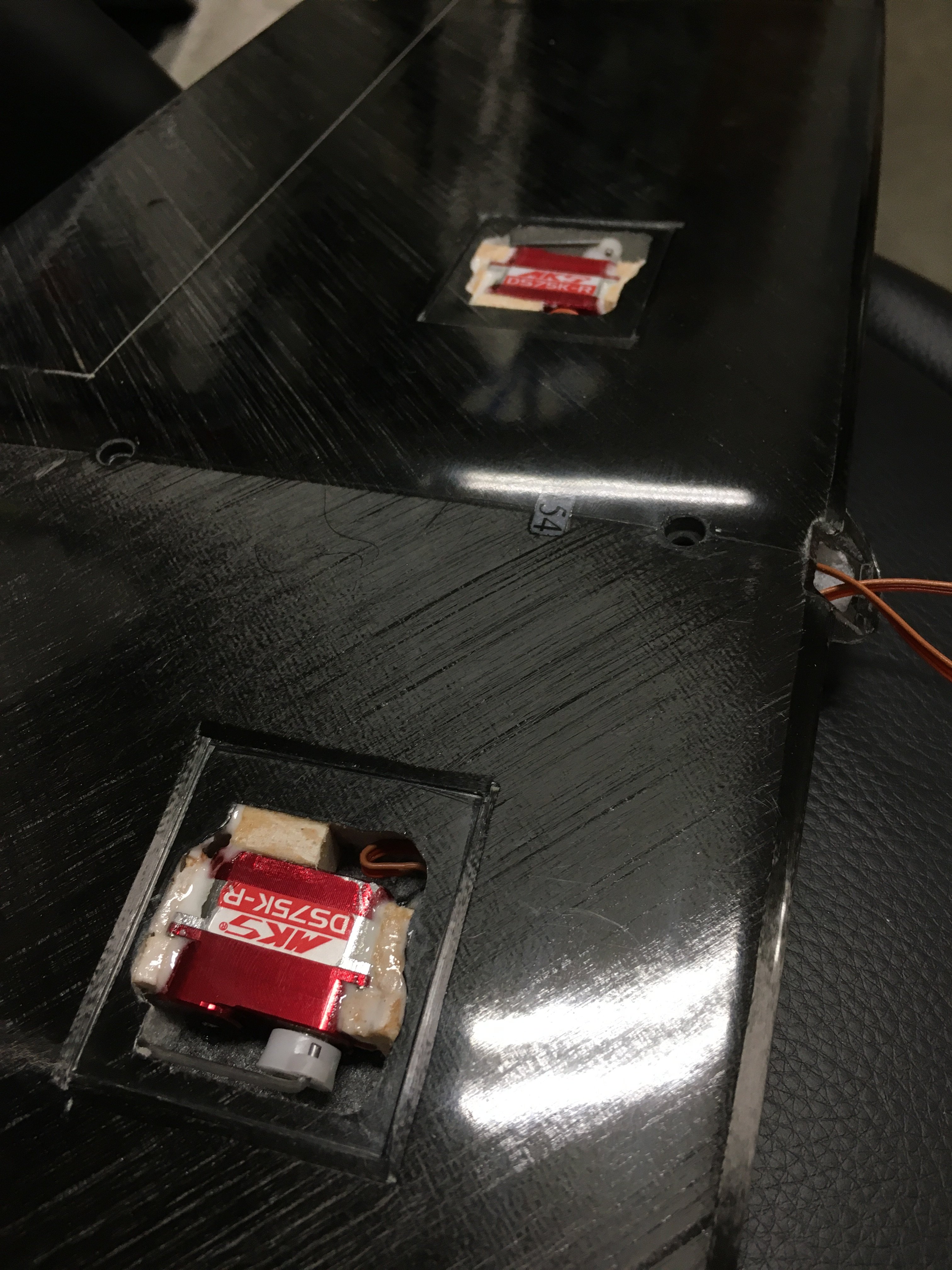

It must be a Father’s Day miracle. Mamma came home from night shift, baby and mamma down for a nap - I installed the wing servos in the Flitz2 as about happy as I could get. I learned that you can used a Trim1/2 feature in the Futaba 18SZ that is not the same as using an offset mix that was giving me some issues. Then also learned that the Trim1/2 is where I can make my flight mode for launching with a delay for reset. Cool stuff. Here’s a picture of the Flitz2 wing servos installed with balsa shims and epoxy with micro balloons. Normally the shims would be tiny... but I kept enlarging the bays to fiddle around more. As soon as I finished, my little girl woke up. Perfect!!

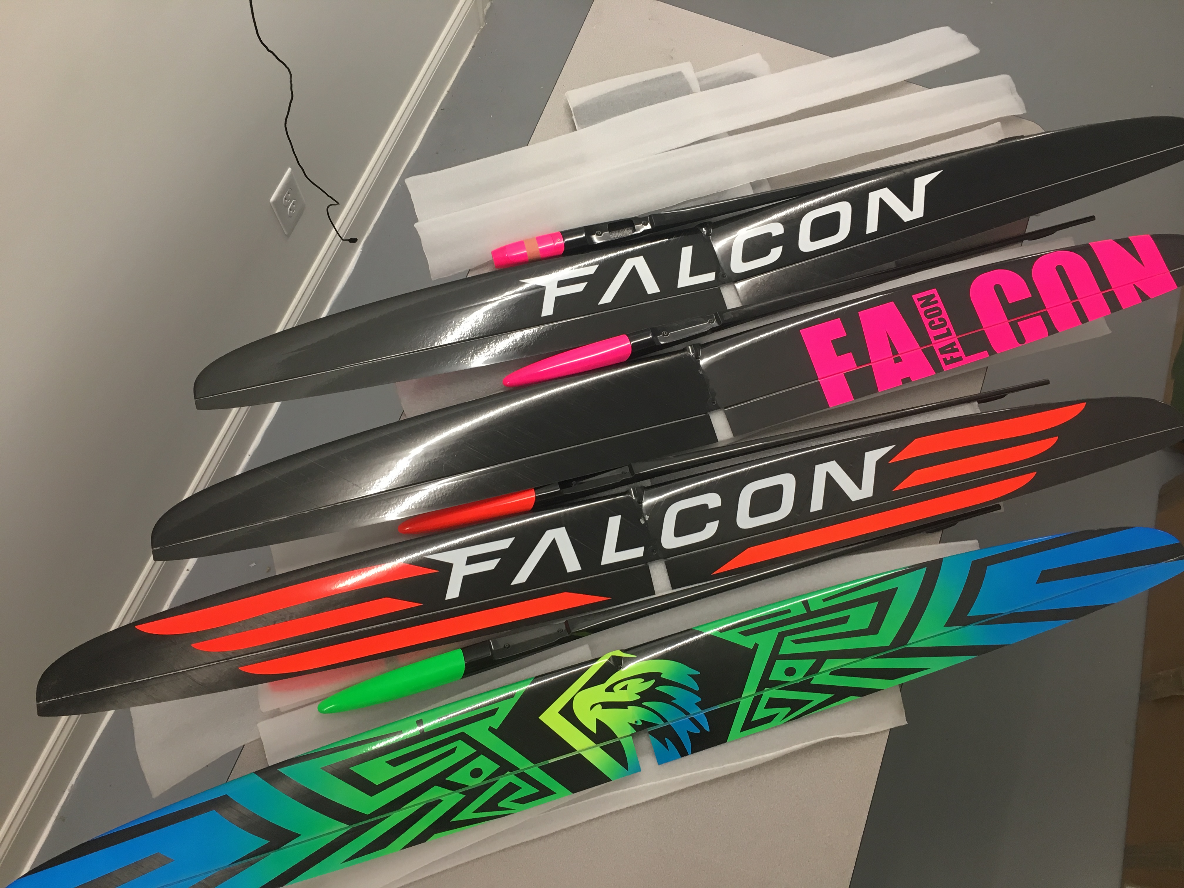

The lower Falcon (blue/green) is now mine! Just awaiting a couple add ons before he ships it to me.

I have yet to fly a Falcon but its my understanding they are amazing. Yes getting ailerons setup on a DLG is a PITA but worth it once down right.
