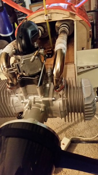

I didn't do much on the Dalton tonight. Instead, since putting another four flights on the Sukhoi yesterday, I figured I'd do some checking on her. I discovered a loose canister so a replacement coupler was in order.

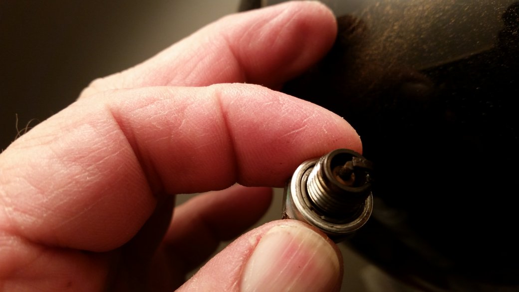

I also decided to pull the plugs and have a looksie. After 64 flights and about 10 gallons, the 170 3dub is breaking in quite nicely. Just a tick on the rich side. So a fresh set of NGK's and a very fine tweak on the ole needles.

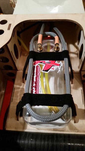

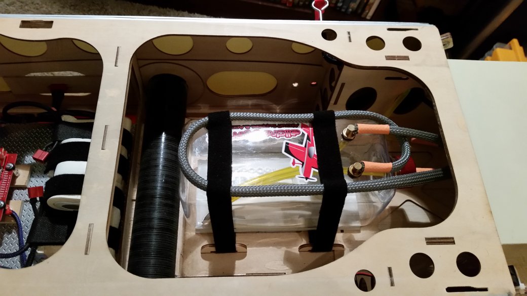

I figured I might just as well dress up the girl a bit, so a new 50 oz. Taildragger RC fuel tank was in order. The 60 oz. Dubro was just way too much.

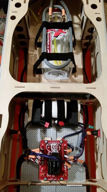

I've been doing some fine tuning on the CG balance. She's always been a tick nose heavy. I want to give IMAC a try this year and this is the plane I want to try with. So getting the balance is really important to me. Losing 10 oz's of fuel won't hurt me a bit and moving the ignition battery further back should put me right where I want to be.

Hello Rob, I really like your fuel lines!! That looks awesome!

That install looks badass!

Restoring those old cars are a lot of fun. I remember doing a couple of auto restores back a number of years ago. Ah yeah, love those old muscle cars. The fuel line is actually normal yellow Tygon fuel line with "Snakeskin" or braided wrap from TDRC. I believe that is where it came from??? At any rate, slide the fuel line inside, put your color choice of heat shrink tubing on the ends to keep it from freying. And Wa-laa..... cool looking fuel lines.
Hey Rob,
157 or 170 on this bird? Is there any way you can center the fuel tank on the cg? The closer you can get it, the better :)
That's my 170 classic Mark. Dang that motor runs so good. It's just...always the same. After it has been started for the first time of the day, it will usually restart first flip no choke the rest of the day. I was actually thinking the same thing on the fuel tank. I really liked the alteration to the fuel tank on the big Yak and was thinking of doing the same thing to the Sukhoi. It really would not be too difficult either. I have plenty of room and all I would need to do is build a little shelf over the wing tube like the Yak. The Sukhoi wing tube sits much lower in the fuse than the Yak so I would only need to raise the shelf by an about a half inch or so. Competely do-able.
Thanks Mike... It turned out pretty ok.
