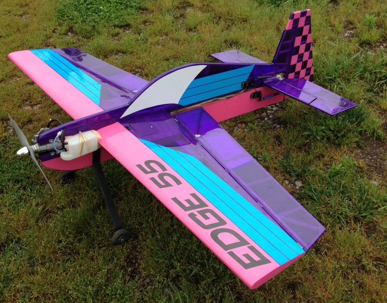

Depends on what your looking for. Do you want something that is slow stable and floaty or to you want something that will carry energy nicely but still remain stable in a stalled attitude?
What I am looking for is something that will carry energy nicely but still remain stable in a stalled attitude. Thanks for replying and your help.
@Snoopy1 i would recommend an airfoil similar to what a buddy and I used on this edge. It is a naca 0018 at the root rib transitioning to a naca 0015 at the tip. Shoot for around 850-900 square inches of wing area and you should be good to go. Build it light and try to cut weight in the rest of the plane.
Also one thing you could try is building some SFG's for your current wings. I have heard the redwing rc 20cc profile flys really nice but isn't very stable in a stalled flight without them on it.

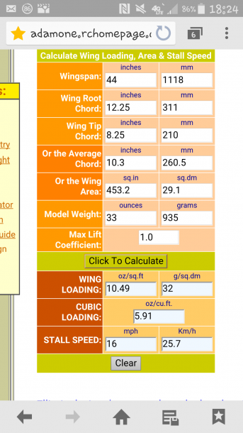

Great thanks will do that. What wing loading do you strive for or cubic loading. Thanks again. By the way the plane does have SFG's on it.

These are the specs on my smaller version of the pic I posted earlier. It's cubic loading is just shy of 6 cu in. The bigger purple one I posted the pic of is around 6-1/4. Typical slab say mojos, primos and such are in the mid to low 4's for cubic loading and your typical 3D fattie is more around the 8-9 range so we shot to split the difference as we didn't want it to be floaty

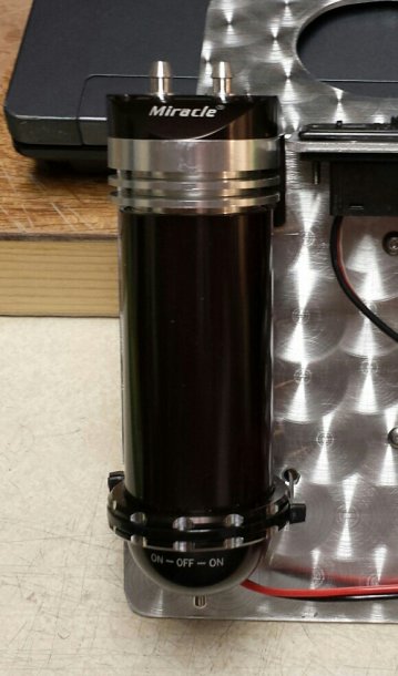

Hey Doug,
Did you bolt your Miracle gas pump to the plate or are you just using the magnet to hold it on?

I figured out not long after I got the pump out of the box that the magnet was a joke. It has no holding power at all. The lip at the top hooks over the plate and I used a wire tie to hold the bottom and to keep it from sliding up and coming off the lip.
The pump survived it's first day out just fine. I'm running it on a 2500mah 9.6 Nimh. I think it's a little slower than my friends Jersey Fueler, but since I'm only flying 50 and 60cc airplanes the biggest tank I have is 24 ounces. It sure beats cranking!
