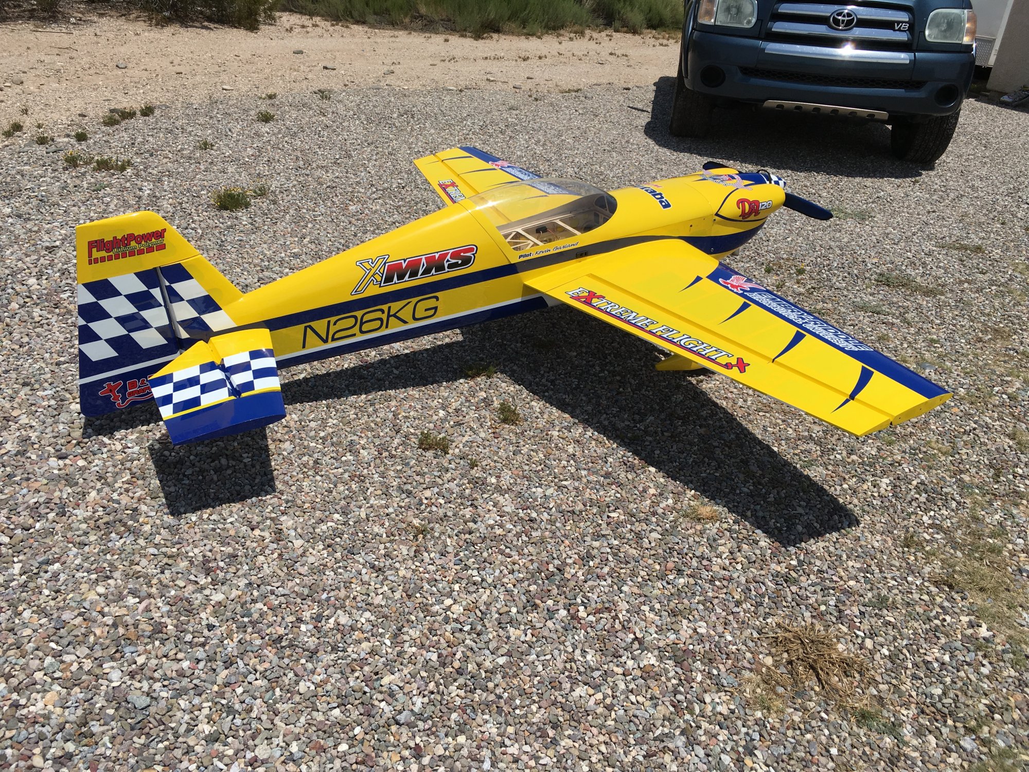

Aint that the truth. I bought the correct tube from Aeroworks for an Aeroworks airplane and it was way to big. Some are way heavier than others as well. The 40mm tube I bought for my Carf Extra only weighed 1.2oz less than the aluminum. That was an expensive ounce.

That was the thing about the Carf Extra I talked about in the previous post. I lost the exact same amount of weight on the stab tube as I did on the wing, 1.2oz. The great thing about that is it was 4 to 1 on how much weight I could take out of the nose. So, I lost almost 6 total ounces changing the stab tube. Well worth the money since a 16mm the stab tube was cheap.

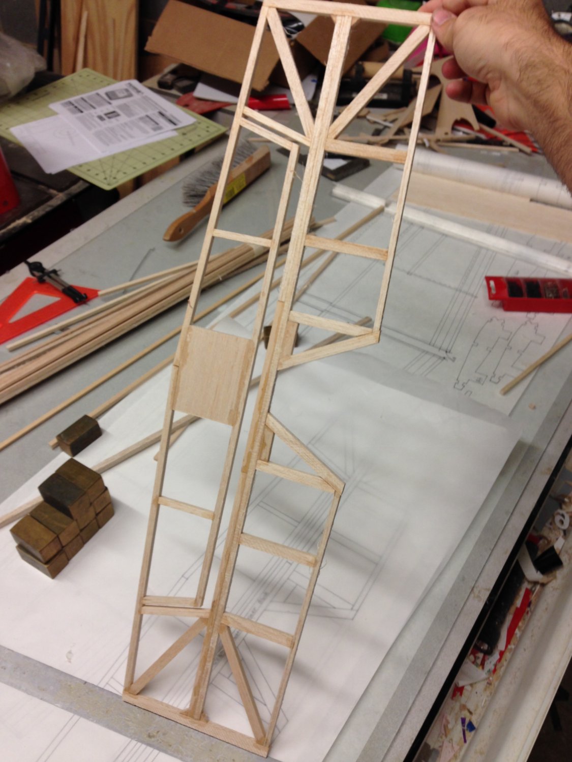

So I had this idea for a while and decided to put it to use. On a couple slabs I have built the counterbalances didn't come out exactly straight with the LE of the stab. Was only noticeable if you put a straight edge against it but still I knew it was there. So on this one I built the stab first but left the LE sticks long. Framed the elevator right to those sticks so it's all in line. Now I only have to cut them free and add the tristock.
Great idea Chris.:way_to_go:
