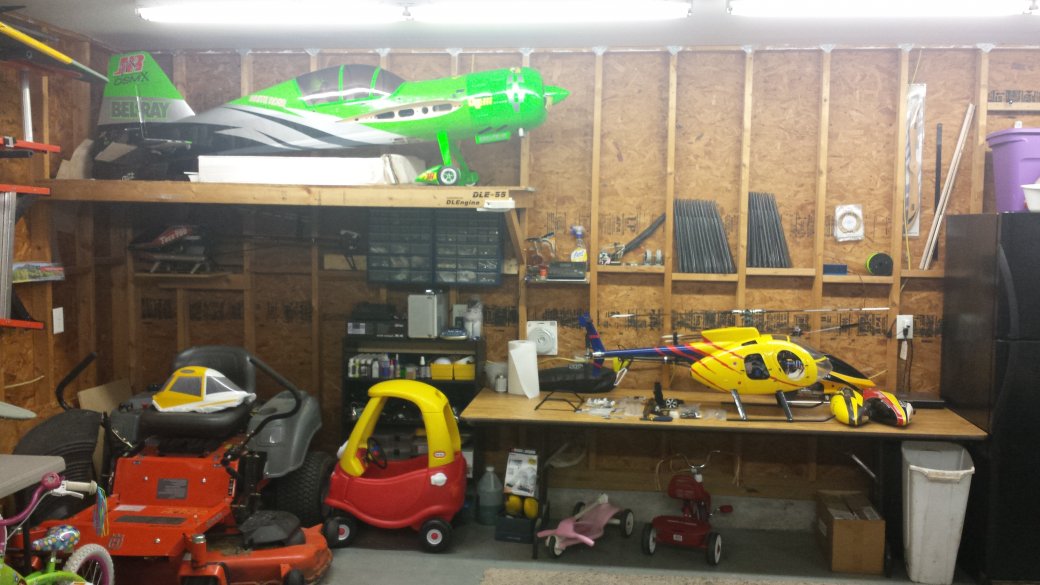

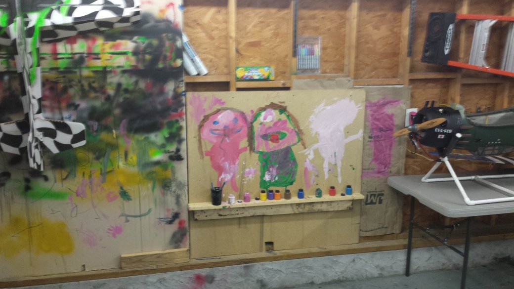

I was hoping to be able to post in the "Im going flying thread" but unfortunately 15 plus mph winds. Considering I didn't want to fly my yak without anyone else there in case something happened.
I now am posting my what I did in my workshop. I reorganized to have more room in the garage. It just so happen that the build table ended up beside the refrigerator.:cheers: LOL! Along with that I made a little area the girls can paint.
Everything is set now so hope I can get some airplane work done. Here is some pics.

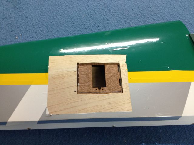

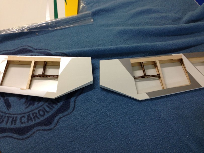

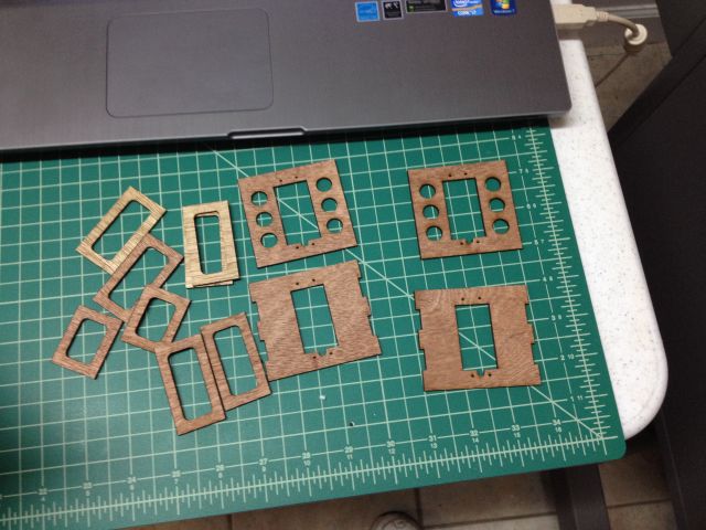

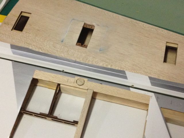

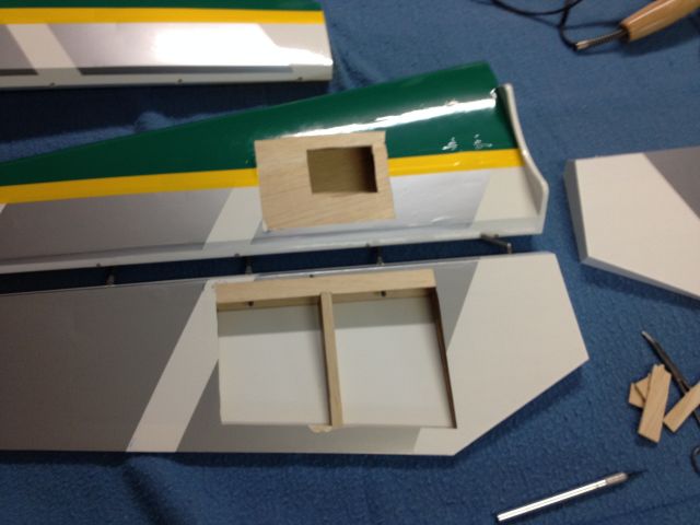

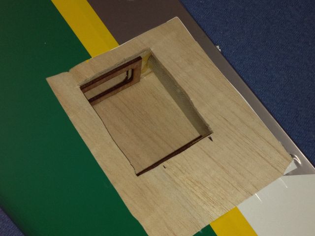

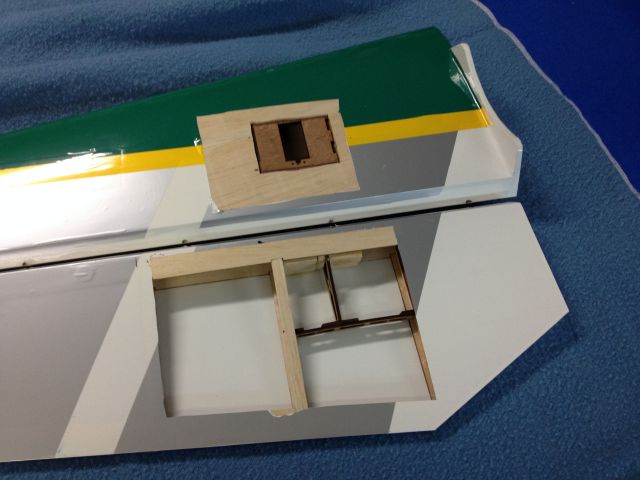

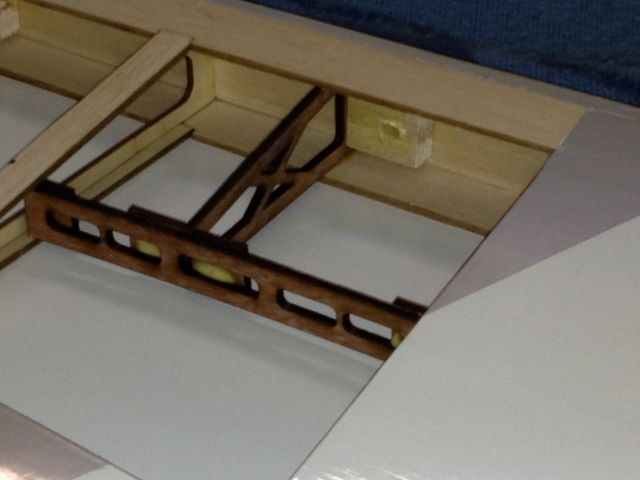

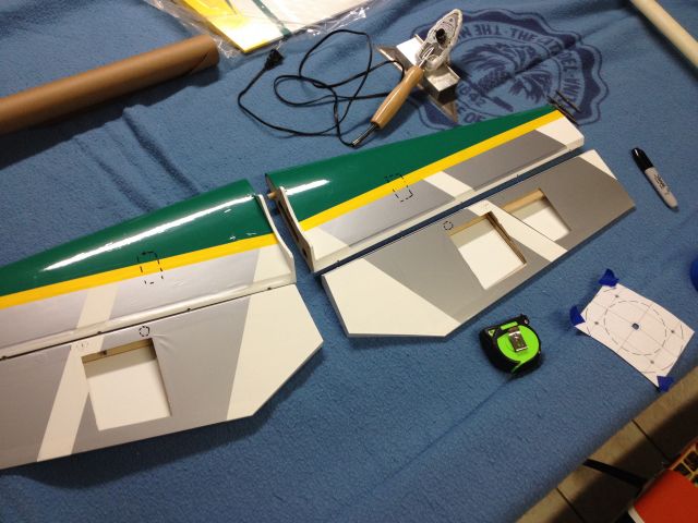

Working on a 42% PAU Extra... the standard elevator design incorporated two servos per elevator half... I want to use a single servo per elevator half, neither existing servo location was ideal for doing this... so, needed to add a more central location for the servos...

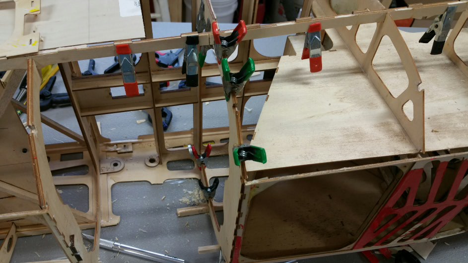

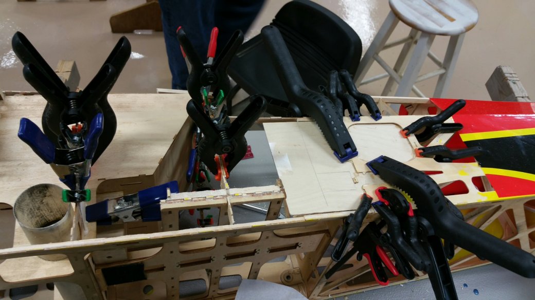

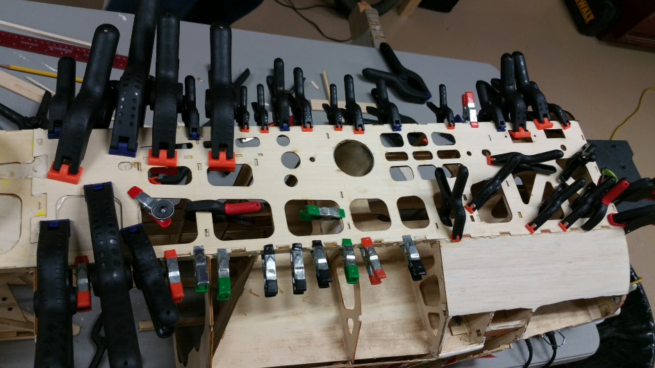

Repairing a 40% extra
View attachment 4598 View attachment 4599 View attachment 4600 View attachment 4601 View attachment 4602 View attachment 4603 View attachment 4604 View attachment 4605 View attachment 4606
Looks good.

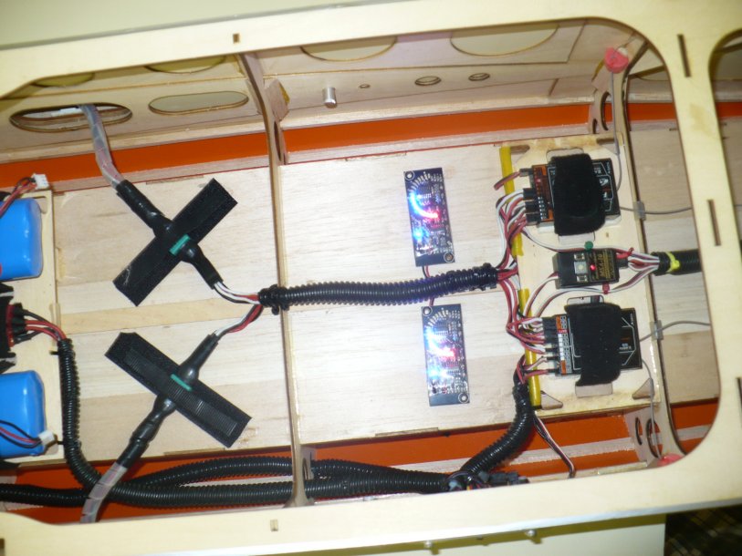

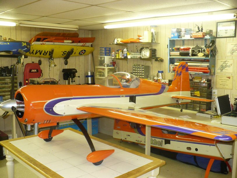

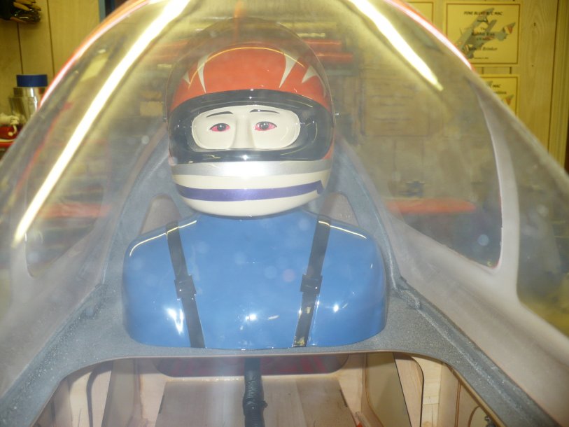

Finished up Sukhoi #3. Retired #2 (seen under the counter) after 1000+ flights and planning to recover in my own scheme over the winter.

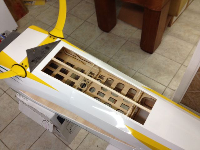

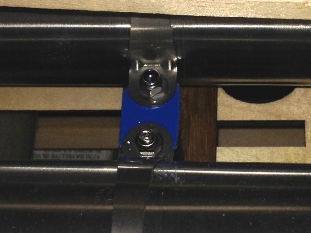

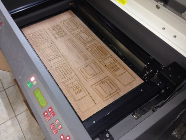

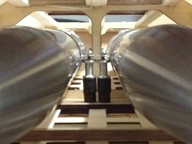

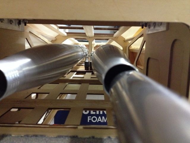

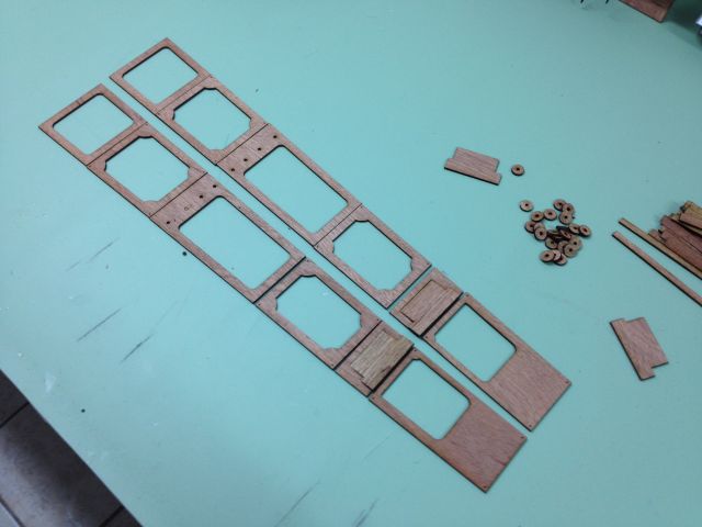

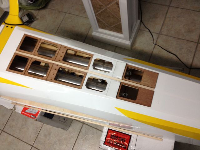

This was more than just last night, but... First time I have tried installing canisters, using RE3's with the Comfort mounts.. as others have said, these mounts can be a challenge to install. After looking at the space and scratching my head for a day or two, I decided to just open up the bottom and give myself a little more access to work with.... measured everything up, did a little cad drawings, cut out some stuff on the laser and it actually fit ! mostly.. one mistake is I left the comfort mounts a little too close together.... so, I cut a little spacer to help hold them apart...
Now I need to find a short exhaust extension that fits the ends of the RE3's... any suggestions ?
View attachment 4222 View attachment 4223 View attachment 4224 View attachment 4225 View attachment 4226 View attachment 4227 View attachment 4228
Very nicely done....

That toy rider car in your picture brings back some good memories of a funny Christmas vid my ex-wife did of our oldest son's reaction on Christmas morning. When played in FF mode it was hilarious to watch him run around it, in it, on it, over it, under it!lol.
I can just see that in my head. LOL..... Would be hilarious
