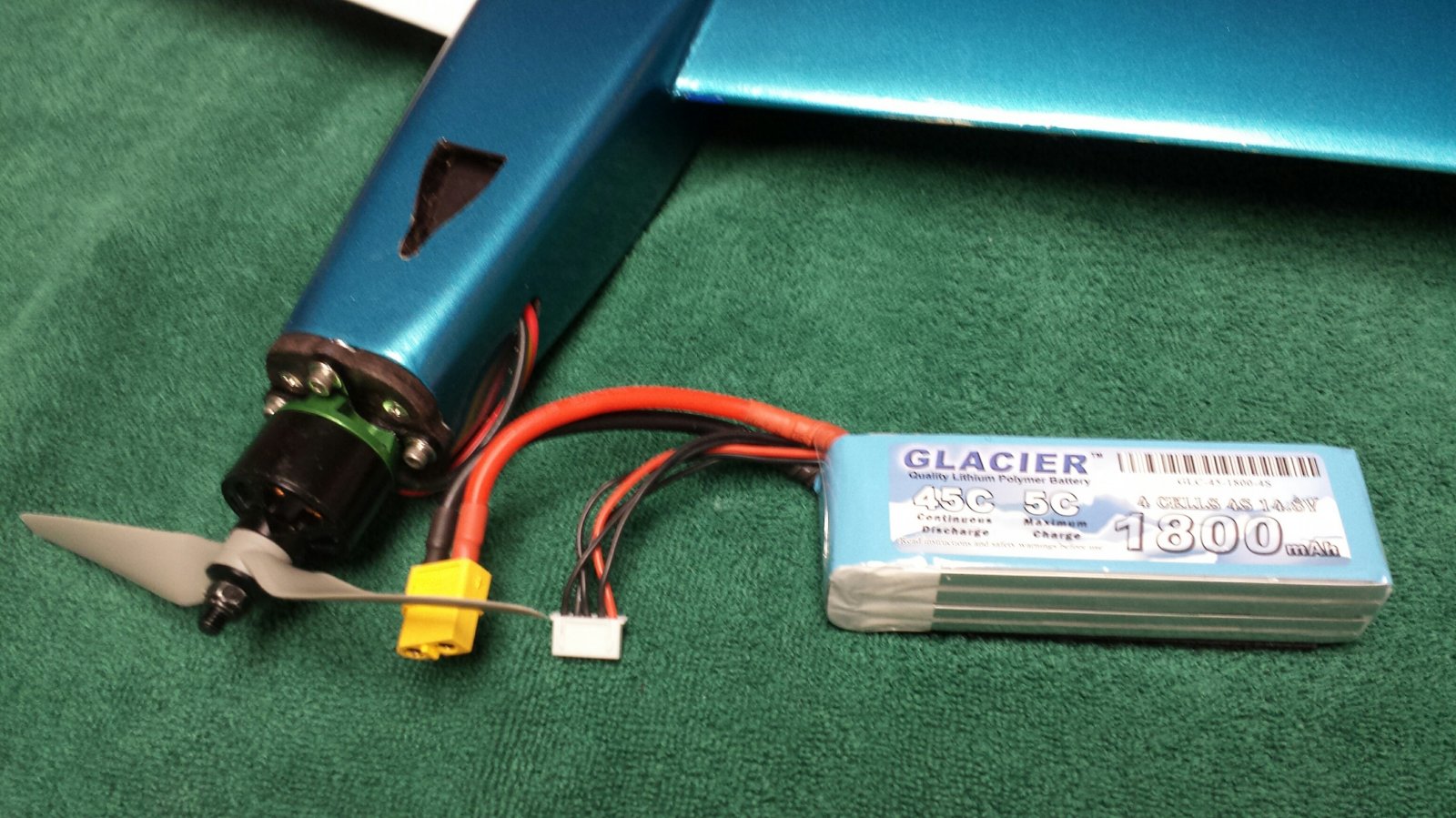

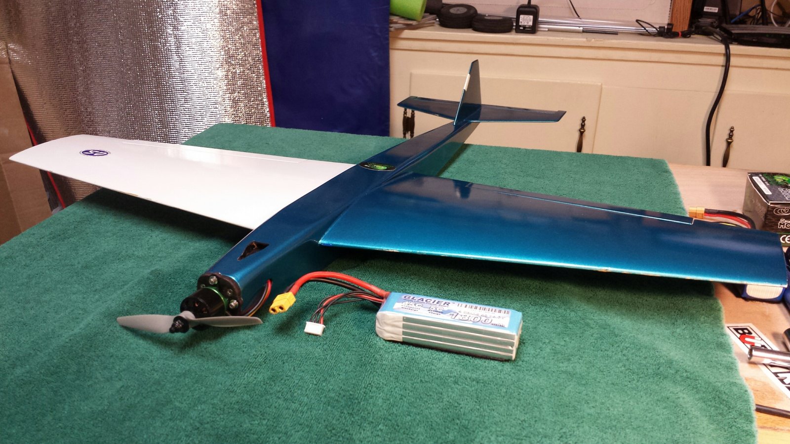

One of the guys at the field has been shaming me about not flying my little pylon racer for over a year now, so I decided it was time. The airplane is one I scratch built from my own plan about 20 years ago. Back then it was powered with an O.S. 10 for races we had at my previous club. About two years ago I changed it to electric. I had been flying it on 3S and have been wanting to go to 4S, so the other day I ordered a new battery to try out.
According to the propeller data for the Cobra 2213/12 2000kv motor, the 3S with the 6 x 5.5 prop I'd been running had a pitch speed of 89.4. On 4S with a 5.25 x 4.75 that goes up to 104. I have a 4.75 x 5.5 coming (hopefully tomorrow) that the data says has a pitch speed of 124.8. It hard to say if those numbers are close are just theoretical, but it should be interesting to find out.;)
It's also going to be interesting to see if the 20 year old glue joints, and servos, will hold up to the higher speed too!:lol2:
View attachment 90408 View attachment 90409
I keep hearing About old glue joins but have never seen old glue joints fail have several old planes and all joints are good. Do not think you will have a problem, like the plane probably go like stink. How did you accommodate the battery in an old glow engine plane.

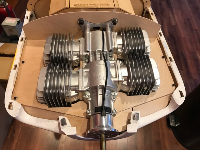

I have been working on the baffling for my new Aeroworks Ultimate with a 4 cylinder in it. I will be glad when this part is done.

I had built the airplane originally with a bottom hatch to access everything. After removing the fuel tank and giant (by today's standards) receiver, I had just enough room for a battery and ESC. I was able to relocate the tiny new receiver behind the wing spar in a spot that was empty. I did have to lengthen the hatch a few inches so the battery would slide in. Thankfully the CG stayed about the same and in the whole process of swapping to electric the airplane lost about an ounce of weight as well as gained lots of power over the OS10.

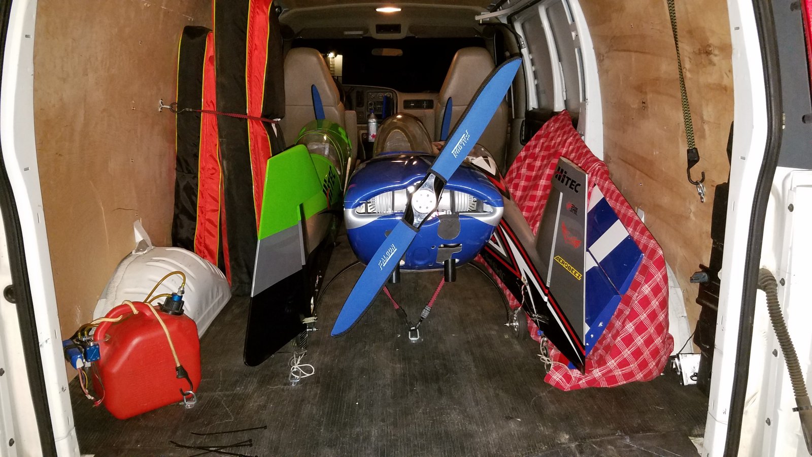

The new 4S battery is a 1800mah which is less than the previous 2200mah 3S so flight times will be shorter. The 3S was a 25c Turnigy battery and the airplane would really slow down after the first two minutes or so, even thought it still showed plenty of charge percentage. I'm hoping the new 45C Glacier will solve that issue. I guess I'l find out tomorrow.:) But first I need to figure out how I'm going to squeeze all the crap I'm taking tomorrow in the truck.:confused??:
This will be my first one, I here a lot from happy customers and great feedback. I love the sound of a 4 cylinder, music to my ears.
Quad's (4 holers) are the bomb. My sons 222 is freaking amazing. I'm seriously considering a new 40%'er for spring. Although I've had many 3w twins and a 3w 212, a guy just can't beat the price for a 222. And oh so correct. Pure music!
