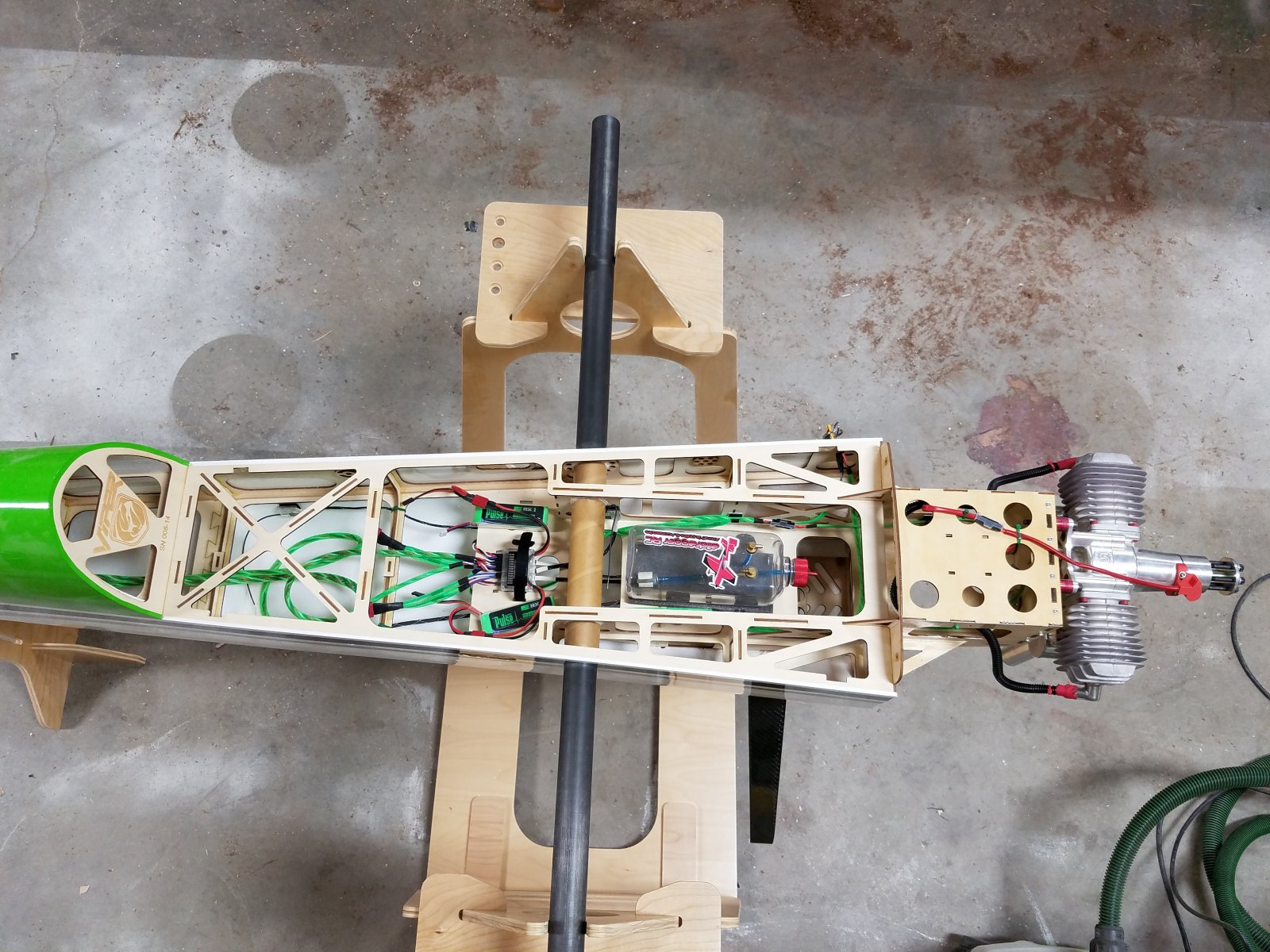

I have been working on my Viper still little bits here and there. I have been stuffing the fuse with the electronics.

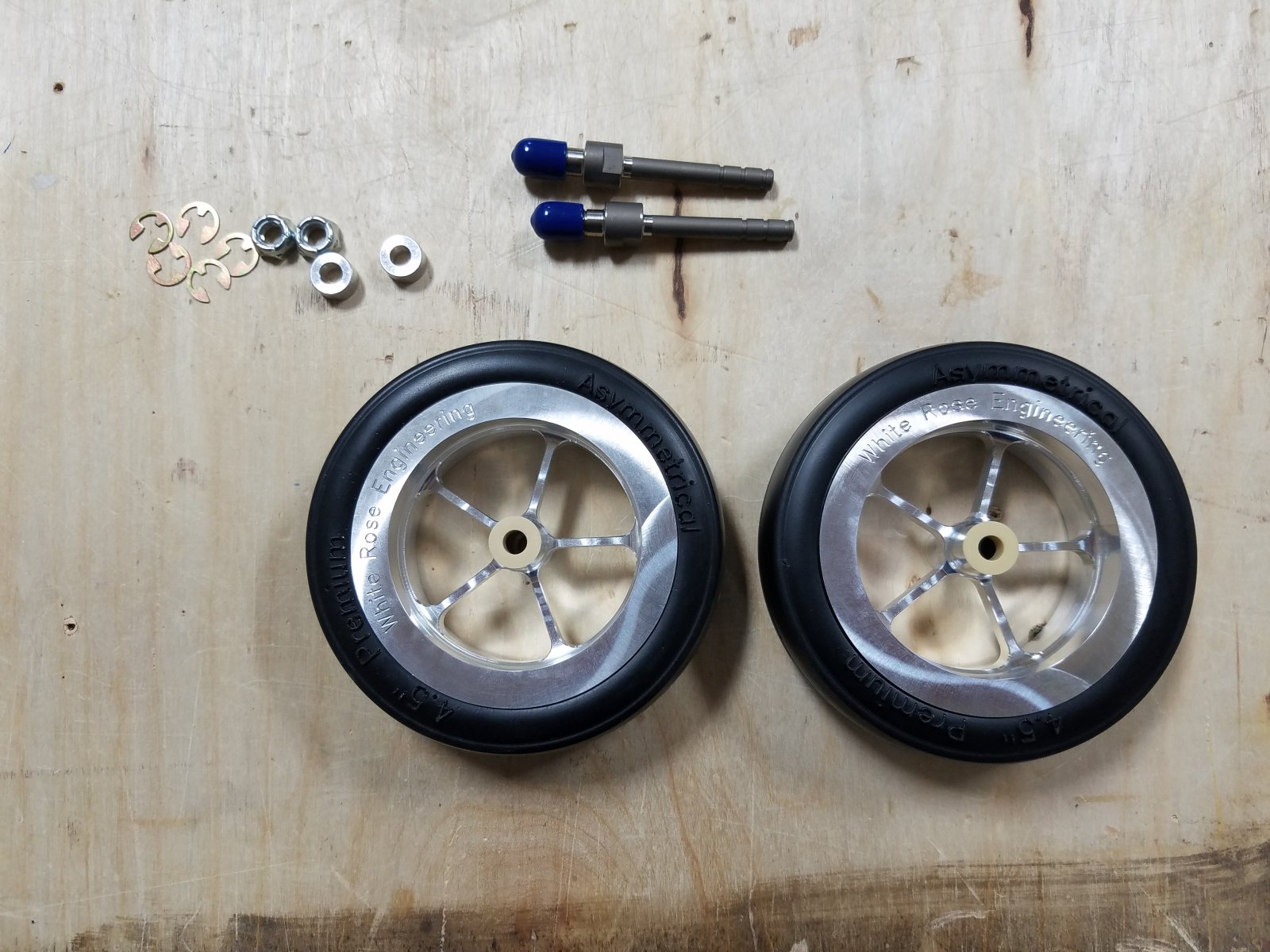

I had a box show up today with some goodies from @Vern.Smith at White Rose Engineering!:way_to_go: Awesome stuff!
Hi there, man I thought you were done and flying the plane. At least it is covered. Looks like all you need to do assembly the plane do the radio and it is ready to fly. Is the weather where your good enough to fly at this time of the year or will you be waiting for the spring. Wheels look great I will be getting the same ones what size did you get.
You need a new bos sounds like you are being overworked, tel him you have a plane to finish and fly.

Today it is snowing and blowing about 30mph and it's about 5 degrees F out, so not good flying weather lol. I got 4.5" wheels.
