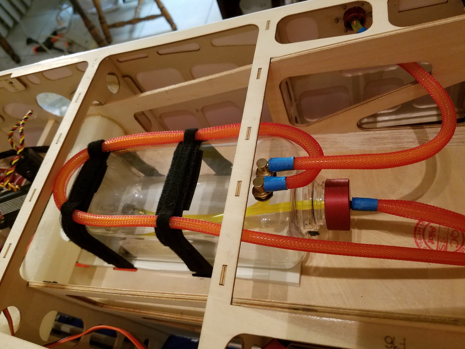

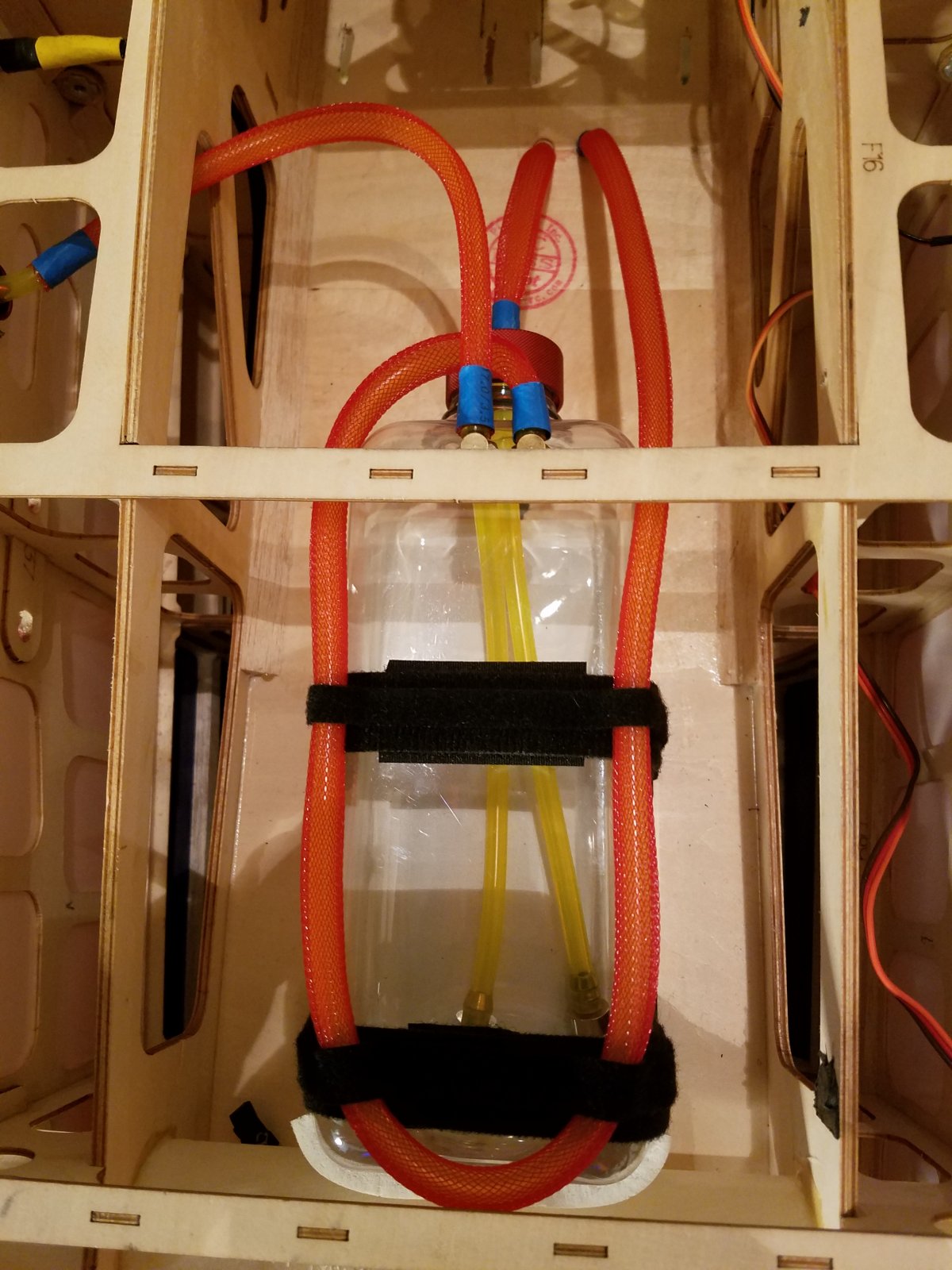

I did a little tank and fuse plumbing tonight. I really had hoped to get more accomplished. But if I get at least one task done per night, I can still make the weekend maiden with time to spare. A little red sneaky snake skin on the ole yellow Tygon go-go juice tubing.

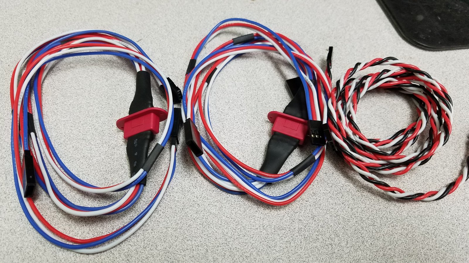

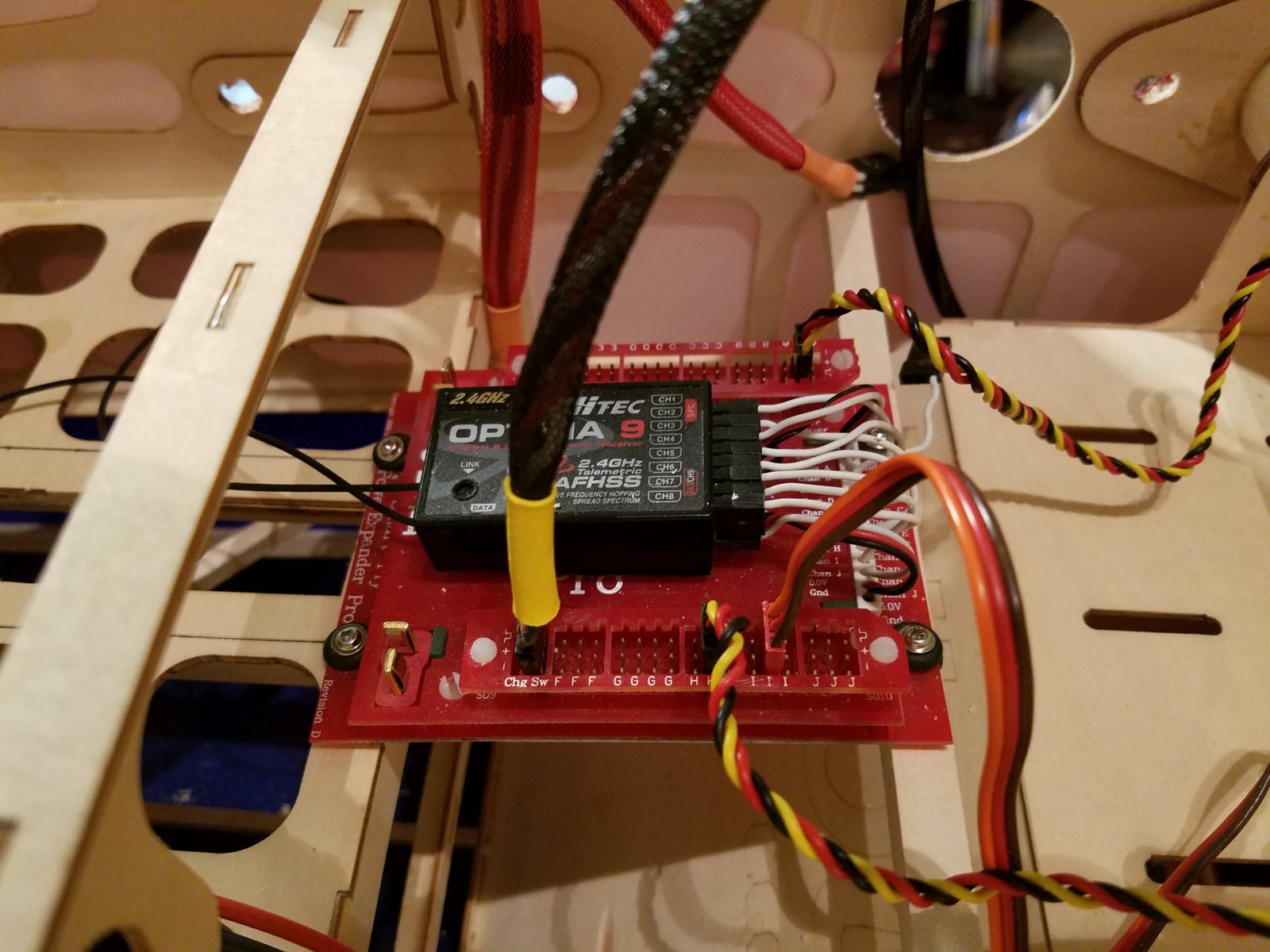

And of course, Smart Fly Power Expander Pro pre-wiring.

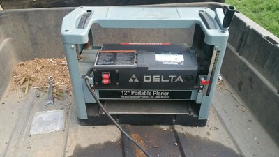

Got a new to me toy today. From what I can tell it has never been run. Just needs some surface rust cleaned up on the guide post and height adjustment screws. Nothing a little scotch bright and lithium grease cant take care of.
Planers make wood working SO MUCH EASIER! I have a Craftsman Professional 12" 3 blade planer that is close to 20 years old and it just keeps on going :) I have replaced the blades 3 times because they just wore out from use and sharpening :)

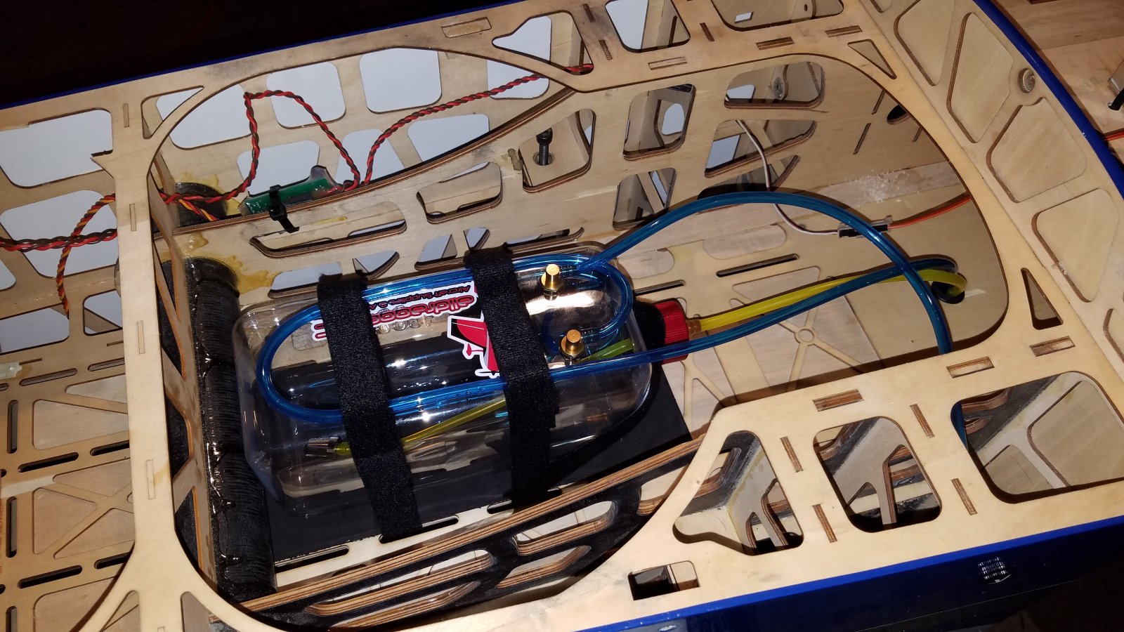

Rob have you ever had a problem with the Tygon chaffing where it passes through the plywood? I'm always paranoid about that and always install these rubber grommets... :omg:

I do worry about the chaffing. Usually I also use rubber gromets. But with the snakeskin, there is no concern.
