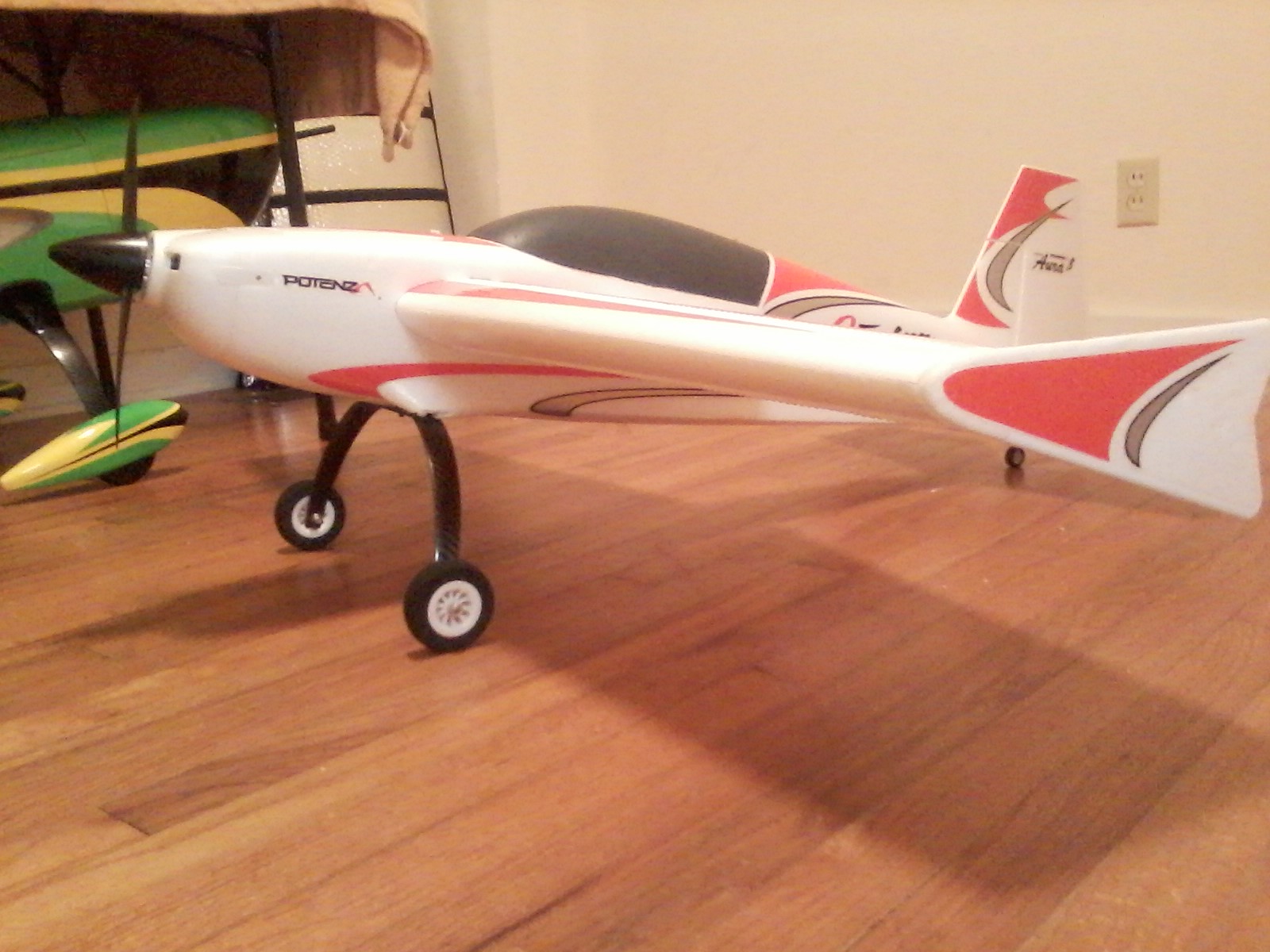

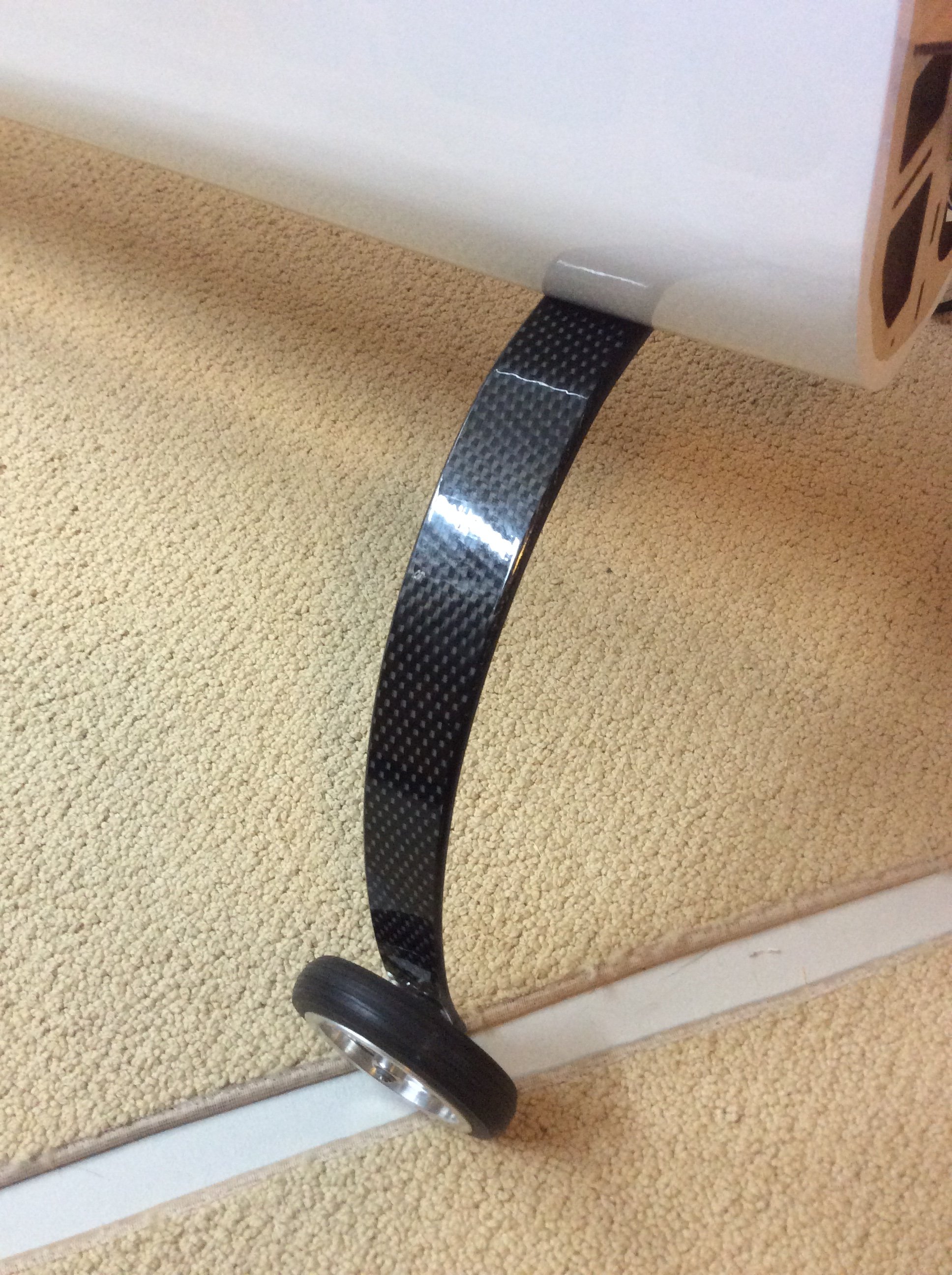

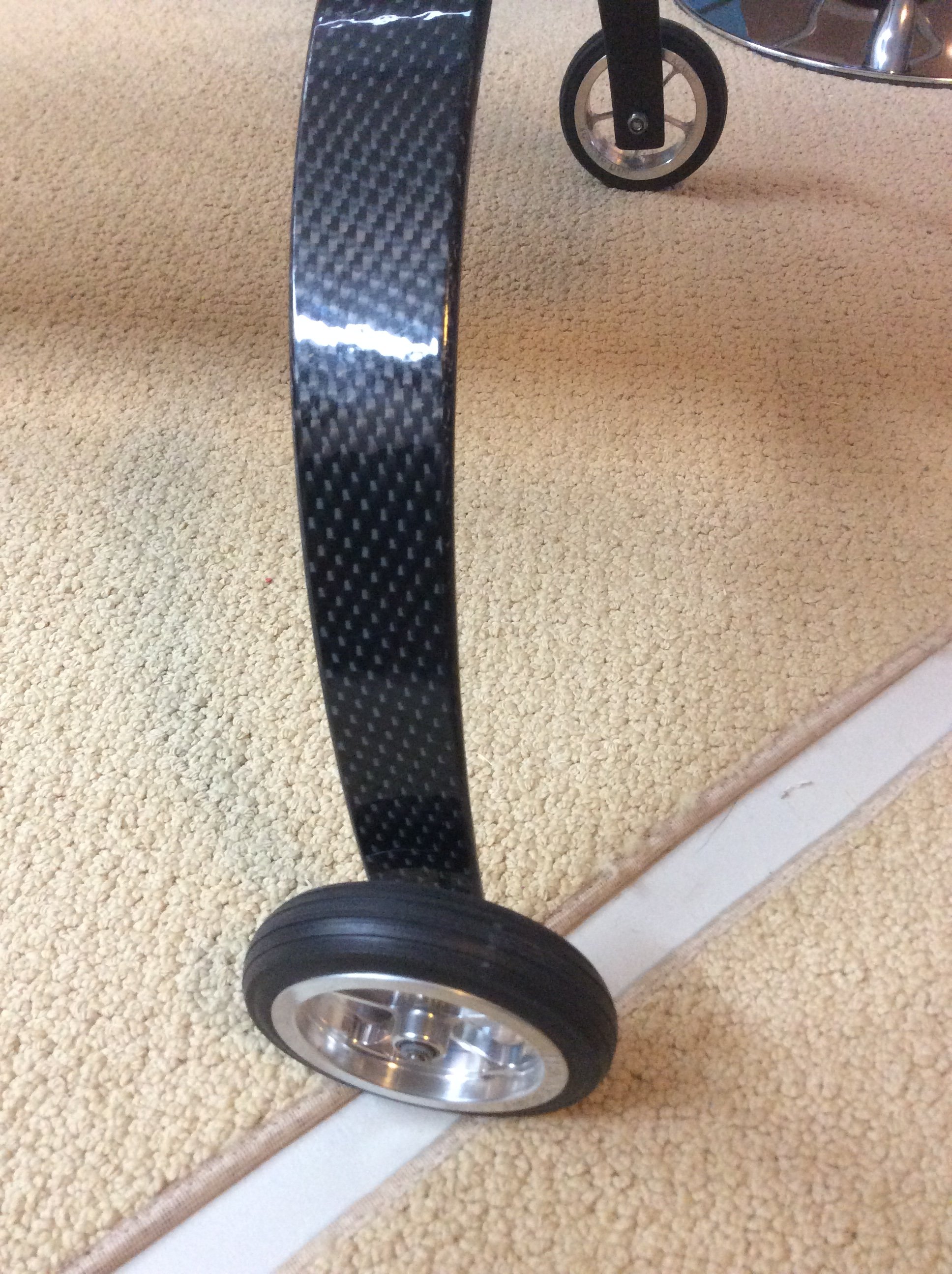

Did a little work on the ViperST installed the gear and the wheels looks ok up on its wheels now less Hanger rash.

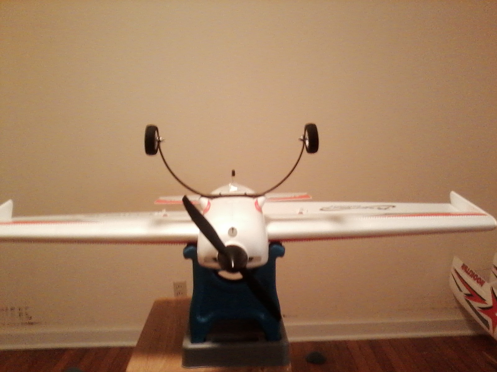

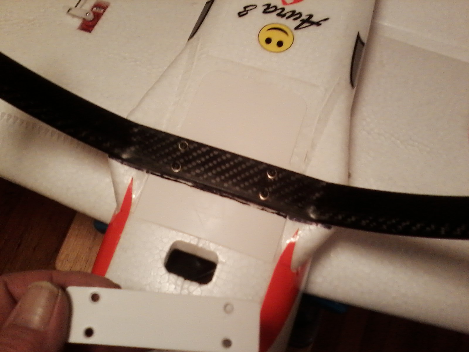

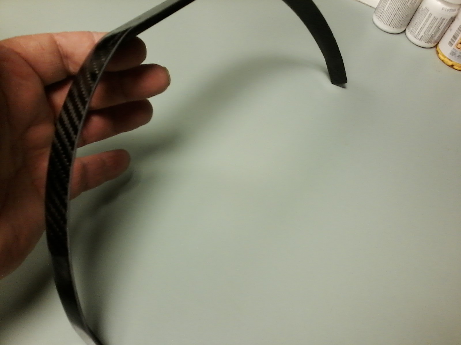

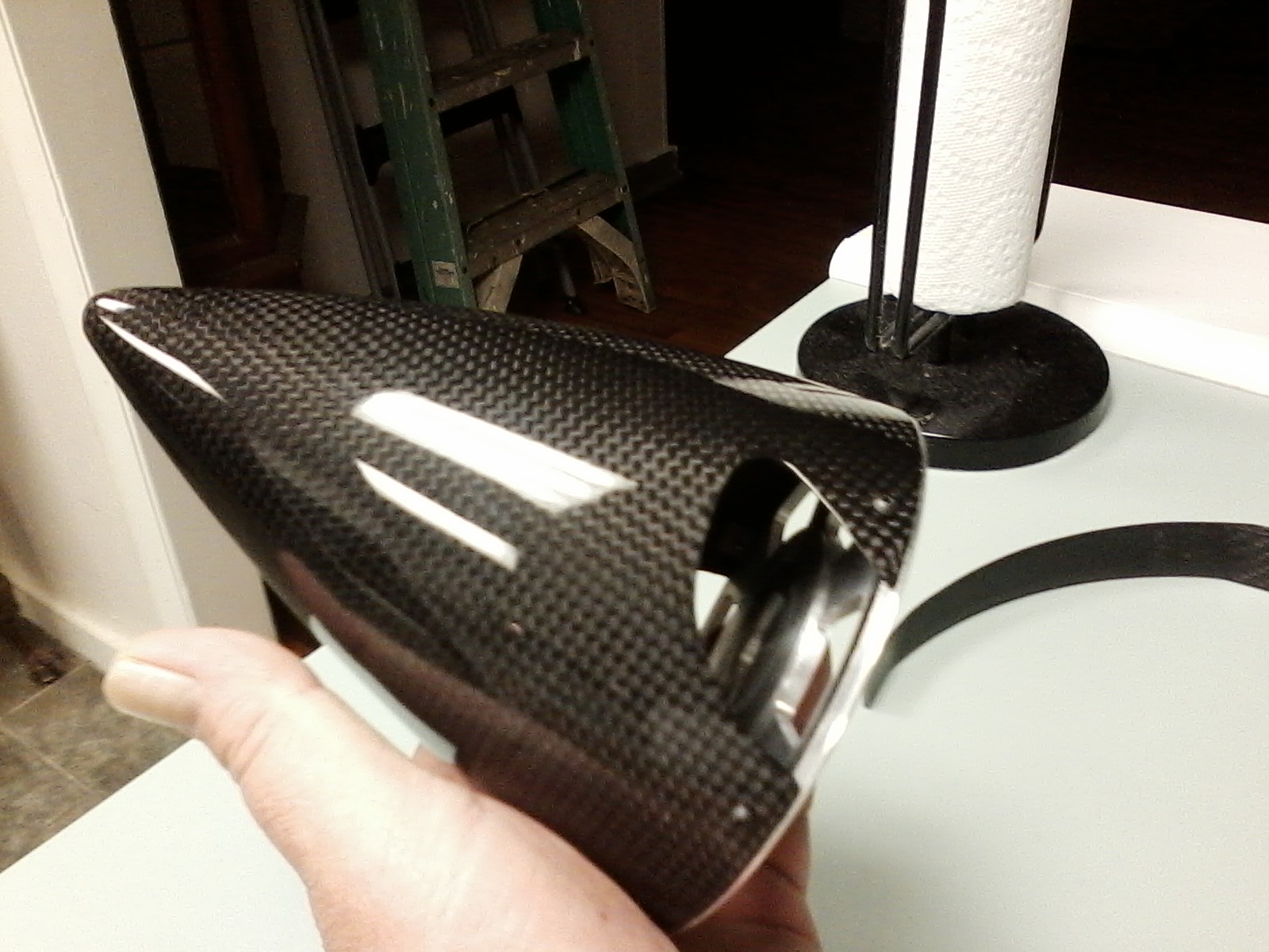

Well I got my shop deed for the evening almost done.... Going to give it a whirl in the air first and see how it does. Simply took the stock LG retainer cover and used it as a template to bore the mounting holes. I'm chuckling right now as the "Robster" just posted up a HUGE emoji.
Guy really does like em BIG!!!!!
Now what was I typing??? Oh ya.......Later on going to cut out the plastic where marked with my sharpe and install a LG plate as to recess the CF gear for a more professional look. Oh!....And I used 2mmx20mm hex screws in the existing holes to mount the gear.
View attachment 100066 View attachment 100067 View attachment 100068 View attachment 100069

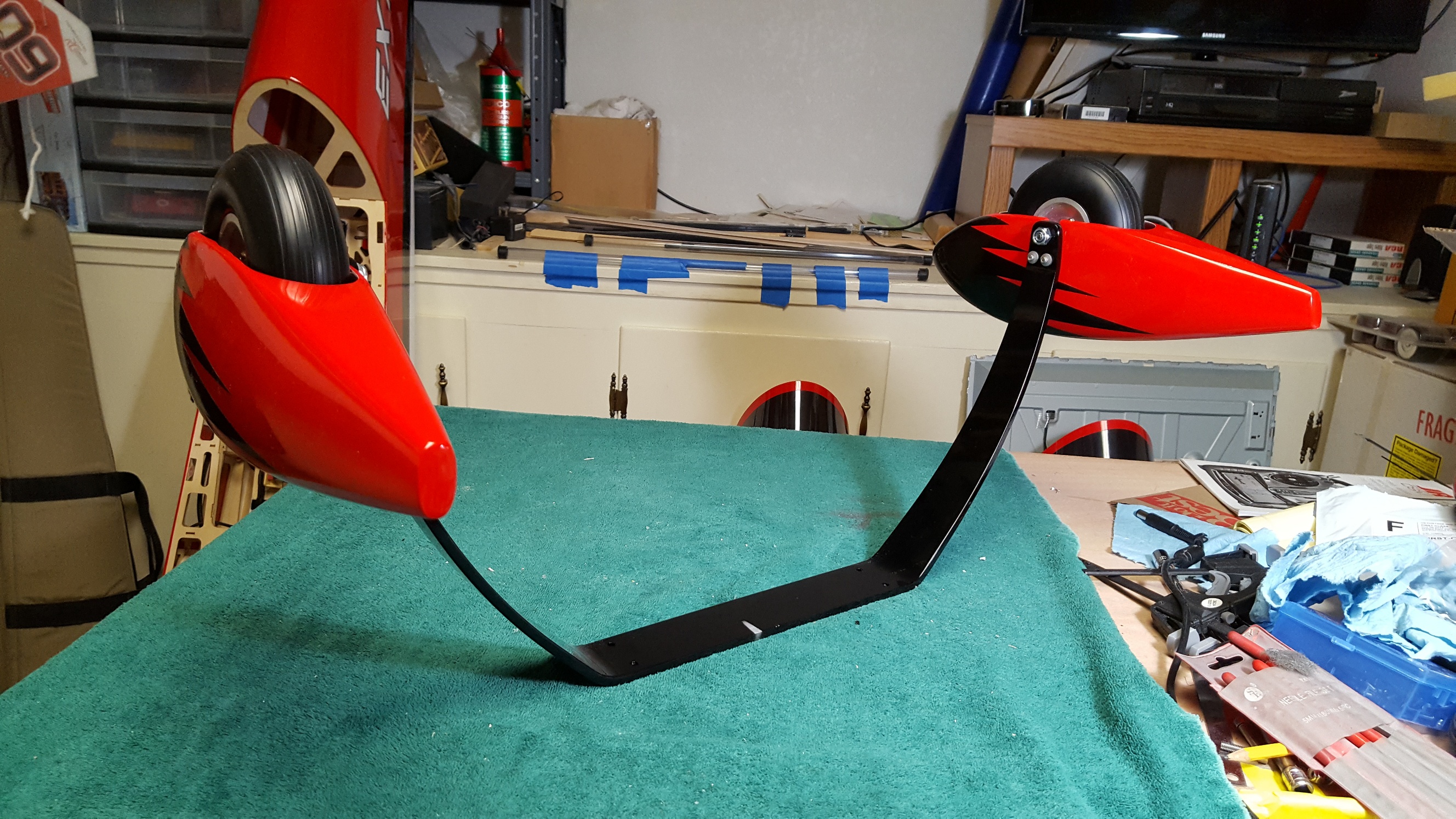

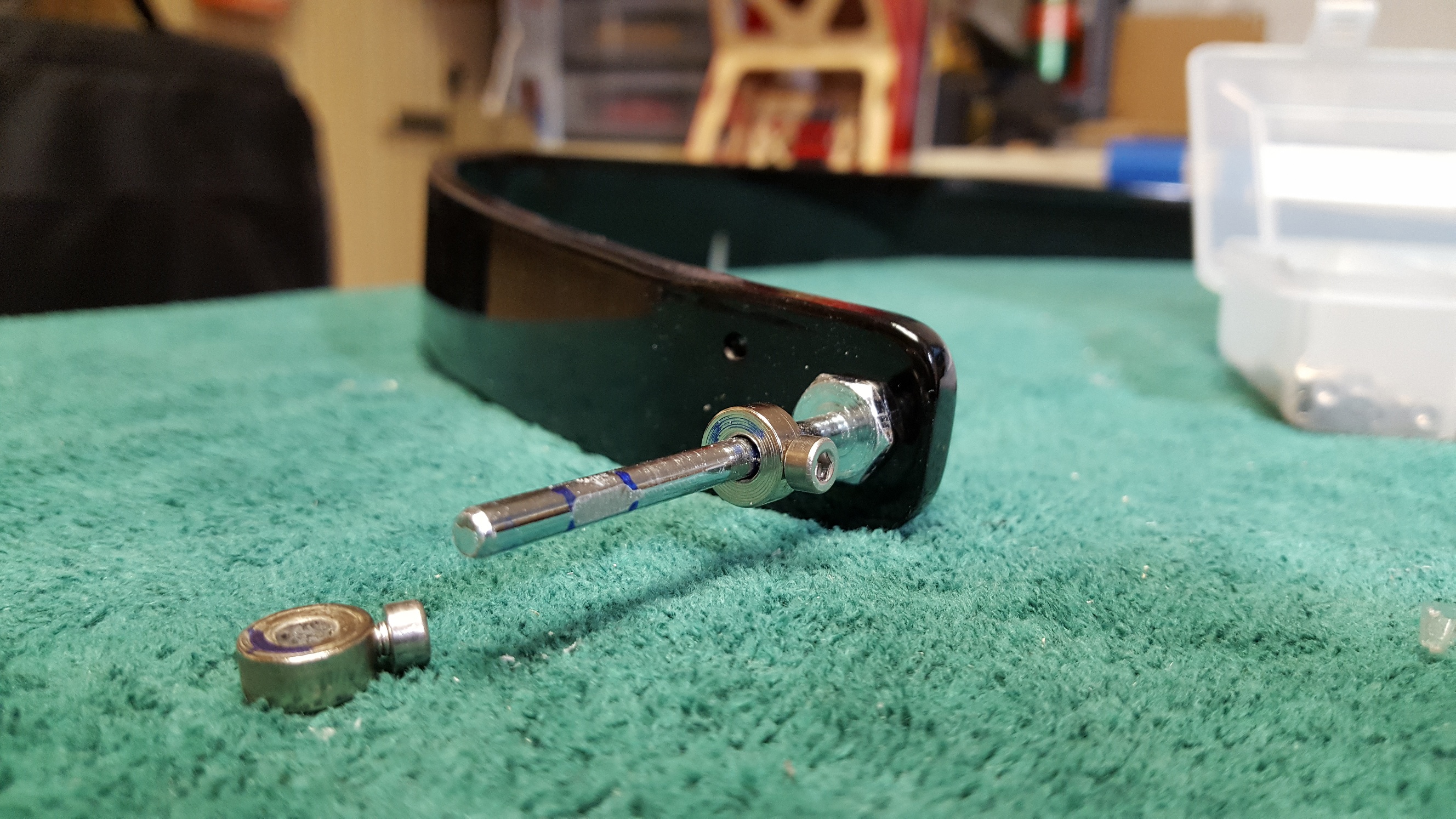

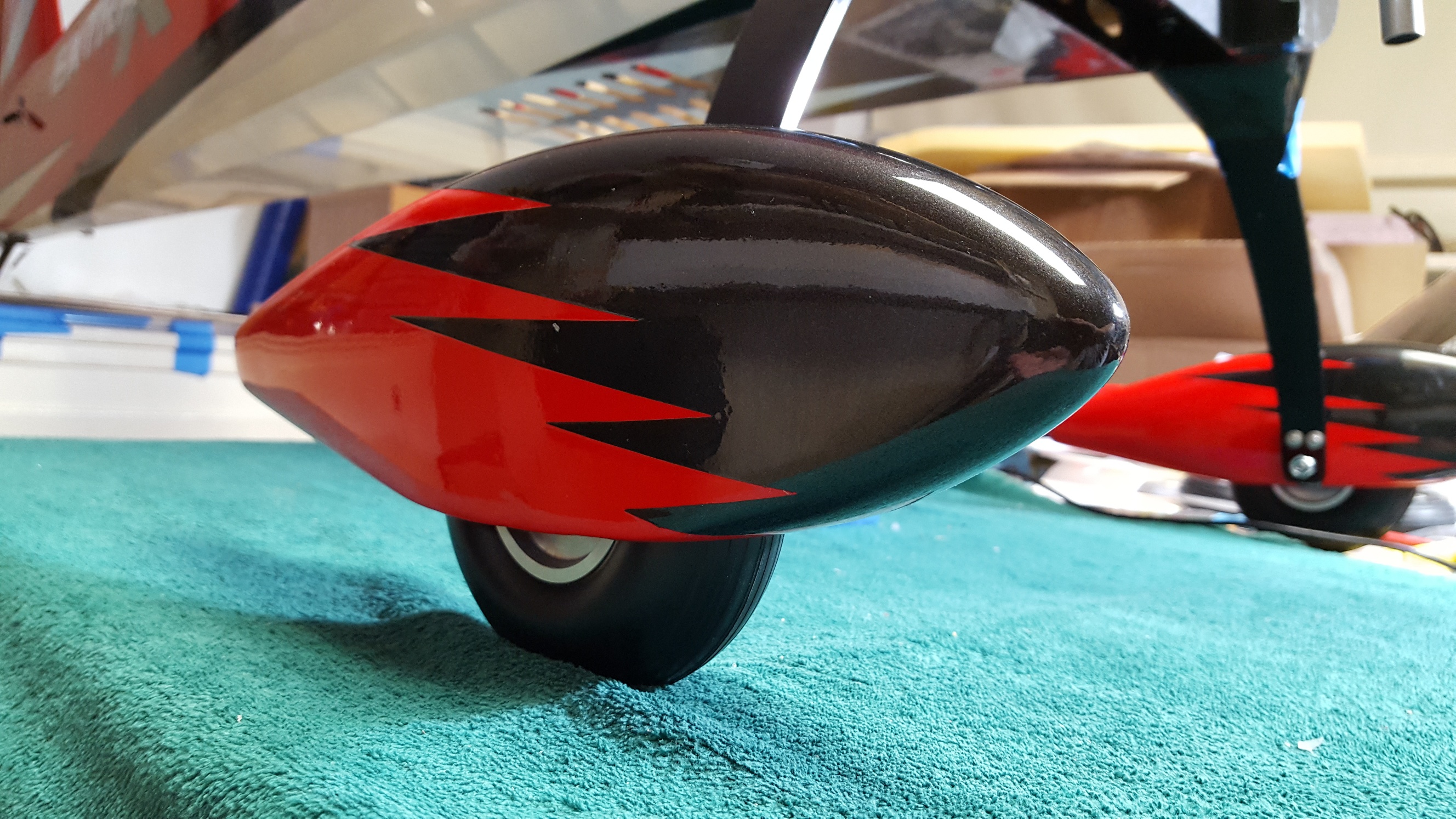

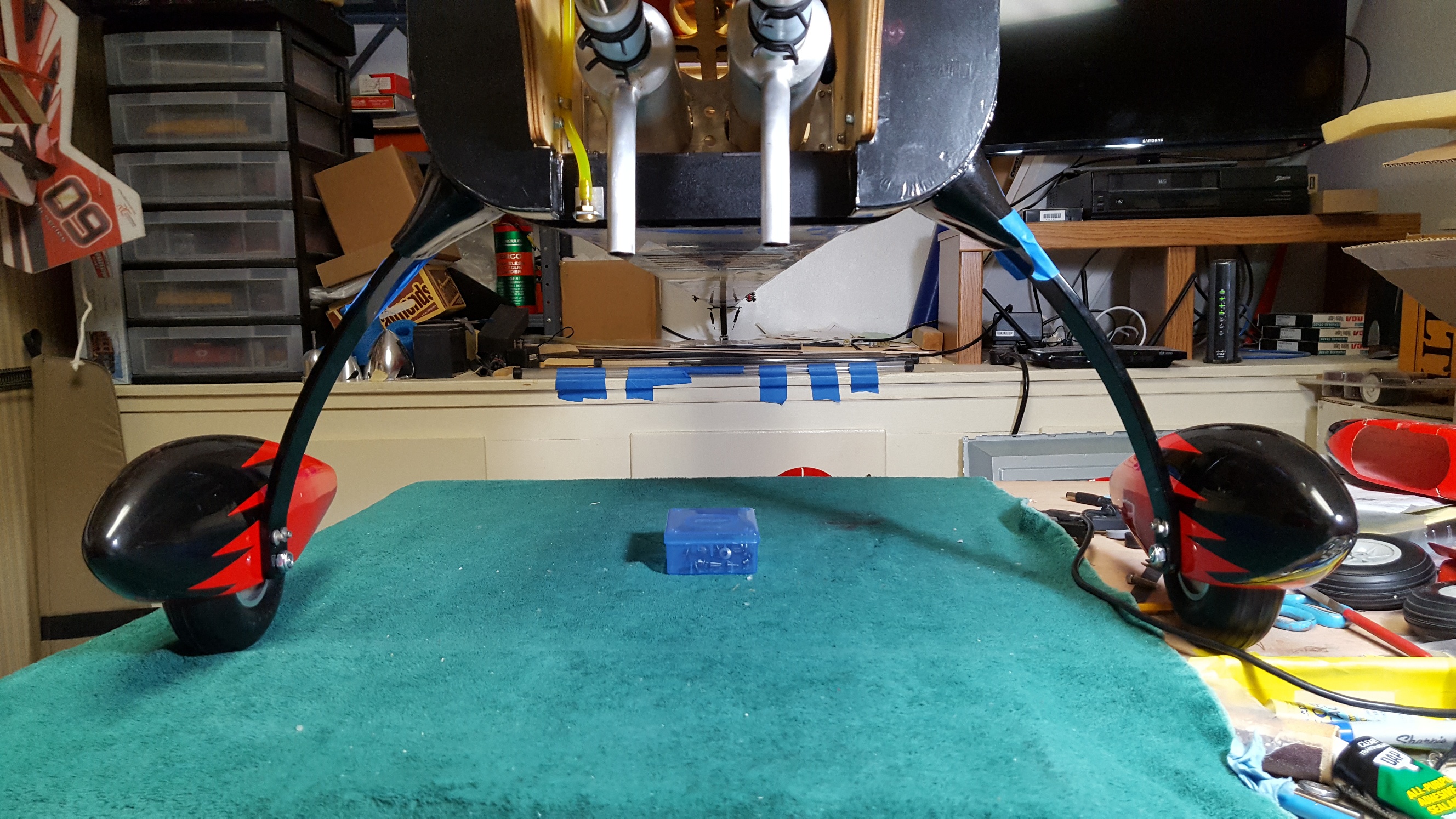

Between yesterday and tonight I cut some flats on my new Dubro axles, test fitted everything to make sure the new 4 1/2" wheels would fit the new wheel pants, and then installed it all for real and glued the cuffs on.
The new gear is 2" narrower which will make it much easier to roll through the door from my family room into the garage. Also the taller wheels will hopefully keep the pants from getting as beat.
View attachment 100071 View attachment 100072 View attachment 100073 View attachment 100074
Hi jetpainter the gear you got is it the one that is milled out to make it lighter. Looks good again.
