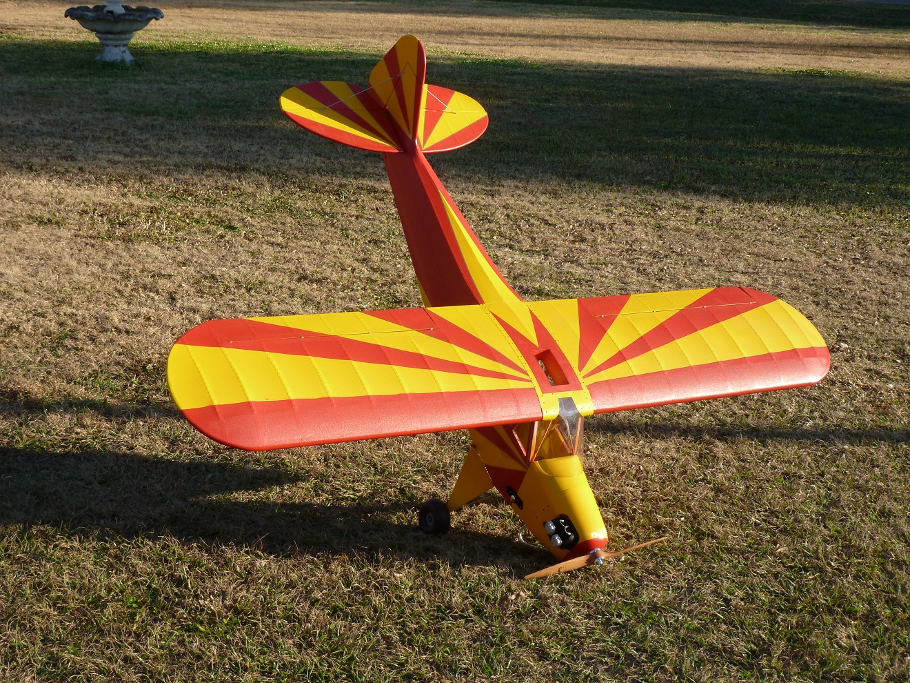

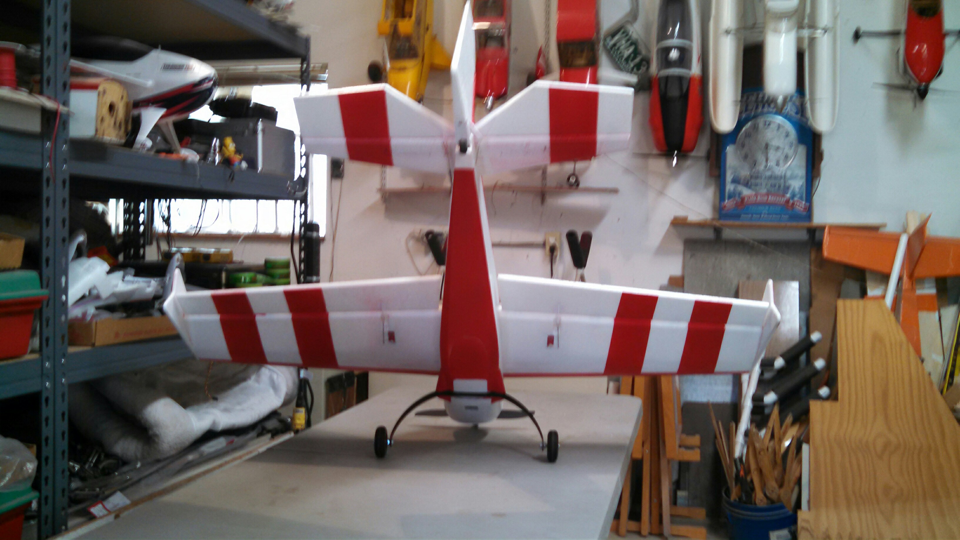

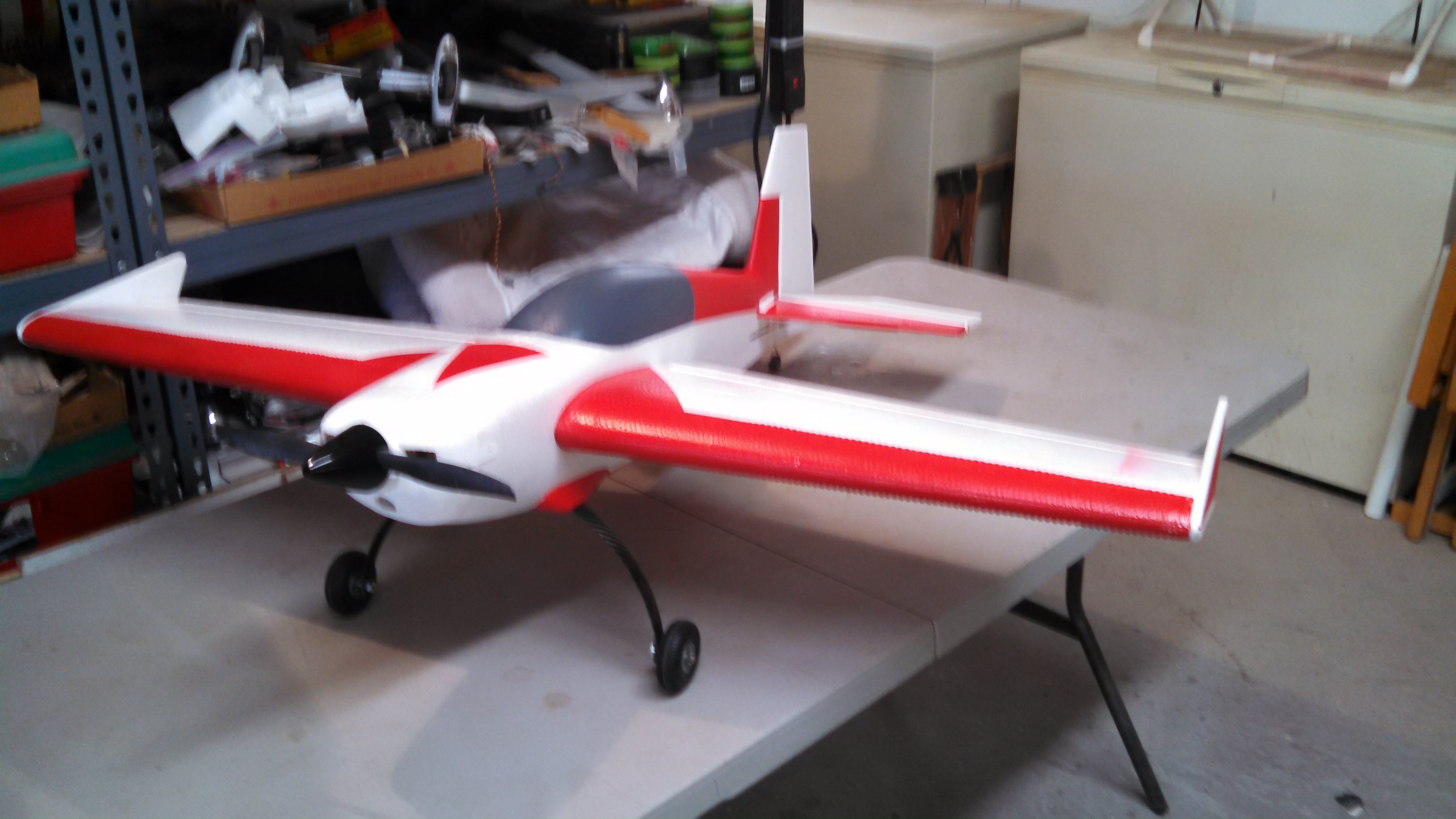

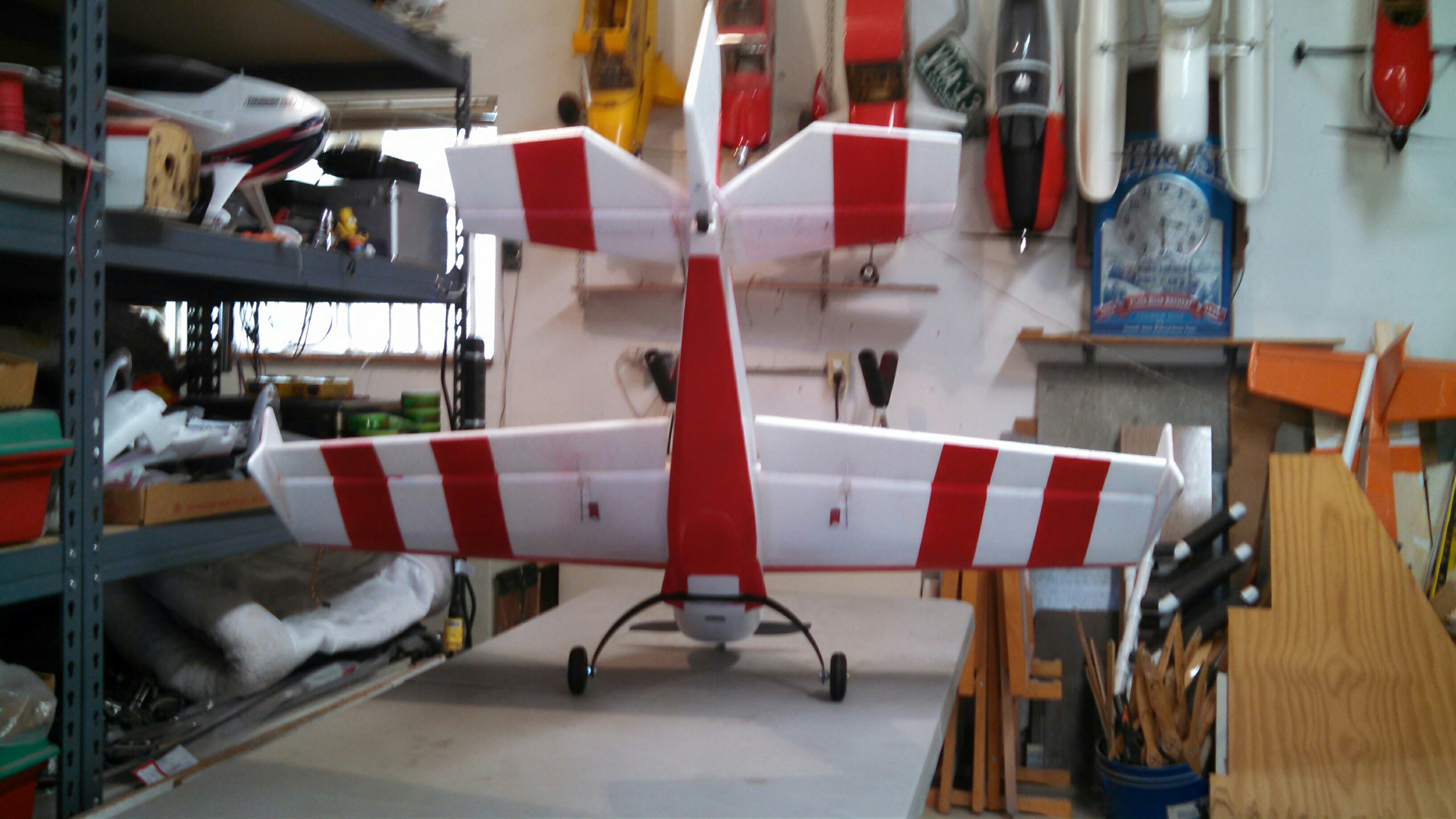

View attachment 101153 The QQ Extra isn't naked anymore. A little overspray here and there and there. Masking is tedious work for me. I like it now got to go fly it.
Looks really nice!:attaboy: I think your going to really like the new gear . I was doing one wheel touch and go's with some really long roll outs. Fun just got funnier o_O.

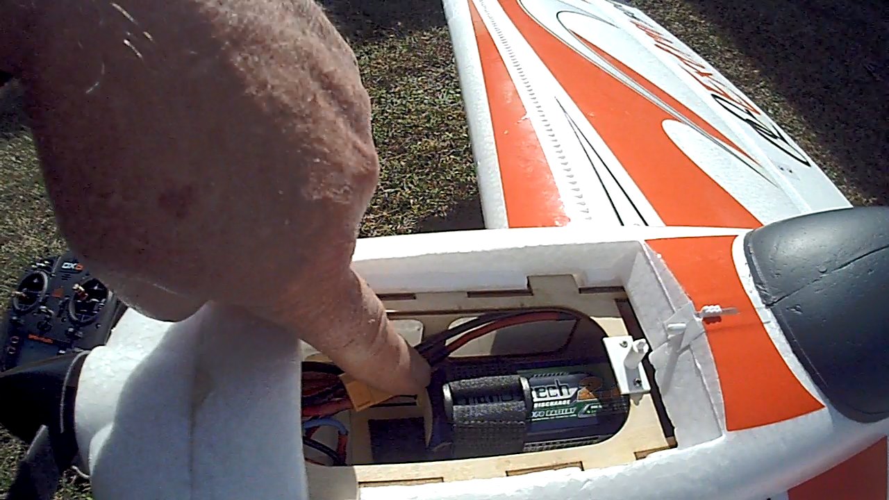

I moved the battery back to compensate for the additional weight over the stock gear. Doubt you will have to go back as far with no pants.

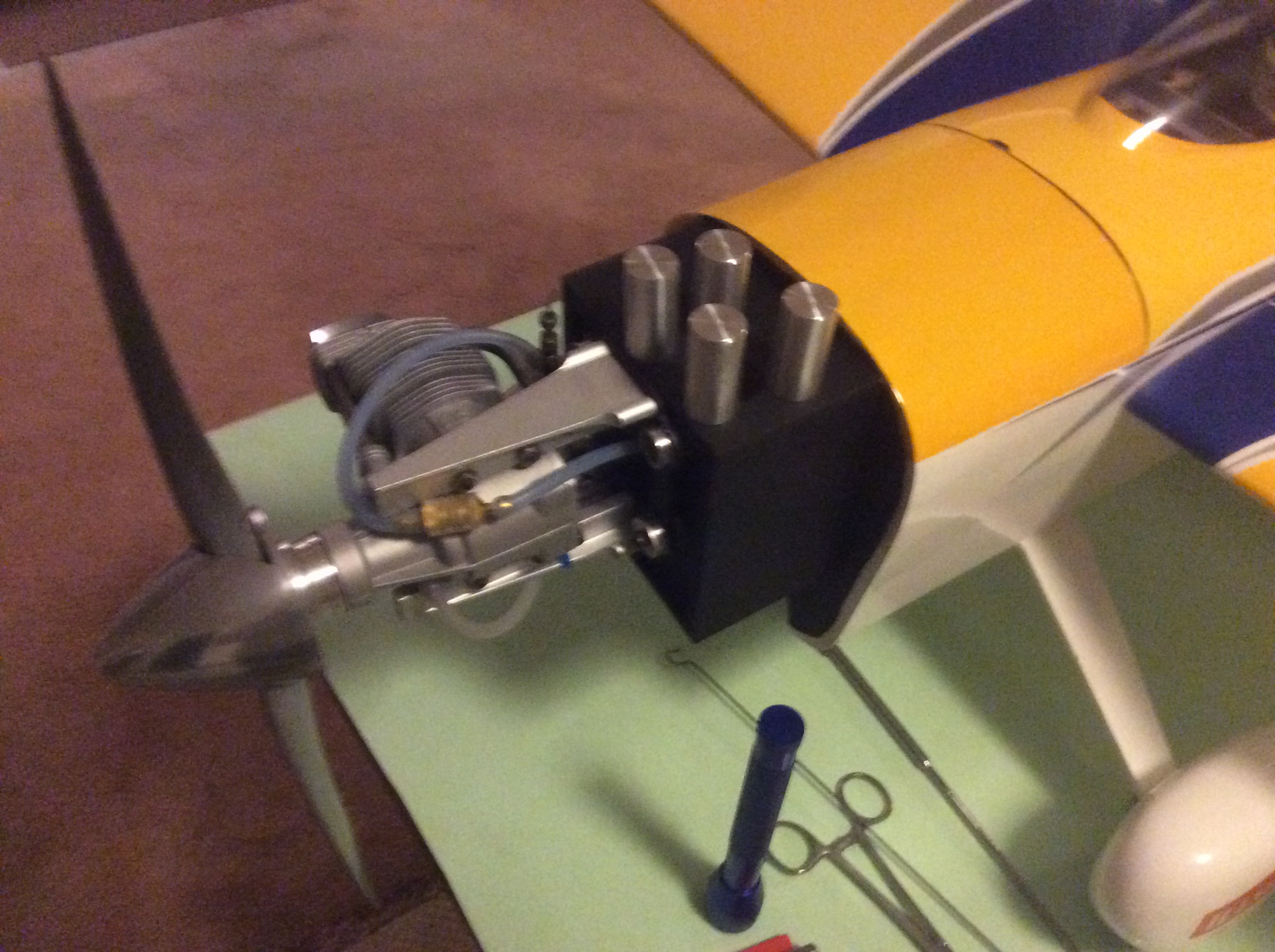

I was hoping but know better not having a cowl and going from a 35cc gas engine to OS 120 the balance is way off. Checked the balance and need to add just over a pound to the front. So now I have to decide how to do this.

Well after finding out that the Sundowner F1. Is quite tail heavy and needs a pound of weight on the motor. So made some calculations and figured out if I move the batteries onto the motor box and move the motor 1.7 inch further forward. With these changes it should balance.
Made four extension and finish off tomorrow and be installed and see how well it will balance

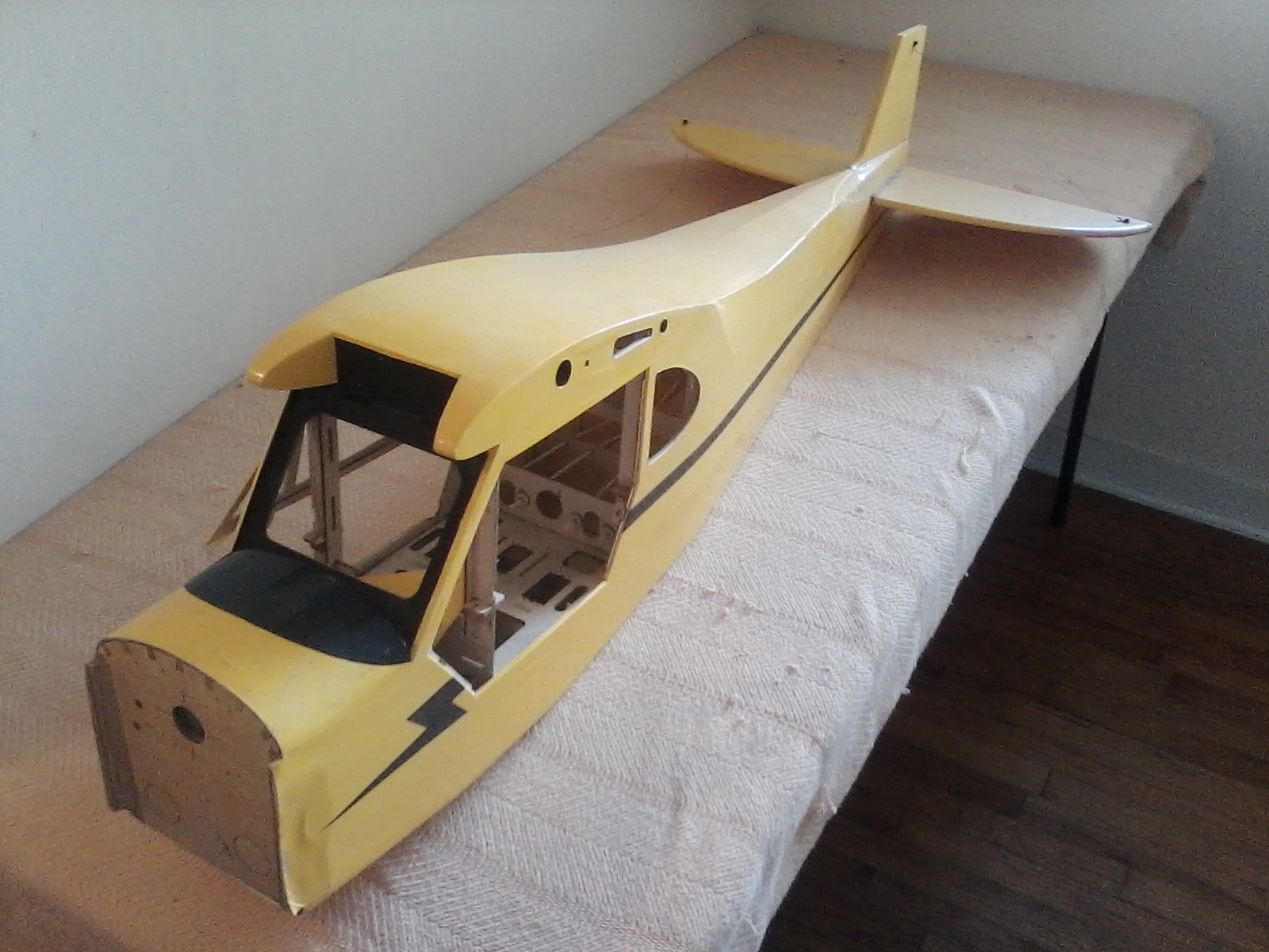

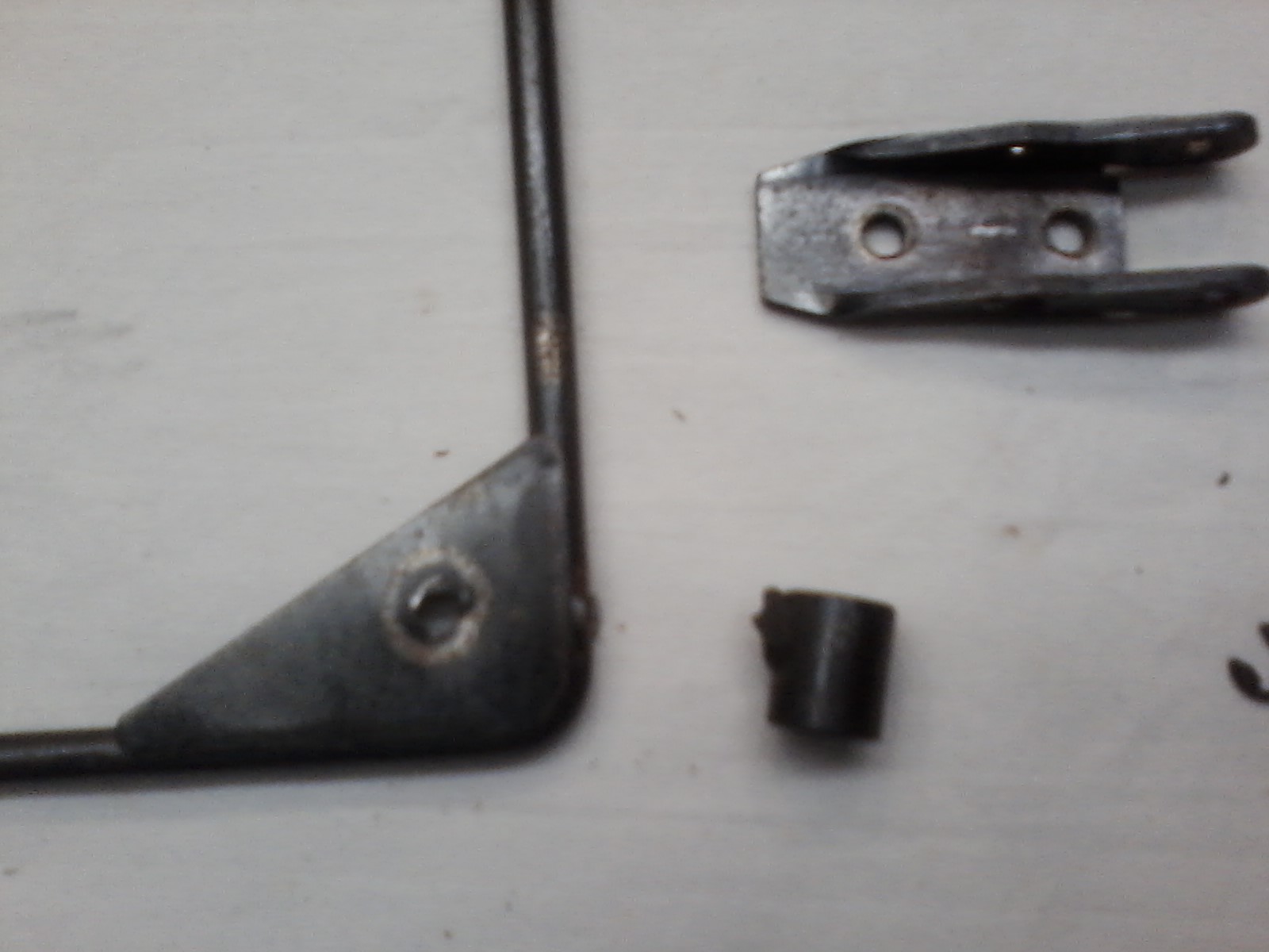

I was told a former club member donated this to the fields "recycle bin". So I decided to "restore" it :).

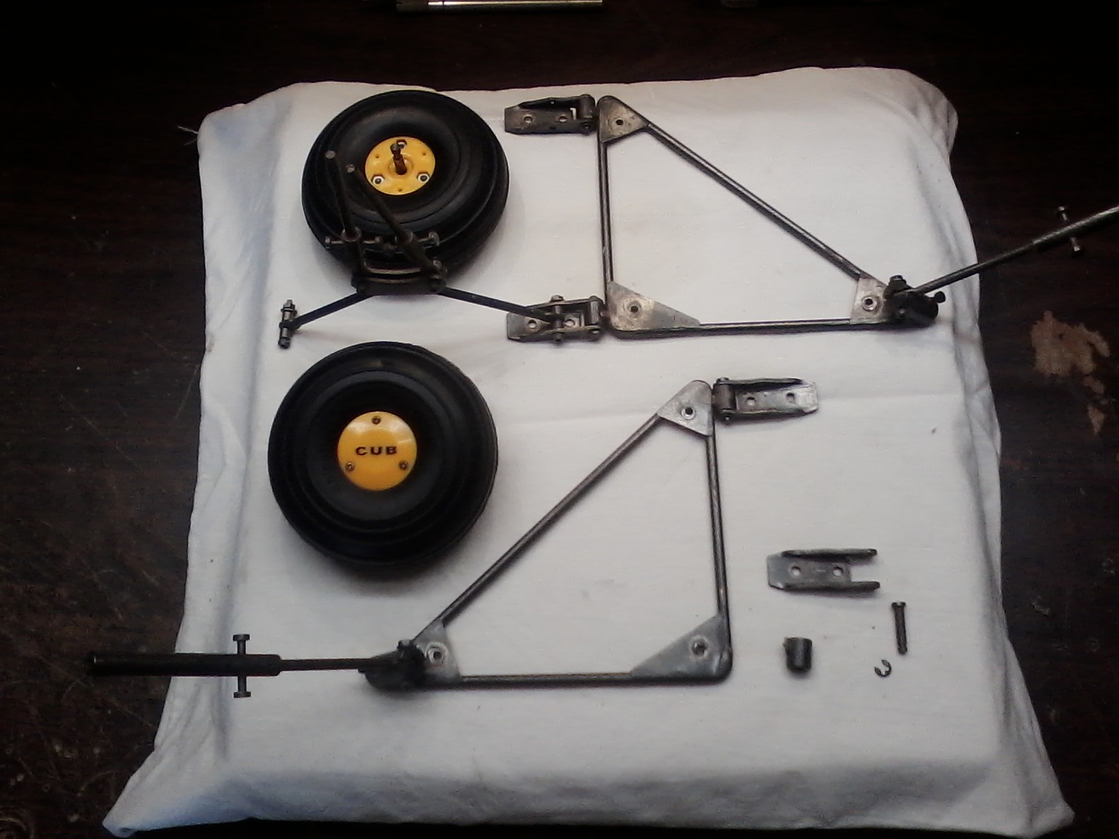

It is just the fuse and it is even missing the rudder. LG has broken weld on one of the carriers. The cub wheels were covered in garage gunk and mildew but cleaned up very well. I was surprised to see that they are not DuBros but China Model Productions. Going to see if I can find a set of wings and rudder for it (wings attach with two carbon tubes through fuse). A cowl also. It is 1:4th or 1:5th scale (Fuse measured 48.5" minus rudder ). Wheels 3.5" so I'm thinking more likely 1:5th scale which would probably be a 88-90 inch wingspan. Looking at the fuse fire wall appears to never had a motor mounted. Makes me wonder how the gear got broke :confused: and if the donator has other parts and who he is. Must investigate :sneaky:.

Hmmm.... keep us posted. Very good chance my friend up here has what you're looking for.

@49dimes I have a Sig 1/4 scale Clipped Cub I sold then bought back, apparently after someone somehow snapped the wing off at the mount. 99% of it is still good, an RCGF 26cc, switches, etc. still in place, you can have it if you want to meet half way on the interstate. The wing mount can easily be fixed. Attached is what it look's like.

Well should be an easy fix and on top of that the firewall is clean how can you crash a plane with no engine, as you said needs some investigation. That being a cub you should not have difficulty getting parts.
