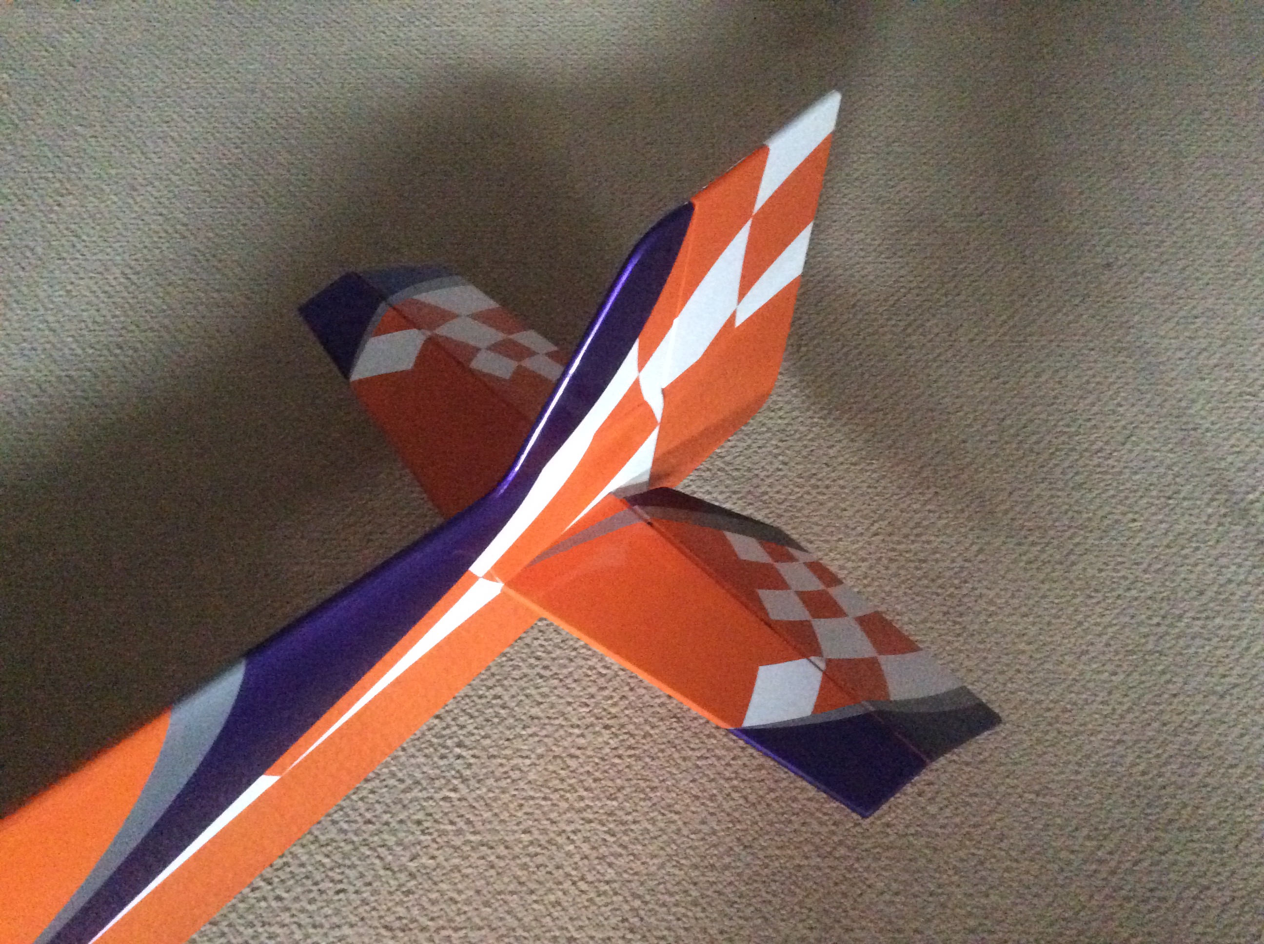

Ok continuation on the Factor 30cc rebuilding . The rudder and the stabilizer are reinstalled and covered but not the all the checkers, ran out of white and purple Monocote so I will most likely leave that for the owner to finish off. It is starting to look like a plane. Will start the motor install and then the radio.

Great video. Now you just need to come up with one for checkers (ultracote on ultracote) :)
For what you want to do on your edge it’s best to lay out each piece and tape one side so it’s in place. Also before that be sure you have gone over the base covering to shrink it really good. Then just start at one edge and tack it down. Then lift by the other end and just slowly use your iron to push it down as you go. This will help minimize air bubbles between the two layers.
Now I have done checkers on my glass before. That how I did them for my pink and purple glitter as well as the glitter jr I did for Goofy.
