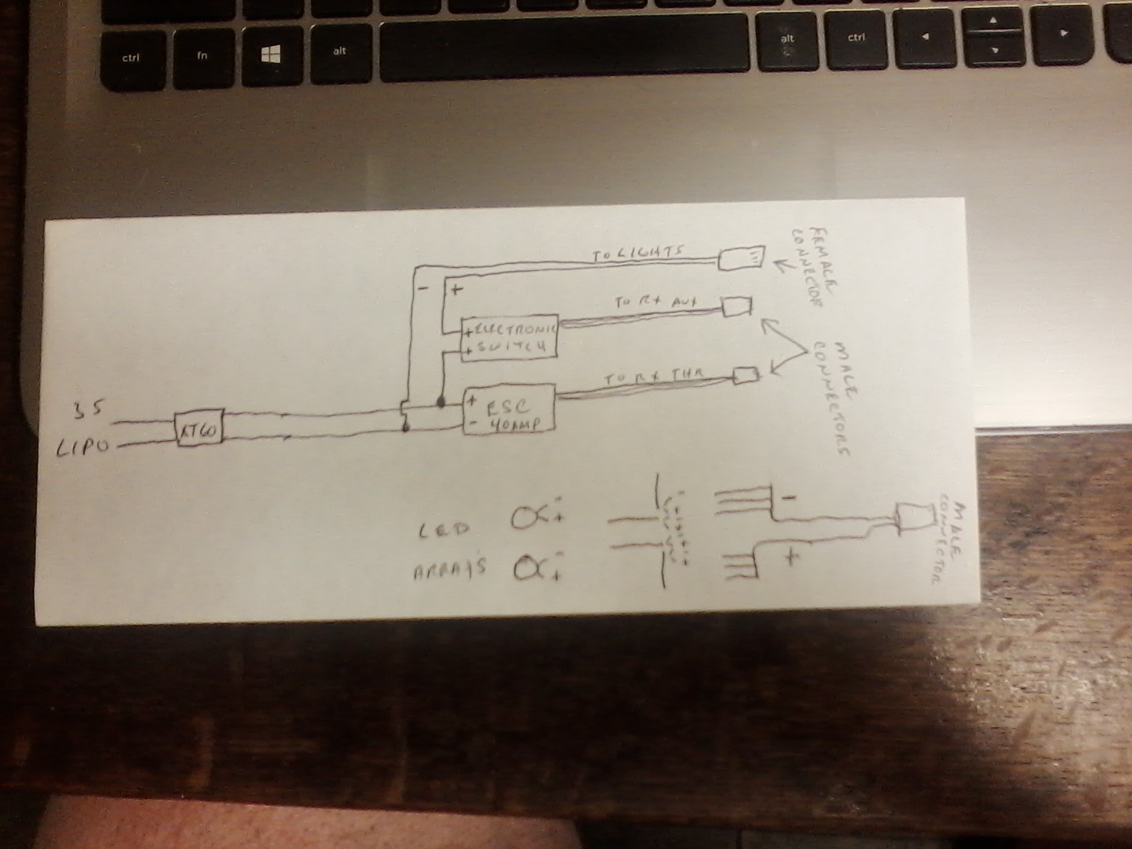

Dude... you make me want to get lights for my Twisted Edge Foamy. Any chance I can have you teach me how to set them up?

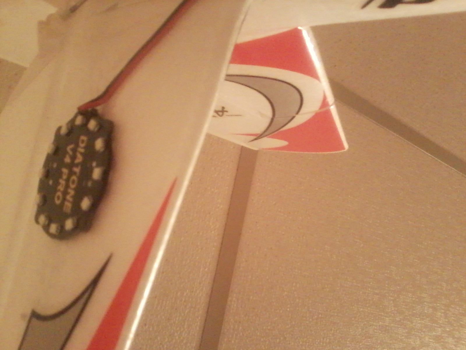

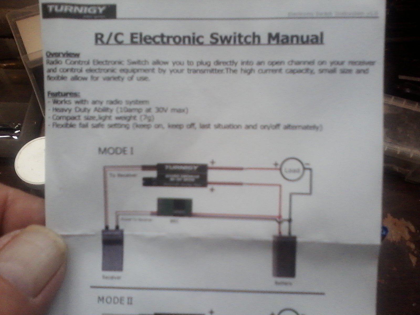

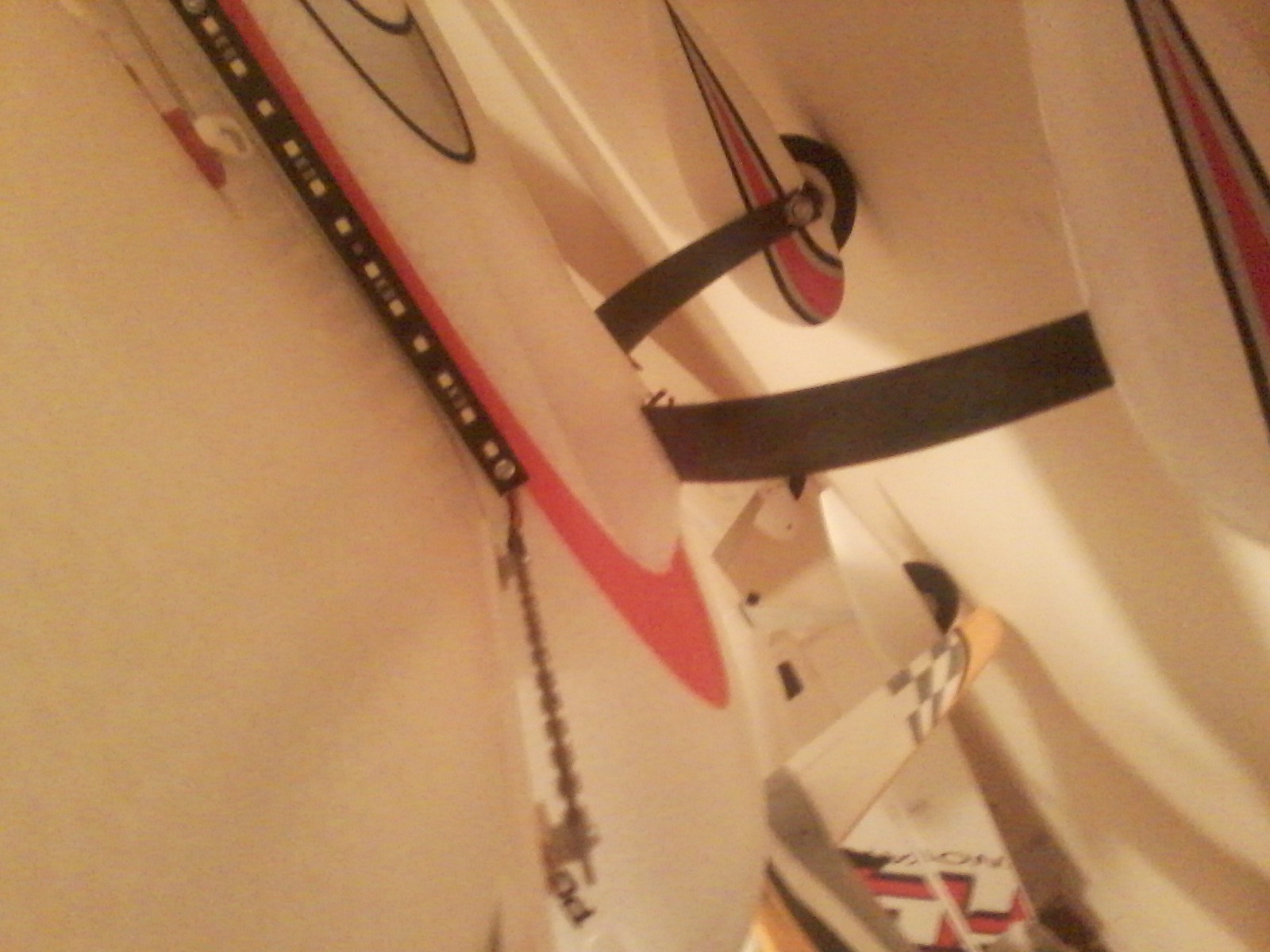

It's pretty simple. Key is having a small electronic switch to turn them on or off or even flash on off. For the wings I made some small wood mounts (thick ca) glued to the wing and used small socket head servo screws and small nylon washers (shims) to mount. For the stabs I just hot glued the light rings on.

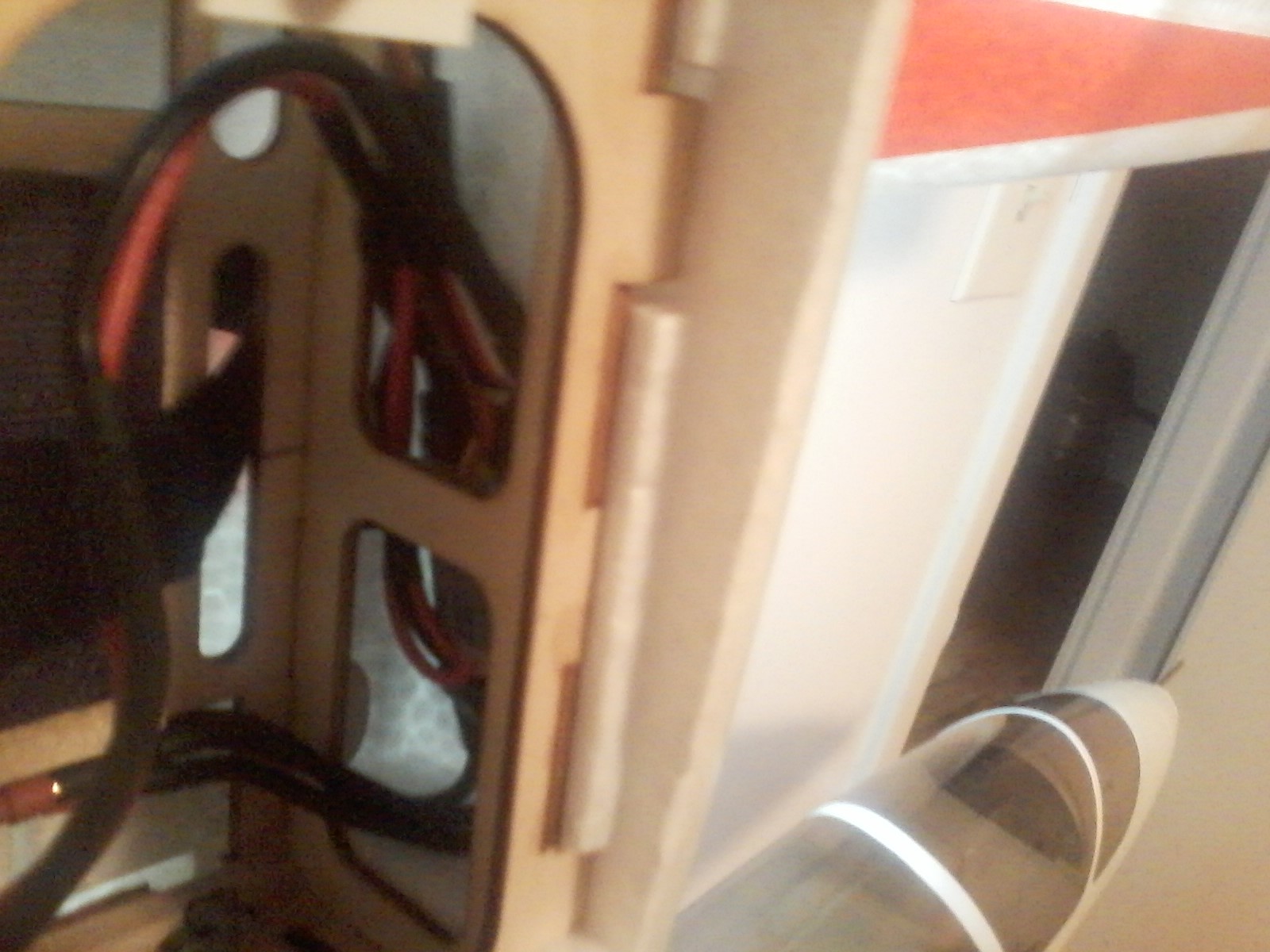

Lots of individual wires (12) two for each light bar/ring. May be a bit much weight for smaller profile foam planes. When mounting everything double check the CG for it may change a bit. I also just hot glued the electronic switch on to the ESC to make a compact unit I shoved inside the battery compartment .
