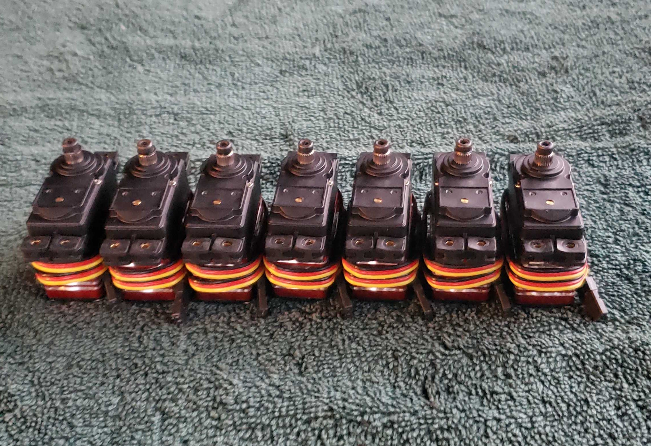

Rebuilt 7, 9380's last night with new cases. 400+ flights and still impressive that the gears are as tight as new. Off to a new owner today :)

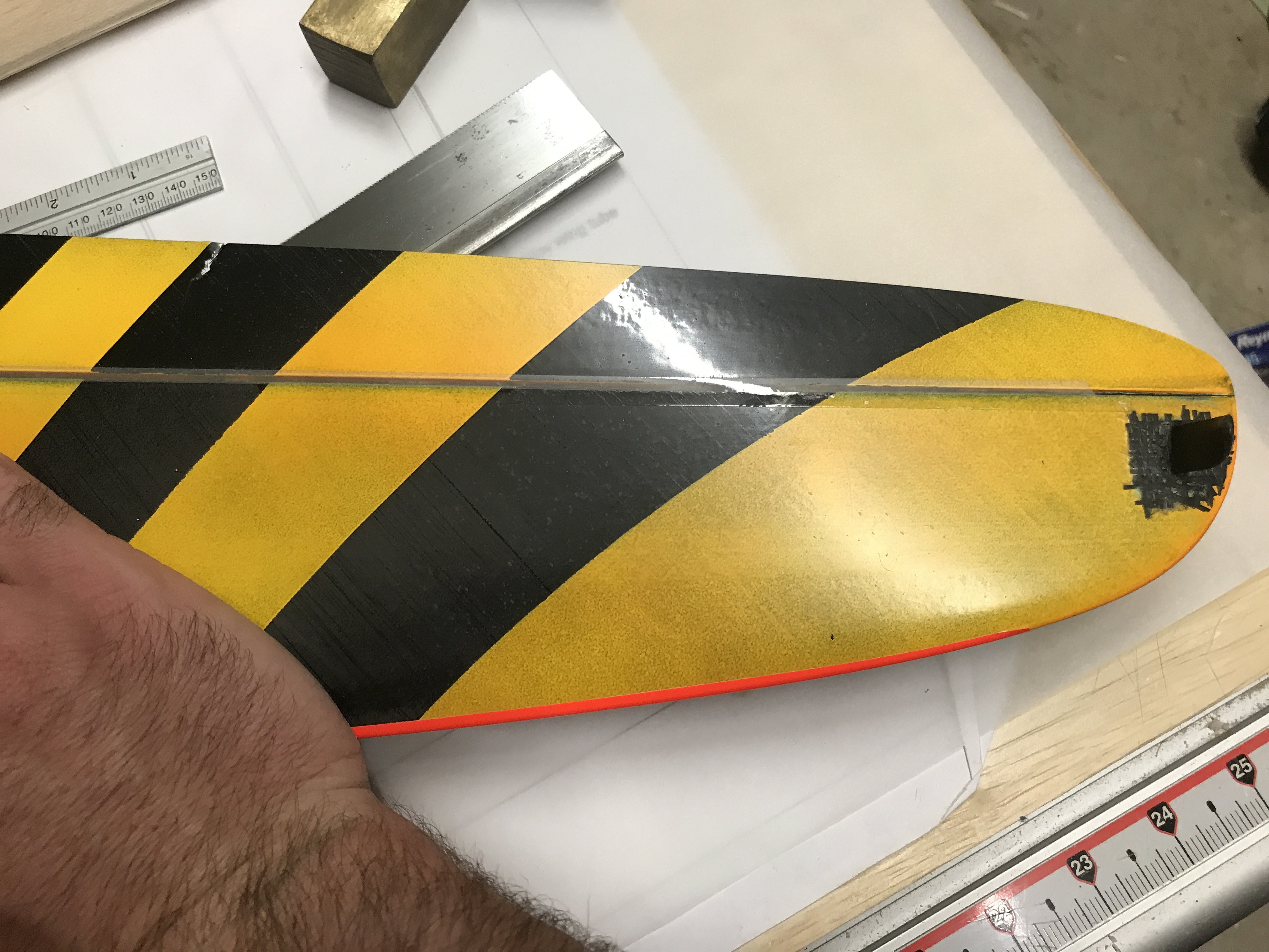

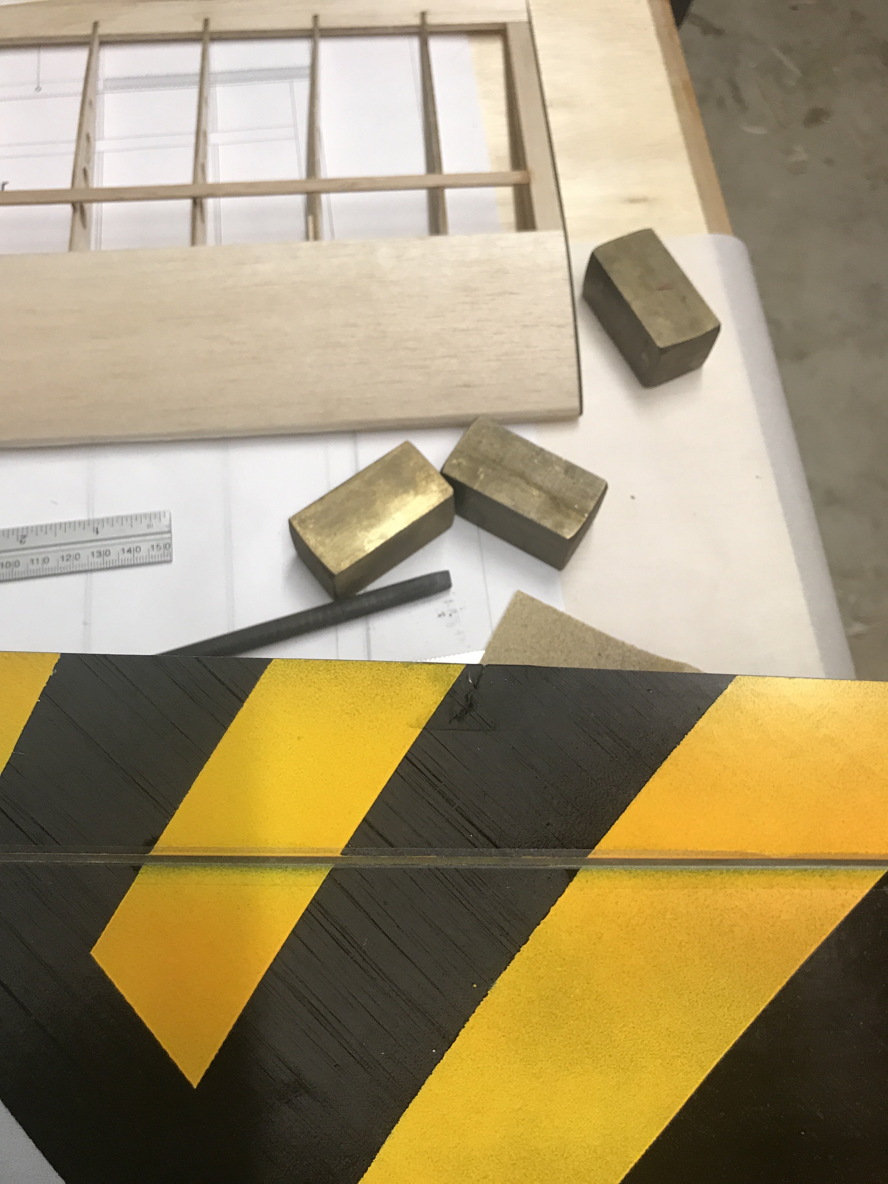

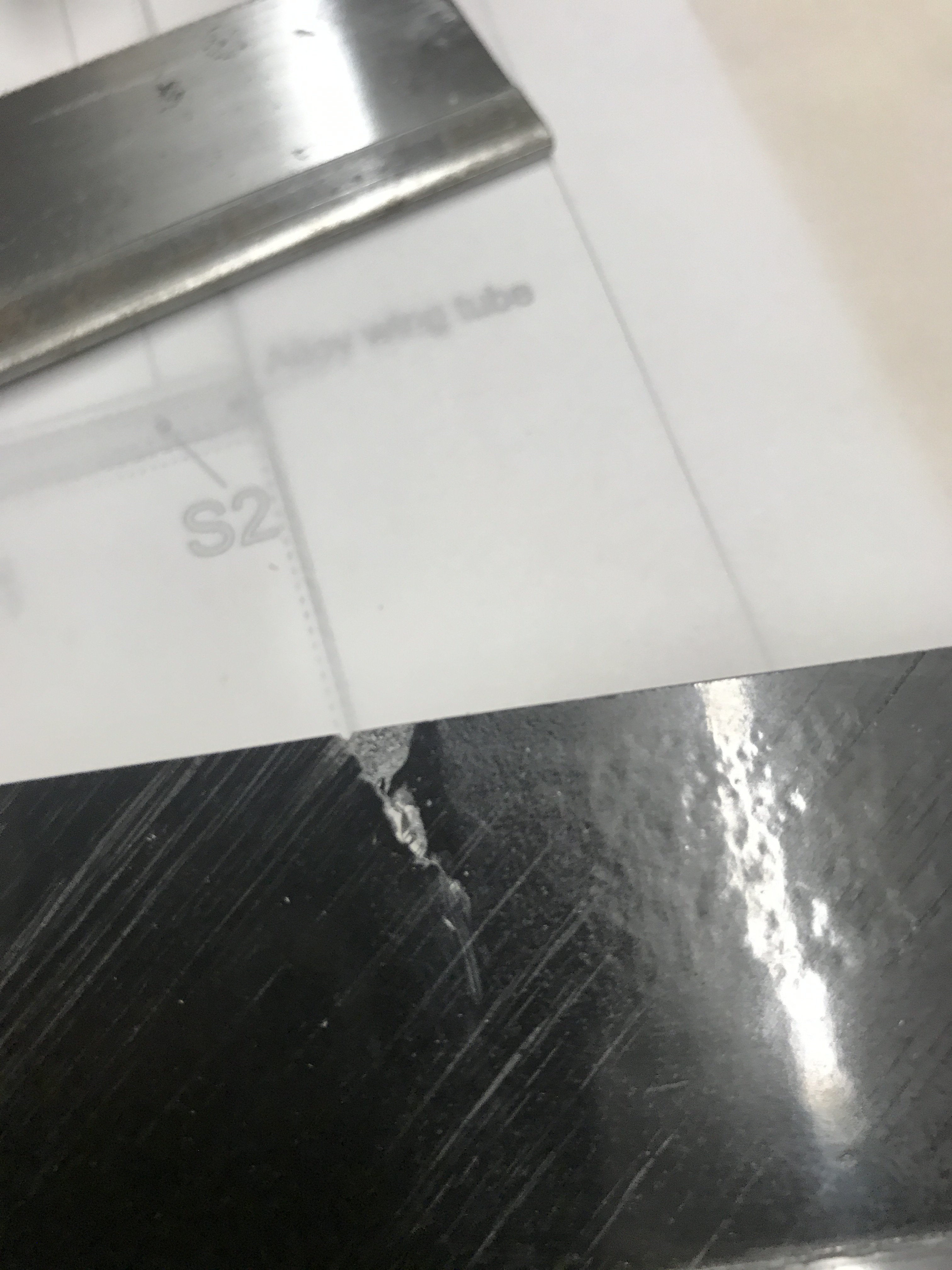

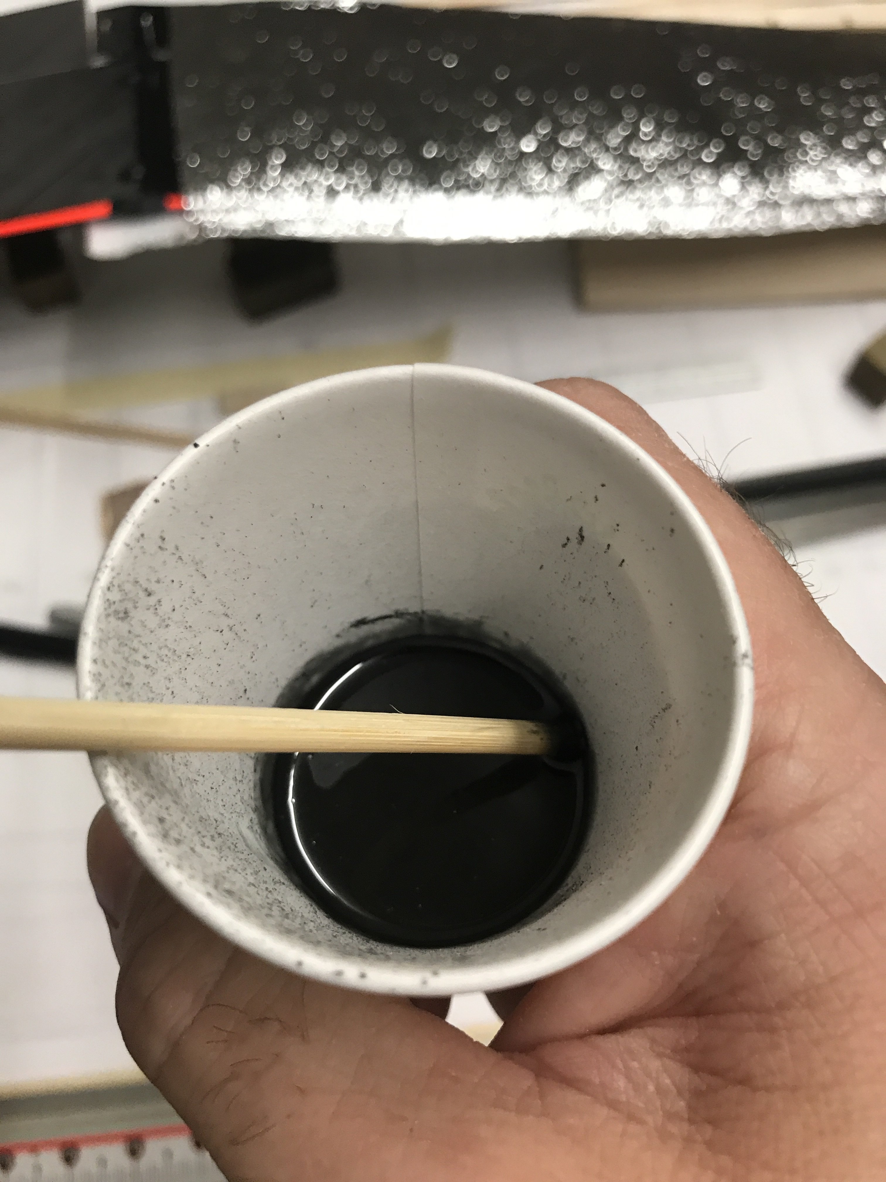

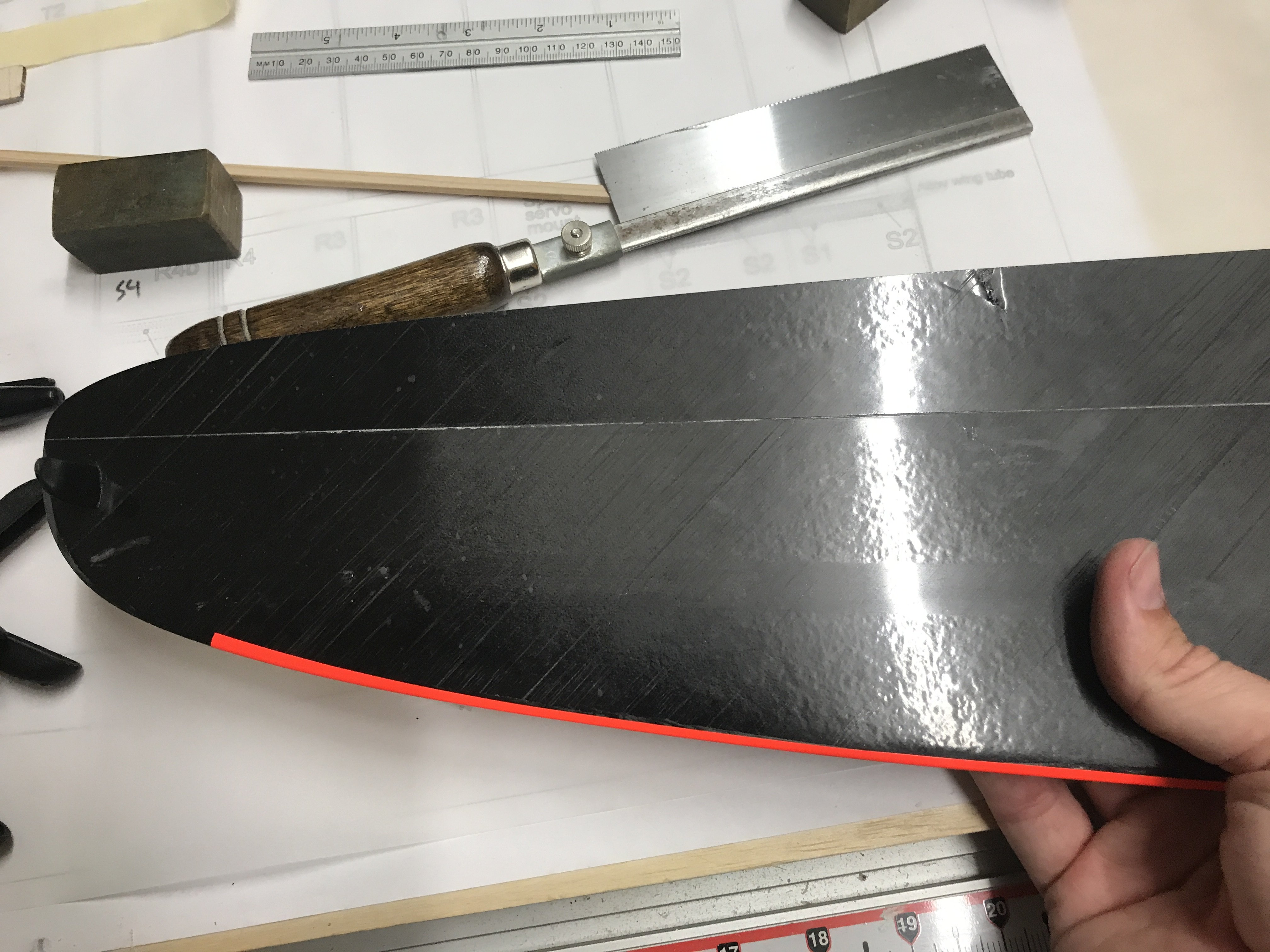

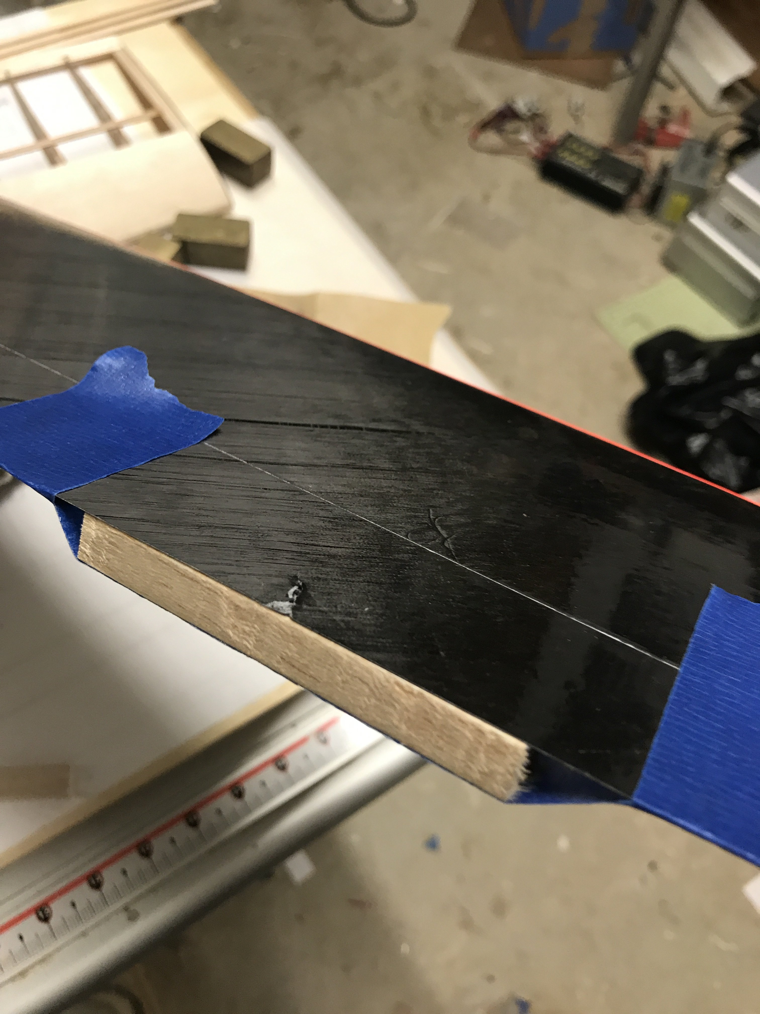

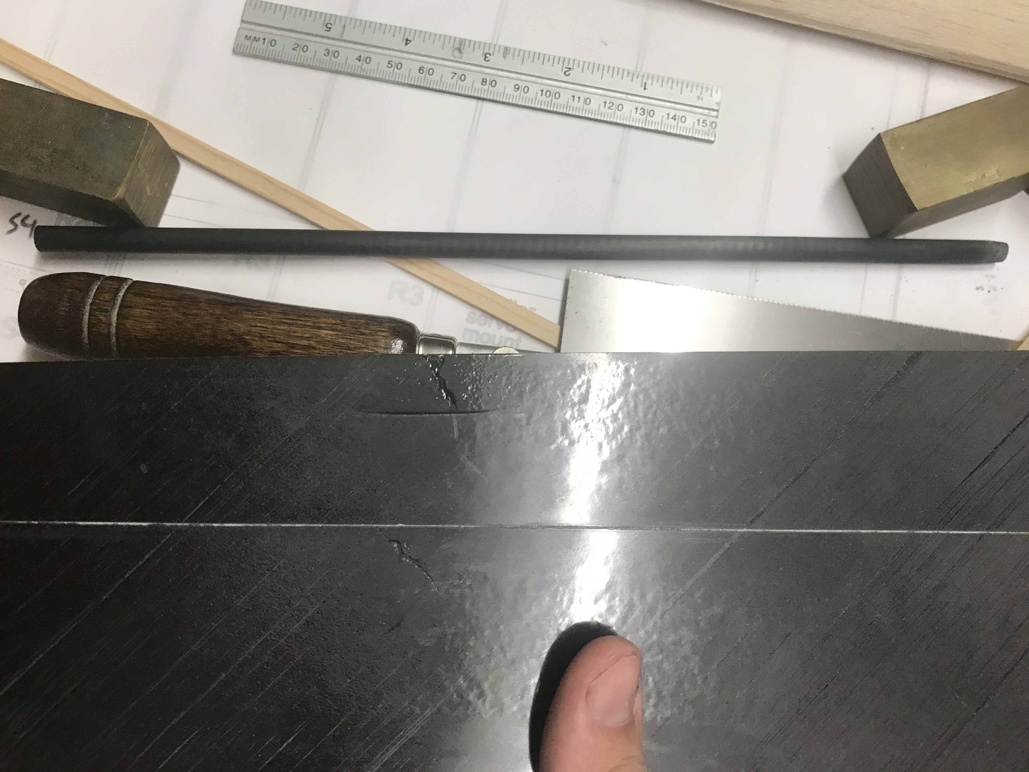

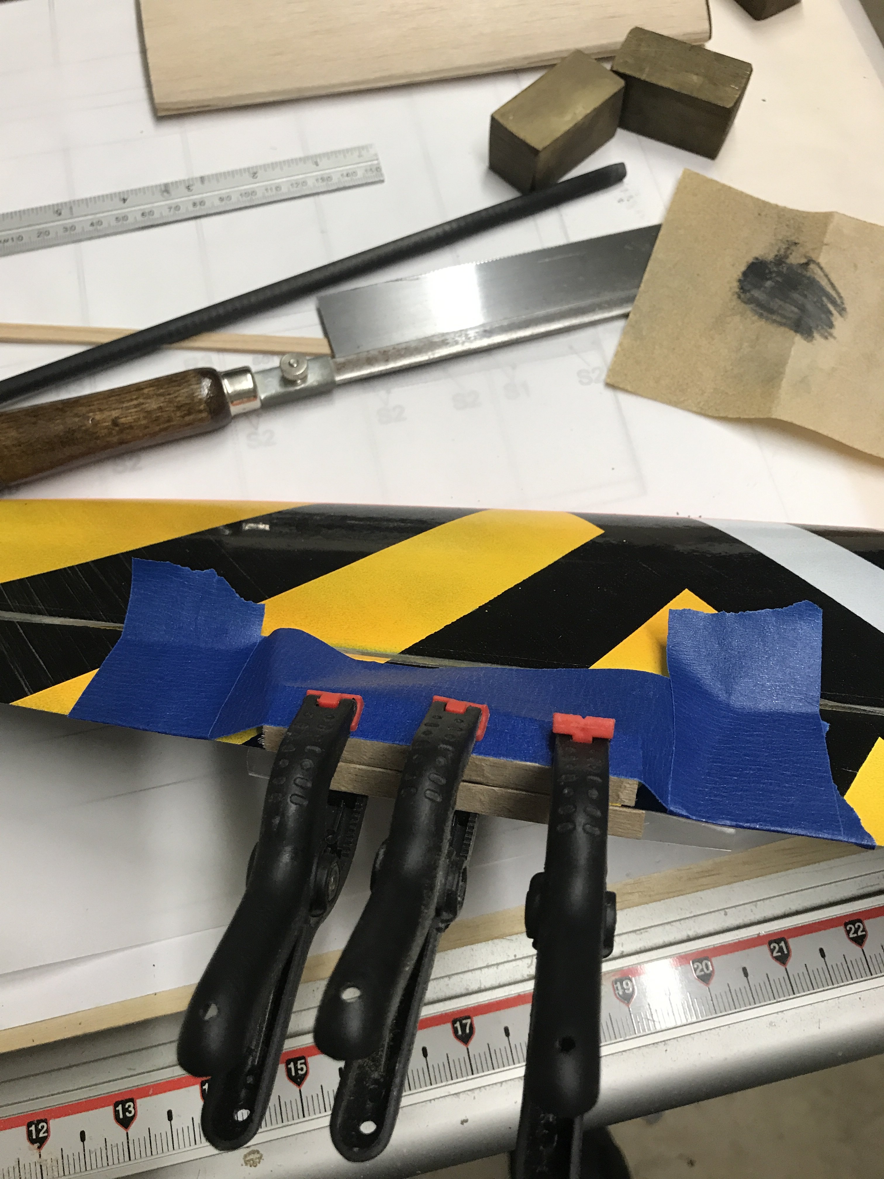

Had to do a little repair on my dlg after a dumbass moment yesterday. Buddy offered me to fly his brand new BAMF dlg. Third flight I was ending up a little short on landing and totally missed that my dlg was in the way. Caught the te of the aileron on mine with the bottom le of the vertical on his. Mine had to be repaired his will get a replacement part. Literally less than an hour flight time on his new bird and I go a F it up. Felt so horrible.
Basically just mixed up some finishing resin with some carbon fiber dust to tint it black. Will unclamp it here shortly to see how it turned out.

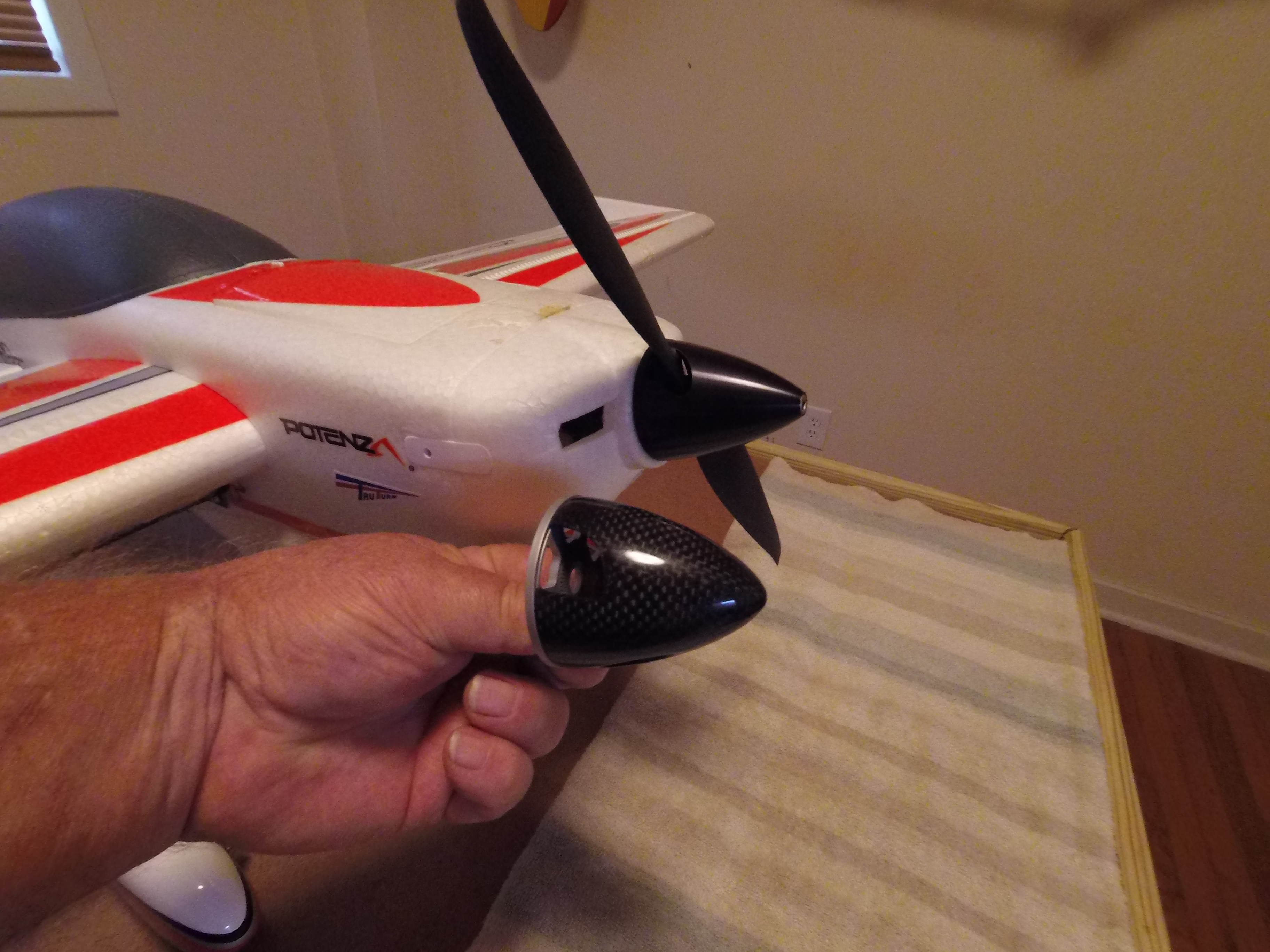

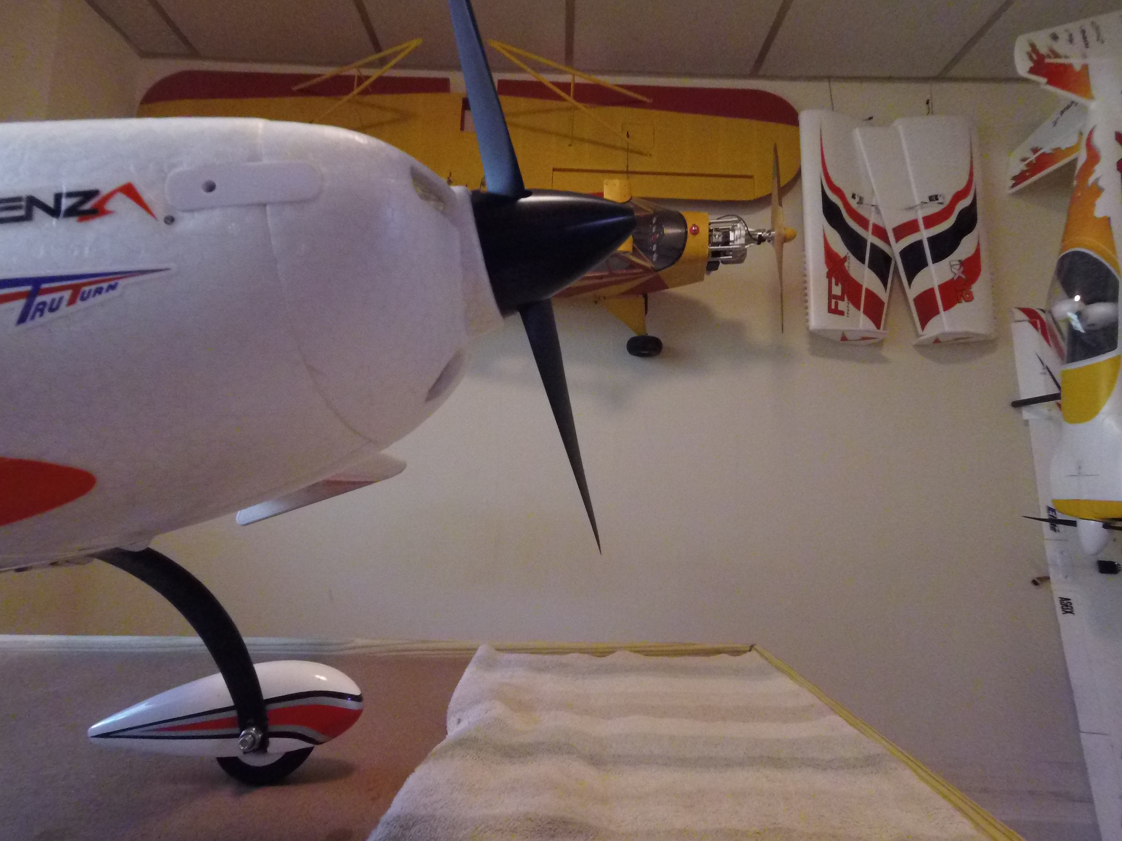

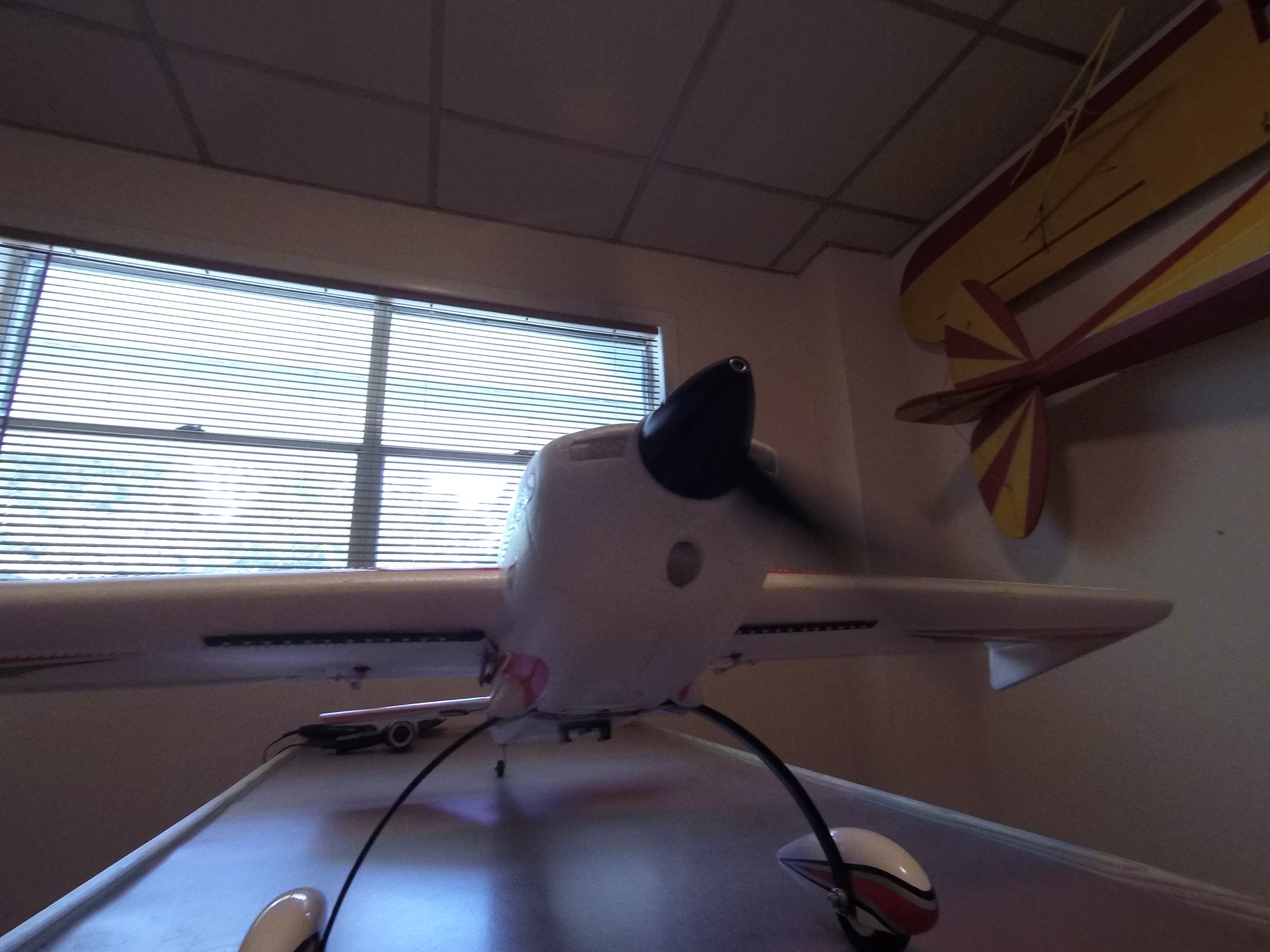

Fine tuning the "dynamic balance" of the parts that go round and round meant yet another new spinner for the QQ300 o_O.
The cone of the CF spinner is "out of round" and just wont balance good enough for my liking.
The 2" anodized black TruTurn did the trick! Spools all the way up smooth as silk now :).
