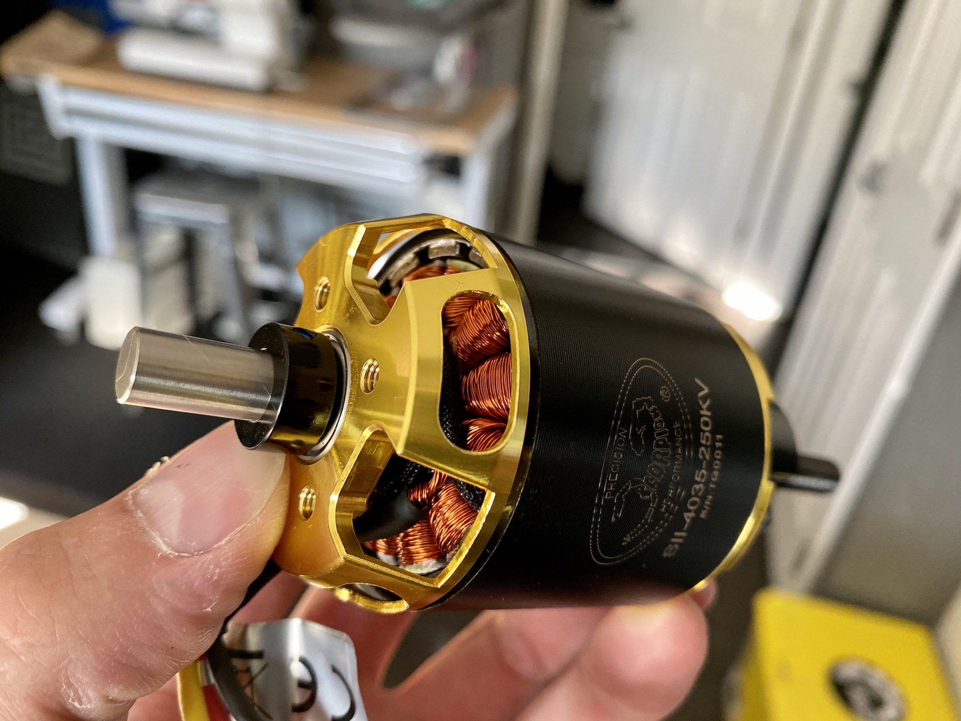

The power has arrived! Two Scorpion SII-4035-250kv motors. I'm a big fan of the 40 series Scorpions, I have 6 of them now in various lengths/kv. They will be paired with Castle Creations Edge 80HV, 10s, and 16x10 Graupner E-Props. I'll have them spinning opposite each other with reversing for landing breaks. Static thrust should be right around 20lbs each with a pitch speed of 90mph. They will be just cracking the max continuous power rating full power static, but under with any forward speed. I suspect my plane will come in just over 20lbs flight weight, so 40lbs+ static should be sufficient;) Nearly 6000watts for Twinber. :big-grin:

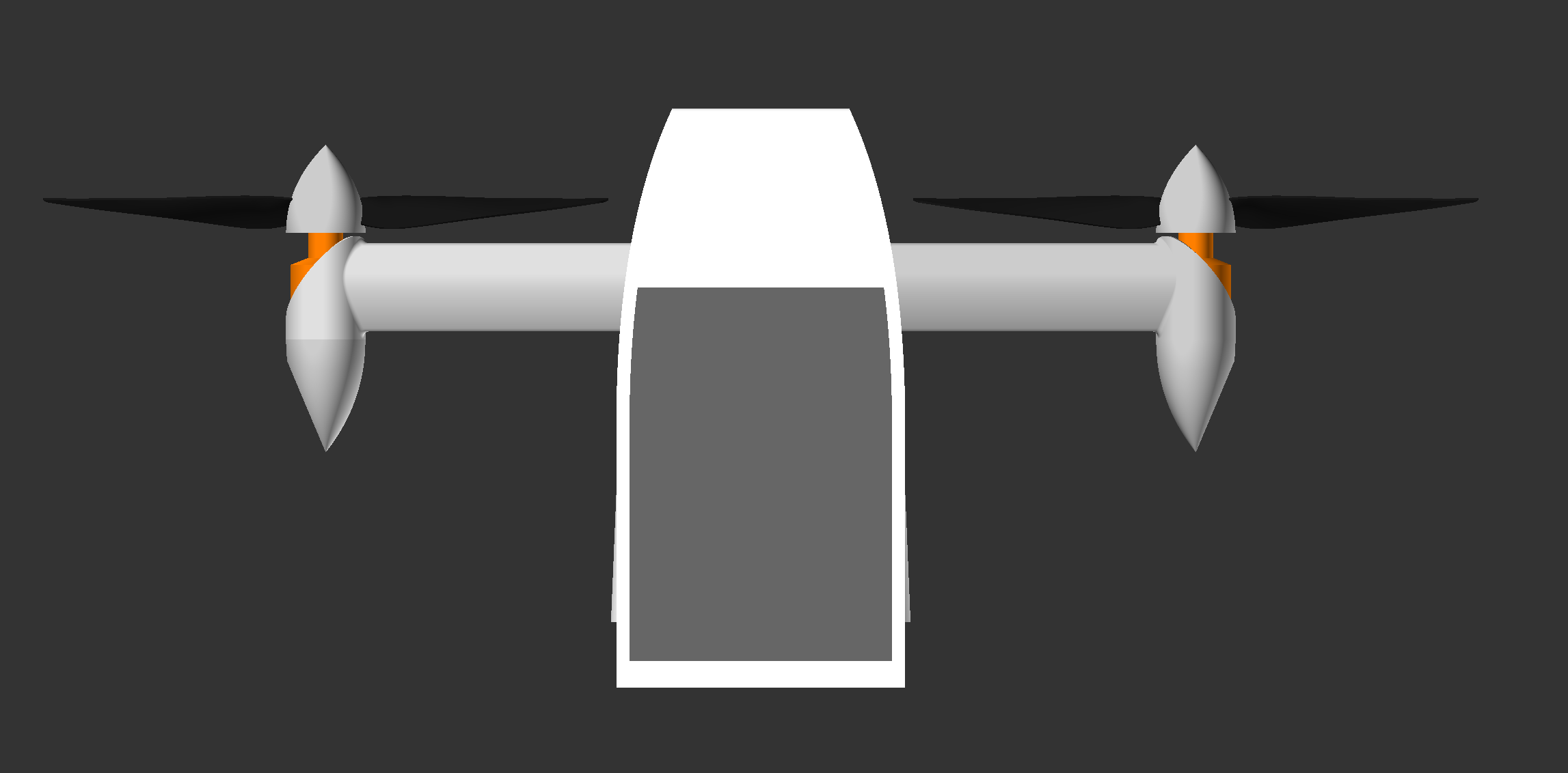

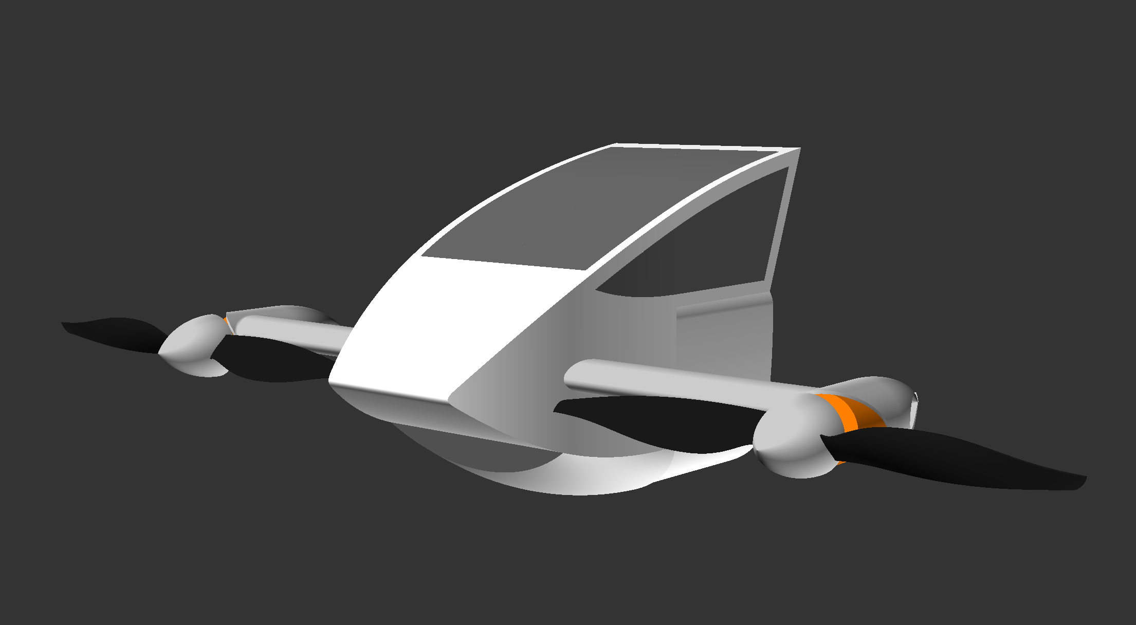

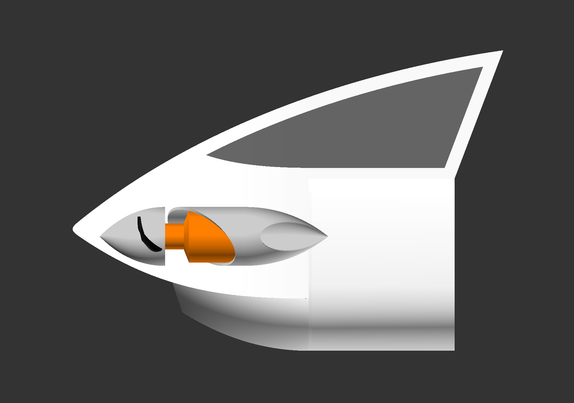

I stuffed the cardboard template in the scanner, traced in CAD, and lengthened the nose out a couple inches to give it a little more sleek appearance. The firewall/windshield area tapers and arcs in several directions which makes it difficult to line up a one piece windshild/nose cone. I'm going to compromise a perfect fit up a little for ease of building.
