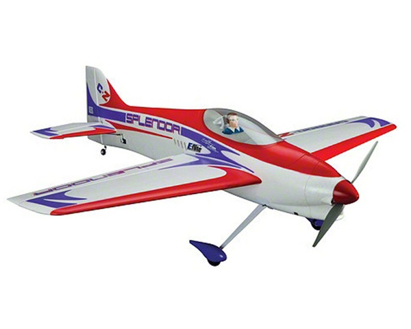

Hello, I was wondering if there are some mods I can make to my splendor to make it more 3D.
This thing is so fast on the down line, it covers the airspace quickly. Also is there a better prop I can out on it for better post stall flight. I an hover it, but the prop feels like more of a speed prop.

My Splendor is all stock. The motor is a BL50 Brushless Outrunner Motor, 525KV on a 6S pack. It runs a APC 14x7E prop, and has a 60-Amp Pro Switch-Mode BEC Brushless ESC (V2) by E-flite. My battery ranges between a 3700 to 5000 mah and AUW is around 5 1/2 LBS. I have the AS3X gains on Zero because I find that stabilizer just gets in the way when you are trying to Huck-it around. It would be nice if you could flip it on and off with a switch, because its was nice on landing when dealing with choppy wind and random gusts.

Just looking at the above, would say you should try propping up to a 15x6 or 15x7 to get more grunt out of the motor, and to get some more air over the tail in post stall. Check the 15" props with a watt meter, and try and keep the continuos full power draw at 60a or less... Momentary bursts over 60 are ok.
Also, those big 6s5000 packs belong in a 10lb plane.... Try and get comfy with the 3700, or even down to a 3300.
My preference in the 55-60" wingspan size is a 500kv motor, 15x8 prop, 6s 3000-3300mah packs, (eflite recommends 3200) and as close to 5lb or less as I can get.
You can switch your AR635 to sport mode and that will give you two different adjustable gain banks, set the gain on one to 0 to be able to turn it off. You'll lose the preset lo/hi rates though and each bank will have full throw.

@ Gyro, I have some 3700 packs. I will try them. I just like the longer flight times with the 5000's But to make it a better 3D plane, I will try the smaller packs and change the prop.
