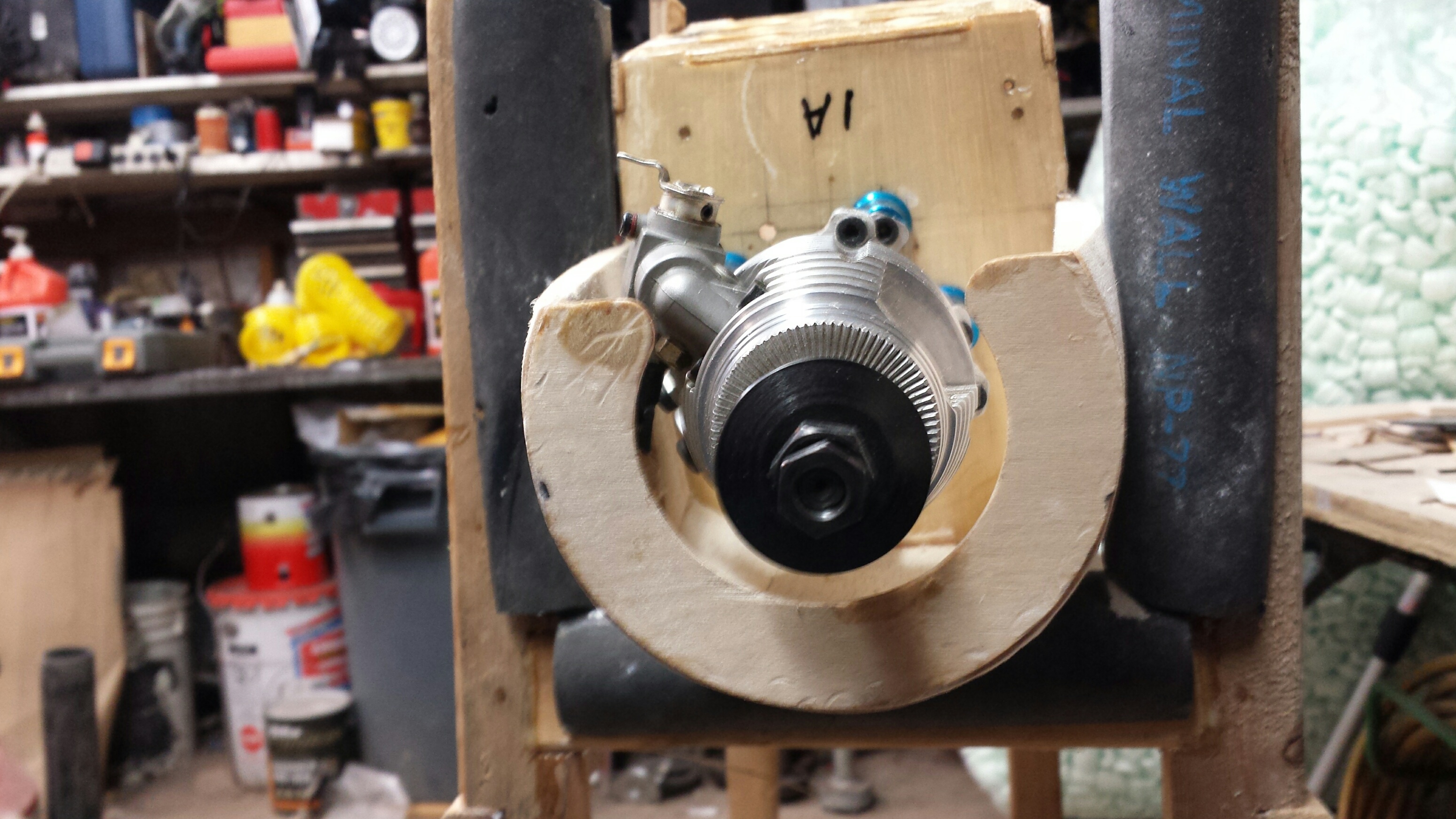

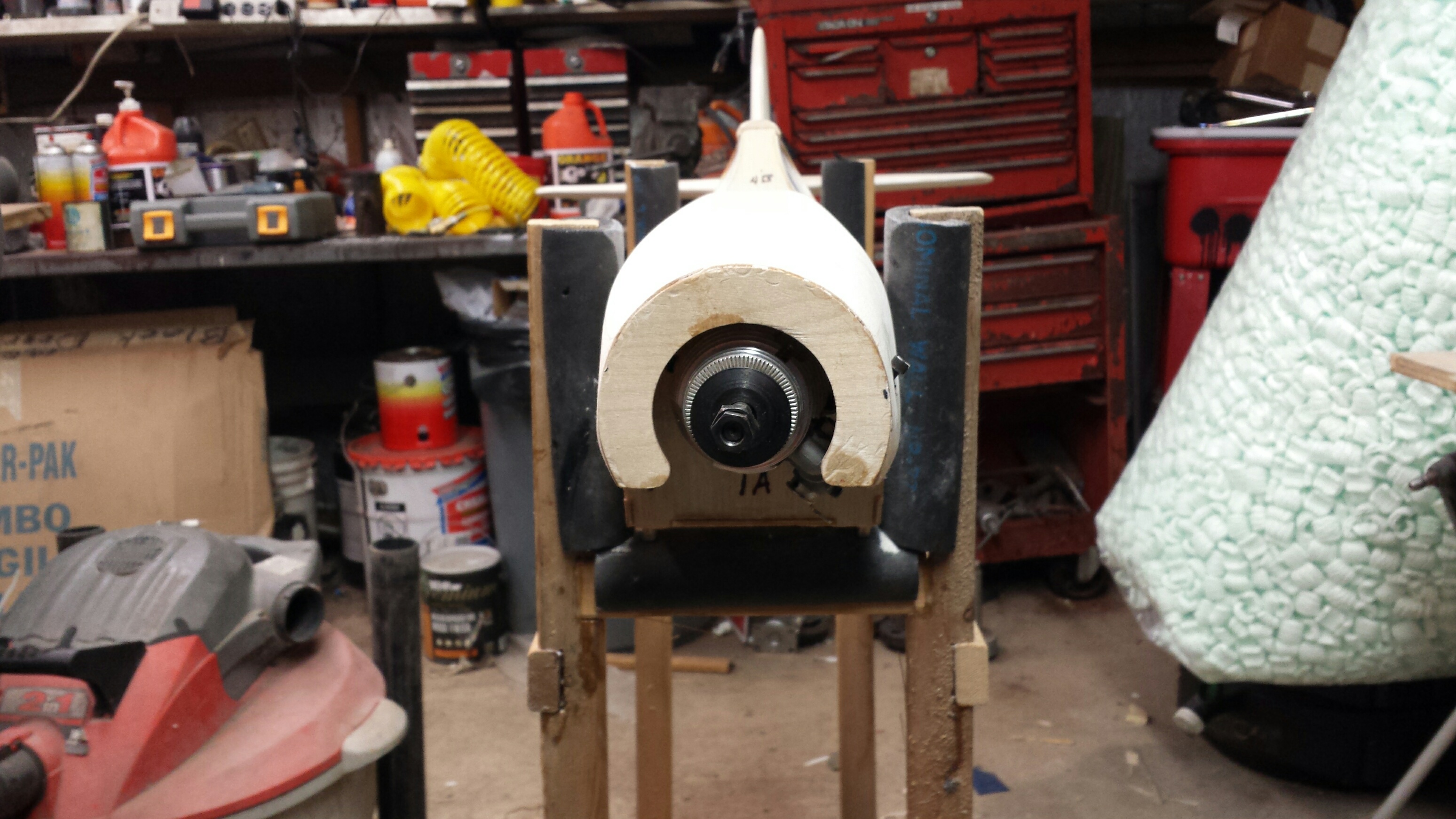

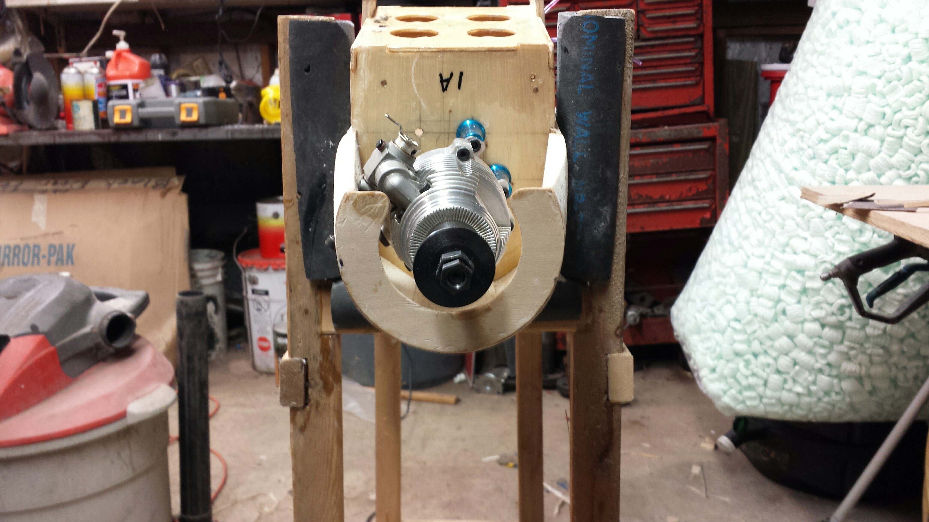

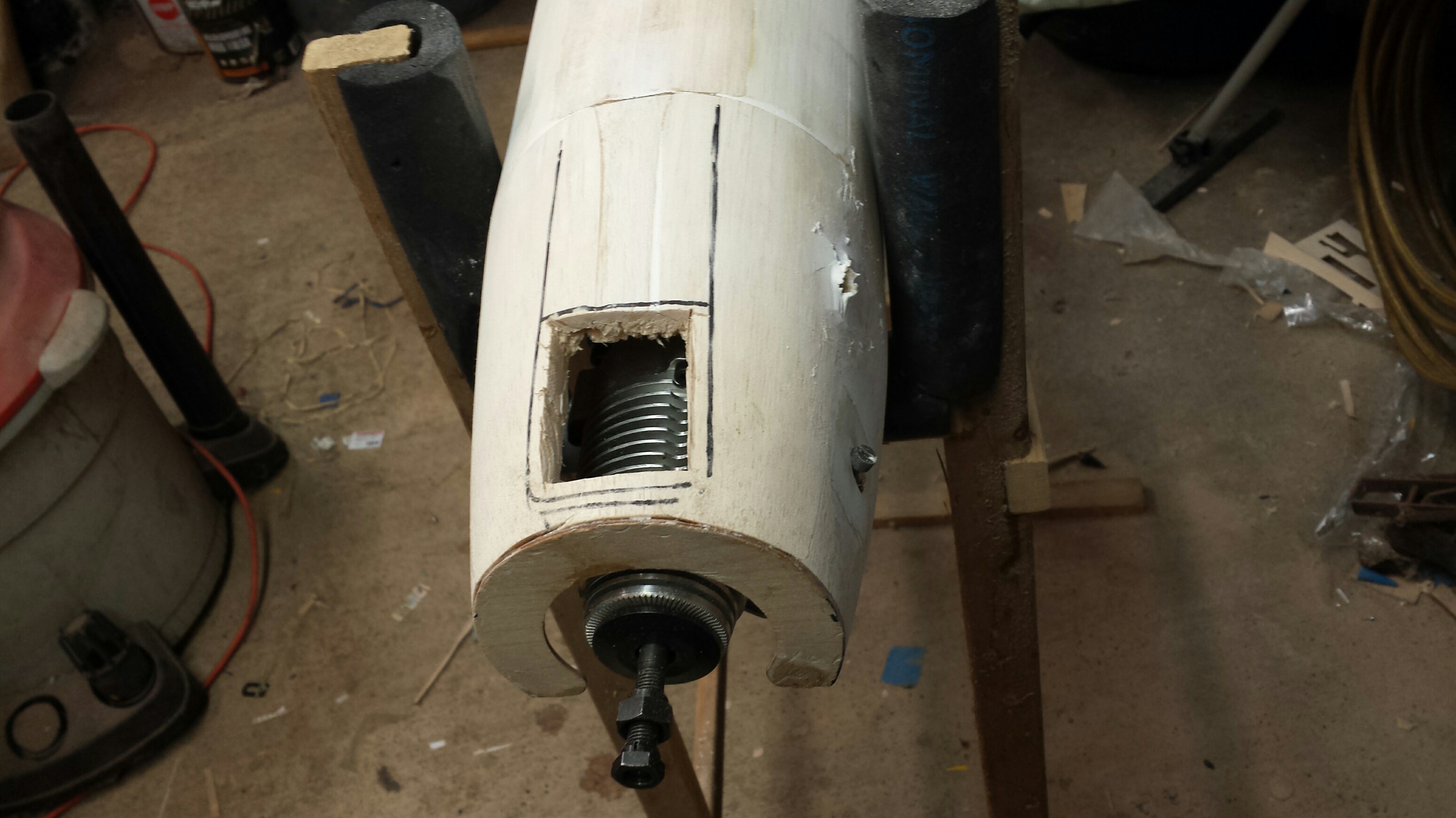

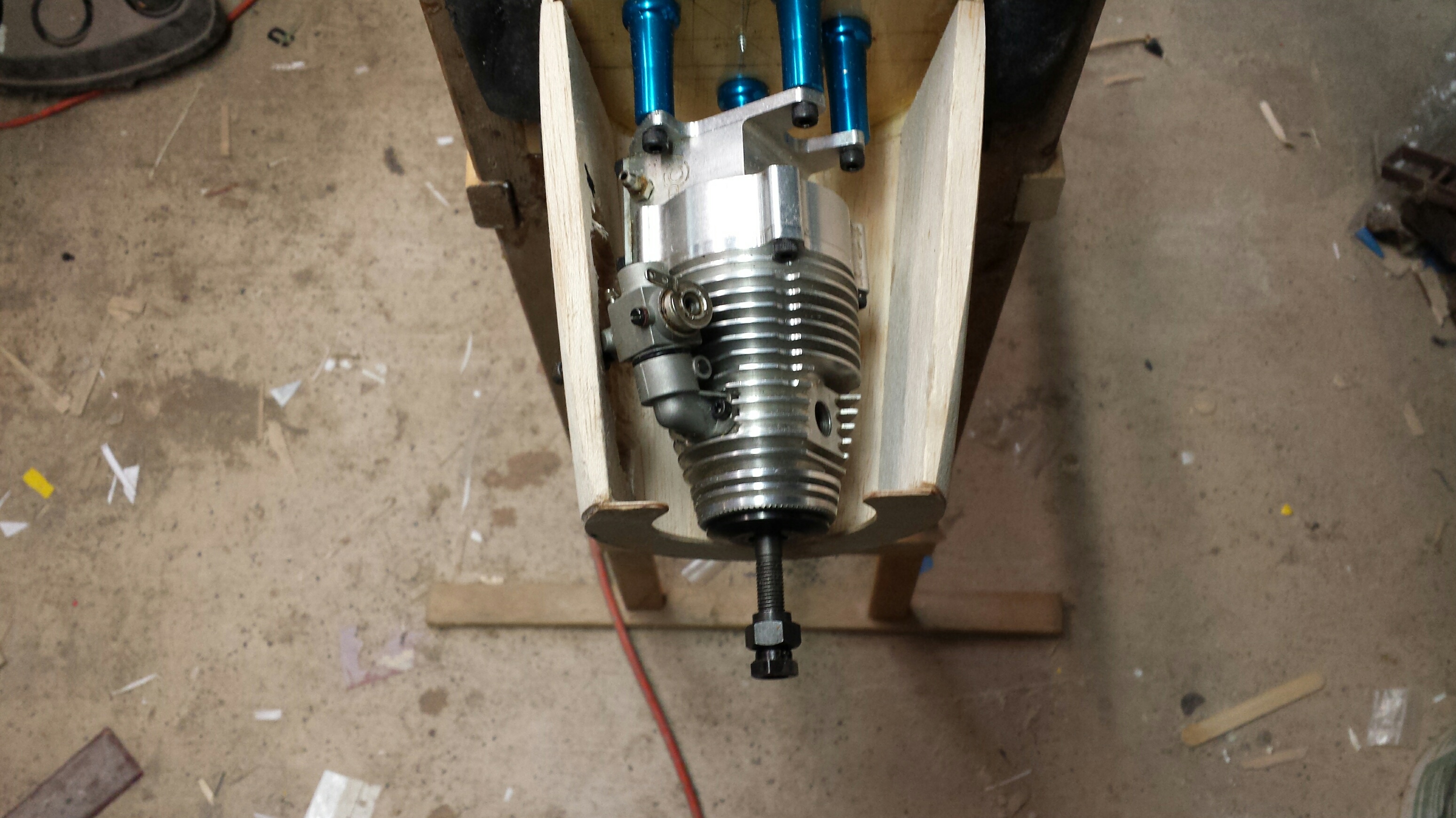

Another cool feature with the engine is because the prop is driven through a 2 to 1 reduction you can't start it with the prop but instead it is started by putting an allen wrench  the the allen bolt in the end of the crank on top of the engine and the allen wrench can be attached to a battery powered drill or electric starter motor and can be accessed through a small hole in the model. They are built is a very small shop in the UK and have just never been very popular here in the states I bought the three I have about ten years back on ebay from the UK. I have a 120 in a biplane, this 90 and a 60 that I haven't mounted yet.
