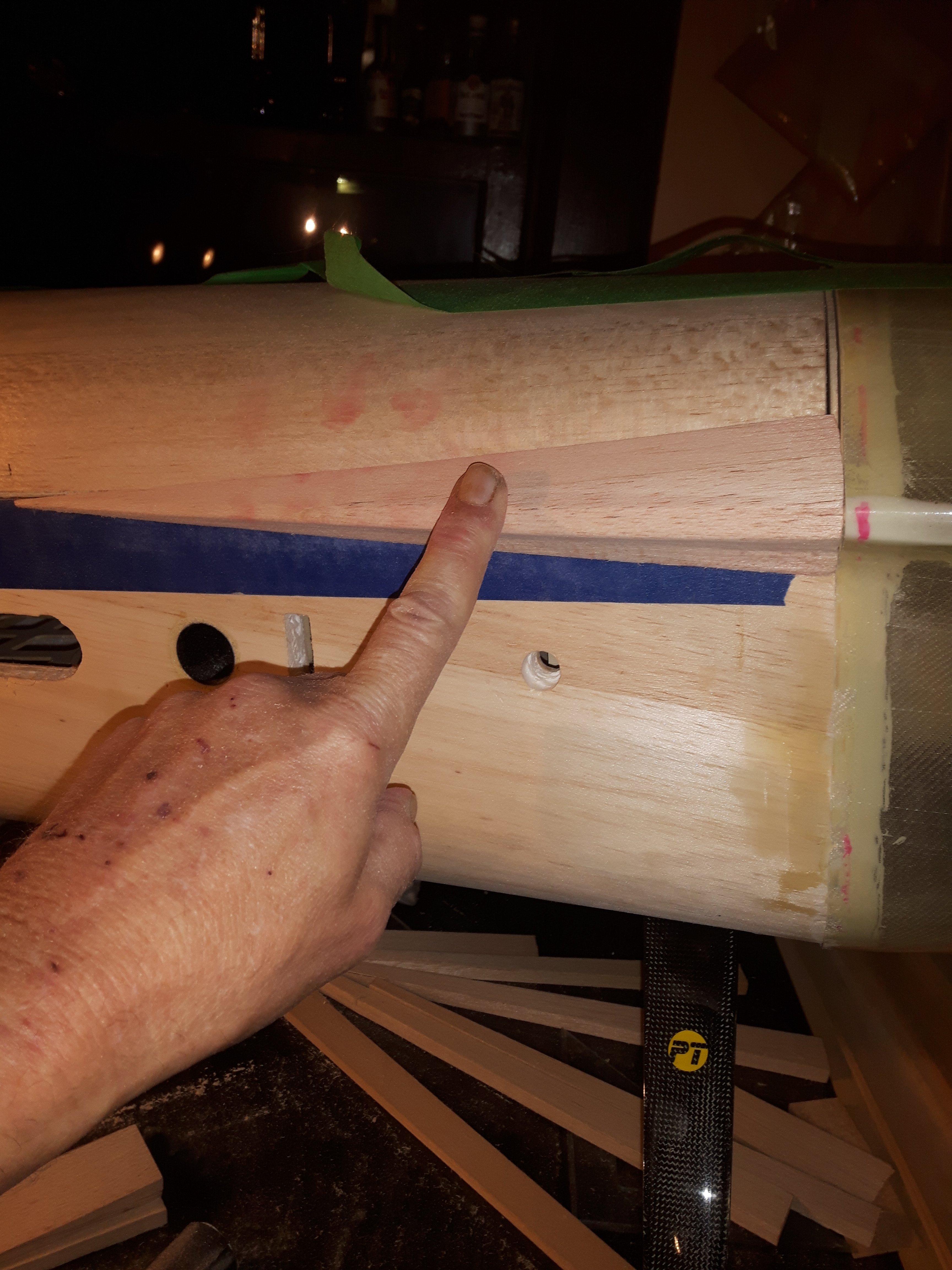

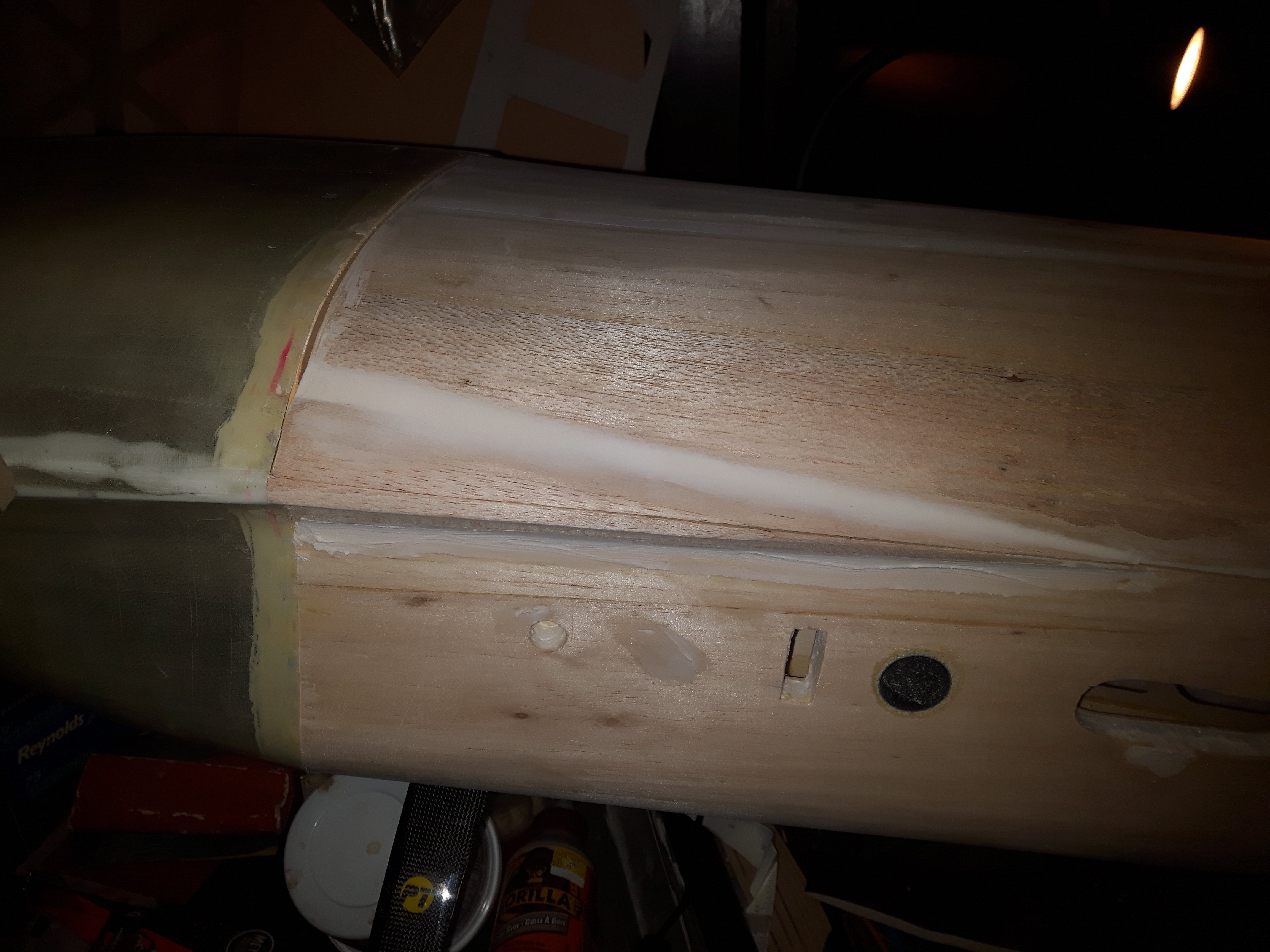

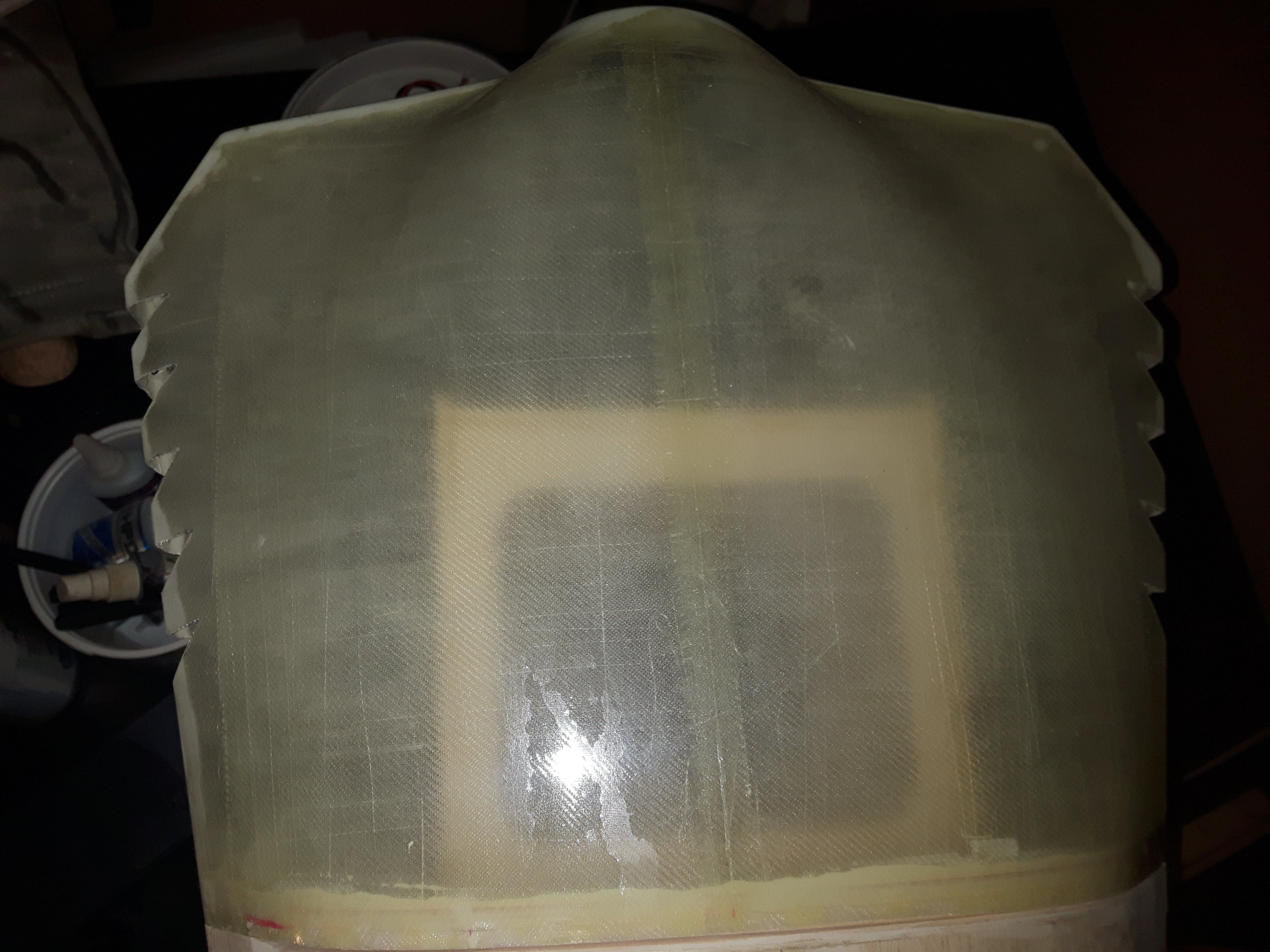

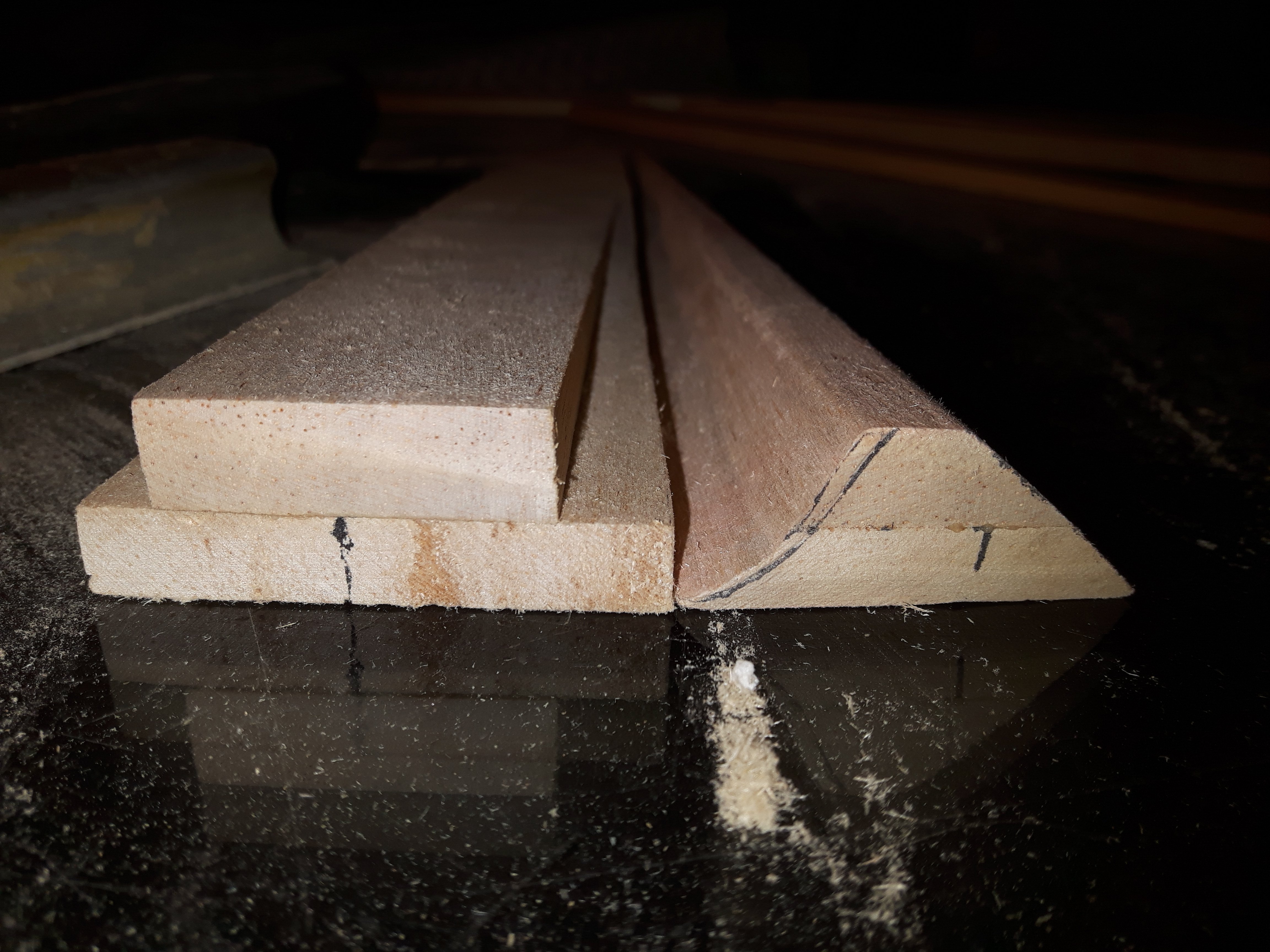

    Back at the plane again. Had to shape the two extensions for the cobra cowl. I did them in one piece, when I was happy with the fit I cut them very very carefully in half. They turned 20210210_192245.jpg 20210210_192153.jpg 20210210_192245.jpg 20210210_192153.jpg 20210216_185354.jpg 20210216_185354.jpg out good enough for me!

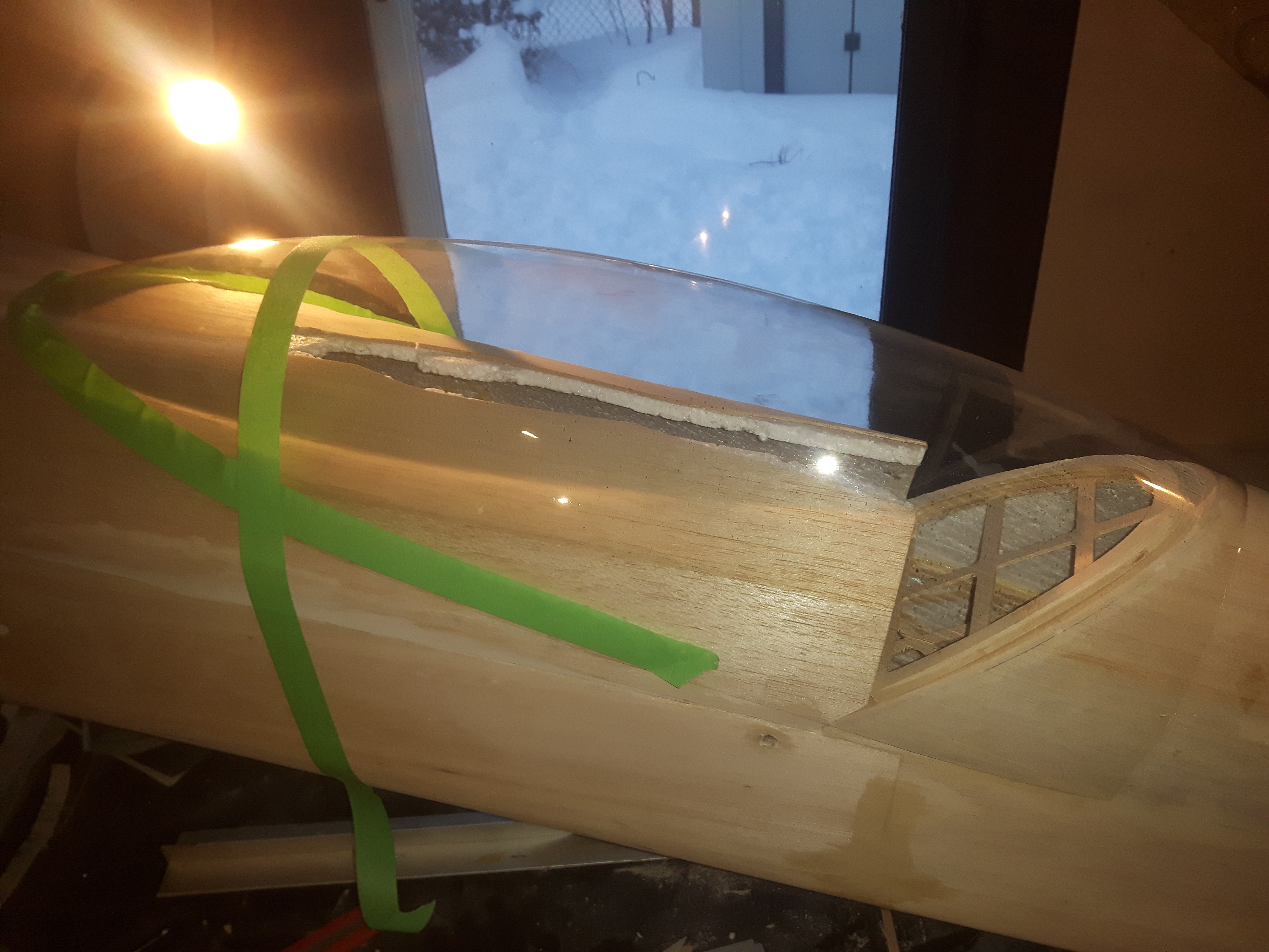

    Next up was fitting the canopy. Was a bit nervous about this as you only get one shot at doing it right. But I have it to a perfect fit. 20210216_173934.jpg

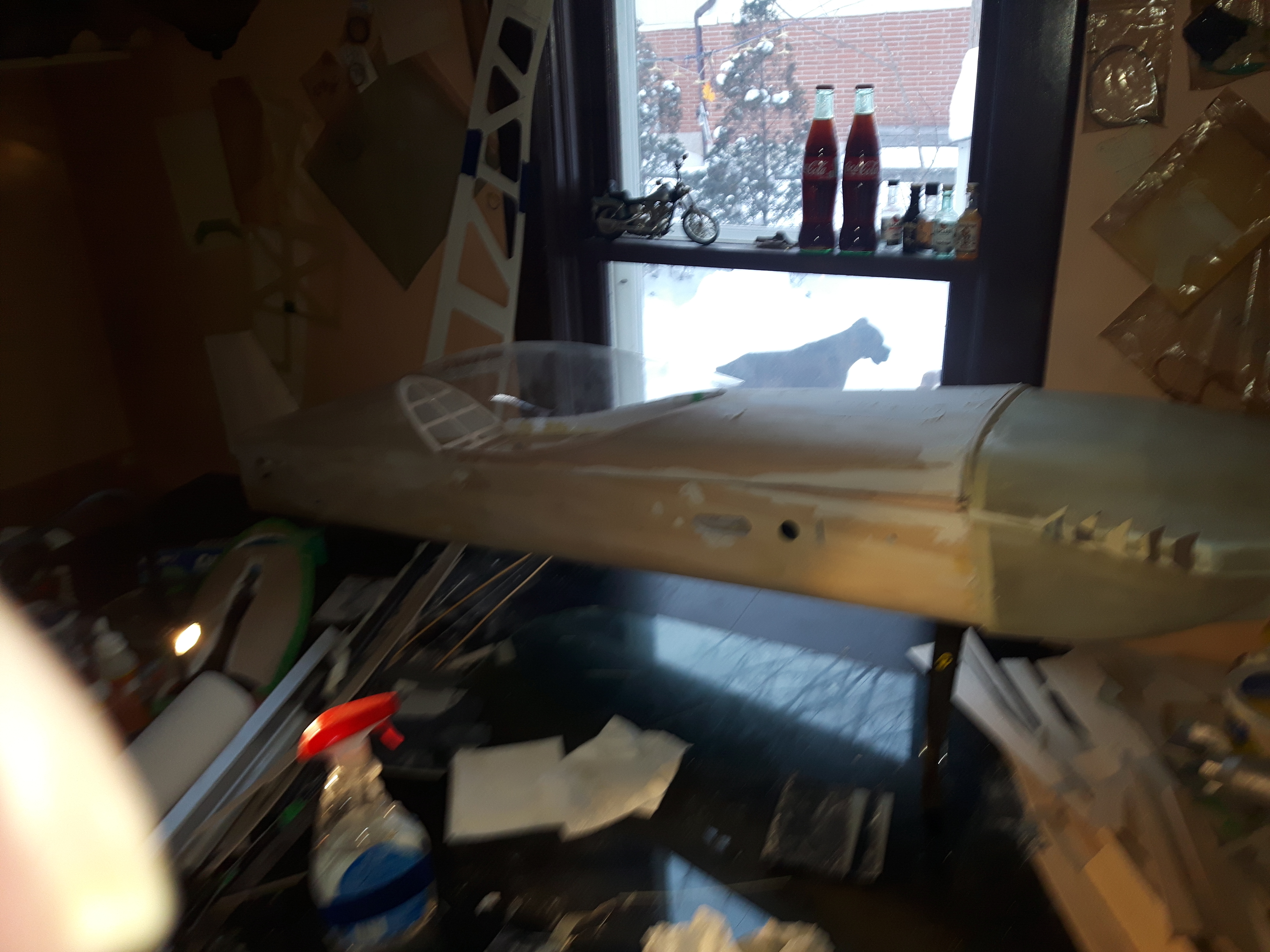

    Now to cut out the cockpit. There no template of any sort to do this so it is trail and fit. Same as the canopy.

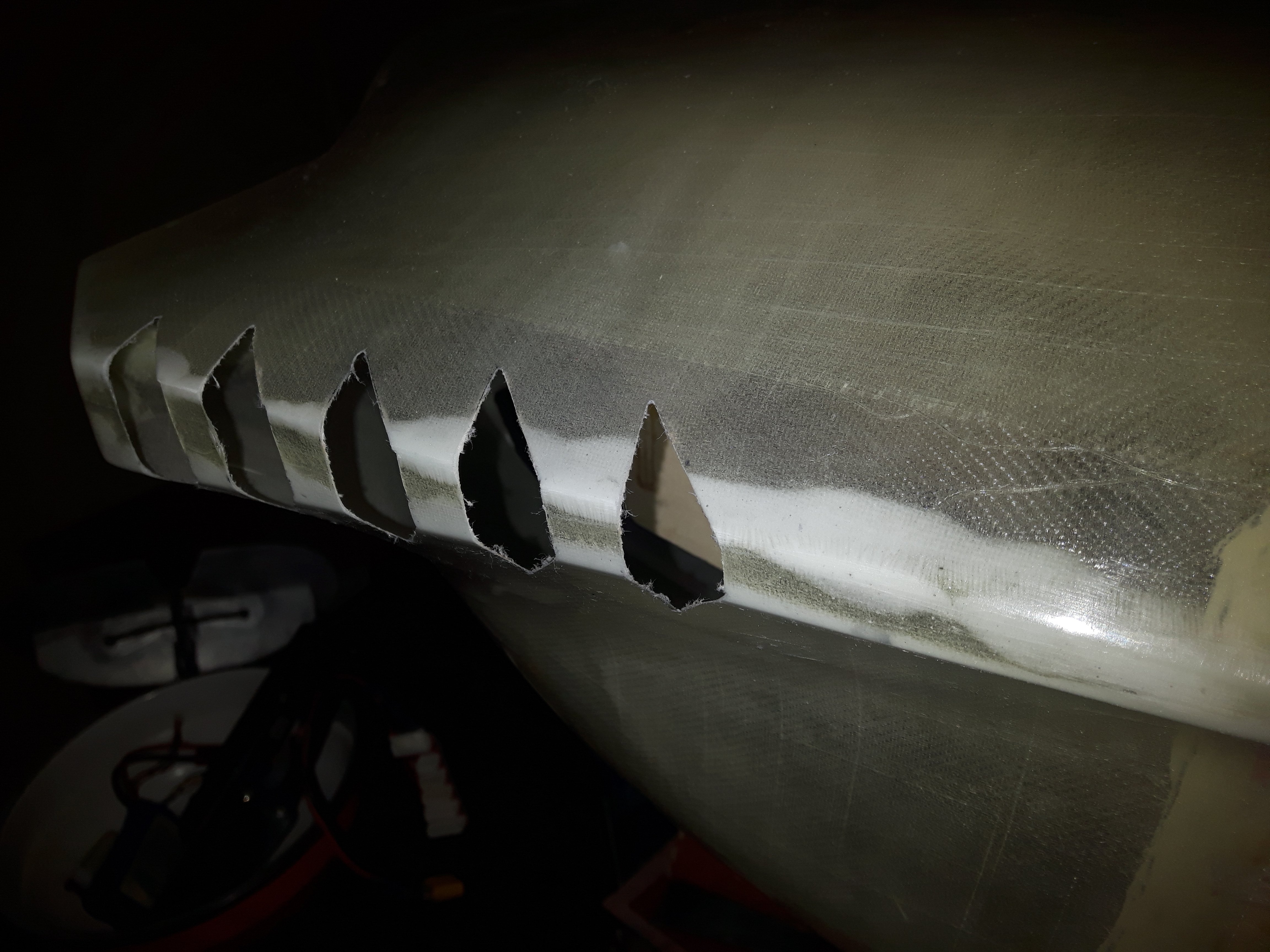

    Forgot about cutting the cobra vents in the sides of the cowl. Again very carefully with a dermal.
