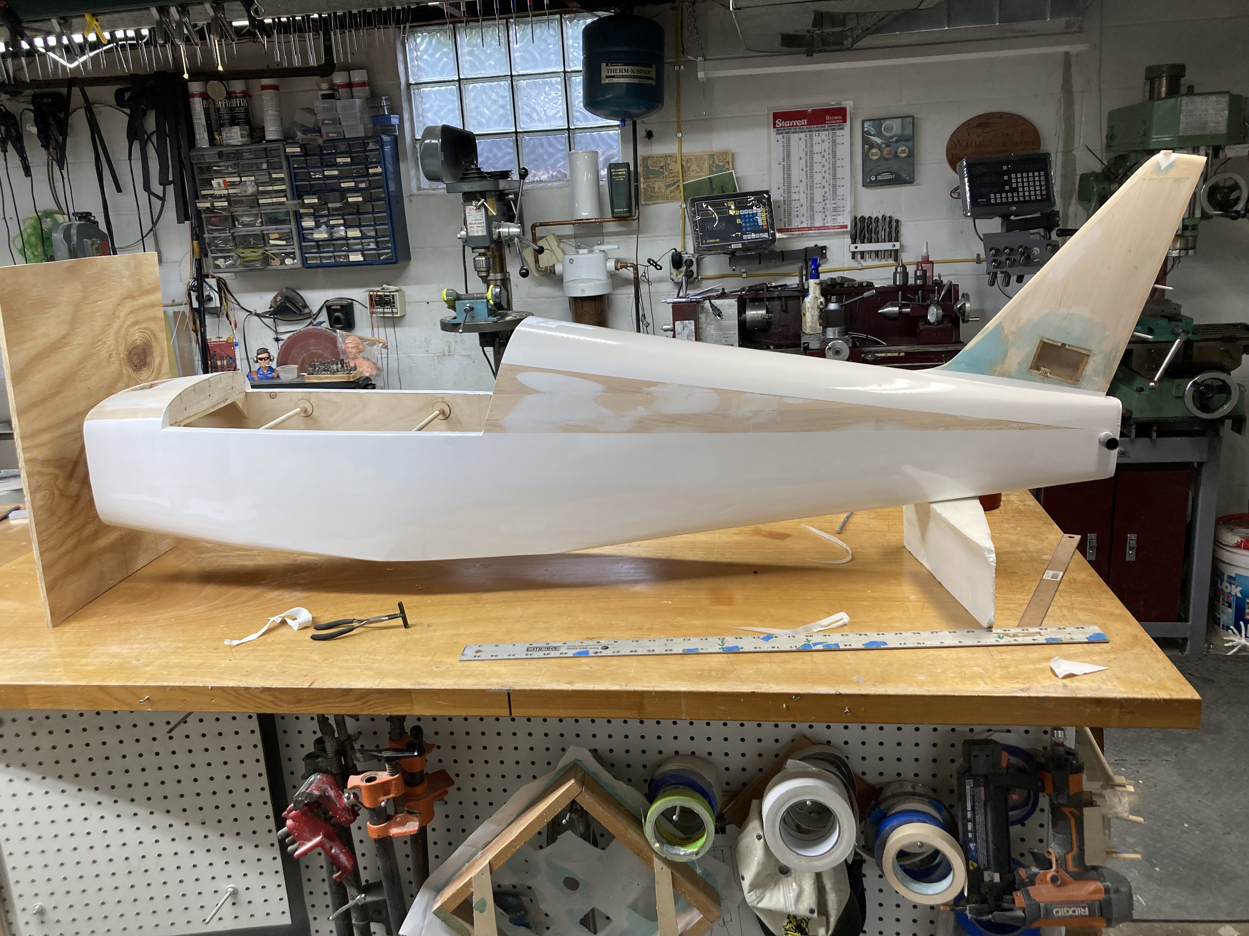

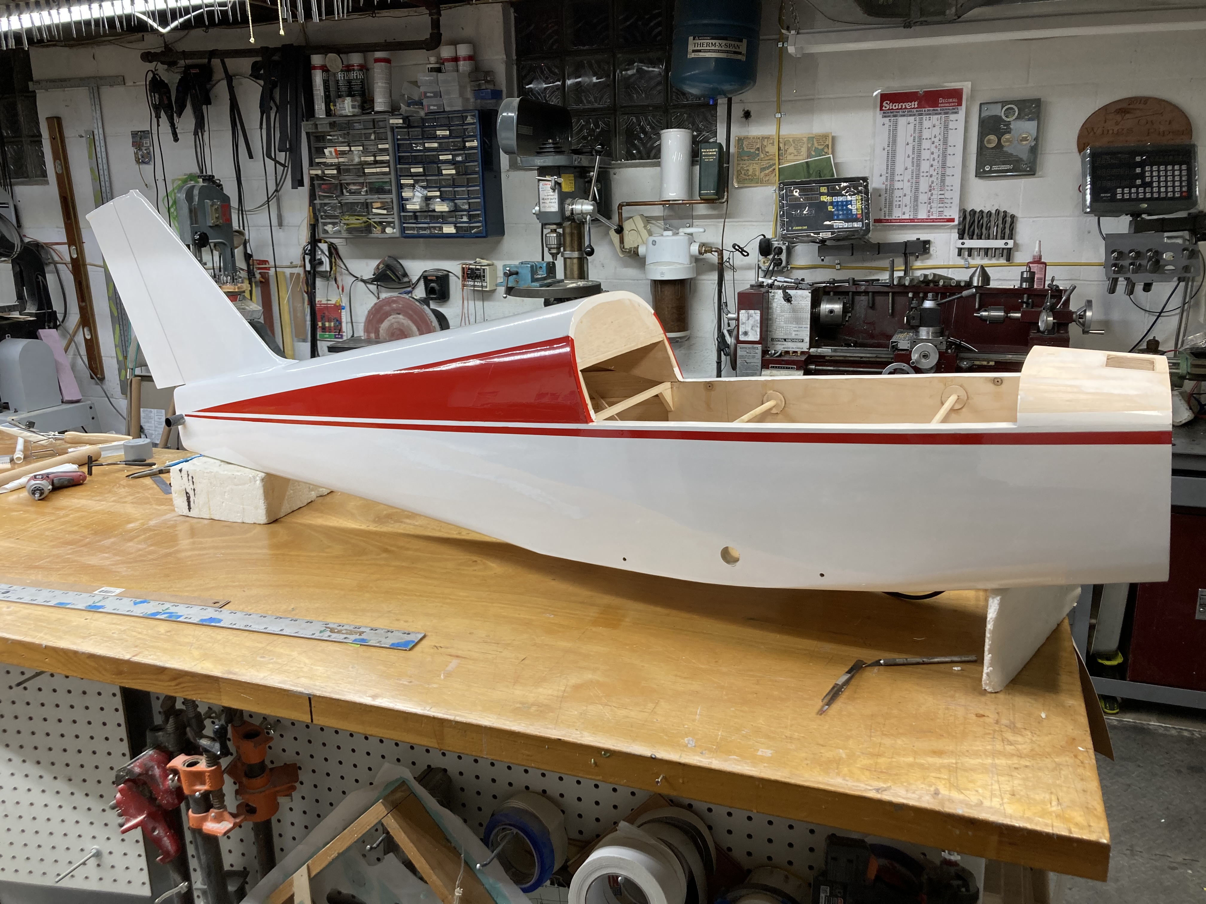

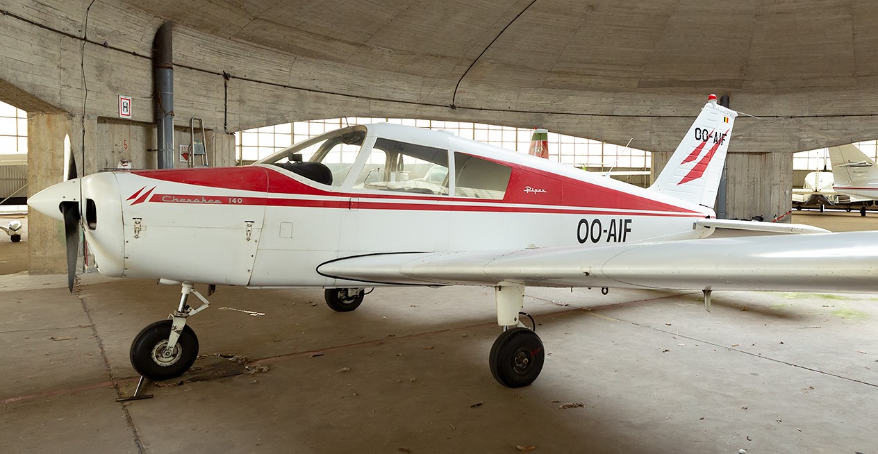

Looking at the graphics today and found this photo on Airliners.net. Red scheme just like the light blue. Pretty sure I'm going with missile red trim.

Yes I am putting in a Roto 85 FS in the plane. Can't speak to the discrepancies but the plans are a good starting point and use the plans as reference for your build. To be honest I would not have attempted this build without these plans.
Weight? I hope it as light as possible, will let you know in a month or so, if it flies as good as my 25% RC Guys plane I will be happy.
At the risk of sounding like a dope, may I ask what the purpose of spraying it down with hair spray would be?
Scotty68
The hair spray is also an old school trick for controlling the fuzz balsa can develop when sanded. And as Tony said it does so by acting somewhat like a sanding sealer/filler.

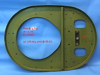

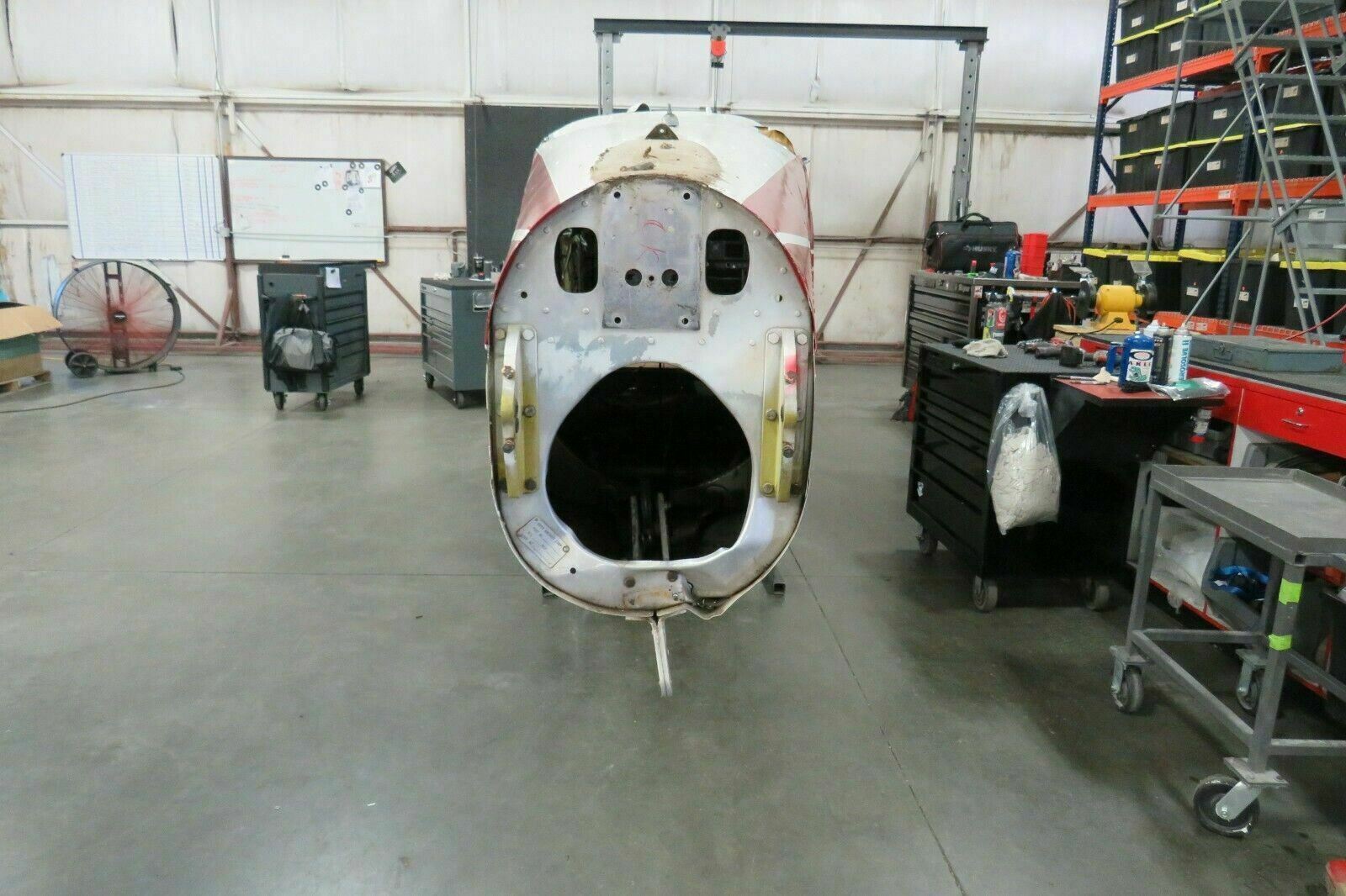

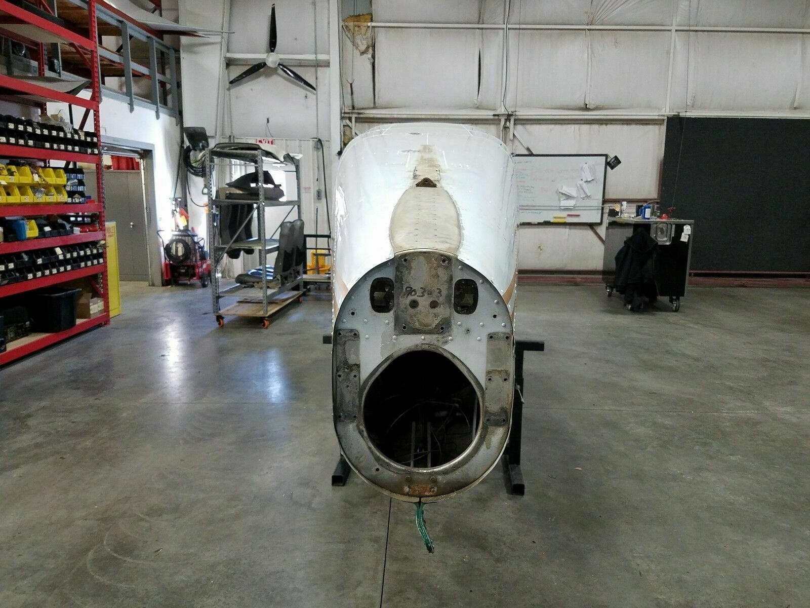

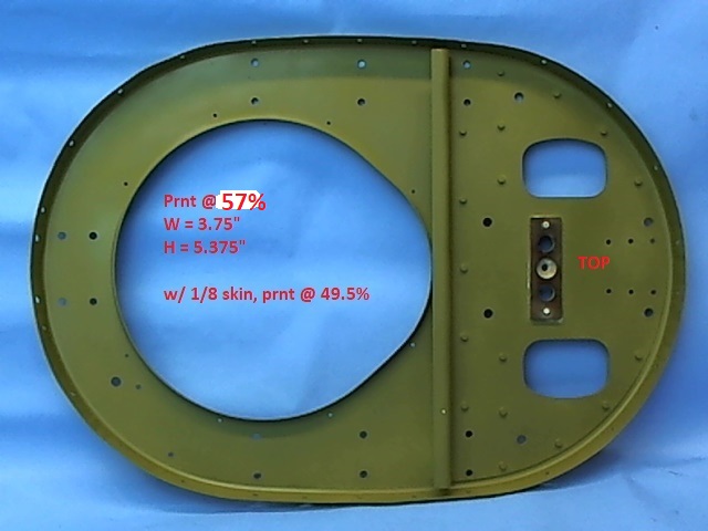

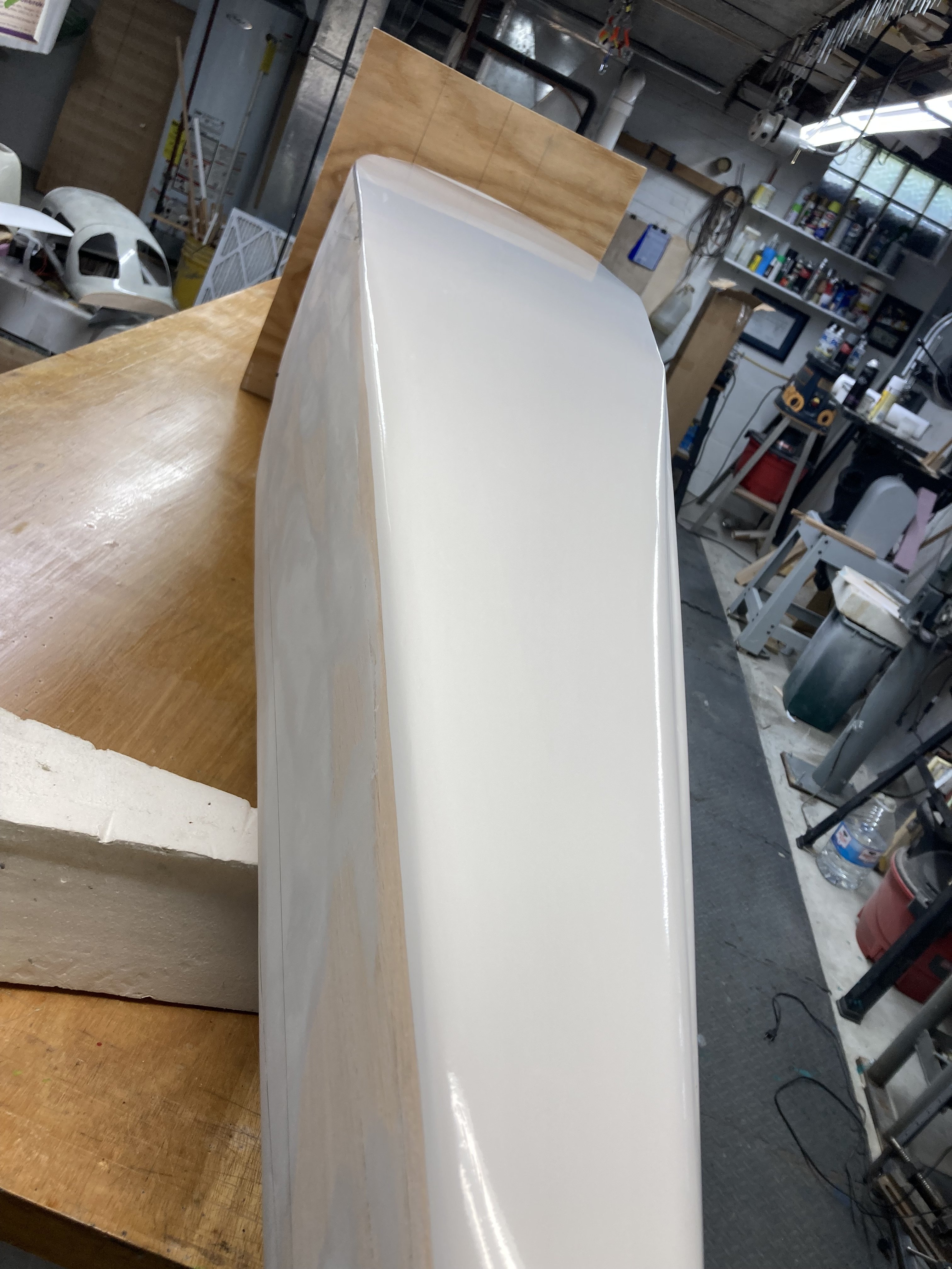

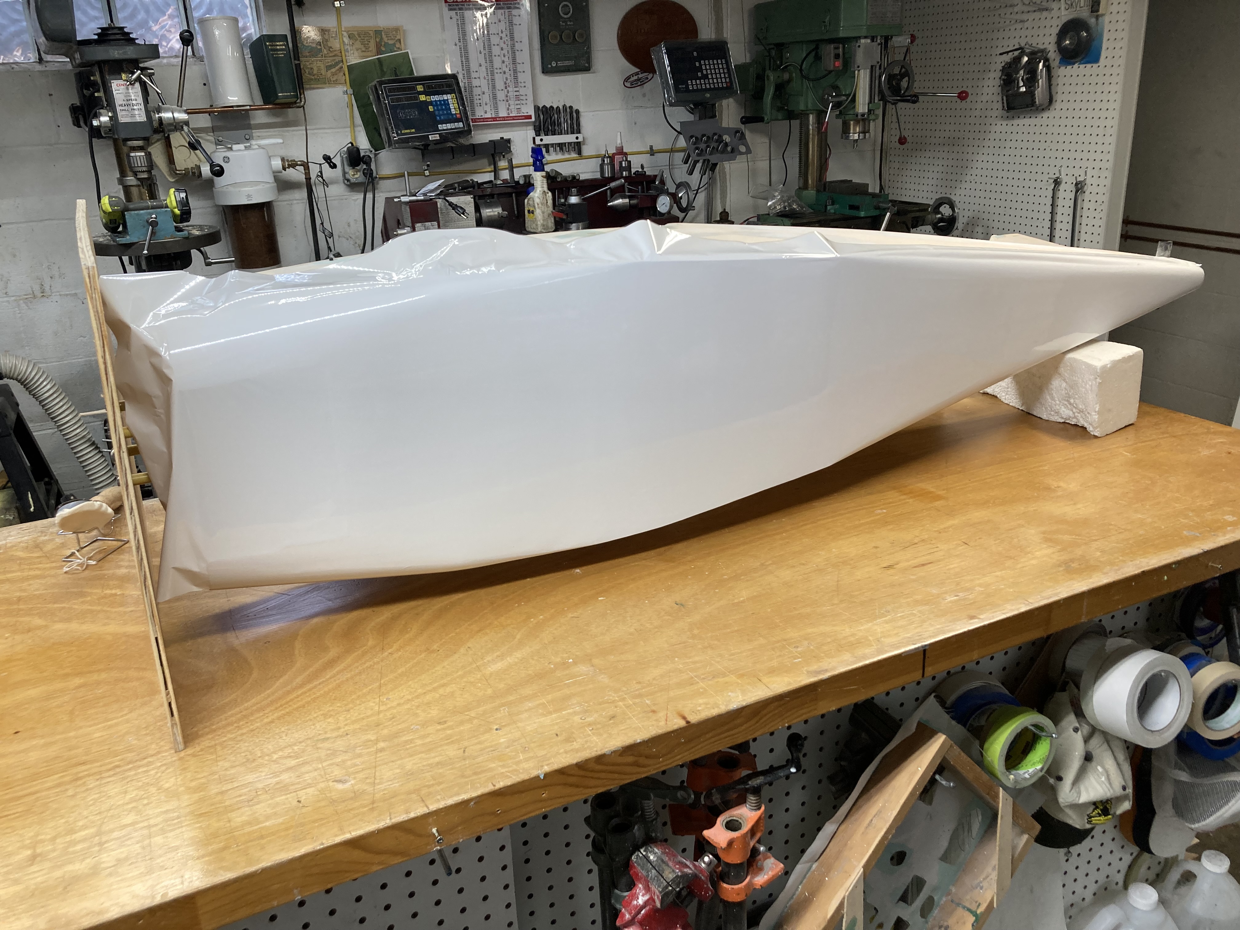

For me the first discrepancy was the stab. Like you I want the scale flying stabilator. While digging into that and deciding how I'm going to do it I realized the cross section profile at the tail was off. Here's a couple of pics of that final former in the tail. The bearing blocks for the stab actually bolt to this former.
