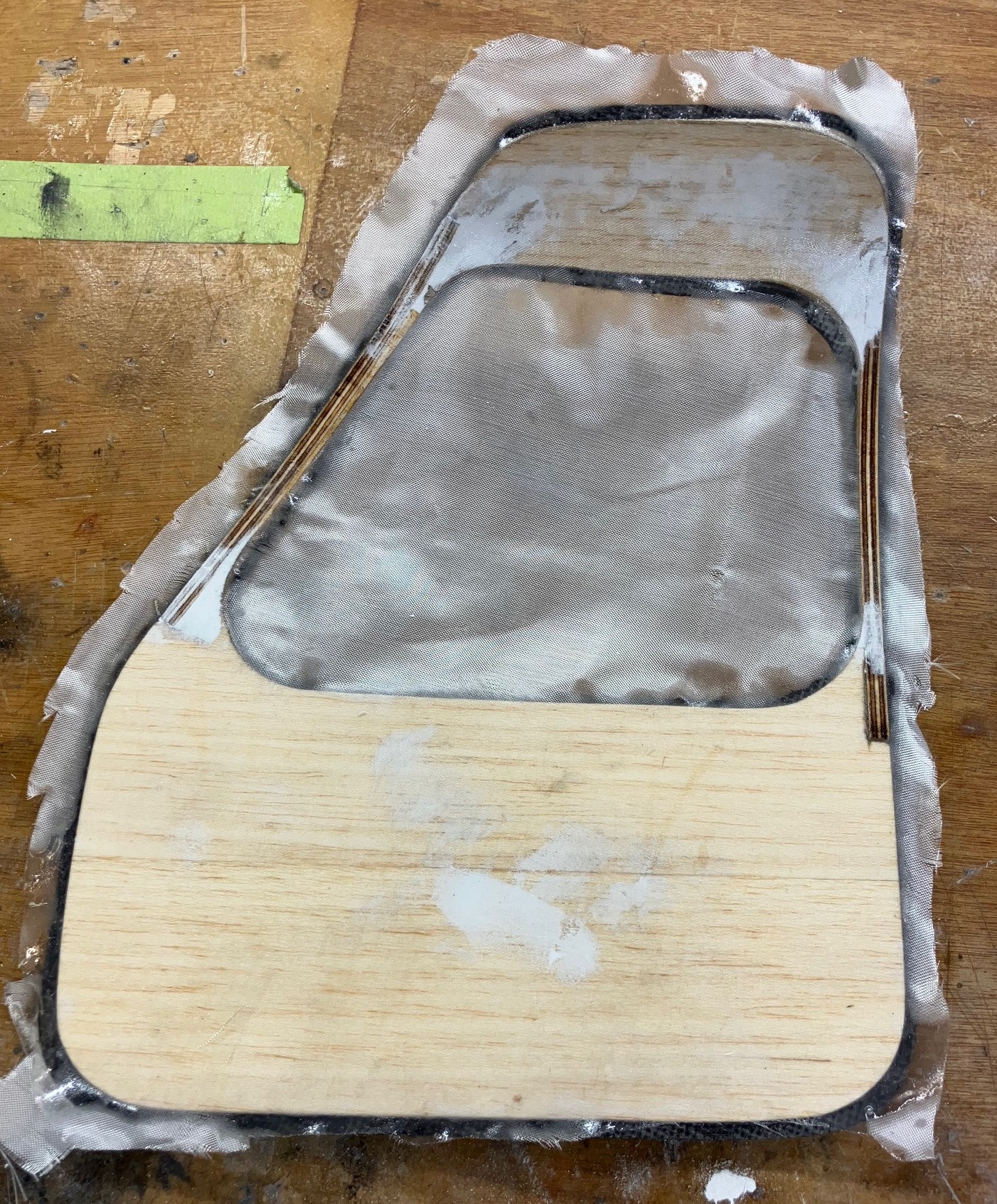

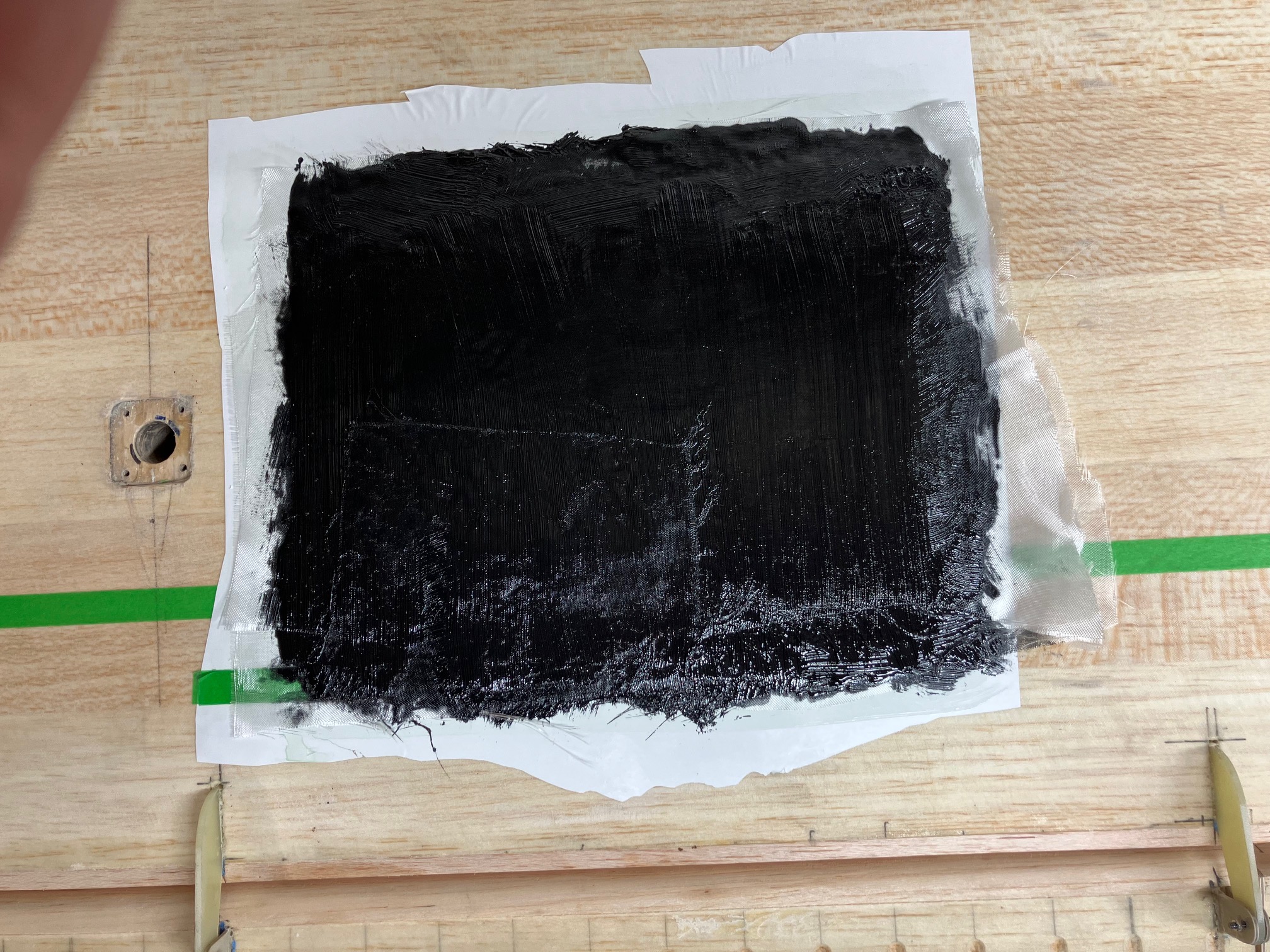

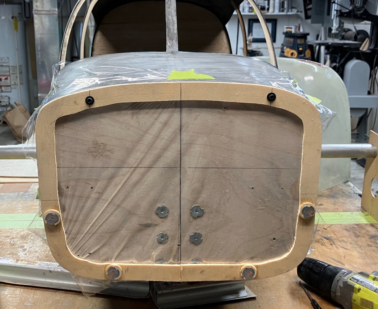

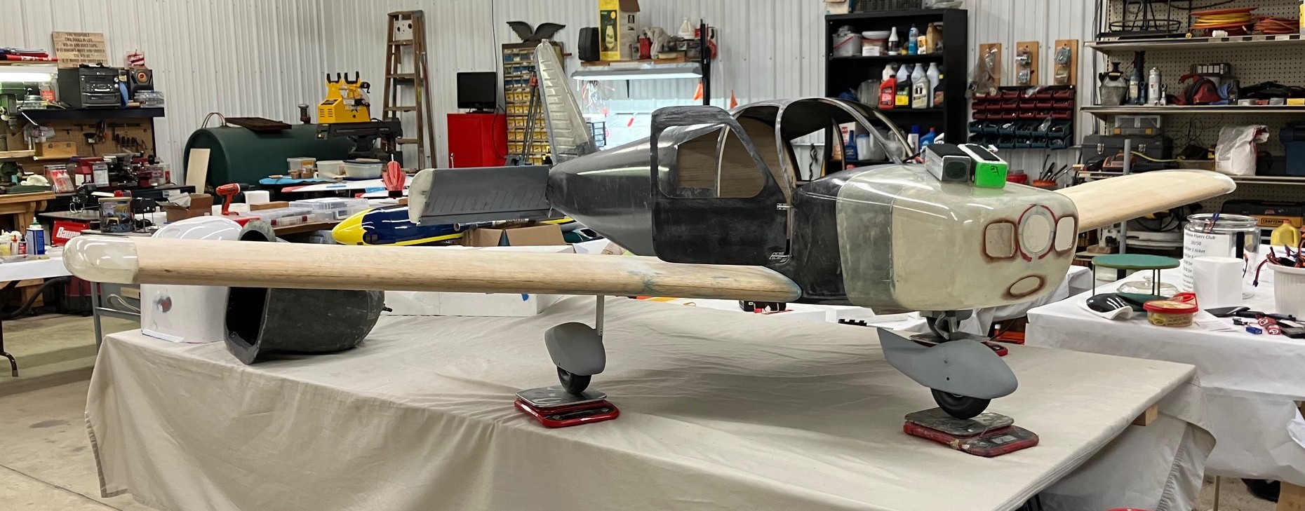

The door came out nice and really stiffen it up. Happy with it now. Have the 1 1/2 ounce cloth on the flat surface, once cured and trimmed the flange area will get glassed.

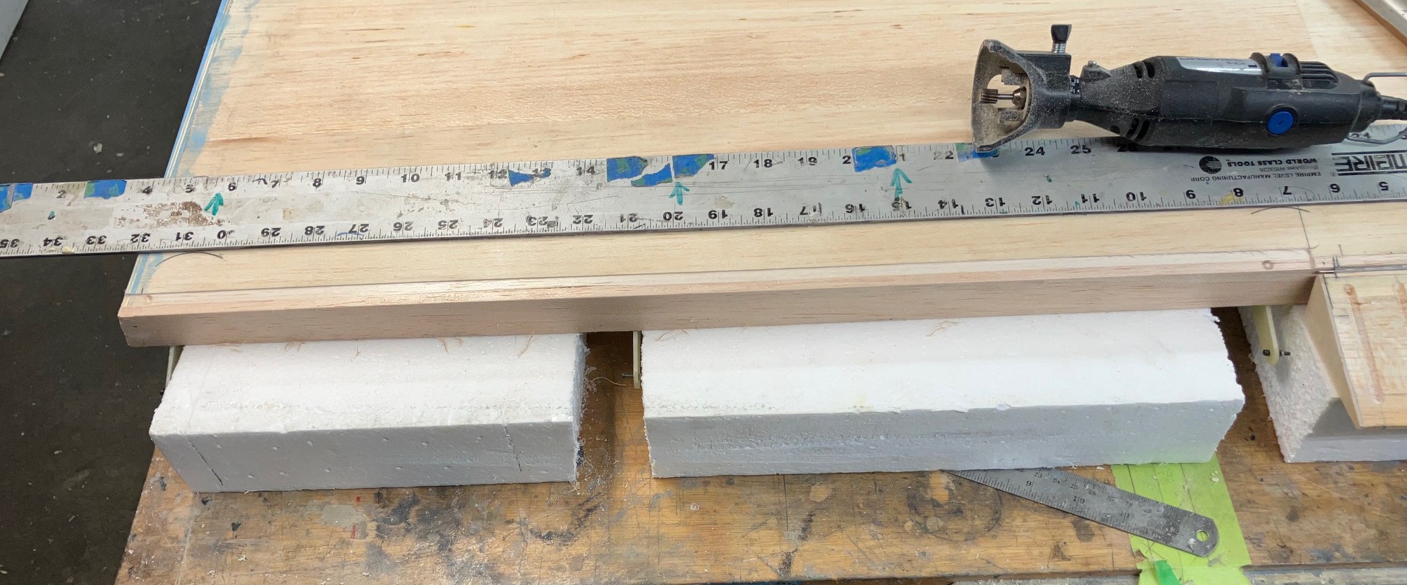

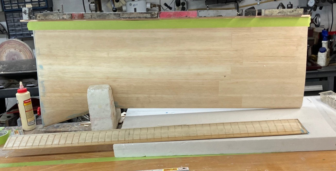

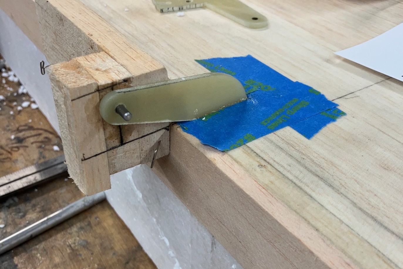

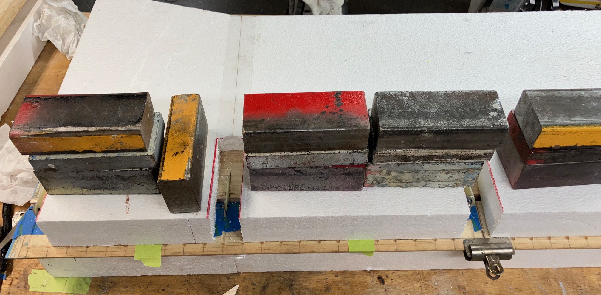

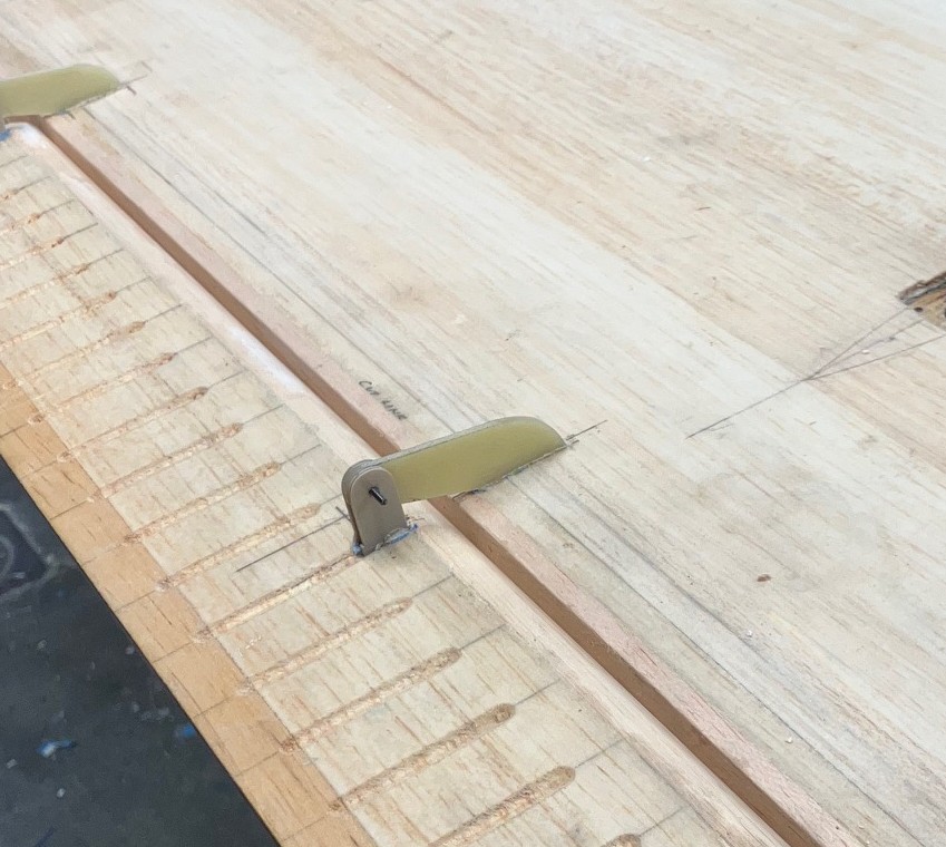

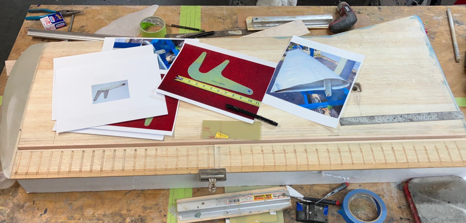

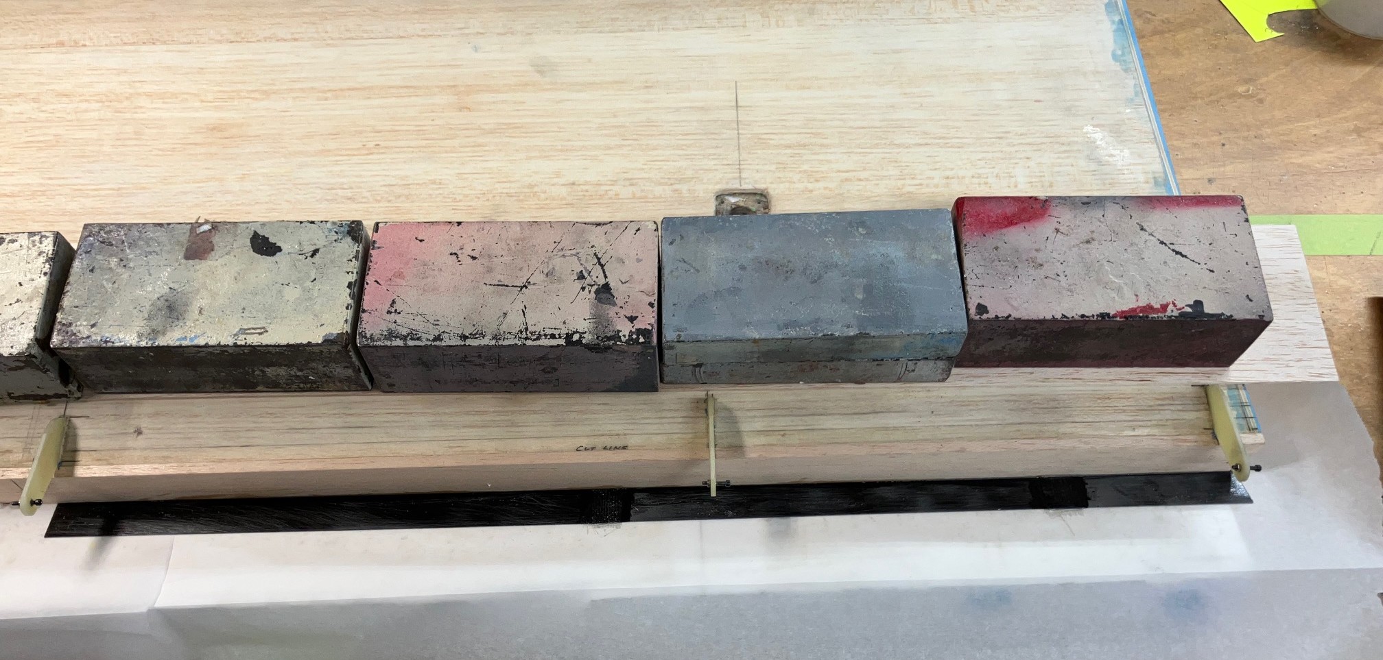

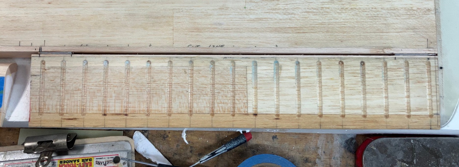

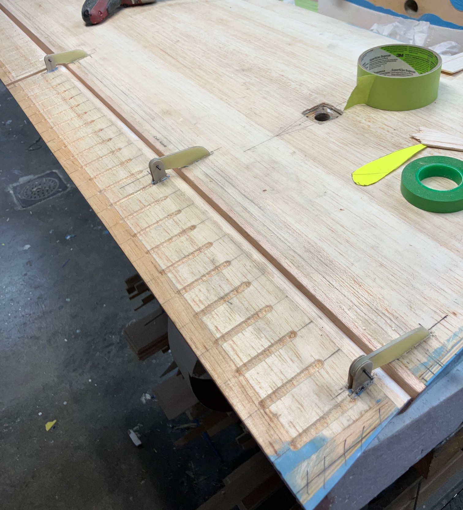

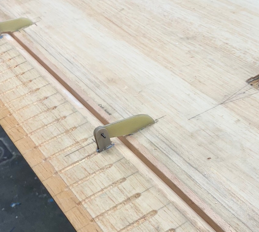

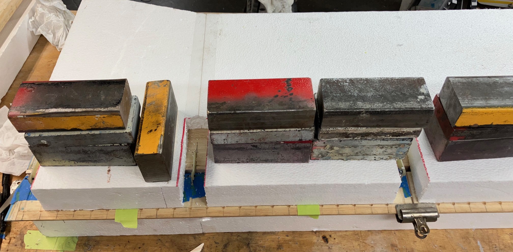

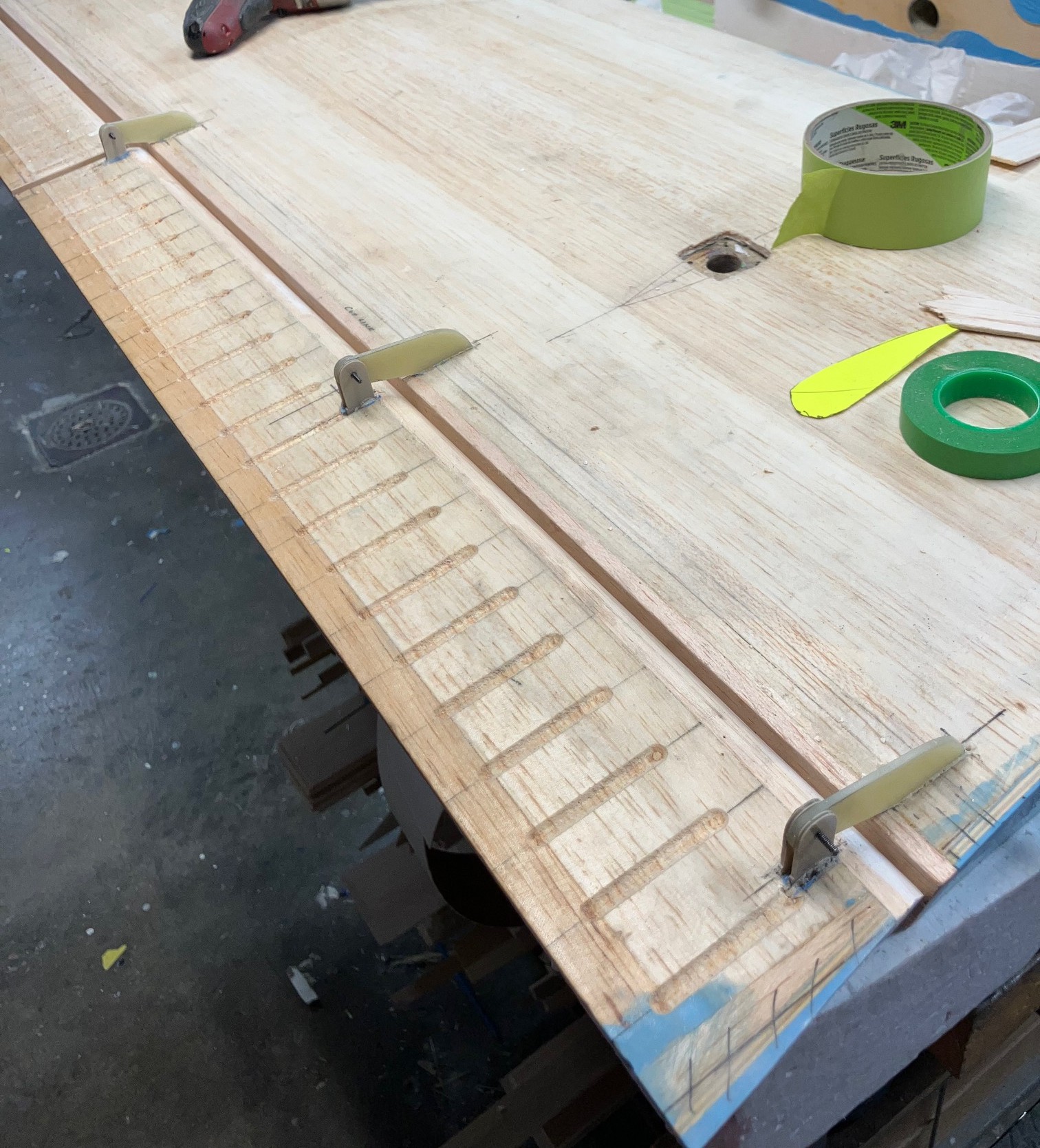

Cut the left aileron/flap free and installed the 1/4" balsa trail edge, once the right is cut will begin cutting the leading edges, plan to do this in the band saw so would like to have both available once the saw is set up.

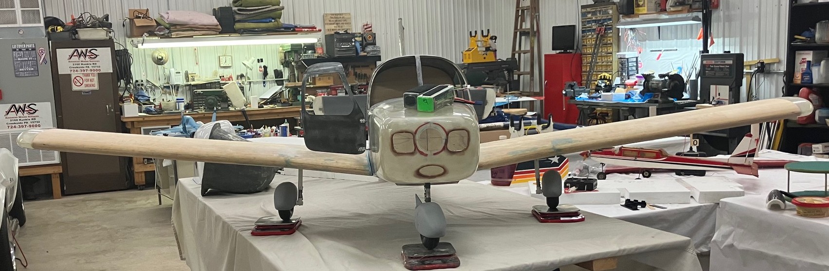

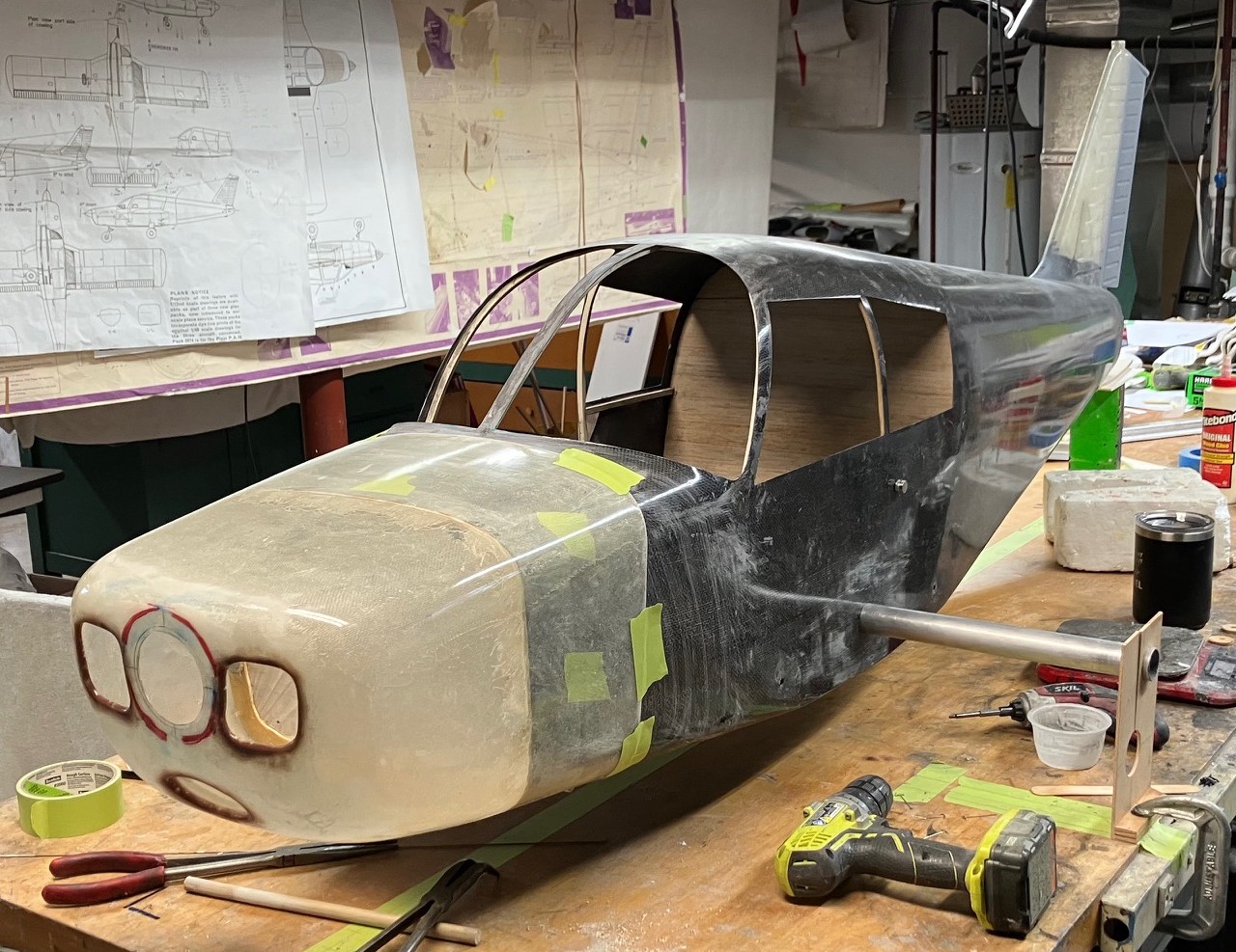

Put the last pieces of reinforcement inside the fuselage, once cured the last window panel will be cut out.
