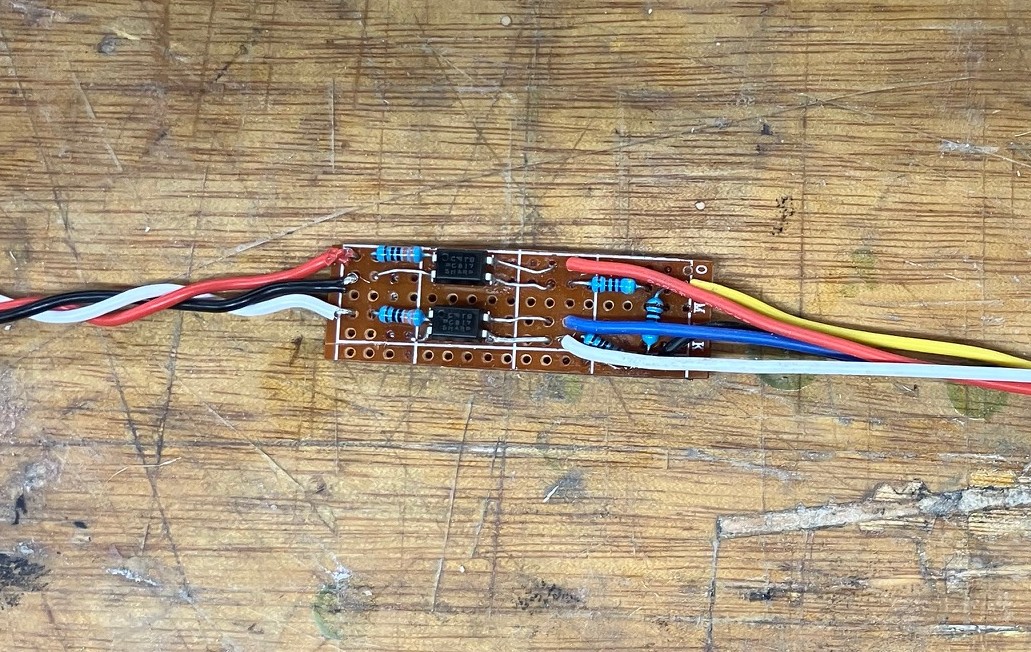

I don't plan to disconnect the starter battery between flights and didn't care for the fact the starter beeped all the time while the radio is off. I thought about installing a simple MOSFET switch to turn the starter battery off when the radio is off. While investigating the circuit Google AI recommended isolating the starter battery from the radio electric system to avoid a ground loop.. Two PC 814 optocouplers are used to isolate the system on command and the PWM signal to turn the starter motor on. In the photo below on the left side + 8 volts on the red wire turns the stater MOSFET on, the PWM signal on the white wire turns the starter motor on. On the left side 16 volts from the 4S battery provides the voltage to turn the MOSFET on at full saturation, the blue wire provides 5 volts for the PWM circuit to control the starter motor.
The complete system adds a few grams to the system.

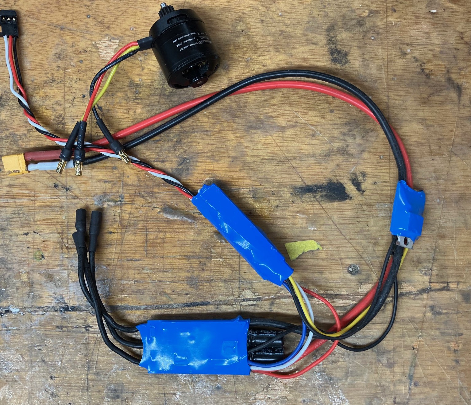

As a side note the ESC is rated at 40 amps and is the same size as the 76cc starter I purchased for the Roto 85 engine, It seems that that their 123Cc engine uses the same ESC.
I think this is the last hurdle, time to put everything together and test fly.
