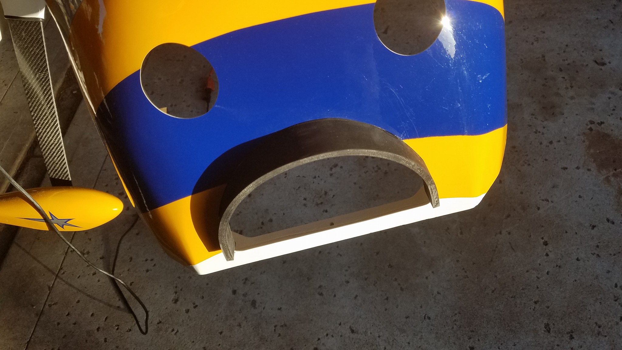

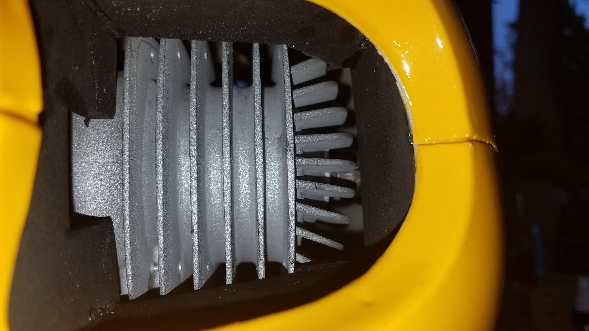

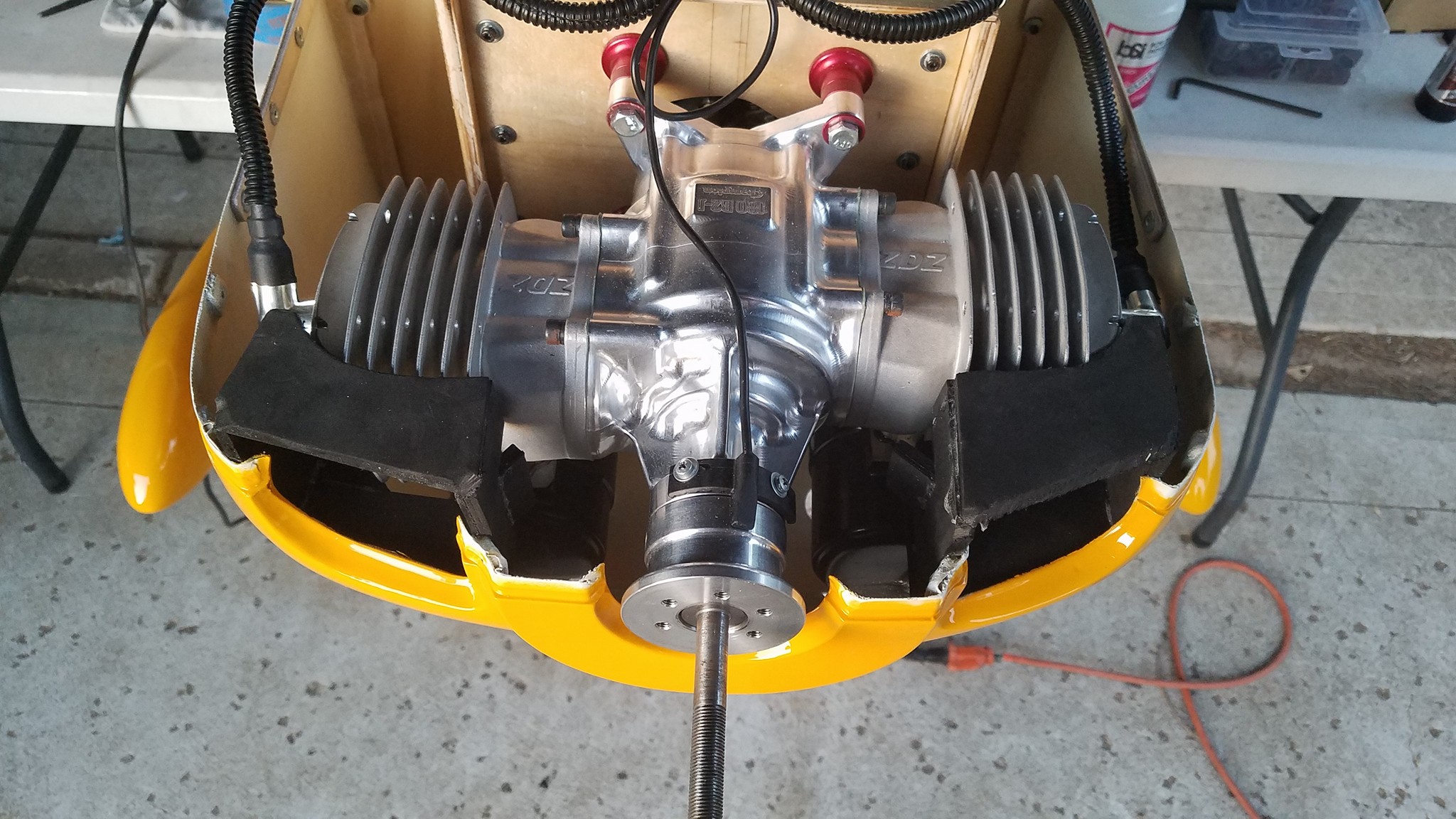

    Got to work on setting the cowl up with baffling and a low pressure lip. I went with the "D" shaped cutout in the bottom and fitted a creative foam low pressure lip. Creative foam was also used to make the baffles for the engine.
    If you'll notice I also opened up case vents on the inside of each baffle to allow air to flow to the engine casing and aid in cooling it.

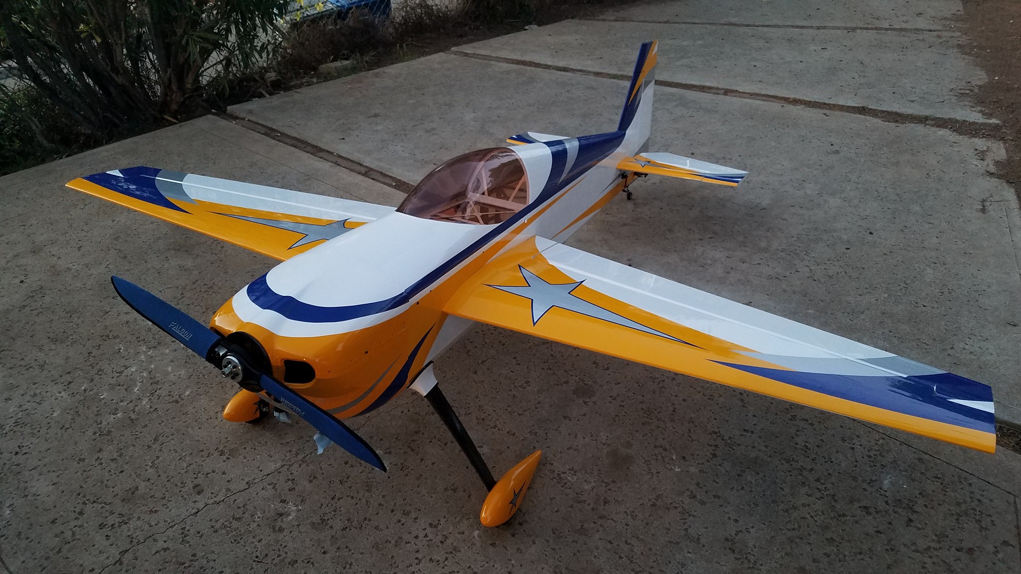

  6. Snoopy1
    Snoopy1 640cc Uber Pimp
    4,976
    7,133
    Canada
    Looks great just needs a spinner then it will be done.

  7. Xpress
    Xpress GSN Sponsor Tier 1
    The one that came with it needs a little adjusting to fit properly, but I may just hold out for a Falcon spinner like I put on my 105" Laser.
