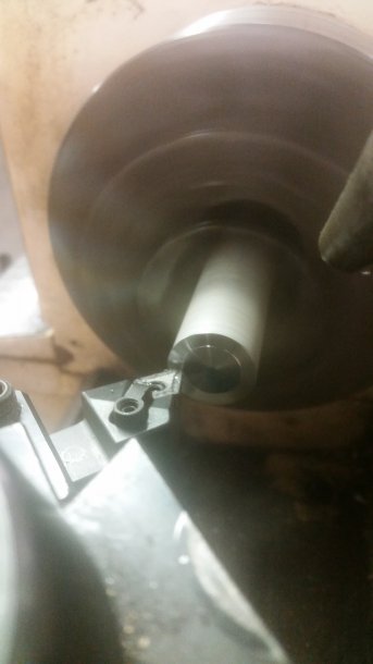

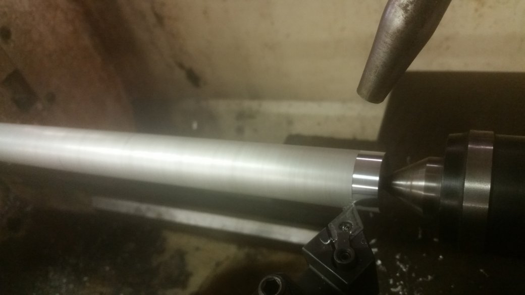

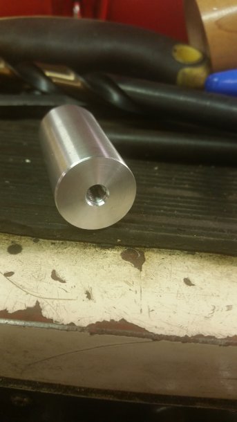

I'm taking 1" round bar stock down to .75". Id like to keep it at 1", but the weight offset is greater than I like.

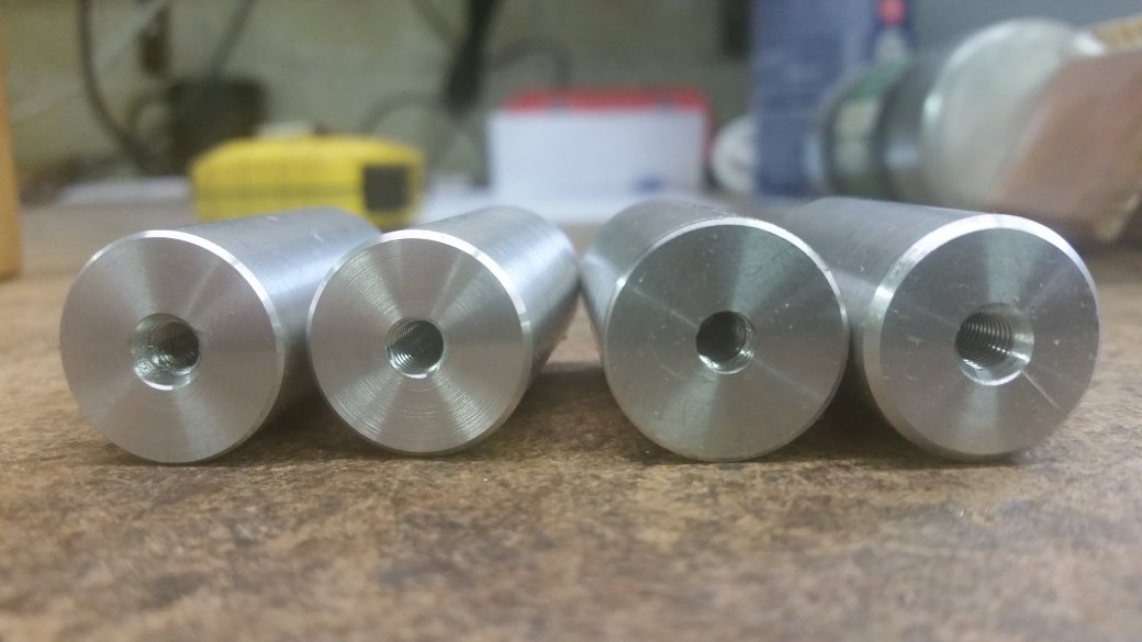

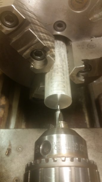

Got'er done! 3 hr of lathe work. I give myself an extra .125" on the length of the stand off. So, total length is 1.625". And my tolerances are within .005" ;) 1.622-1.627".

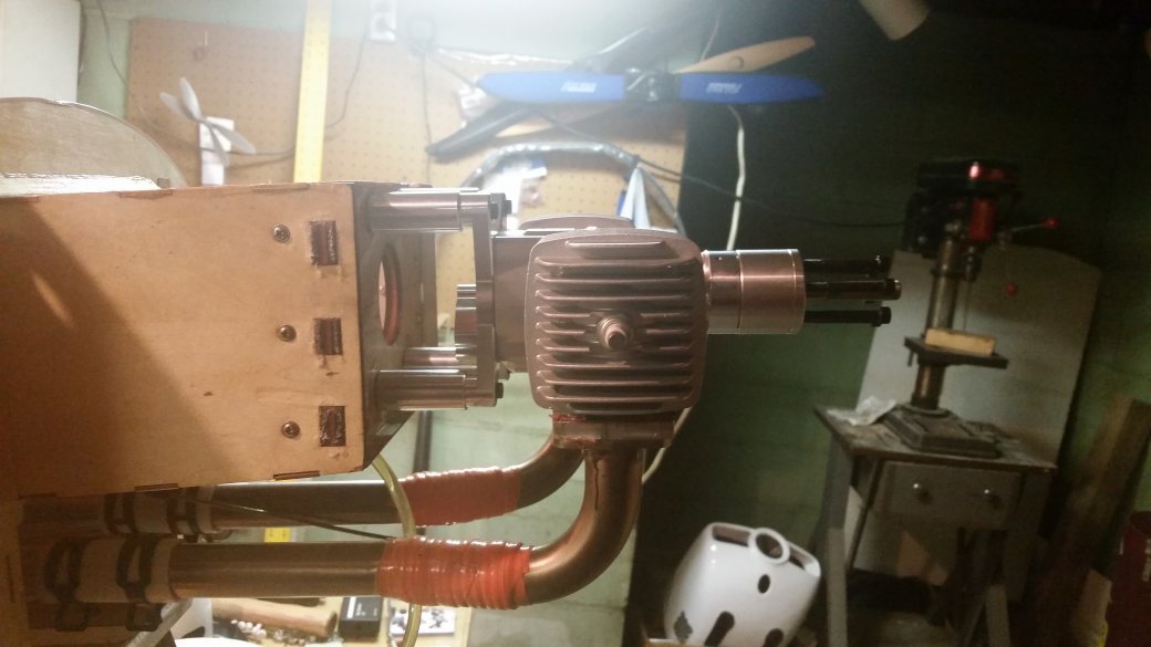

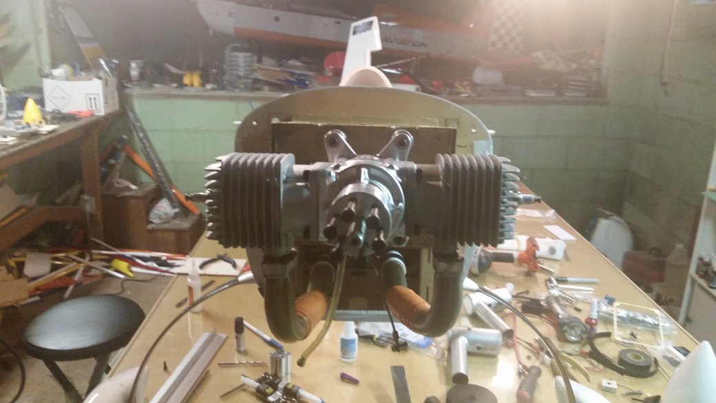

Mounted up, but still need to trim the firewall for Mr. Carb. A "yes, please" pic coming in a few minutes.
Just looks naked with no carb on the bottom of the engine!
