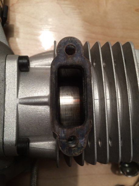

So I've been doing some reading, I someone say that the 112 can use DA100 / DLE111 mufflers. Can anyone confirm this.
The bolt pattern is the same and they all have rectangular ports. Maybe not be the exact same shape. The cylinder offset is opposite DA 100 if there are any asymmetrical options out there. Not sure if volume would make a difference using 100 size mufflers on a 112.
I think they had a 112 on DA mufflers in the rccanada testing thread.
I still need to get a set of compacts ordered one way or another so I don't know for sure yet, but the drawing shows the bolts being 40mm apart and they measure 40mm apart.

I That's right I heard it from you as well as saw it online. The offset is not a huge deal, I used DA muffs on my EME and just had the smoke nipples pointing inward. I'm done with smoke systems so no biggie there.

I'm using pipes made for 45-60cc on my 120cc engine. Most pipes are made for upto 60cc engines.
