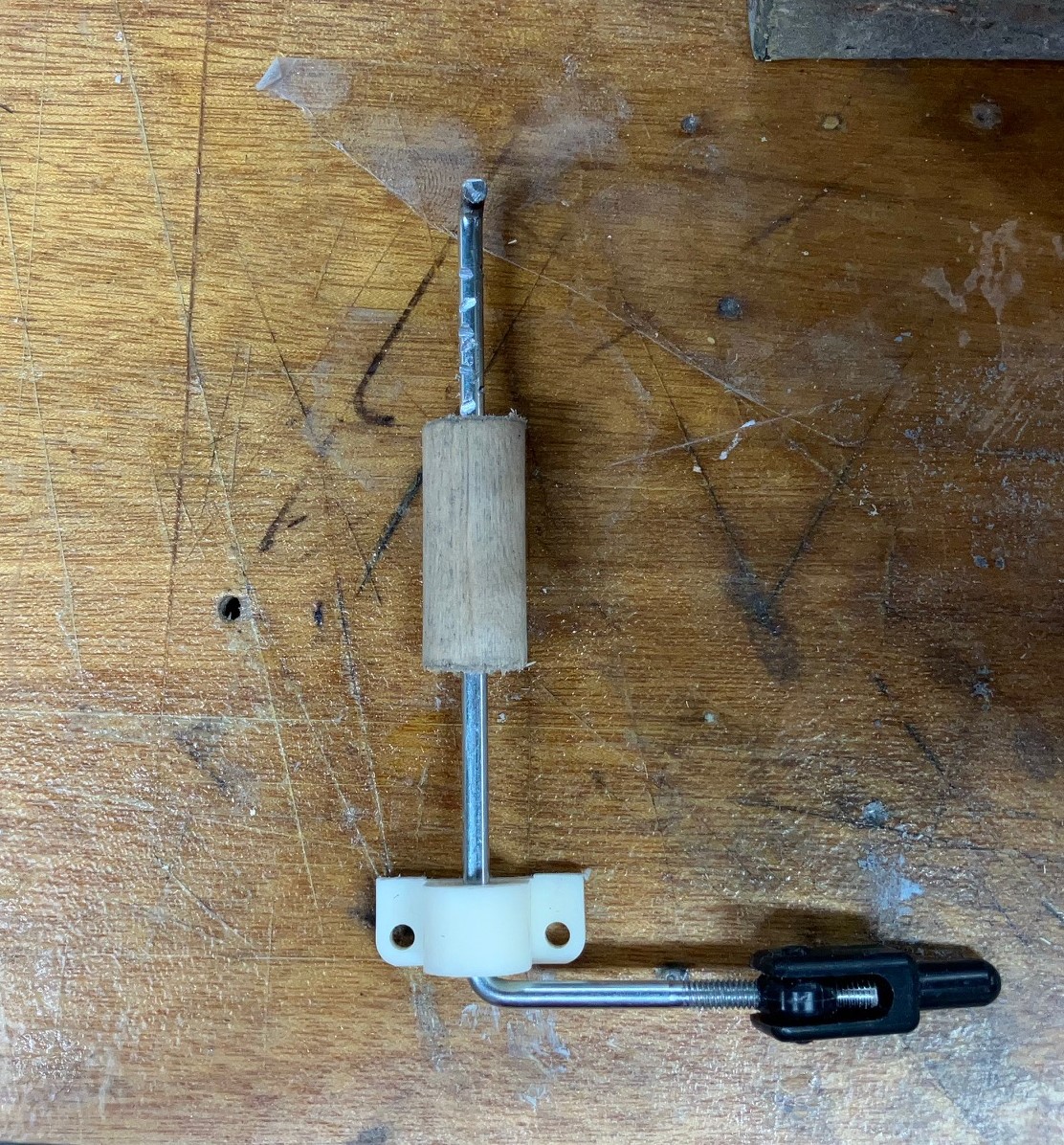

Plugging along slowly because I need to wait for the glue to cure before moving to the next step. Any rate now the tail pot and servo are installed the rudder linkage can be completed. Completed the part of linkage this morning and it is glued is glued into the rudder. Once this cures I will decide if the rudder will get glued on now or later.
The shaft fits into a groove on the top of the dowel and scored the shaft where it is n contact with dowel, this area was painted with glue, wetted the wood dowel and put Gorilla Glue in the rudder, don't think it will come out. The shaft threads are 6-40 if interested.
