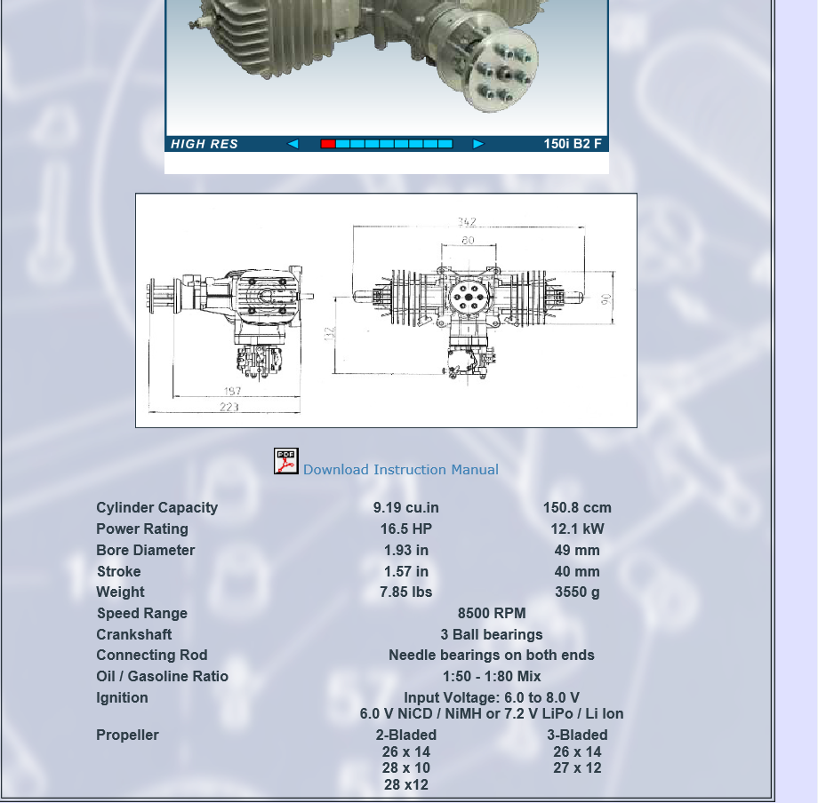

I am a bit perplexed over this 3W 150 I just received. It states (see pic) a 28x12 as the largest prop, but my DLE 111 is turning a 28x10 very well. Even though the DLE has Bowman rings I surely thought this 3W 150 would have a lot more ass to it. Or am I missing something in the translation?

Well Acerc, that is an interesting read. Do not own or have I ever played with one. But I do have is an older DA-150 I have 30-12 on it and it will rip it at will when ever I hit full throttle but unfortunately I cannot remember what it tacked at on the ground. Originally I flew it with 32-12 and did good, but did not spool up fast enough for me. It will be very interested to see @stangflyer has say.

I was thinking something like a 32x10, need power more than speed.

I have a 3W-106 and have ran a 28-10 Falcon prop on it for years . That should be way too small for a 150.
That is what I mean, the DLE is turning the 28x10 with authority. Guess I'll have to dig some on the 150's and what people were running, or I may call Gerhard Tuesday but would prefer to not have to.

I've got a 32x10 you could try but I think it's drilled for a DA.
I appreciate the offer, but after a short search on a couple other forums I do believe the 32x10 may be the ticket. I found a couple people liking the power of their 32x10, one was a Biela and one was a Melzlik. I like Falcon and believe they are lighter and have a better profile. So I think the Falcon 32x10 would be a good starting point and the Valch 140 is turning a 32x10 so I'll check it for the bolt pattern. It would be great if it was the same.
