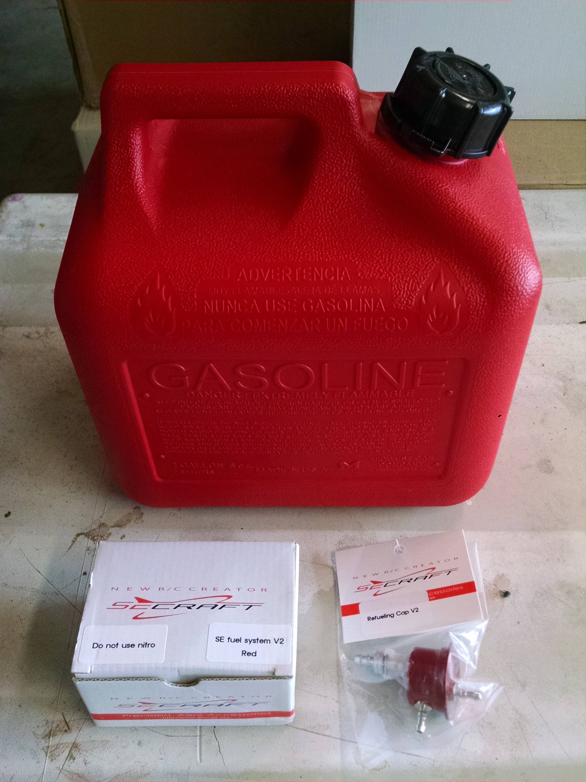

I'm moving enough fuel and smoke that hand cranking was getting old!! Used a buddy's fueler last weekend and knew I needed a setup of my own. The Secraft products look and function great so I called up Azhar at Aztech Aero Models to make it happen. Pretty straight forward assembly, done with both in about 15 minutes. :thumbup:
I started off with a 2 gallon can as well as the V2 pump and V2 fueling cap.

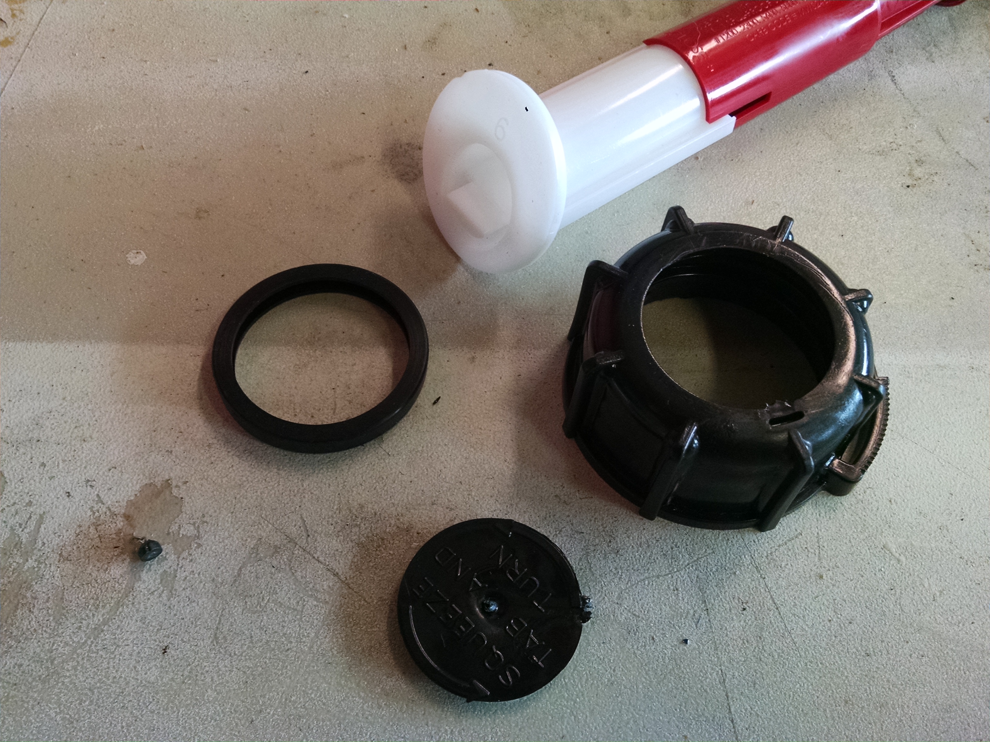

Start by disassembling the stock cap. You'll need the gasket and ring to secure the new fueling cap.

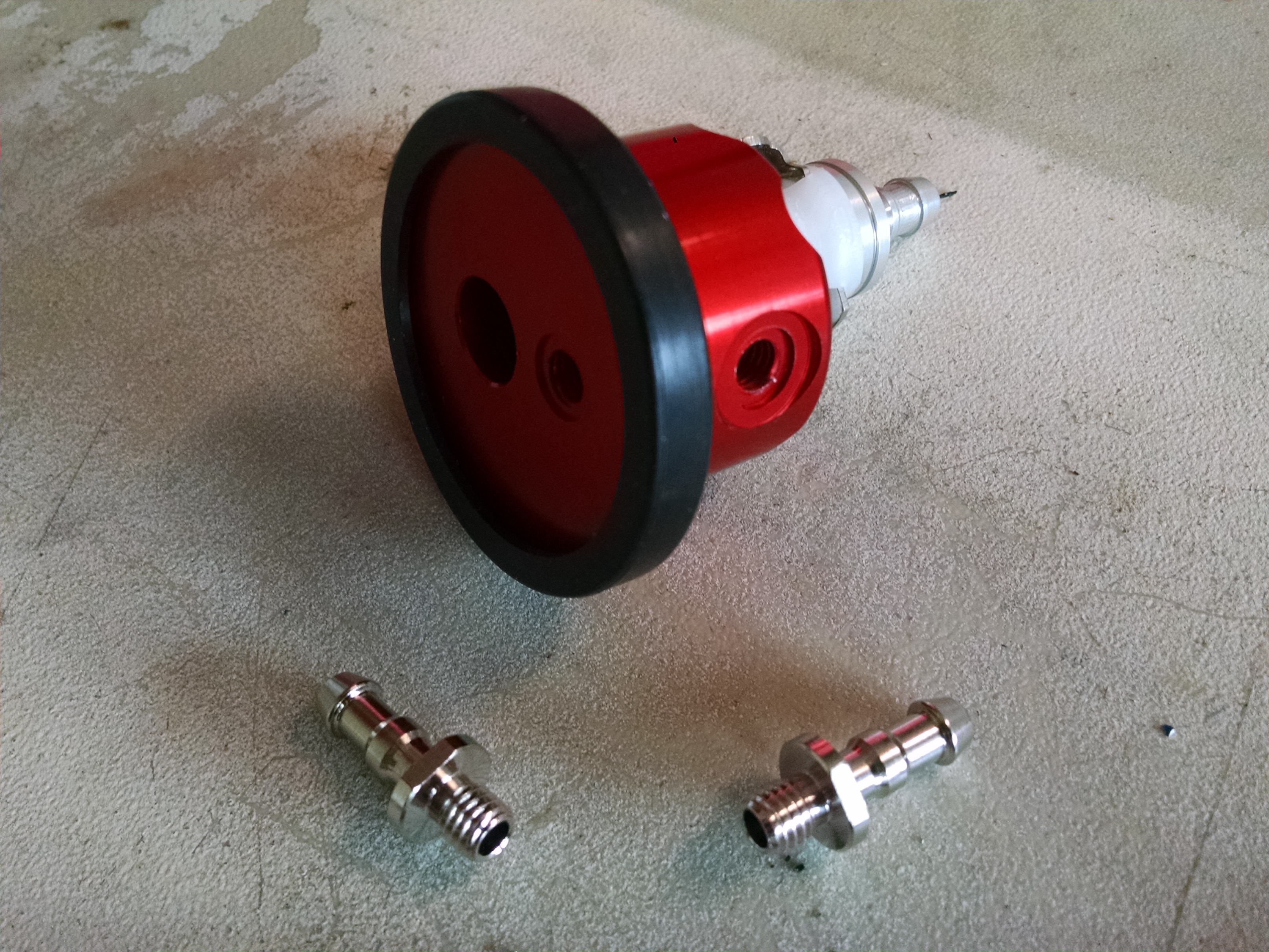

With the gasket from the stock cap I removed the fittings and used loctite so they'll stay snug and won't let air/fuel in or out.

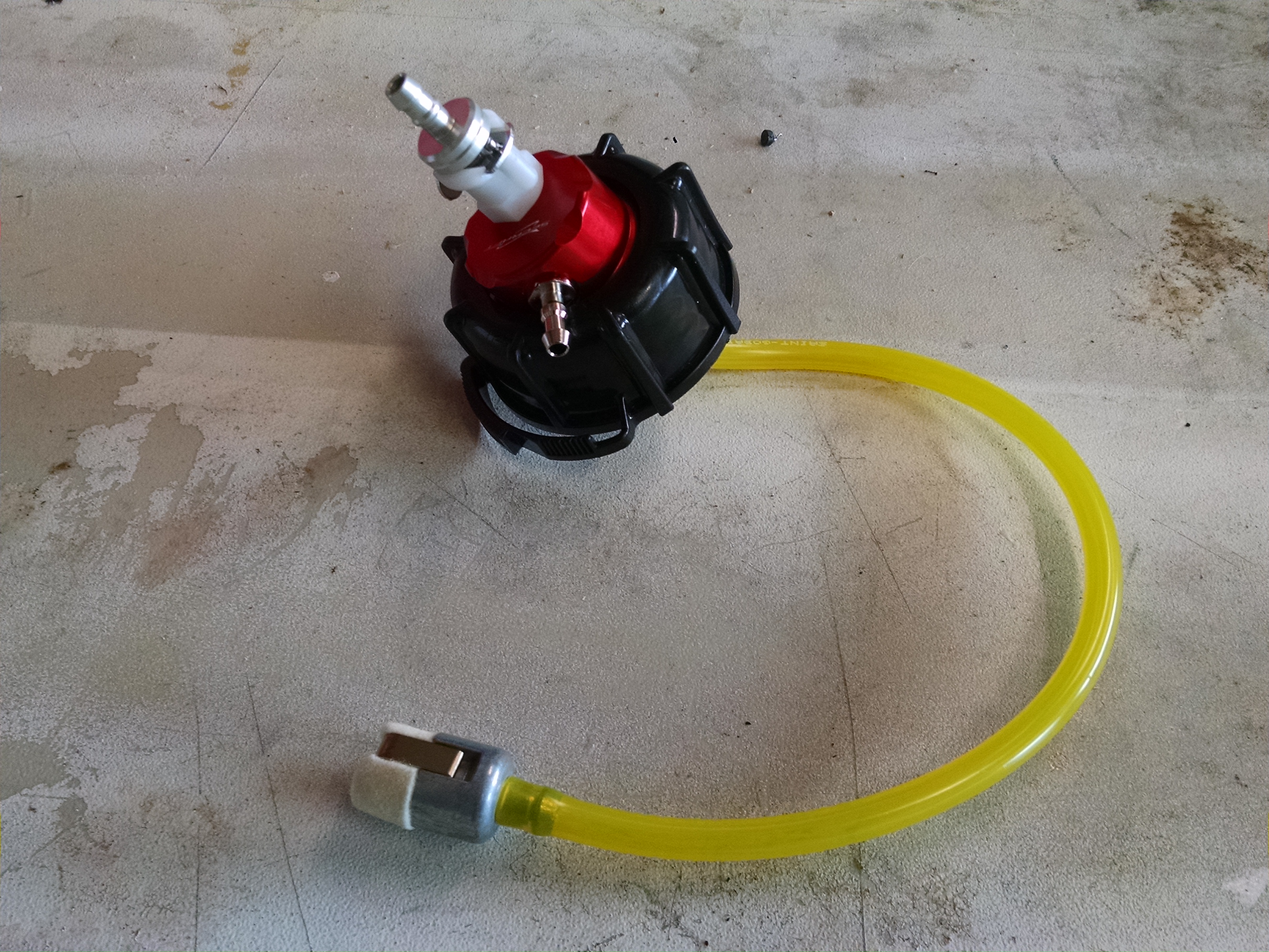

Cap goes in the black ring THEN the fitting gets installed on the side. Since this is my fuel tank I using a felt clunk to filter my gas before it even sees the plane.

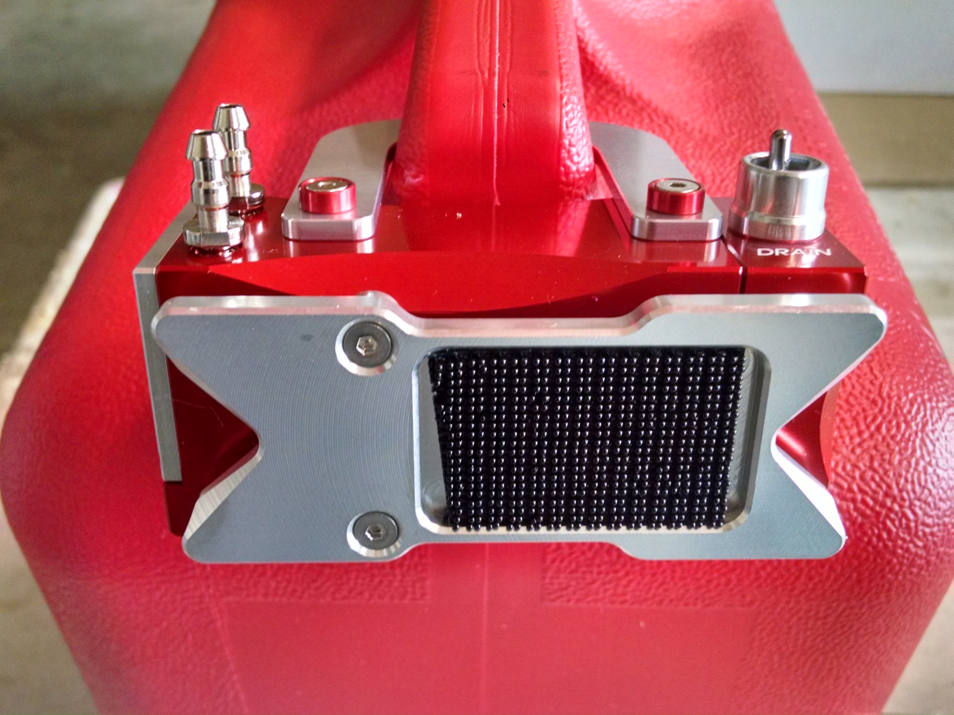

Aluminum bracket holds the pump in place. Loctite everything so you never have to worry about losing a bolt or having a fitting come loose. Snip off half the hook and loop for the base and the other half goes on your battery.

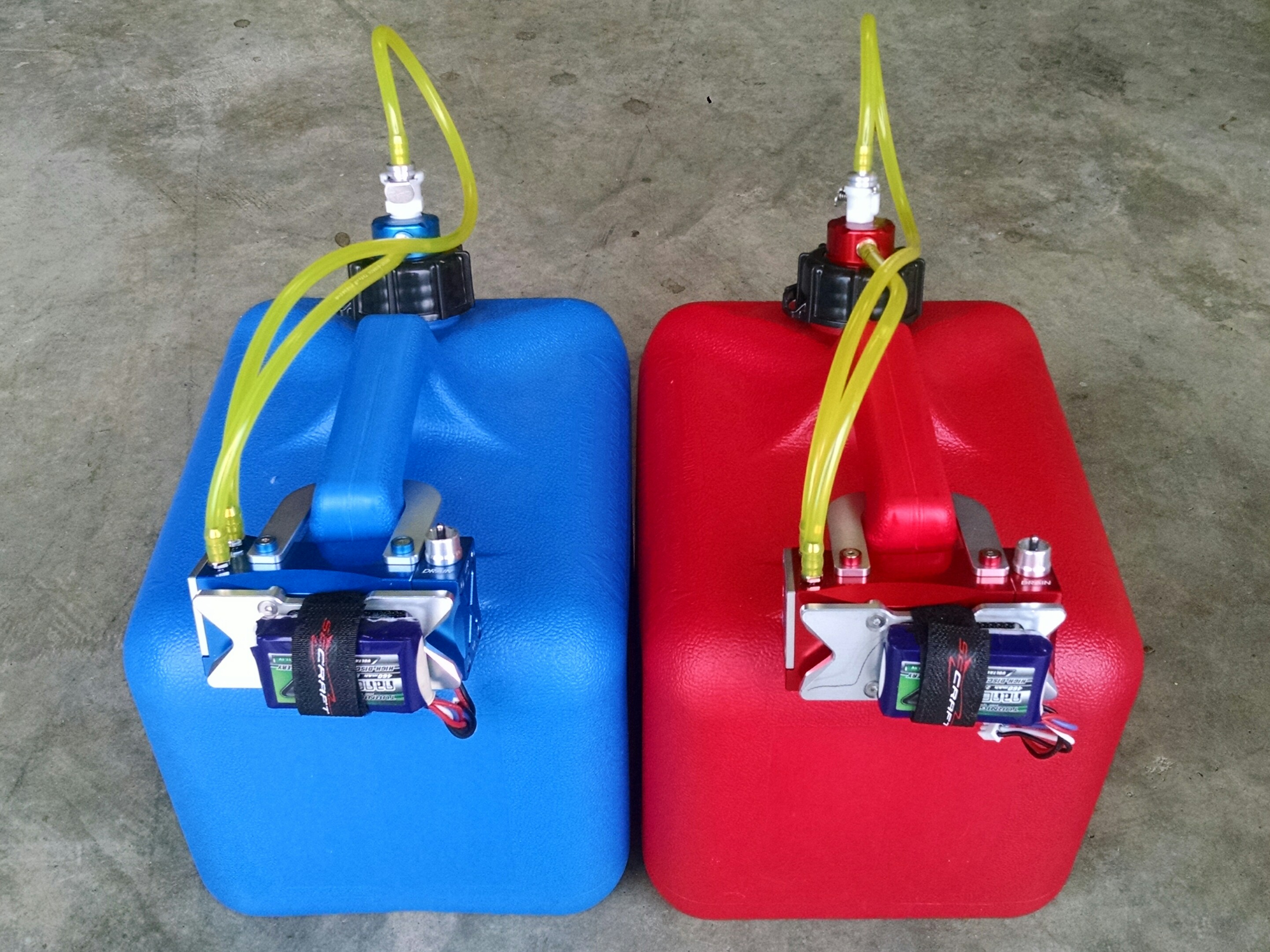

Completed the install with tygon lines and secured the battery in place with the included strap. I used a 460 3s LiPo I had laying from my foamies but plan on supersizing to 3s 2200's so I'll only have to charge about once a month! And of course I had to do one for smoke too...
