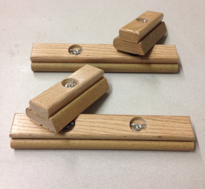

Sanding blocks I have some extras still made that I was selling or you can easily make your own. See pic attached. I sell them for $20 for a set shipped to your door.
