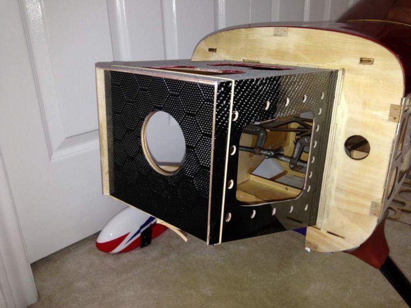

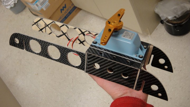

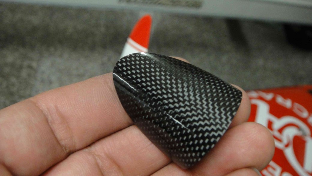

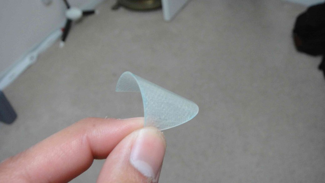

Here is a photo from a few years ago in which I made a light-ply laminate with carbon 2x2 weave for a Seiko servo in a CARF super Xtra.

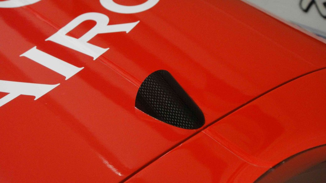

Remember the stupid little drama that arose over some of the first Futaba receivers overheating and shutting off? ....fixed that with this little air vent. LOL

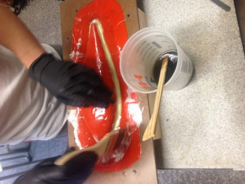

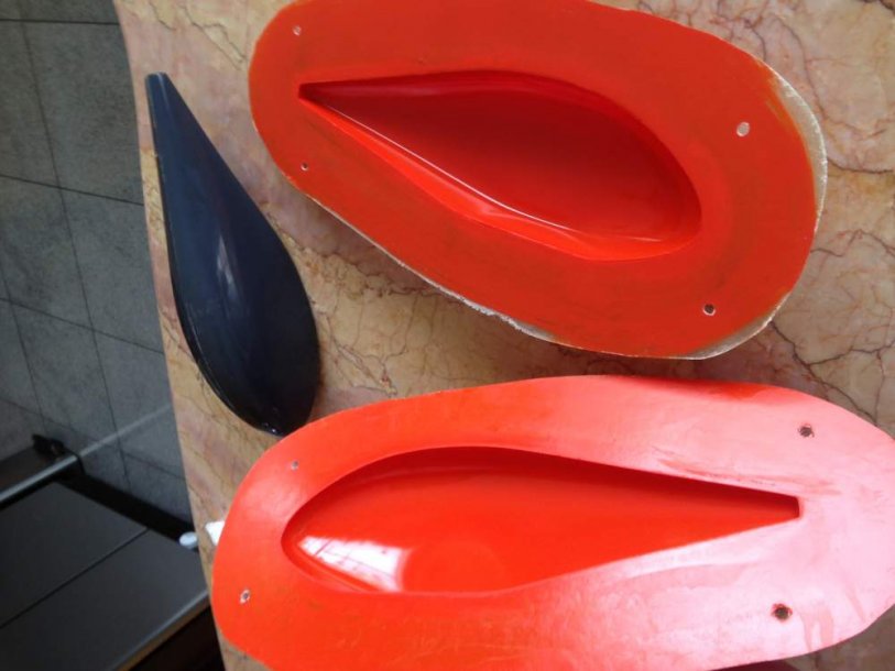

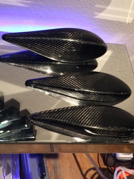

My current project however took a new turn in composites....when I was working on the plane pictured above I realized that I would not have nice carbon wheel pants to accompany it. They seem to be hard to come by and are not easy to make so I began trialing several methods to vacuum bag and or infuse them. First came the plug, then the molds....
GM
C-C-Carbon_Chemist
The molds pictured above are not the ones I ended up using as I had to modify them after trial and error. The wheel pants will have a more streamlined and teardrop shape to them than many that come with today's kits and I will use 2x2 or even 4x4 twill fabric. I hope the new molds can last long enough to make wheel pants for all my planes and any other members here who would might like some for their 35-40% planes.
I understand this is a build-forum so, will start a new thread in the vendor's section soon so I can post updates and picture of the finished wheel pants.

Very cool! I have a set of carbon fiber pants on my Areoworks Extra and I really like the look.

Wow! Very, very impressive!! Really like the simple and elegant way to make the small vent.
