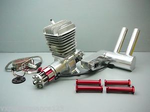

The DL50 I have is tired and wont tune well in the midrange (using canister/header) so I'm in the market for a new 50cc engine. Researching I found that the CRRC GP50R can be had for about 325 to the door. Hmn...DA50R is only a hundred more but is the CRRC worth the money? I have actually thought of just ordering bearings/carb for the DL50 and attempt to mate a DA50 cylinder/piston/ring to the DL crank/crank case. But I know DA is real sneaky with their fit and tolerances so I am deciding against getting a DA50R and getting the GP50R. The only thing about the GP50R that I noticed is that it has a six bolt hub vice 4. The mounting foot print is the same as the DA/DL. What is the word on this engine? Any good?

@BalsaDust I have had 3 DLE 55's over the years and no doubt a very good engine but now they are out of production and will be hard to find parts soon (just like my DL50). Also I have found that locating a NIB 55 is difficult and pricy (almost 400+ to door) Like Doug and Mike are saying I think a used DA50 might be the trick. I know CRRC has been in business for a long time like XYZ engines but have not been popular to the US market. My choices have pretty much been narrowed down because of price point and service /parts availability. Hopefully others will chime in with good news and bad about the CRRC. One thing that also concerns me is that the availability of the GP50R is limited to overseas stock only. All American distributors have sold them out. Wondering if that is saying good or bad about the engine?

Believe it or not the GP50R has been around for quite some time. Almost as long as the DL50. And like the DL50 it is a hard animal to find much less parts and service. I got some time before Fall shows up (when I really want to fly) to save up for a new DA50. That's probably best thing for me to do. It will drop right in and perform awesome with the cheap China can that's in the plane. Do have an MTW header though! lol
