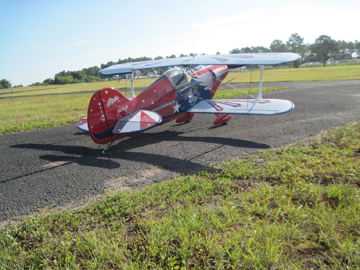

If the needles are right and the engine is getting to the proper temperature there should not be any noticeable oil residue. I have not wiped an airframe down after final tune in many years, as a matter of fact the Red Eagle Pitts shown in the pic has not been wiped down for oil in five years.
