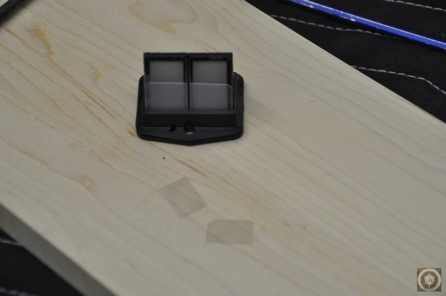

I just did the mod last night on mine. Just order a new set of reeds from VVRC, remove the carb / reed block (no need to remove fuel lines and throttle arm or anything). There is a rubber keeper that slides on over the reeds, pull that off and the reeds are now loose. Cut the factory ones in half and put a slight chamfer on the top outside corners. Install the new reeds with the half reeds on top, then slide the rubber keeper back in place.
Re-install everything and tighten up the carb but not "tight". Sort of pay attention to the torque on them bolts when you take them off, they are snug but not tight. You don't want to over compress any of the gaskets in the reed valve assembly.

I would drop the carb and check the reeds though and add the mod with the second half reeds.
