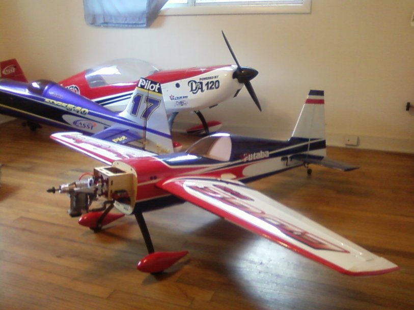

Just wondering how this is available in Europe, but not here? http://shop.lindinger.at/product_info.php?cPath=1619_1635_1636&products_id=9711448
Maybe Chris is expanding his designs to capture interest in a "foreign market" proving ground??? Would love to have one as a banger for my YS's. Not real impressed with the Asian 540( not pilot, they ARE awesome). Cut the wing tips off just to get it to fly true and straight.

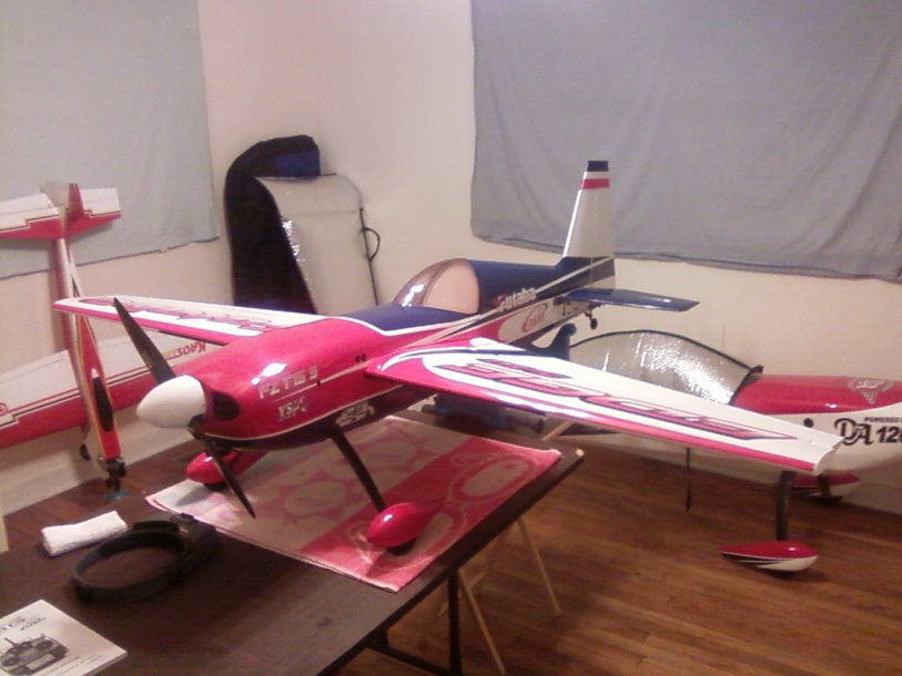

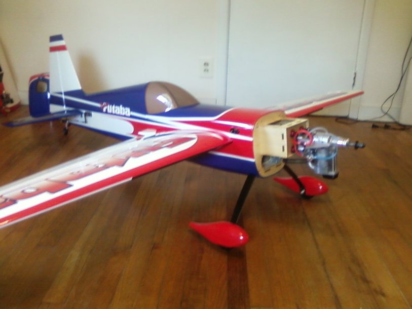

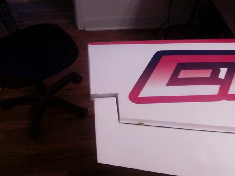

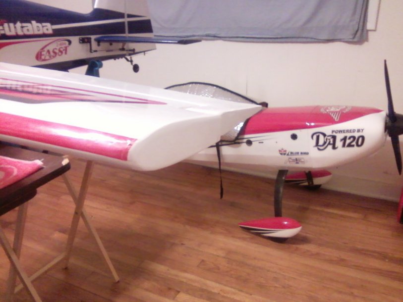

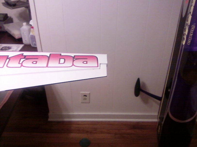

You are absolutely right. Having to modify and double check incidence across the wing is something you won't have to do with an EF plane. Awesome product. First pic is original wing tip. Measured- 1.5 degrees washout across right wing. +.5 degrees across left. Very visual / noticeable difference when viewing wing tips from behind plane.
Well I must say my Asian 549er does pretty decent now that the wings are "squared away"
