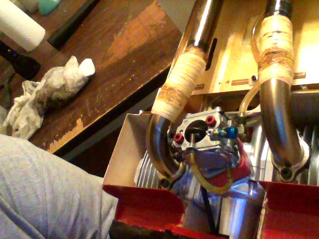

I have a DA 60 on a Pro Flow can in an Extreme Flight Edge. I've noticed that the engine starts to bog when I go into high alpha. This includes upright harriers and rolling harriers. It also bogs on inverted downlines (45 degree) and when I roll upright, it returns to normal.
Any ideas of what I can try?
Transition is fine with no hesitation and very little midrange burble when upright.
I have added a nipple to the diaphragm plate and I have a line running to a pill bottle in the fuse. Not mine but same idea:

Should I try setting the low richer or leaner first?
Also, what's a good source on how to make the plates to go on the carb for holding the fuel tubing?
OK, I was actually referencing that at the field Sunday. Will give it another go and start with the low and get that steady 15-20 second idle first.
I played with the needles yesterday and the motor sounds great for the most part and is still having problems in high alpha. I did notice on the last flight yesterday that it sounds like it's being starved for fuel occasionally for just a second even in straight and level. So I'm going to pull the fuel tank and inspect and also inspect the screen in the carb.
Any other places I should check?
If I don't find anything in the fuel tank or screen I may buy a Dubro tank to assemble and throw in there just in case there's something up with my water bottle tank.
