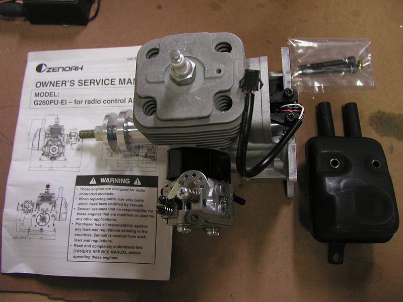

FYI this is a brand new 26EI on RCU for $250. It is the older version and has the hall sensor on the back and is a little heavier than the newest versions.
