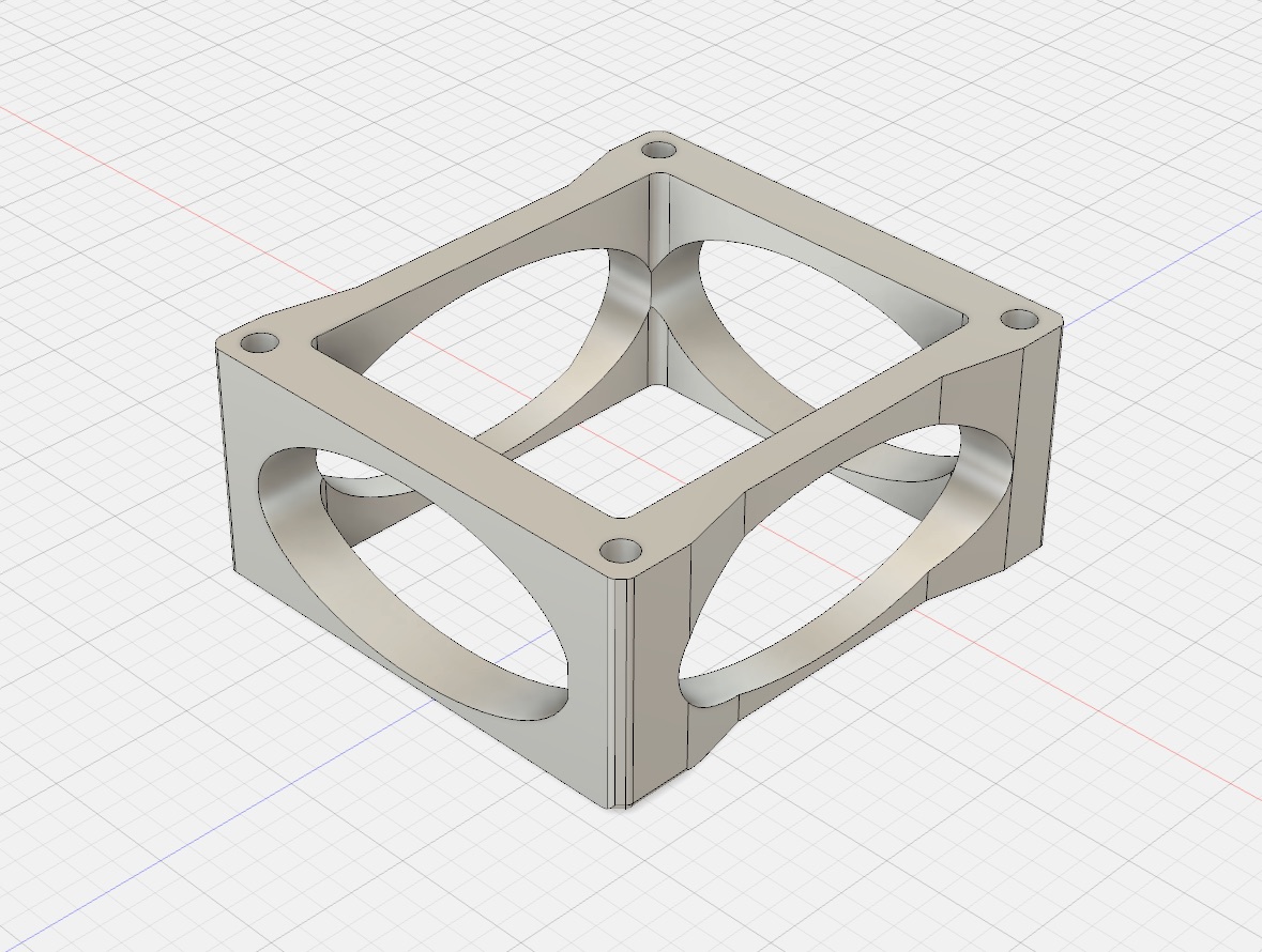

yes, make one for a DA 150/170/200!
about 43 mm in length,
and the 4 holes to be spaced center center of 80 mm by 90 mm in a rectangle shape.
the 4 holes for the bolts need to accept 6 mm bolts.
Nice, give me the actual file. What format? Does the drawing have the exact measurements for that engine?

The new Dalton ARF, which can be outfitted with a DA 150, 170, 200, and DLE 222, all have the same bolt pattern, which is 80 mm by 90 mm.
I do not know what the depth would be on the new ARF kits.
On A Dalton 300 ML, with the short motor box for a DA 200, you need between 43 and 45 mm of depth.
Just to give you an idea. I believe there is a market for these, especially for the people buying the Dalton ARF Extra from PAU.
