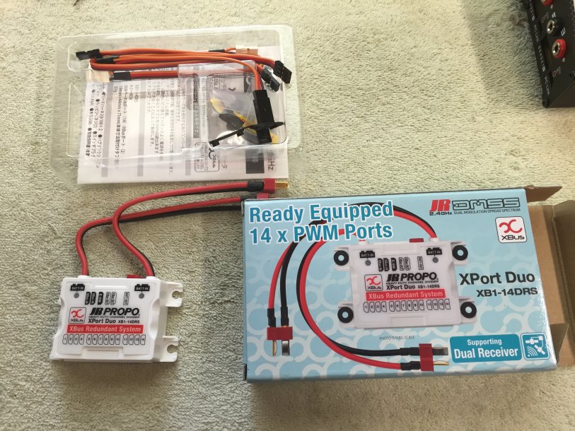

The Xport Duo is like a big Xbus converter and allows you to run normal servos off the Xport Duo directly. It allows you to assign any servo to any port. It's also expandable so your can link two of them together and get 28 channels out of it.

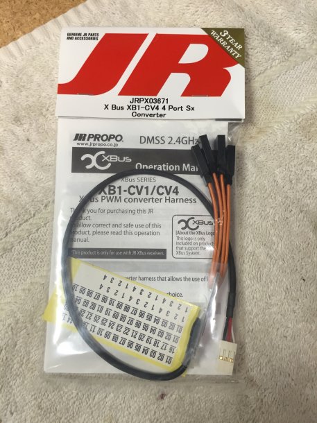

If not using the Xport Duo you can buy converters if you don't have Xbus specific servos and run normal servos using Xbus. If you have Xbus servos you don't need the converters.

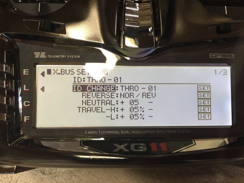

Go into your Xbus setup menu..

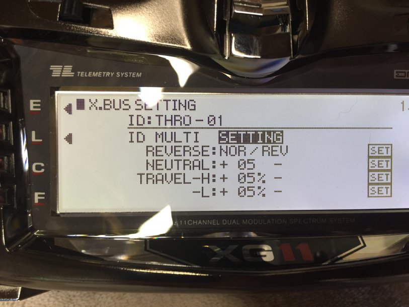

Scroll to where it says "ID Change" and click there until you see "Setting" appear next to it and then scroll over and click on "Setting".

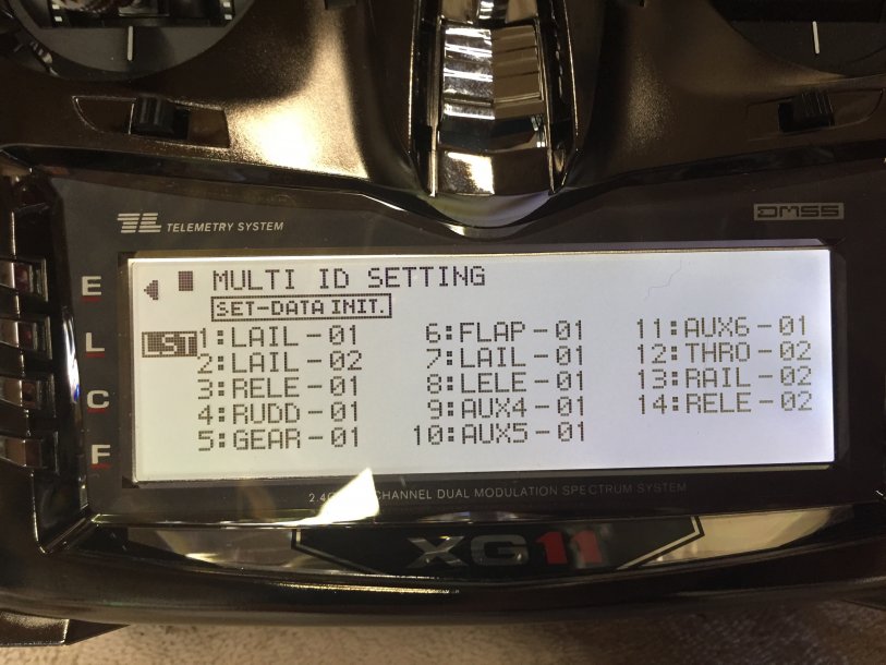

Here you assign which servo is on which port of the Xport Duo.
So for my example I set ports 1 and 2 to be Left Ailerons 1 and 2. Simply scroll click and adjust, it's pretty simple.
Here's the catch.. When you have it the way you want it.. Scroll up and click on "Set-Data Init". Until you do that the settings won't be in the Xport Duo and the other servos won't move.. I *think maybe you haven't done the last step?
So there can be up to 4 servos assigned per channel on your radio. Each port on the Xport Duo can be any of those 4 servos off any channel of your radio.
