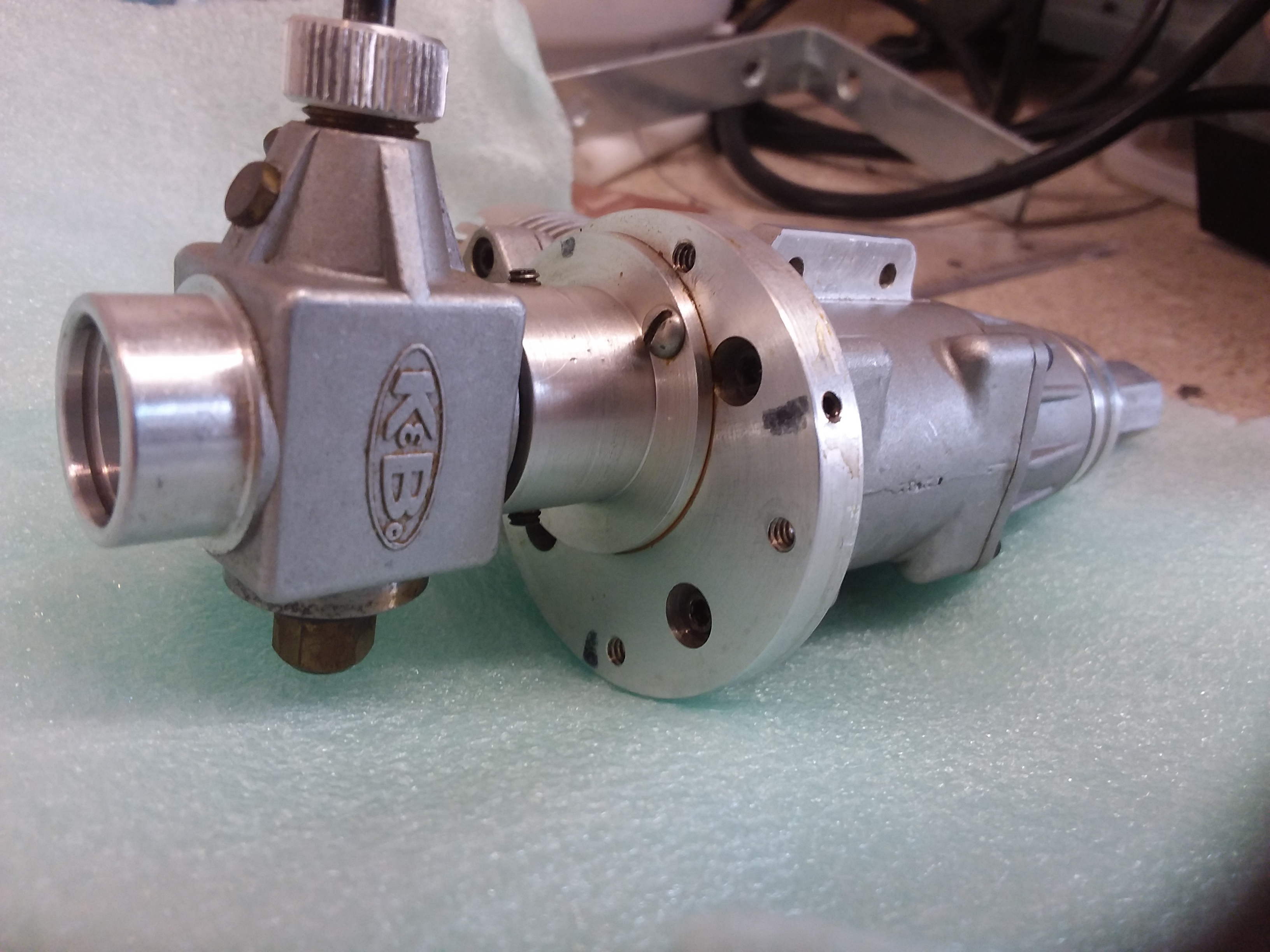

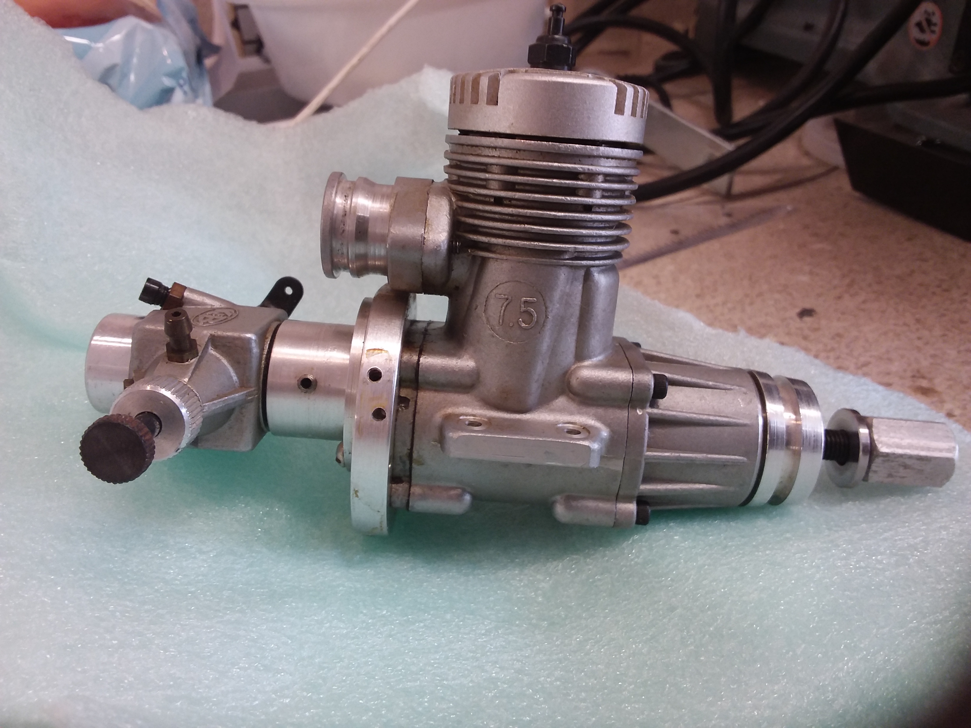

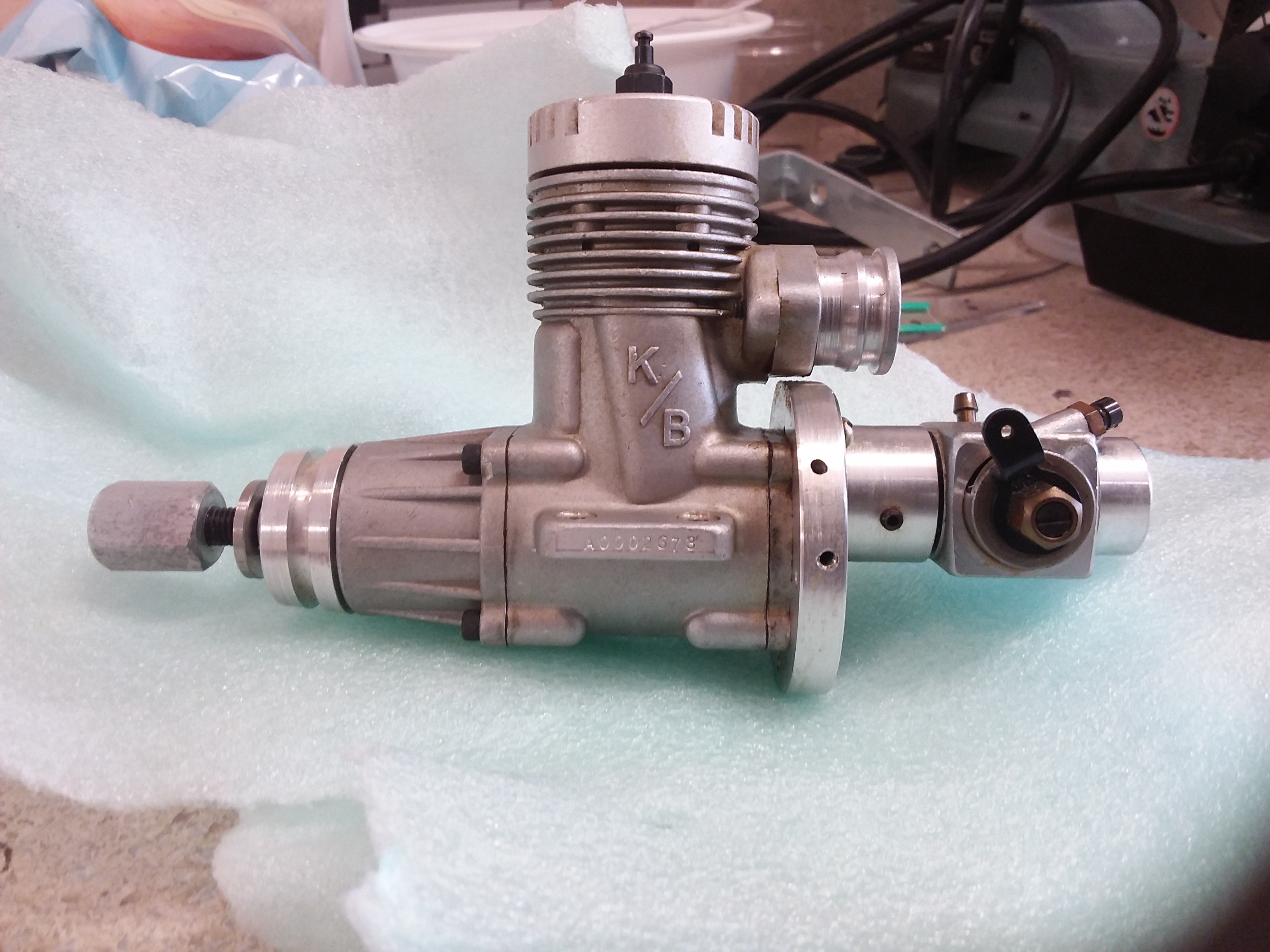

I have several high rpm nitro engines that will probably never run as they're all nib. I got the itch to make some noise so I picked up this used K&B. I'm going to go through it first then make some noise.
Interesting never played with a KB. How does that intake work is it a rotary disc or a reed valve. Need a tune-pipe for that engine to make a little noise. Need to make a video of it when it runs love hear it and the nitro smell if you can do that.

That engine is used for a ducted fan, and really needs a pipe. It's equipped with a rotary valve instead of a reed. I've still got several and ran them in RK40 fans and on pylon models. It's timed similarly to a pylon engine to turn in the 20K range. Appropriate prop will be in the range of 8-1/2 to 8-3/4" diameter. Terry Prather offers many, many, many variations. I'd buy them by the box (as would everybody else) as we sought the 'world beater'. Fuel-wise, begin with helicopter 30% nitro and go up from there to as much as 65% (boat guys use this). Otherwise, you're just making noise instead of power and you'll be greatly disappointed. And without a pipe it'll be loud 'and' obnoxious and sans protection damaging to your hearing (and of those around you). Damage, by the way, which is both cumulative and permanent.
